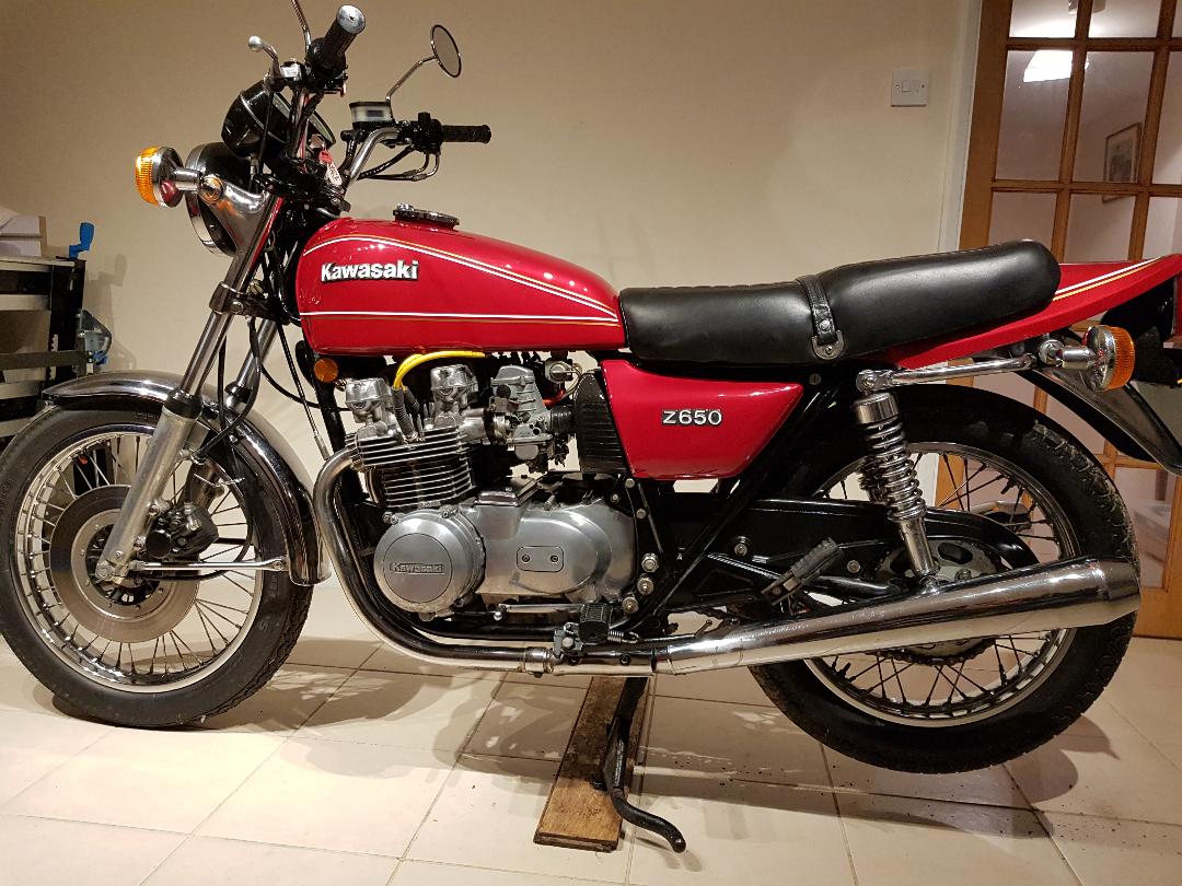

Thanks for replying. Good point noted about dropping the sump. Oil quality is particularly important considering the plain bearings. Bike looks in good external nick, and seems well cared for and maintained. Wire wheels and original exhausts set it off very well, but oh those handlebars!
Pic attached - hopefully

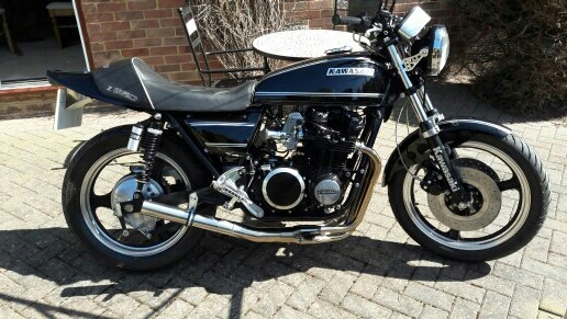

Welcome, I have 2 650's. One period correct customised to be the bike I wanted back in the 70's and the other, in green, I bought new in 77. Still bone stock.
Yours looks to be a original un messed with survivor, pretty rare these days so I would clean and fix anything broken but thats about it.

Oggers, it looks like a good honest bike. As I said a survivor and very nice.

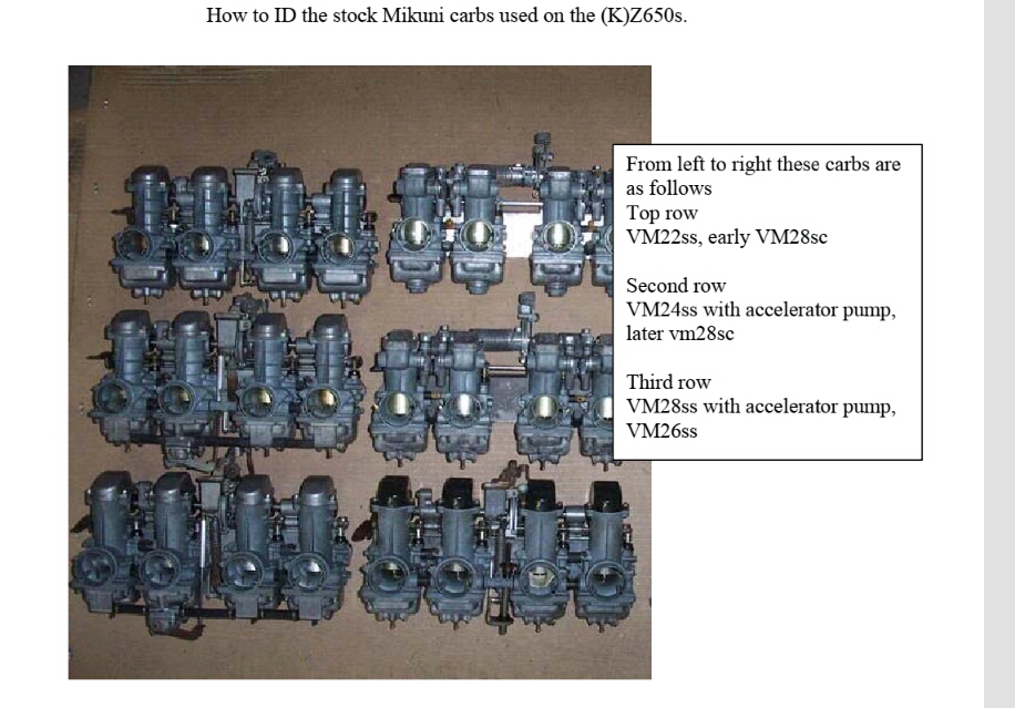

As an aside do you know if it has vm22 or vm24 carbs? Uk bikes had 24s and some us had 22s. 24s are definately preferable and do release a few more ponies. Heres an easy way to tell, vm 22 have a port at the 10oclock position, vm24s dont. 24s also come with or without accelerator pumps.

Oggers wrote:Carbs - no idea to be honest. I guess I wouldn't see the extra port with the carbs on the bike as is?
Easy to check Oggers, just roll back the rubber on #1 carb slightly. If they are 22s there will be a port on the mouth at about the 10 o'clock position.
