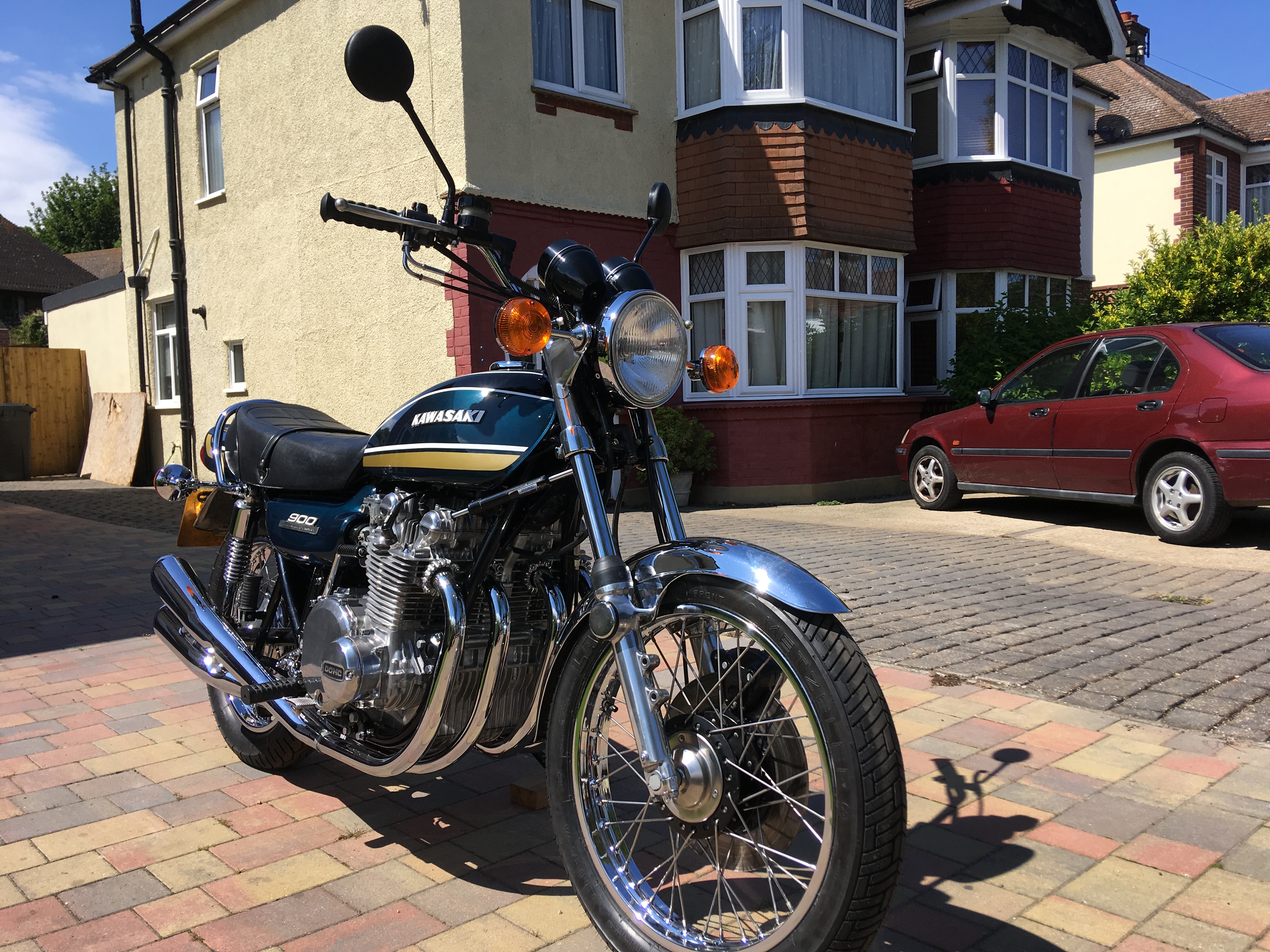

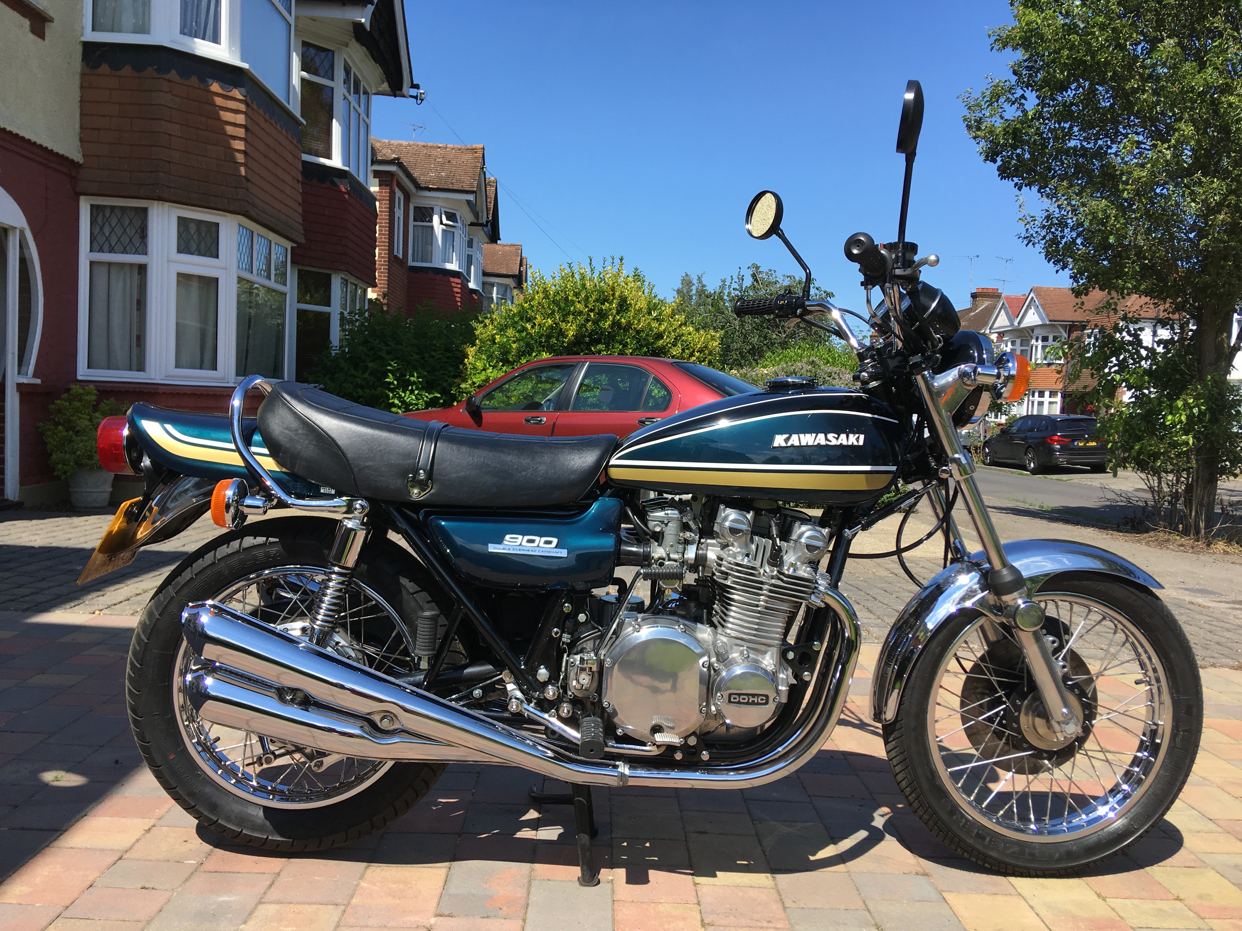

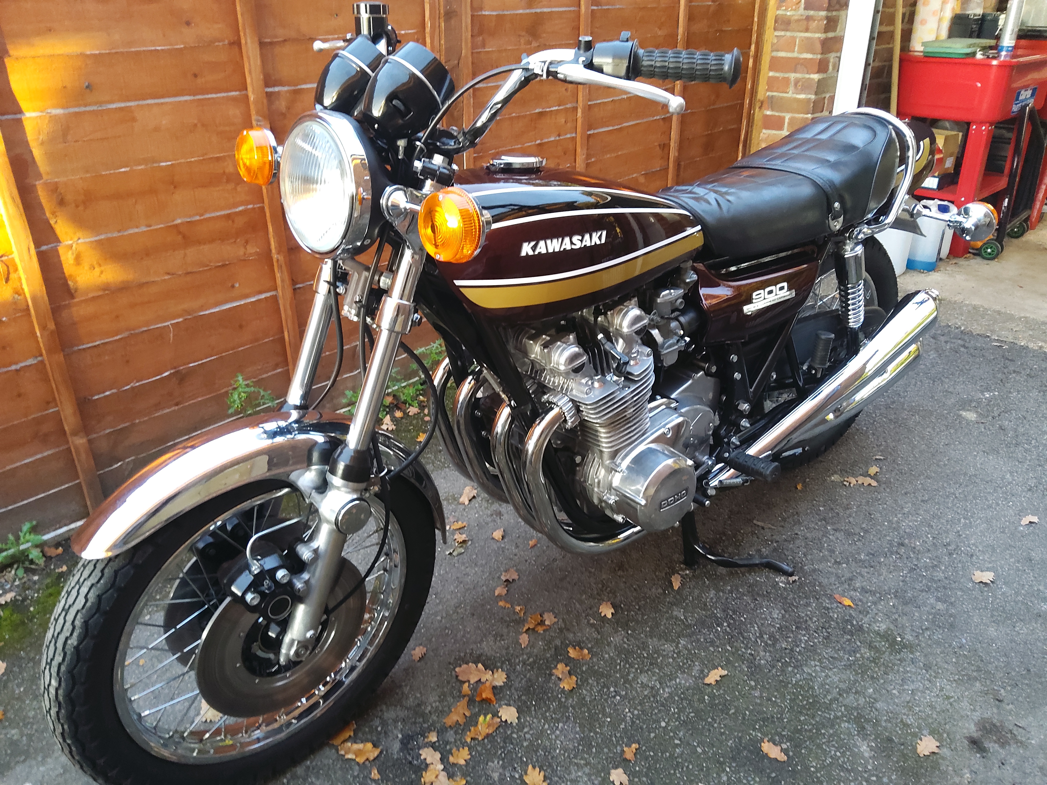

#7 PostAuthor: KwakaRascal » Fri Feb 05, 2021 6:39 pm
Hi Marmck & Philippe,
Couple of pics of my pride & joy. :)

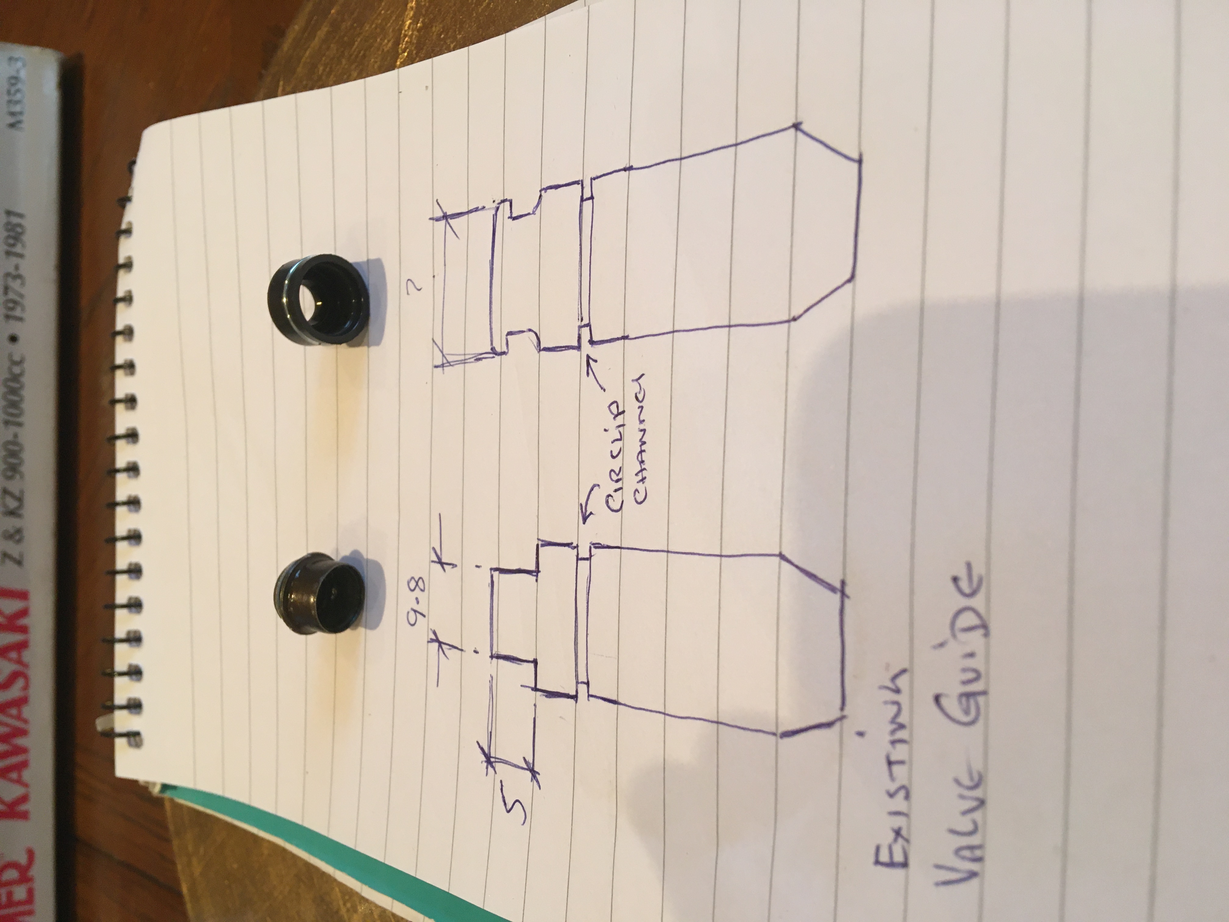

#11 PostAuthor: KwakaRascal » Sun Feb 07, 2021 2:11 pm
Hi Philippe,
Thanks for the offer to source the new guides but that’s not necessary.
The problem I have is that the guides that are currently fitted in the cylinder head are odd / not standard in there profile.
As they do not look anything like the standard Kawasaki profile I need a pattern part to have duplicates made.
Also the chances are they will need to be machined oversize to fit the hole size what ever that maybe once the old guides have been removed.
So, whilst there are pattern parts also available here in the Uk offering 4 & 27 thou o/s, they may not fit.
The best approach I’m thinking is to have them “made to measure” but I don’t have a pattern of either the exhaust or inlet to work to.
I’ve attached a sketch showing the comparison.
Sorry for the lengthy explanation :)
Re: New Member
#12 PostAuthor: Philippe » Sun Feb 07, 2021 2:33 pm
Hi Russel
I think that the best you can do is to get the old valve stem guides out and to measure them.
If those have the same diameter as the originals you're OK. If not you can buy one original valve stem guide for the intake and one for the exhaust and use those as an example to make new ones.
People did strange things in the past...they didn't think about the fact that the guide caps would need replacement in the future.
Good luck!

#13 PostAuthor: KwakaRascal » Sun Feb 07, 2021 3:07 pm
Hi Philippe,
Your right, I would like to source a guide, however these days new ones on offer seem to be pattern parts and solely of the inlet profile.
Not knowing enough if this critical or not, hence seeking out an old original.
Thanks again for your time and thought.
