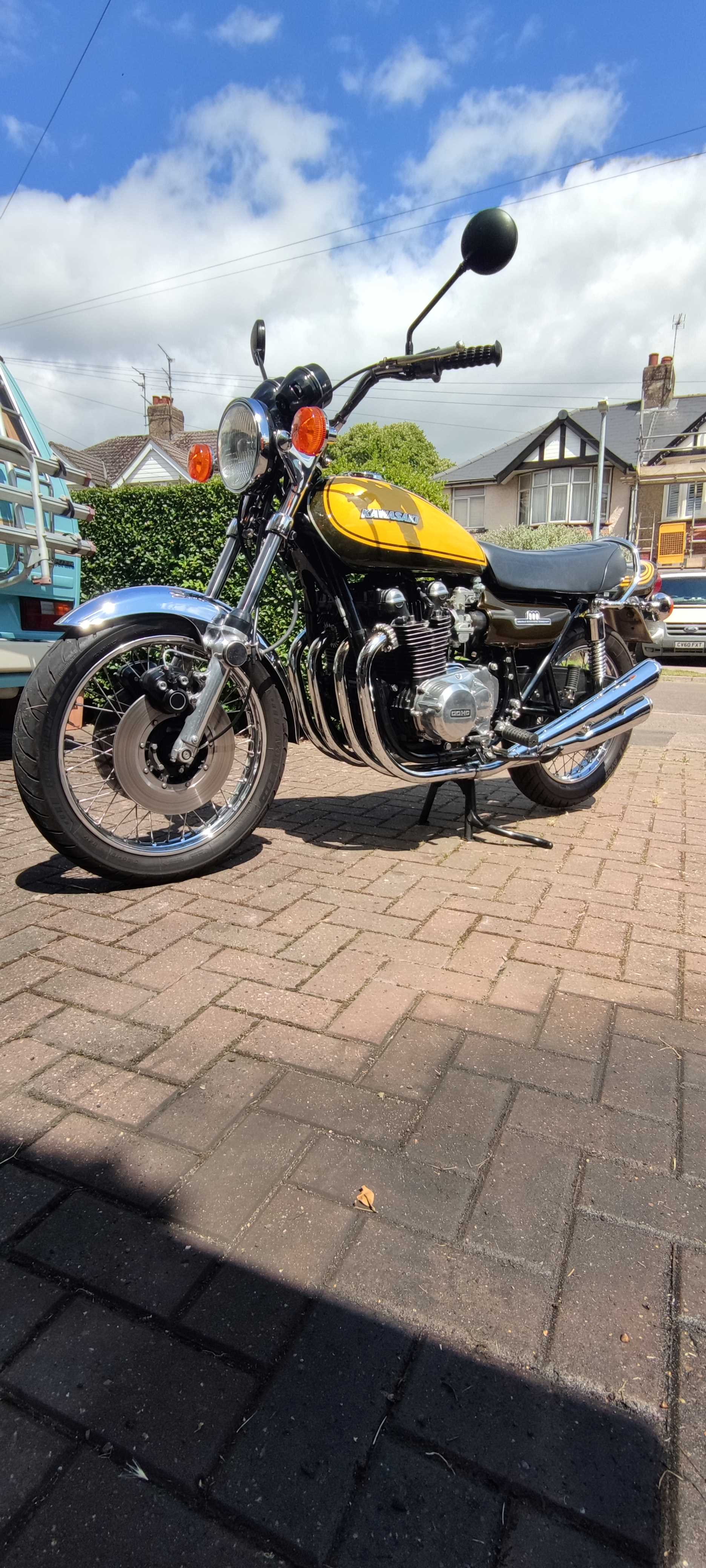

Hello all, first time on the forum for me but not the bike.
I originally owned a Z1B in the early 80's as a spotty teenager, so 40 years later I thought I would have another. This time a Z1 after a bit of searching.
The bike is not entirely original but that is not a real issue for me, and it has had a couple of other users during its brief time since being "fully restored".
All I need not is a bit of sun and for the damn thing to run a little sweeter that is does presently.

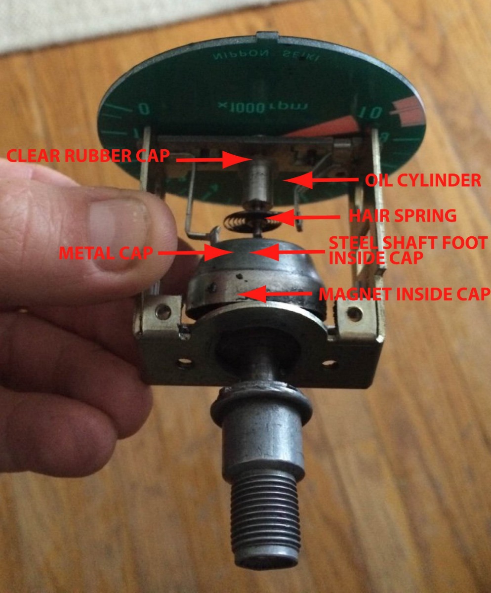

I also have an issue with the tacho being unstable over about 4000 rpm. I understand that there is some damping fluid involved but I can't find much detail about if it it something I can tackle or if it need a specialist.

It's not a khi speedo but they are all similar internally.
To refill the damper pots means dismantling the outer shells and injecting some light machine oil back into the cylinder trough the rubber cap.

warren3200gt wrote:It's not a khi speedo but they are all similar internally.
I wouldn't bother taking it to a shop unless they have a proven record of working on 70's bikes. Most shops these days have no clue. If they can plug a laptop in and get told by it which whole component to swop out for new I ty ll likely come back worse than it when in.!
Thanks Warren, is the dismantling of the casing straightforward please?

Dismantling is just a matter of prying under the chrome ring so that the two shell halves can be separated.
Reassembly is just the opposite but far from easy to do neatly as you need to re fold the underside of the ring which is difficult to do neatly. New rings are available or you could send it to Al Marshall (I think) who does a refurb service and is a member of this club.
