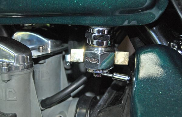

June week 1.5 update - D day :D
So after much deliberation on fuel taps - the obvious Pingel tap arrived from messers Debben.
#3211D - Twin outlet tap £70
#A2001C - M22 tap adaptor £18
#TYGON - Fuel hose yellow £7
I didn't end up using the hose as it looked hideous, it would look ok with some cotton overbraid - but I don't have any - the hose I had stretched over - just!
The threads were treated to some PTFE tape and the adaptor gently screwed down, nipped up with my trusty 1" service wrench and we are good to go!
Closer....
A gallon of fuel went in - and stayed in - no leaks this time!
To be on the safe side I drained the fuel bowls again and flushed em through. yet again more black bits and blackish jelly blobs emerged - but less than last time - with clean fuel flowing I pressed on.
Closer....

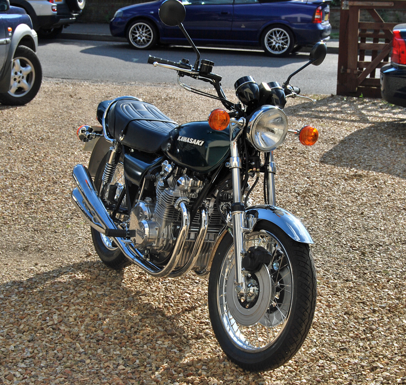

Wheeled her out the garage for the first time.
I had an audience so was a bit nervous - I neednt have worried - First Prod - Brrrrrr, rumm, barrrr, rumm, barrrr, rumm - rummm, barrr - brrrr - perfect!
Ready....
Went to load her in the van and - the clutch was stuck fast - bugger!
another ten mins of adjusting and general buggering around trying to dig up the drive with the rear bridgstone and the clutch was free - yay - in the van she goes...
So - First Ride Report.
Unloaded and warmed her up......
Sun shining - Fuel on - Ign on - Start - into 1st gear - and off we go.............
1st, 2nd, 3rd, 4th, 5th - nice and so smooth - no issues.
Round the twisty bits - over the bumps - on the brakes - purrrfecctt!
The first thing I noticed was how smooth it is, steering is light and very positive, suspension is nice and firm - but not too firm.
It flows naturally into the corners with just a hint of understeer - but that's being really picky.
The riding position is very upright but not uncomfortably so, the wide bars take me back to bikes of old, pootling around it felt more like an old flat-tracker - just waiting for me to get its tail out!
The gearbox is super silky smooth, positive selection with plenty of lever feel.
Final drive ratio is great - just what I wanted, I'd calculated the ratio for using the 530 set up and wanted a touch taller gearing.
Going with the 1 tooth less rear than the standard set up for the 530 kit brings the rev's down a few hundred rpm for cruising but is still responsive enough if required, first is still pretty low - so I could easily go down 1 tooth more on the rear if I want (or up one on the front and two/three on the rear if clearance becomes an issue).
The motor is extremely silky and so so smooth, still a touch tight but I was surprised how much low down grunt it's got, to be honest I was expecting less.
The fuelling seems spot on - ticks over perfectly at 900rpm, pulls cleanly from the bottom with no hesitation whatsoever - power is linear and progressive.
I didn't rev it hard at all on the test ride - so the top end is something to discover on another day :D
The first ride was unfortunately cut short as a ticking sound had started to appear on acceleration, four miles into the ride.
With the bike stationary it sounded like cam chain lash or a loose shim or two, will pull the cover for an inspection at the weekend.
With the bike back on the ramp I gave it the usual once over.
Save for a bit of wet-staining from the cam cover gasket she had No oil leaks and after a quick go around with the torque wrench - No loose bolts either - result!
The motor was too hot to do much, so I sat with a tea and made a few notes of things to do.
1 - adjust clutch lever, as the plates started to bed the lever play got bigger, I adjusted the lever adjuster a couple of times but I'll adjust it gearbox end as I know the cable will stretch as it beds in.
2 - pull the forks up a touch in the triple clamps, just to quicken the steering a bit - although the steering is very neutral and doesn't need adjusting - most of my bikes are a bit quicker to turn in so it suits me to make the change.
3 - bleed the front brakes again, just a touch on the soggy side, the lever was just a bit too far back to the bars.
4 - pull the nearside front calliper, although on the test run I didn't pull very hard on the brake lever - it had not wiped the paint off the disc completely - the offside had - so I'm going to pull it and check it slides freely, if it has stuck that would also explain the slightly more soggy than normal (for bedding brakes) feel.
5 - pull the cam cover and have a look around, re-tension the cam chain.
6 - adjust the rear brake lever, the more I used it the more it went out of adjustment, as it started to bed-in the feel was getting better and better, not snatchy but with firm pressure it had already started to be effective - something I'm devoid of with my tuono - shite rear brake on that.
I really don't know exactly what I expected - but I was very pleasantly surprised.
As I type a parcel has just arrived from the states - thanks Jeff :D
Such fun :D

On the subject of fuel hose - for now the debben tygon yellow hose has been replaced with marine fuel hose.
The short length of hose debben supplied turned out to be not long enough to cope with the bulky fuel filters I'm using.
The tight turns necessary caused kinking when warm as the tygon hose has no wall strength.
It wont run fuel filters when the new tank goes on - but it will be using the genuine tap currently fitted to the Ltd, and (if I can find some) black tygon hose - if not marine hose.

The MOT is booked!
I spoke to the tester about the headlight from Z Power and after showing him a pic was told 'That beam pattern is for driving on the other side mate!' - oh good....
I'm going to use the original sealed beam one for the MOT - The dip beam pattern from this is more or less straight - I'll take a bit of black sticky tape just in case.
Ever closer :D
