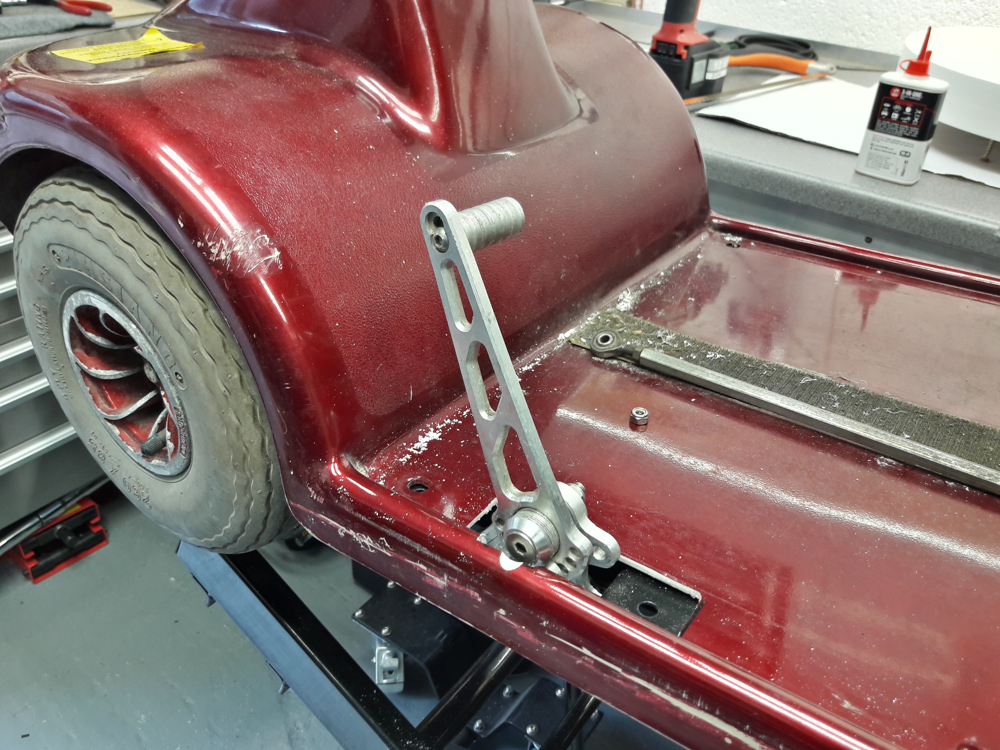

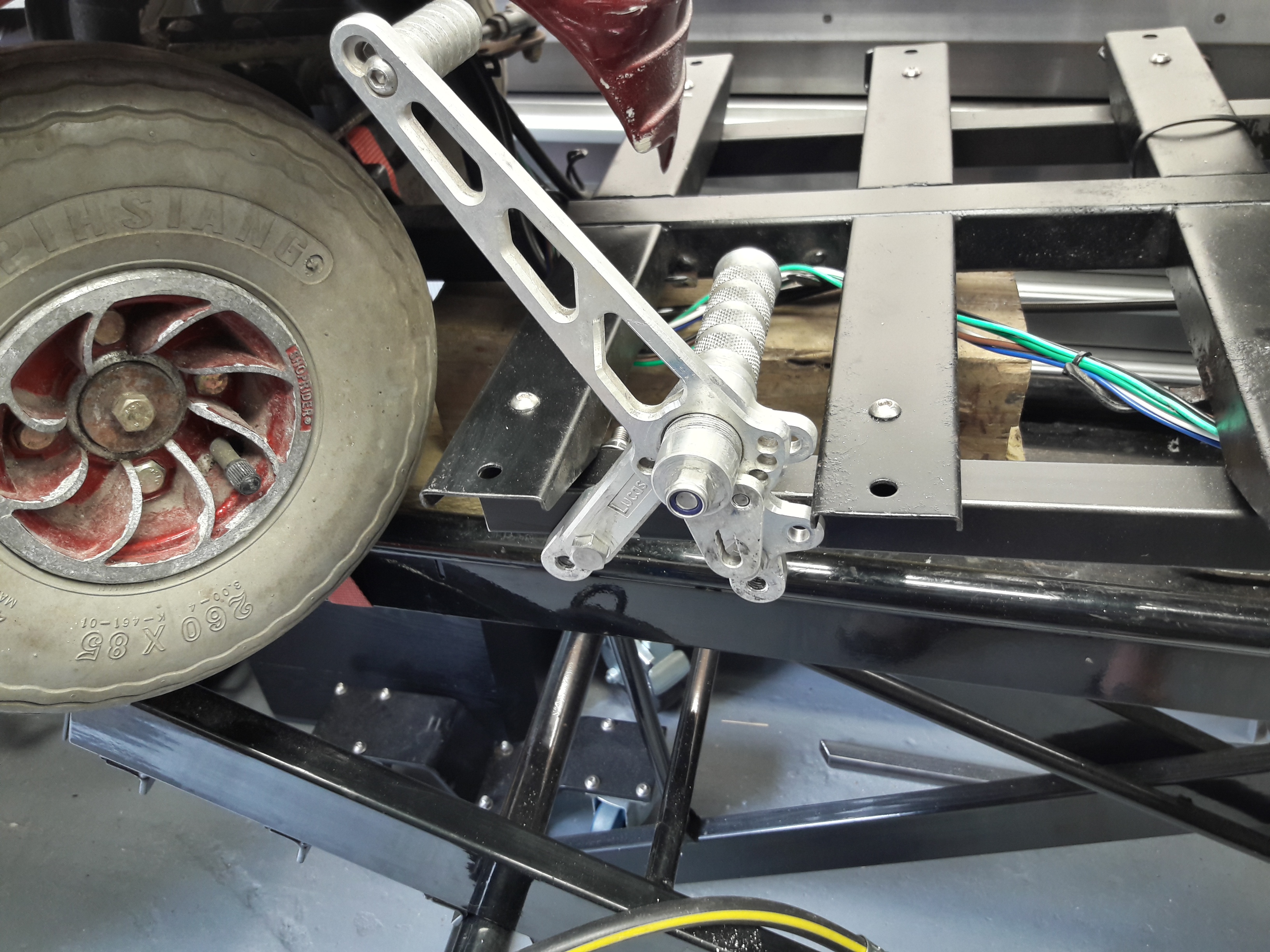

Brakes (or brake) was bled up at the weekend, as was the clutch. No leaks!
Sorted a couple of the final jobs this afternoon.
Using an old Lucas rearset, I robbed the best bits from the pair & mocked up the gear change.
A bit more fooking around & it fits through the floor. I do have the option of adding the footrest, should I need something to 'brace ' me foot against.
I've ordered a length of 10mm aluminium hex bar to use as a linkage, along with a LH M6 tap, but the linkage would have fouled the engine mounting bolt...
A bit of countersinking has resolved the problem.
Just waiting for a new chain rivet link & some long M6 bolts to mount the clutch outrigger & we're ready for testing.
