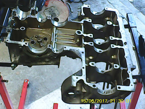

Managed a few hours tonight - hopefully get the cases apart and get a good look at what's going on. Obviously someone has been in the motor before but judging from the gaskets and goo used I don't think that they got much beyond taking the head and barrels off.
Flipped the motor and removed the oil filter housing and then the sump.
Pretty telling in here - loads of metal flakes and more gasket goo on the strainer.
Just spotted this lil' beauty as well - a trip to the Tig guy is on the cards
Sump pan was filthy with goo and tar.
Multi coloured gasket and alloy heaven
Worryingly - I could see a crank cap bolt missing. Nothing like that in the motor so I guessing that one was removed from the sump aperture ?? Strange.
Another sheared crank case bolt. Hopefully shouldn't be too much of a problem.
Cases apart - crank out - nice and easy - just had to clean up the threads on the jack bolt points.
Just a reminder to me of another sheared bolt. This time it's a starter motor bolt.
These marks could be when the cam guide let go
Close ups of the marks
That'll do for tonight - everything bagged, labelled and stored.
Next jobs will be getting the broken studs out, weld up the crack, clean up all the threads and get the external alloy head and barrels off for vapour blasting.
