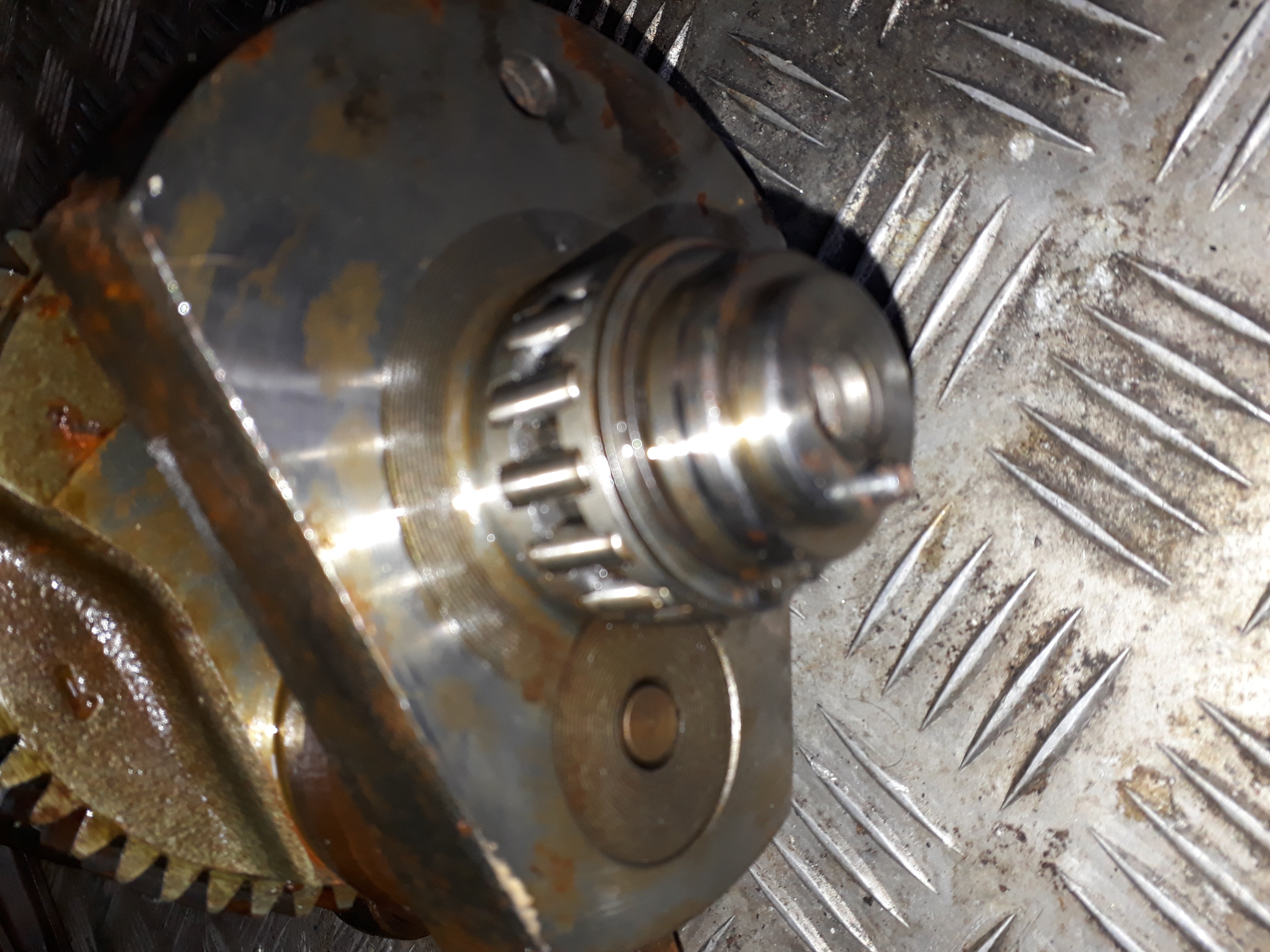

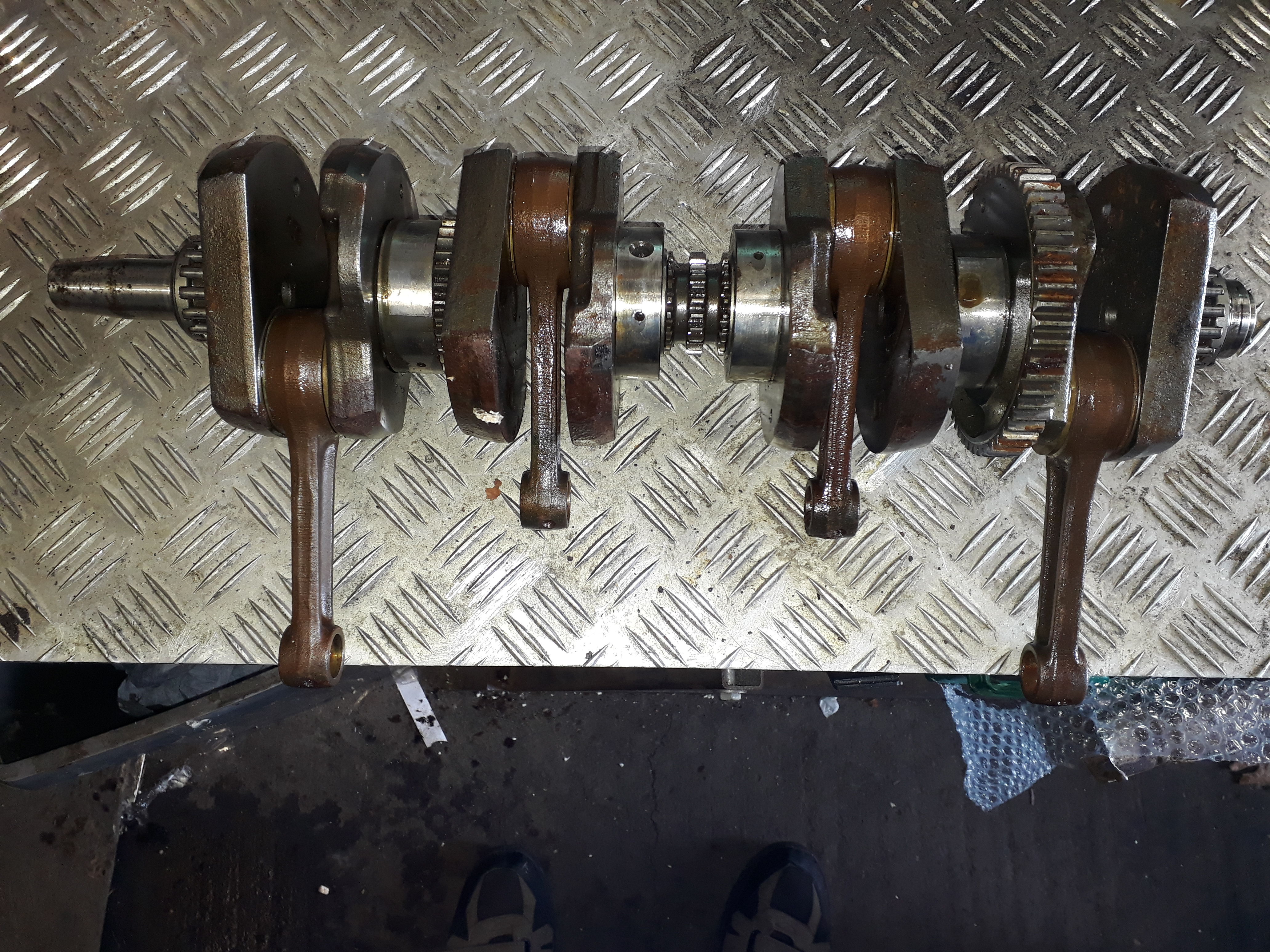

Before I list this crank I want to be 100% sure I know what it is for the description .
I believe it is GPZ1100 as it has 18mm gudgeon pins holes ,am I right or wrong I need to be sure.
some pics
Thanks Ted

GPZ1100 and Z1100 Ltd (1983 - 1984) had 18mm gudgeon pins. All other air cooled zeds had 17mm gudgeon pins.
