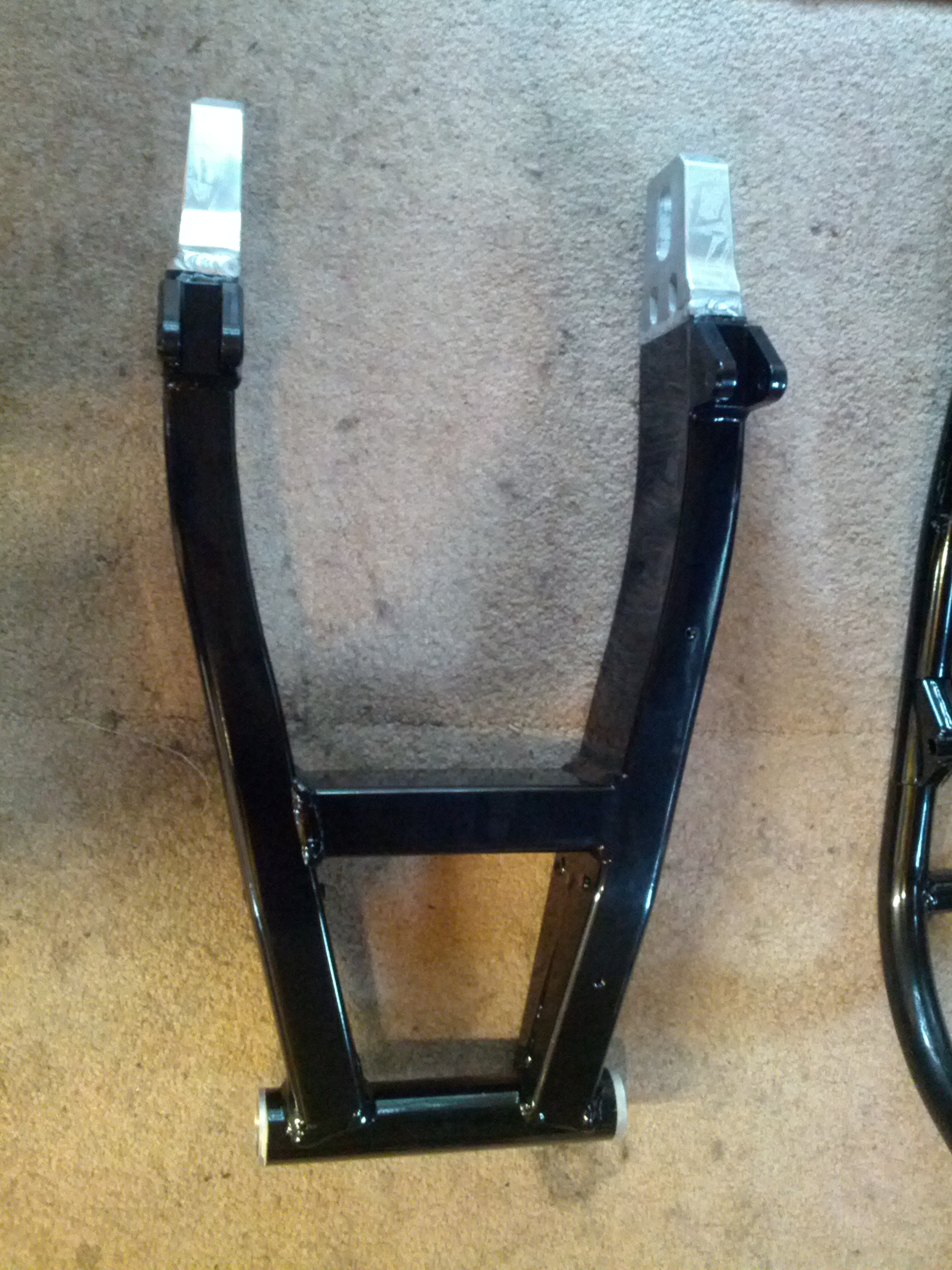

Got some parts back from Mikey, polished and anodized gloss black:

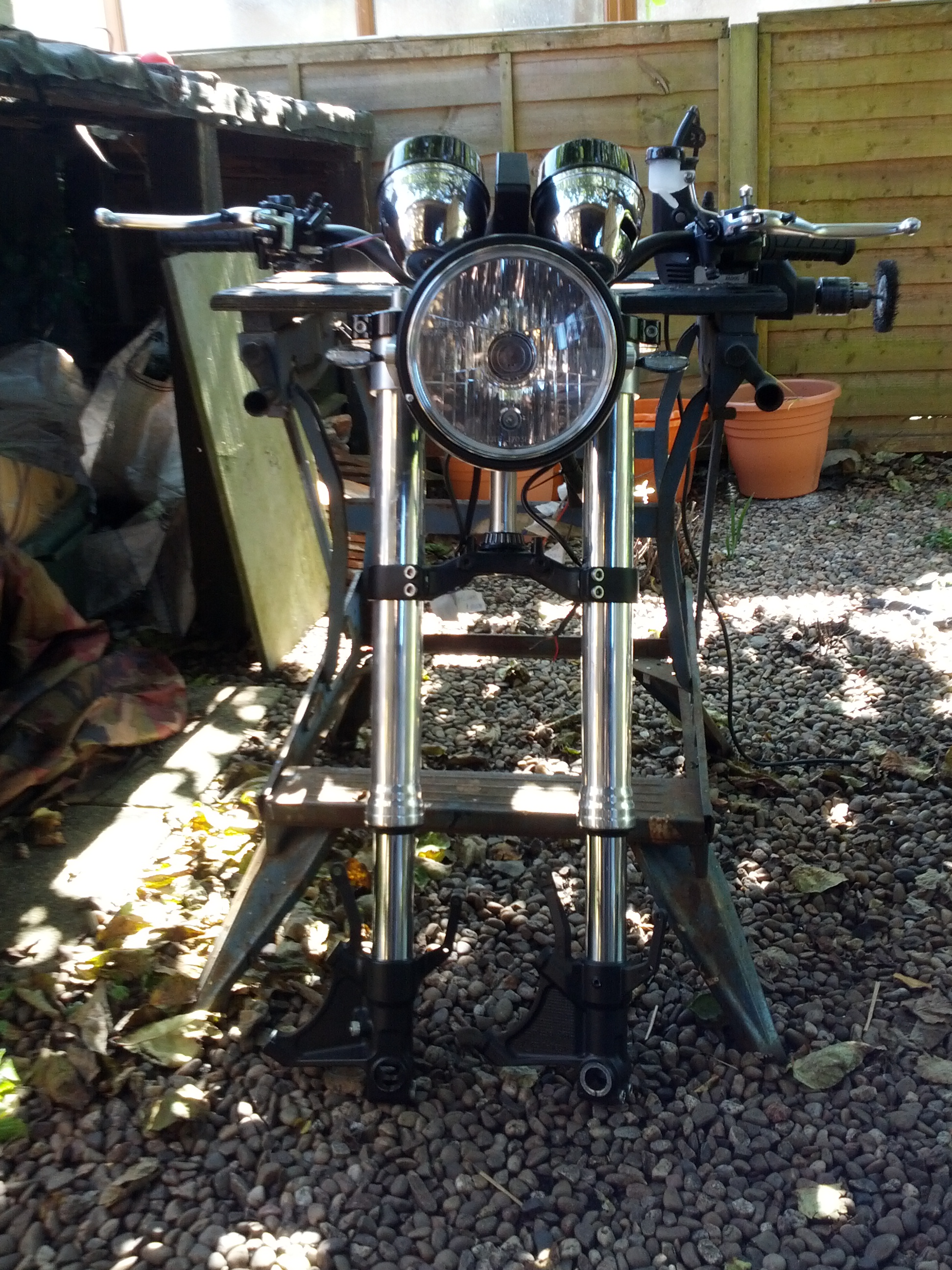

The forks i have got Mikey to polish at the moment. I have real doubts about the forks as i may have to lengthen them to get more ground clearance at the front. If i think i may have to do this i will have to make some tube extensions to screw in the top of the forks and lengthen the cartridge by the same amount. The end goal is to get the forks anodised black, but i have decided to wait until i have the whole bike built up and at least do some riding on it to decide how much the front end may need to be raised, then get the extensions machined and then send the whole lot off for anodising, so everything matches colour wise. I only want to do this once as the internal PTFE coated bushes will need to come out of the forks for anodisng and this looks like a prick of a job, and im sure the bushes wont be cheap either
Swingarm spindle end caps:
Oil cooler brackets:

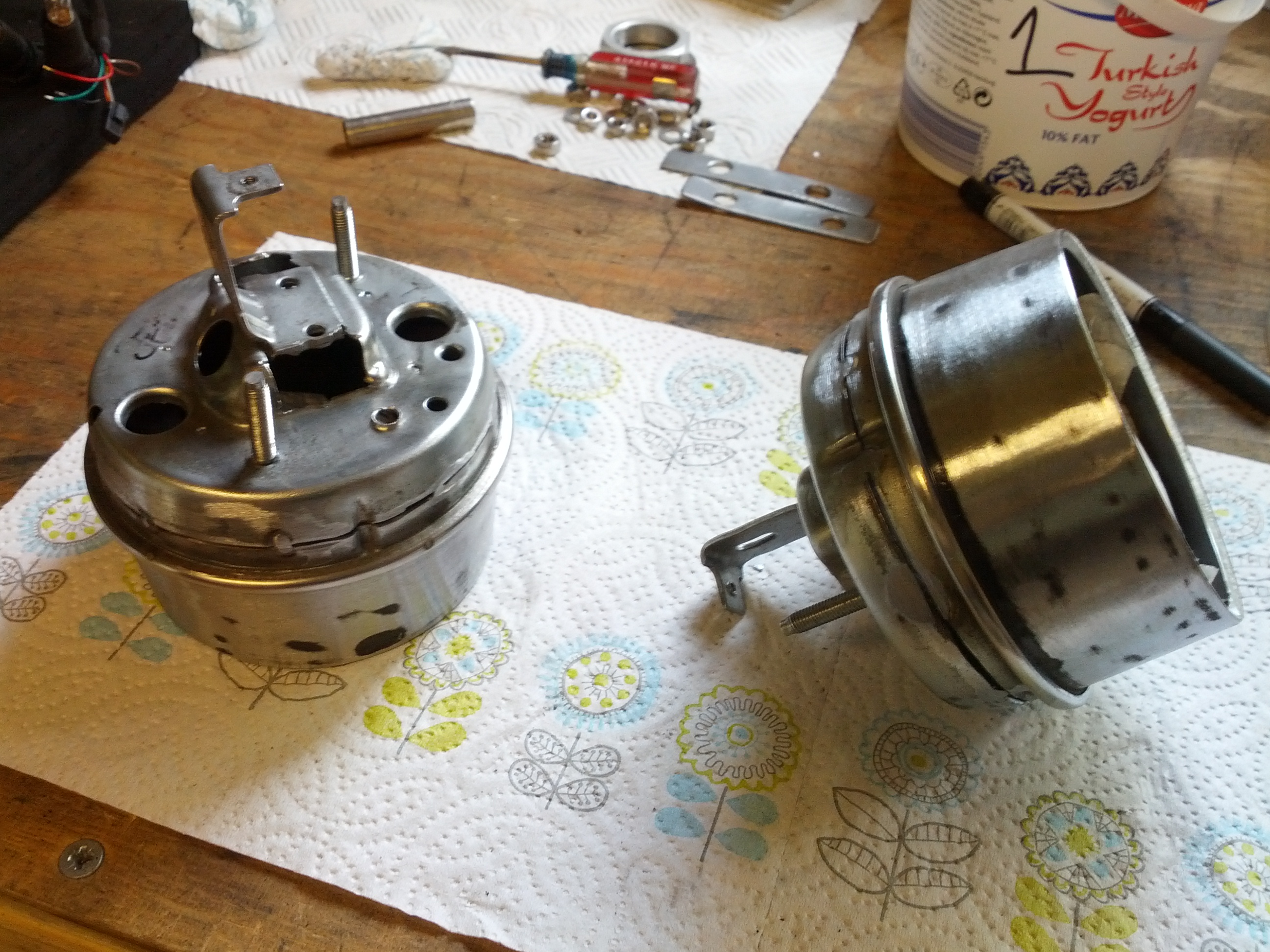

I took the plunge and opened up the original clocks with the angle grinder:
The idea is i am trying to fit the Koso LED Tacho and speedo into the original instrument binnacles
I wont go into detail here but its proving to be a fiddly swine of a job
But i am determined to make it work and look decent.

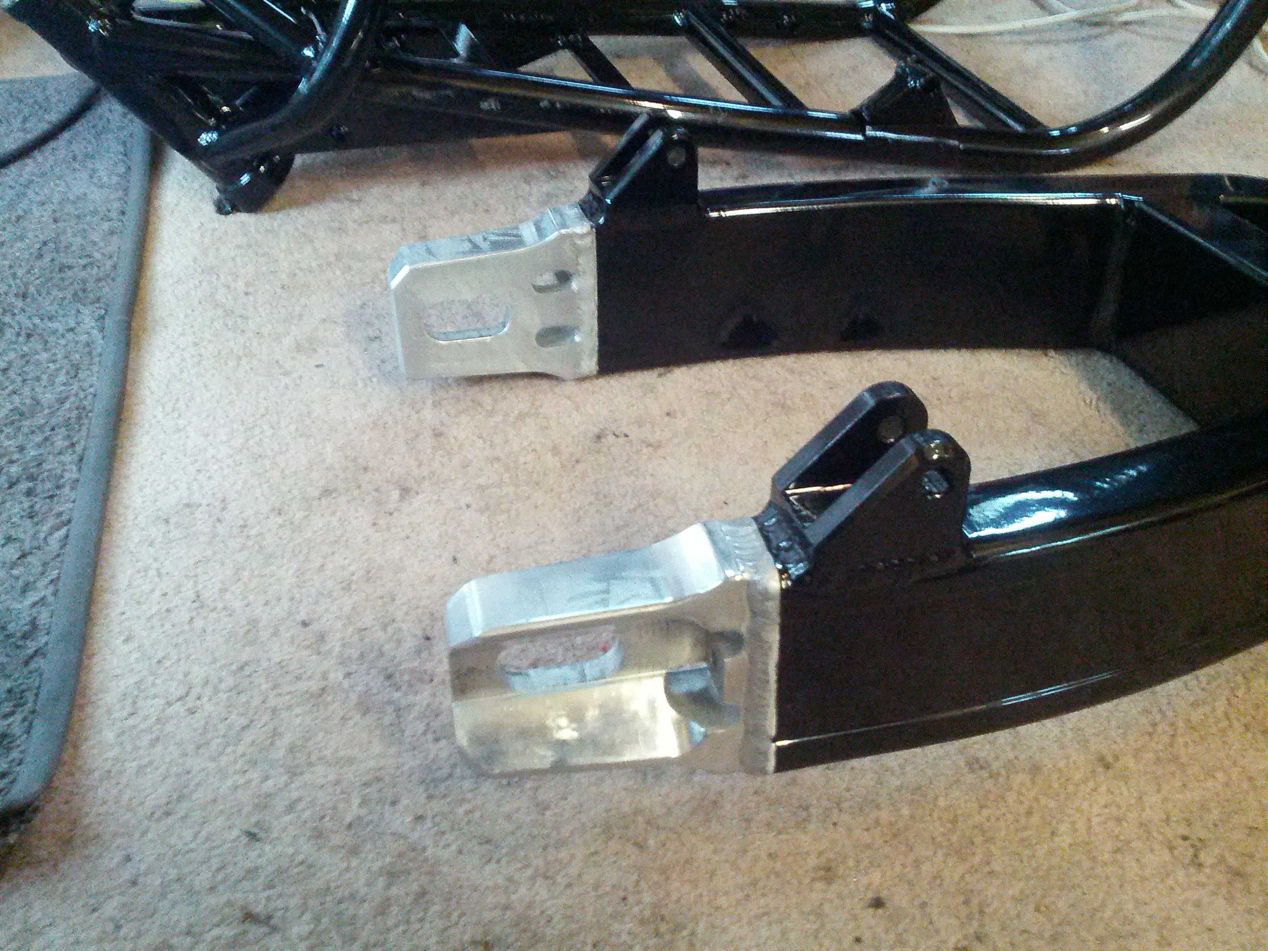

After much prevaricating i designed and had machined some pillion footrest brackets in steel so i can weld to the rear tube in the desired position (where it will fit folded up basically)
I got some cheap Yamaha pegs complete for a tenner off ebay. Came up well after a bit of wire brushing etc:
Locating them on the frame for welding:
Welded on to the frame:

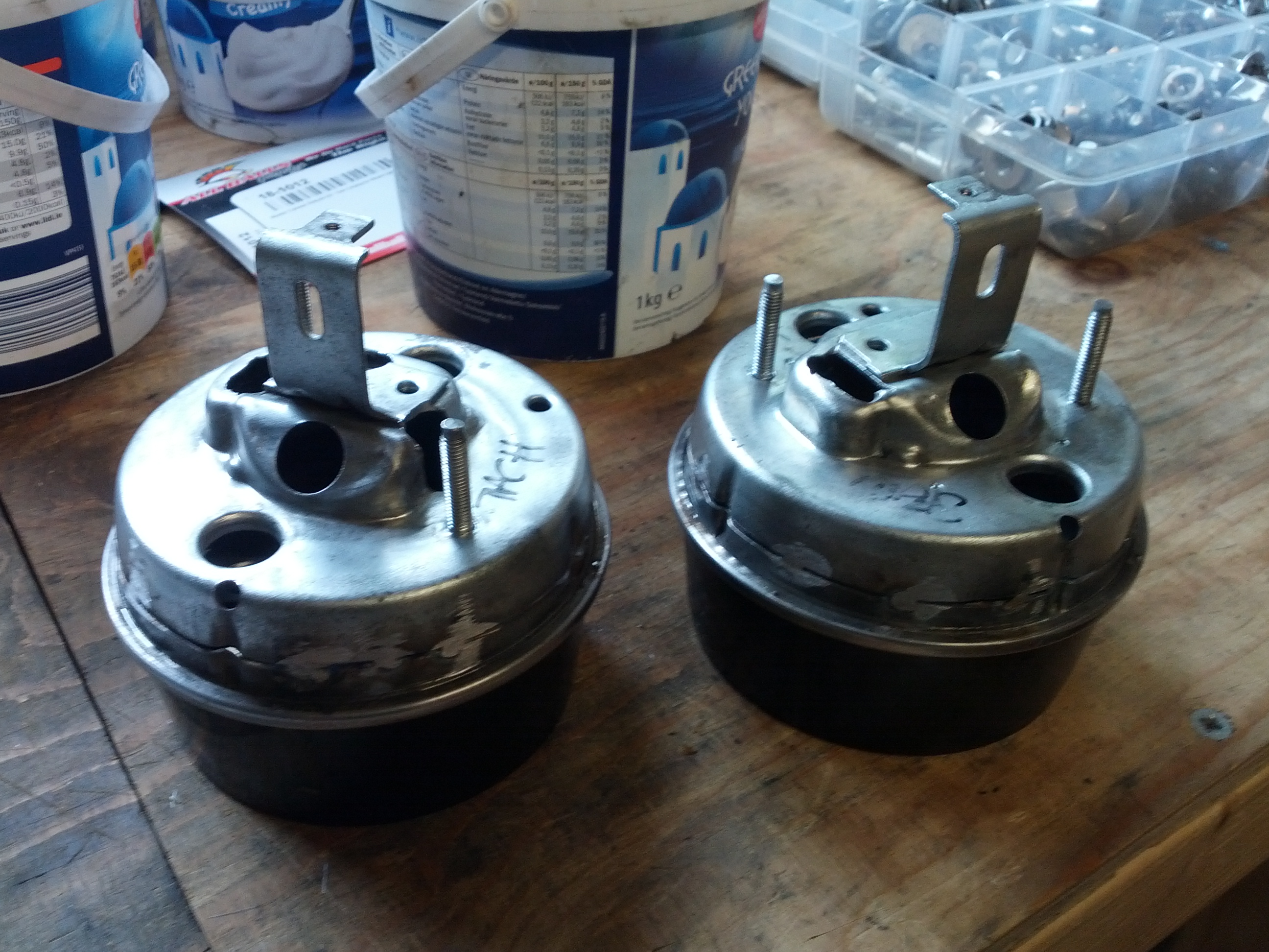

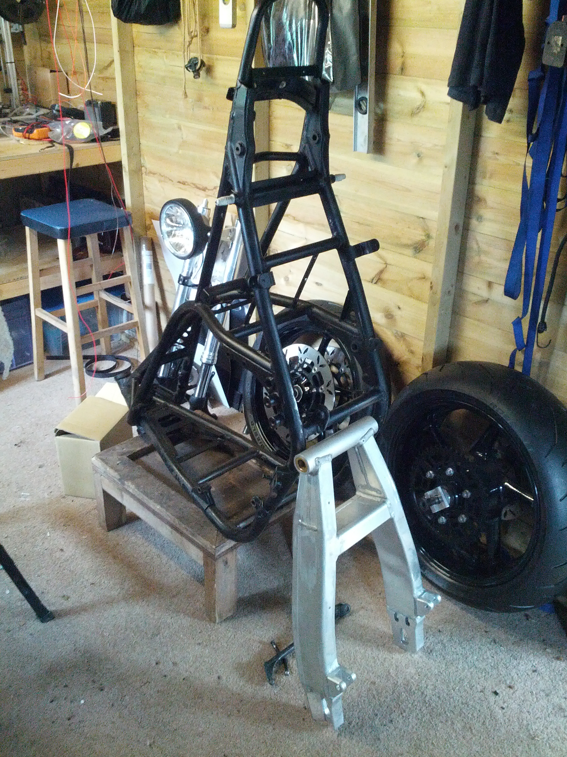

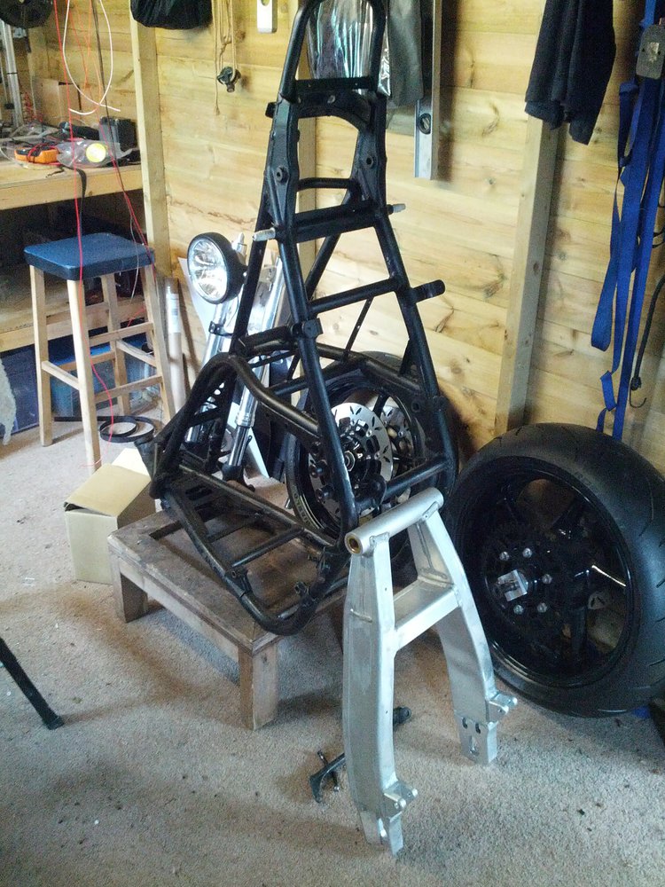

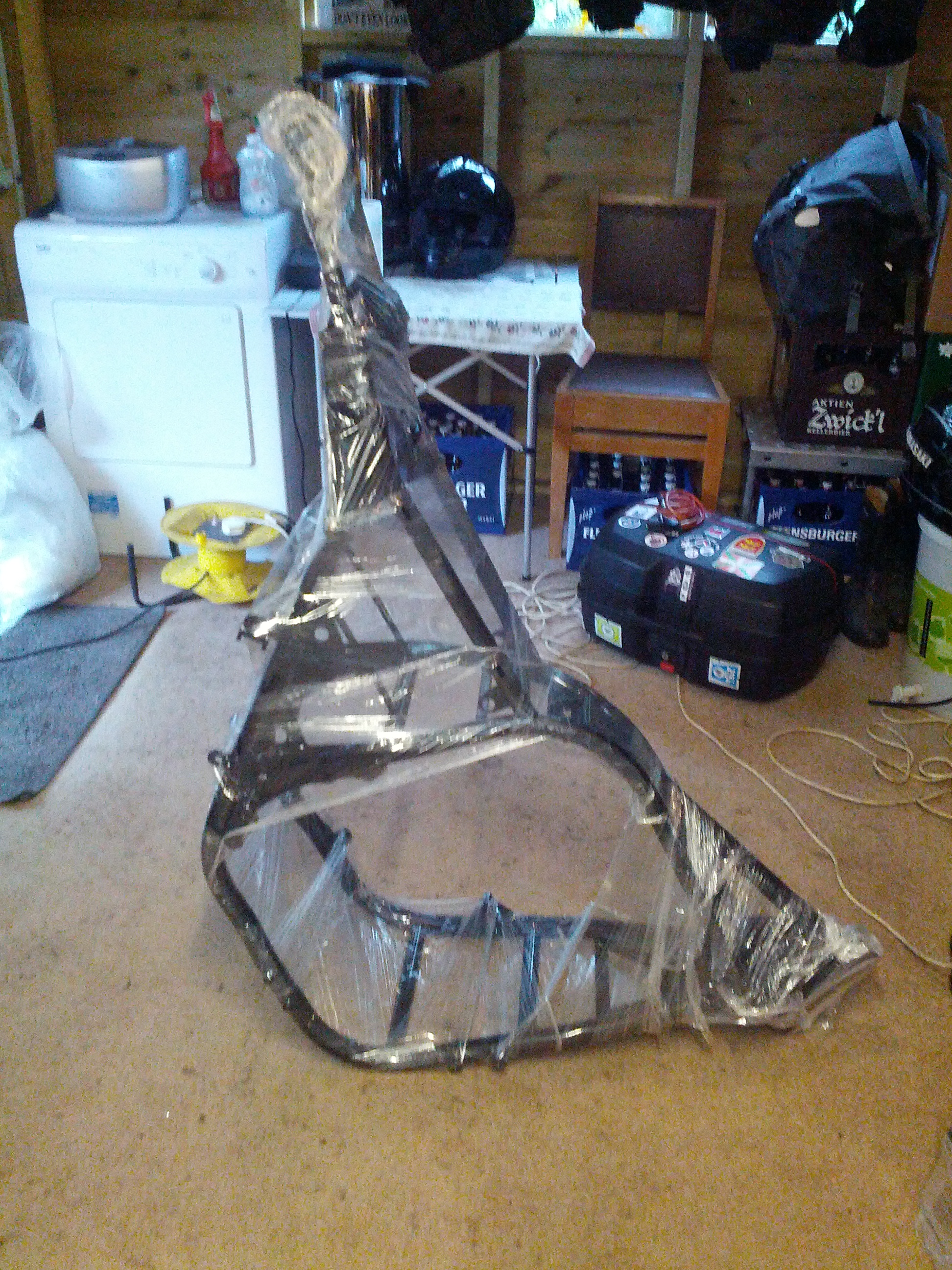

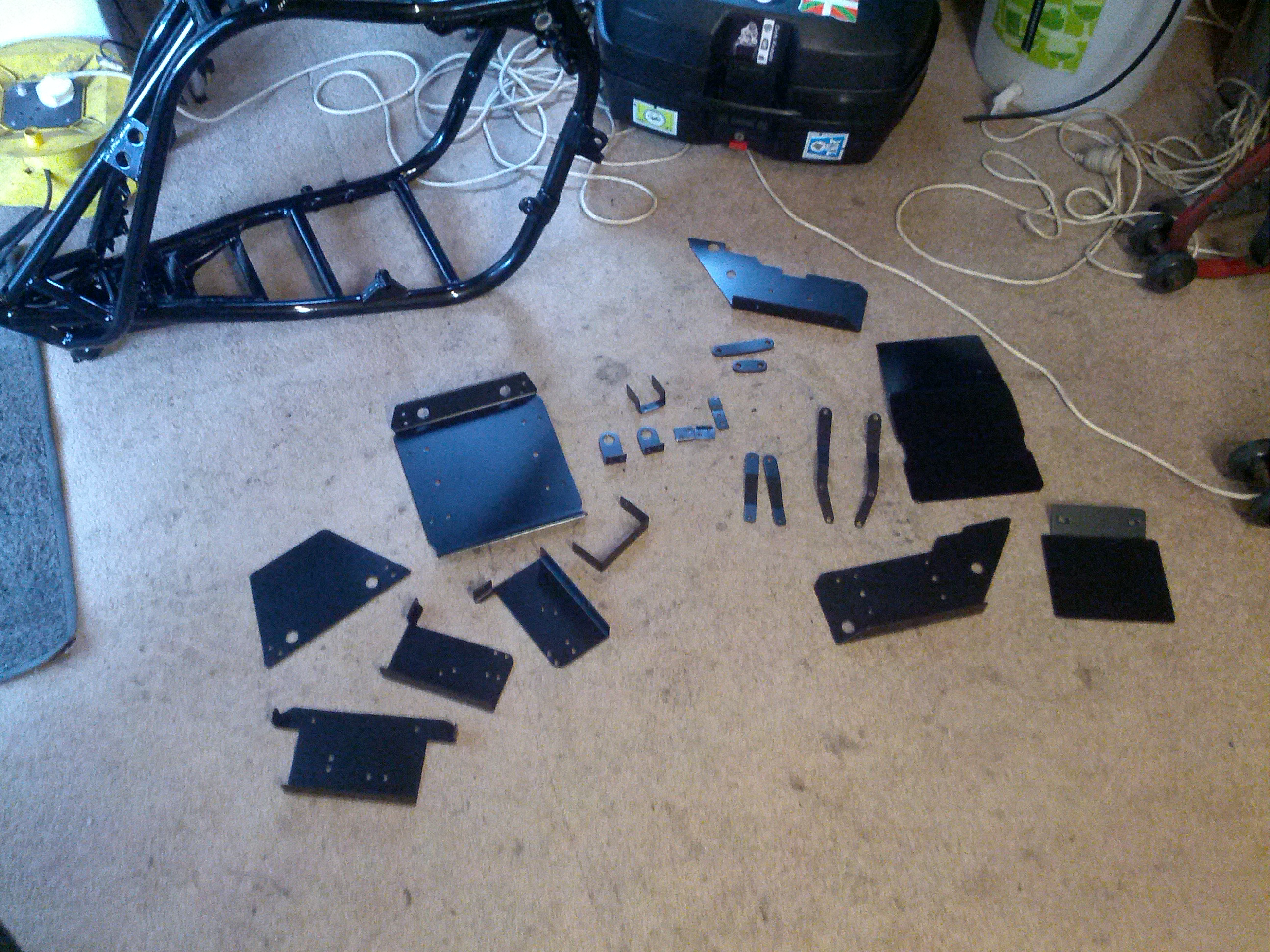

Getting everything ready for blast and powdercoat:

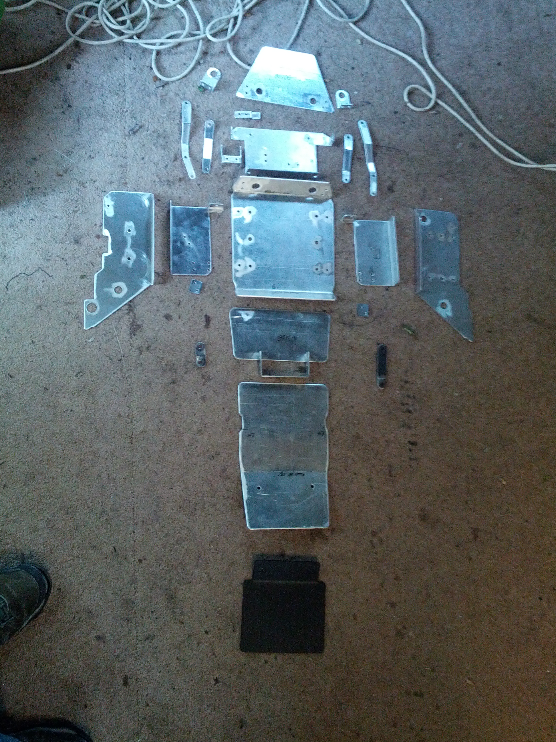

I re-made the electrical box side plates so they would fit the frame better towards the rear and you cant see through into the box behind the side panels.
While waiting for the frame to get done i got on with a few other jobs: Adapting the standard clock housings to accept the Koso digital gauges i bought for the bike:

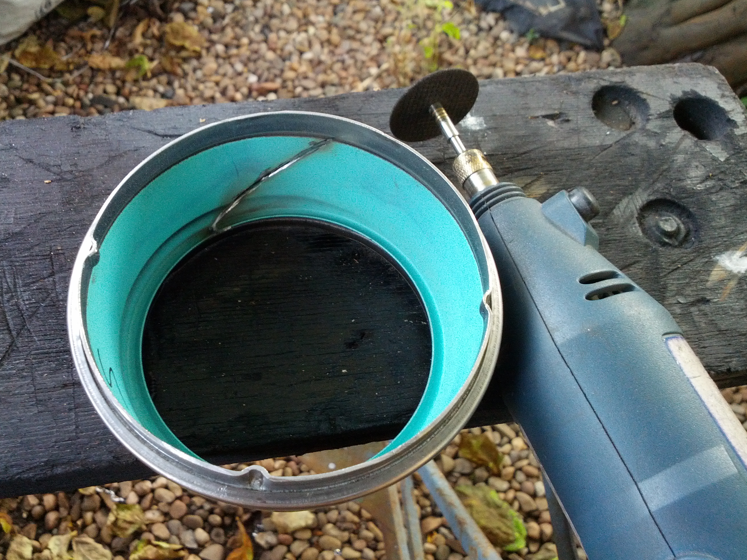

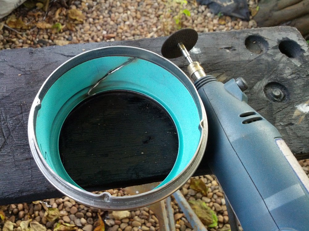

Cutting out the original steel green stuff coated liner was a bitch

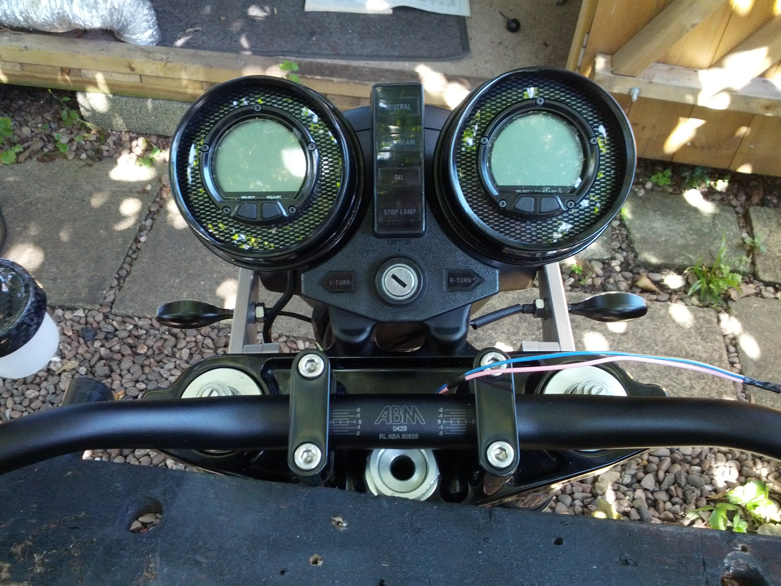

Once i had worked out how to get the new gauges into the housings i could weld (tack) the housing halves back together. It needed 2 of us the hold in the correct orientation whilst tacking.
Housings were filled, sanded and painted with gloss black aerosol and clear lacquered. I had just picked up some more parts from the CNC shop including the headlight/front inicator brackets, so i made up a complete front end and mounted the clocks:
Not perfect but it'll do for now until i come up with a better way of doing it

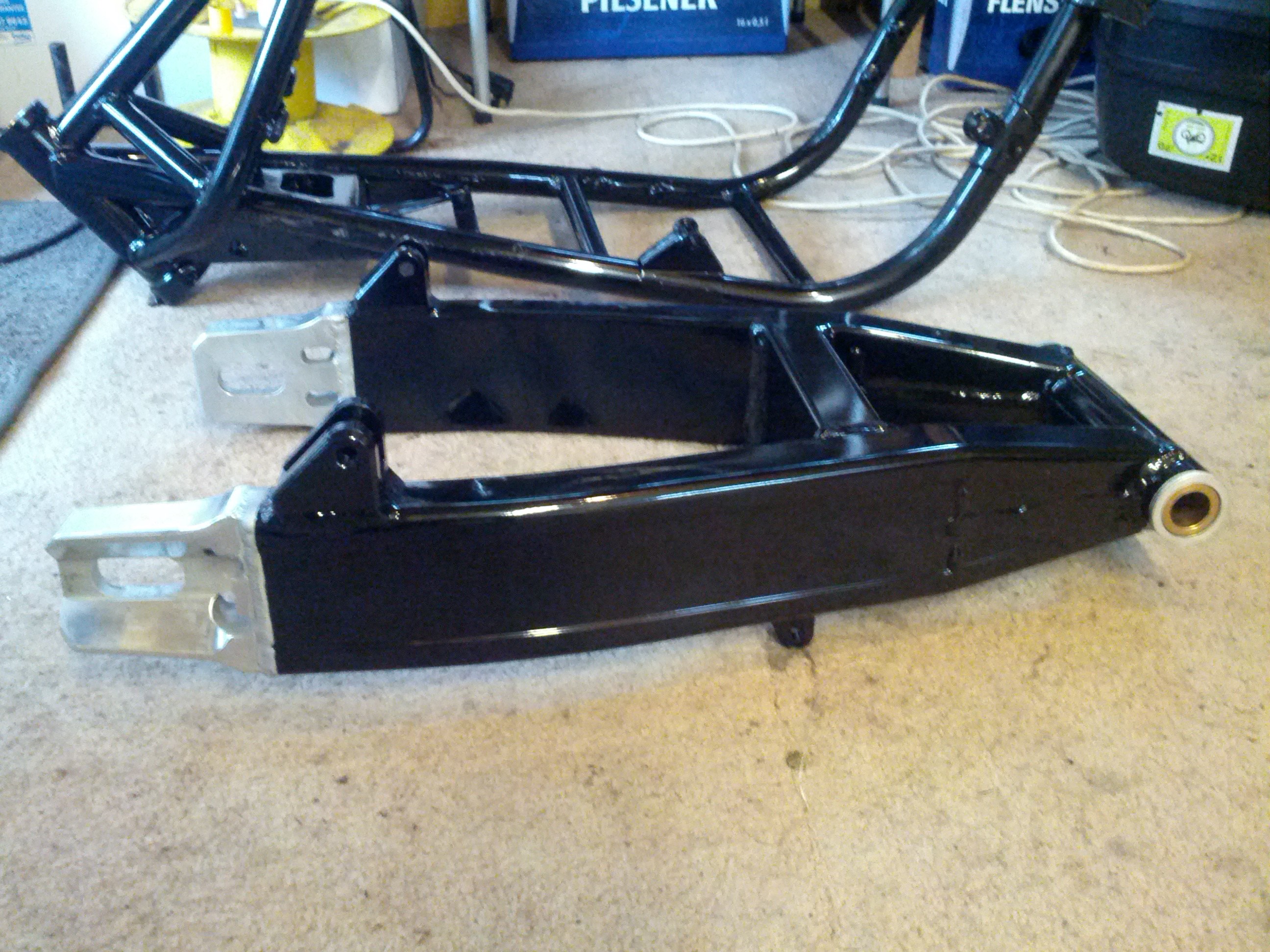

Fast forward 6 weeks (not the agreed 4) and i have some powder-coated parts back:

Powdercoating by Nick @ Griffs?
It may have overrun a little (something that niggles me too) but the quality will be second to none.
Hi GB, yes. Although the overall quality was good there were other issues that had me really not happy at the time. But time is always an excellent cure for most things.....
Don't want to go slagging off people on forums, but their "mistakes" have cost me time and money. This is to be expected on any project of an engineering nature and my own mistakes have cost me on this project too!
The bike is actually complete and running, but still sorting through the small issues as all specials have when you first ride it. I am playing catch up on the thread
