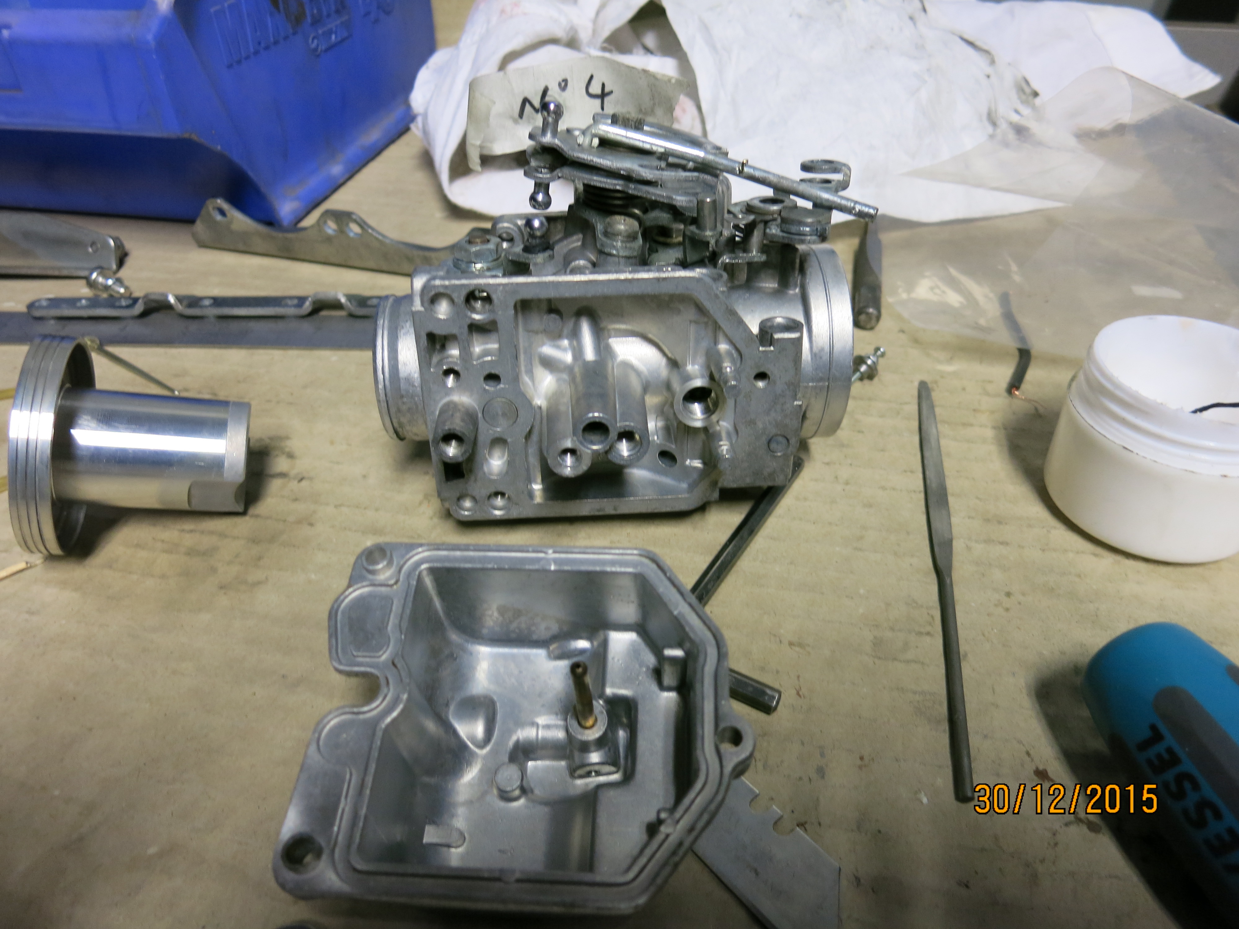

There are 700+ parts to the assembly, all the rubbers are perished, O rings are the same as are the float bowl seals. You can send them to the US and have them overhauled or there are a couple of blokes in the UK that do it, but the backlog is months and the cost is a basic £750 - or more if there are sheared bolts etc.
Ordered a carb repair kit from "Randakks" a specialist in the US who makes the seals etc with Viton - £160. You can get cheaper ones but why take the chance? Hodna use the usual Japanese Industry Standard (JIS) screws on these bikes and these were very tight. A lot of problems are because someone has used a phillip's screwdriver on them and knackered the heads, then the chisel comes out........A new set of JIS screwdrivers from Vessell were ordered, also bought an ultrasonic cleaner, which is a nice bit of kit.
Started to strip them down, each carb was separated and bagged up with associated pipes and connectors, "witness" marks all over the place to show that they had been "worked" on by a dick in the past.
Bank of three, vacuum tap on the top with pipes connected . As with some other bikes there is a scenario when people either replace the part or leave it out and connect straight to the tank tap. If the diaphragm fails (or the valve is removed) fuel is permanently on to the float bowls, then if one of the float bowl valves fail and the bike is on the side stand number 1 cylinder can fill with fuel. Press the starter and the conrod goes through the crank cases. Regular thing, even now, with CBX owners.
Not all the carbs are the same, some have different linkages and pipe work so care needs to be taken about the order of the things. I did one at a time but there are people that can do these in their sleep and strip everything at once.
This is the bottom of the carb underneath the float bowl, the black rubber bung in the middle of the carb hides the problem.
When this is removed it shows the offending pilot jet. The problem is that the holes in the jet are 0.0013" (0.35mm), the jet is fed from one of the larger ones next to it (you can just see the feed hole at about 5 o'clock). The rubber bung stops the fuel draining back to the bowl so the knock-in jet is permanently in a fuel pocket and the very small holes soon get blocked up with varnish and the bike won't idle.
This is a knock-in jet with no way easy of getting it out, The jets on this bike have never been out, some people just soak them in cleaner or blow them with compressed air without removing them. This rarely sorts the problem though, other people screw a self tapper in and try to get them out that way? Bit too rough-arse for me.
I made a little puller out of an M2.5 screw and aluminium collar.
First thing to tap the end of the jet, you have to count the number of turns though or you will damage the holes in the jet - max 8 full turns of the tap.
Screw in the puller;
And the jet pulls out, should have put a ruler in the picture - these jets are so small.....
I made a couple of sets up consisting of a tap, pullers and drifts for knocking them back in and sent them to CBX HQ. This got me some brownie points to use at a later date if needed.
The carbs come out of the ultrasonic bath a lot cleaner, they really are a die-cast work of art....
And the finished articles, it took me two months to do them all. Bench tested with fuel and a couple of leaks so had to adjust the float heights again.

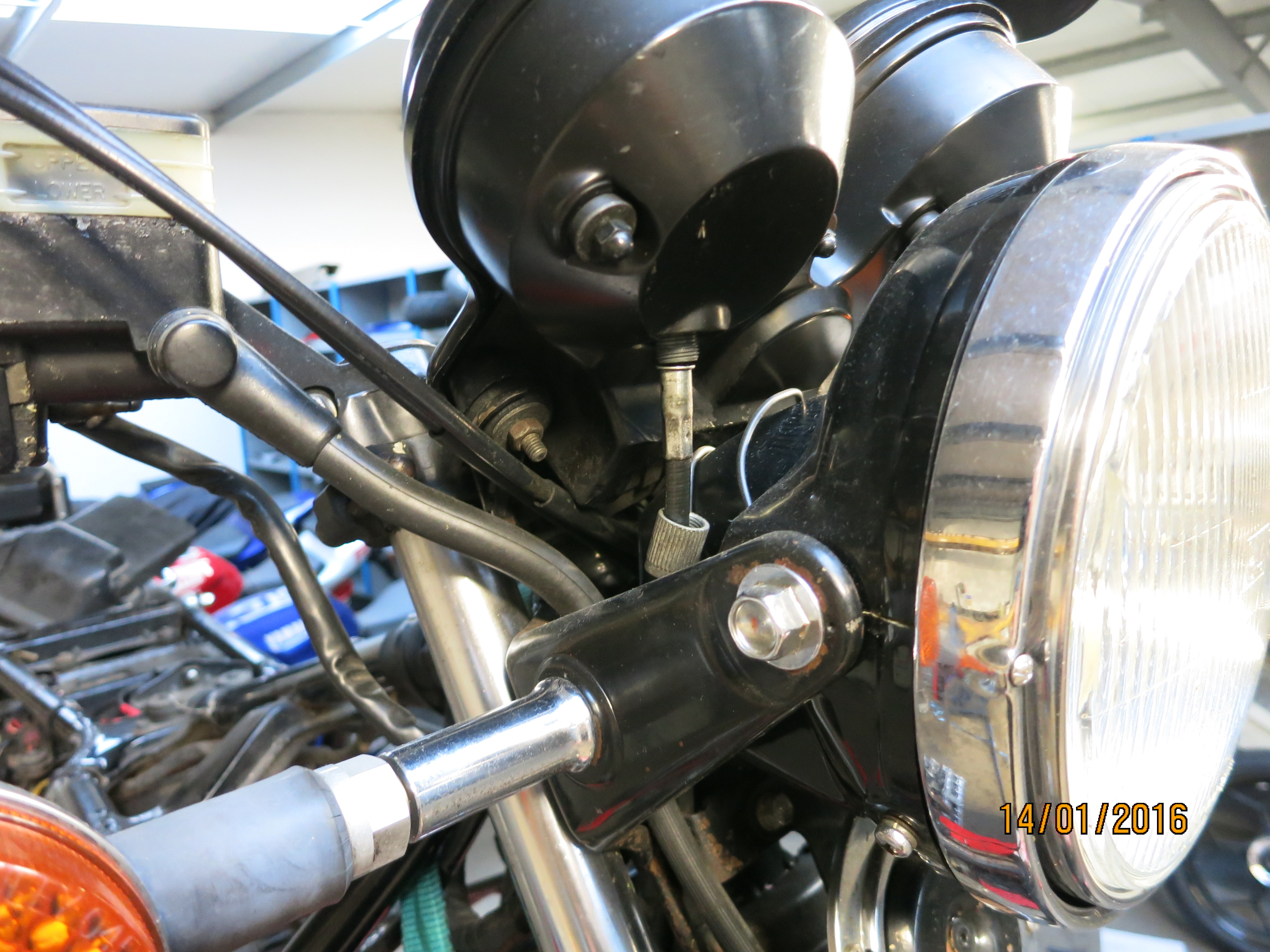

The 1970's electronics were a sight to behold. Again, every spade was removed from every connector block and cleaned
Typical damage to the headlight shell, the cracks from the mounting holes to headlight rim are caused by the rider reaching over the clocks to adjust the beam height. Damage has to be repaired as they are no longer available from Hodna, pattern ones aren't the same - Hodna material is like a plastic / bakerlite? Several narrow slots were cut on the inside of the shell at 90' to the crack, then I dropped small lengths of 316 stainless filler wire into them, filled over them with Loctite 4090 cyanoacrylate gel and dremeled off when set.
Repair is strong and virtually invisible from the outside after being painted.

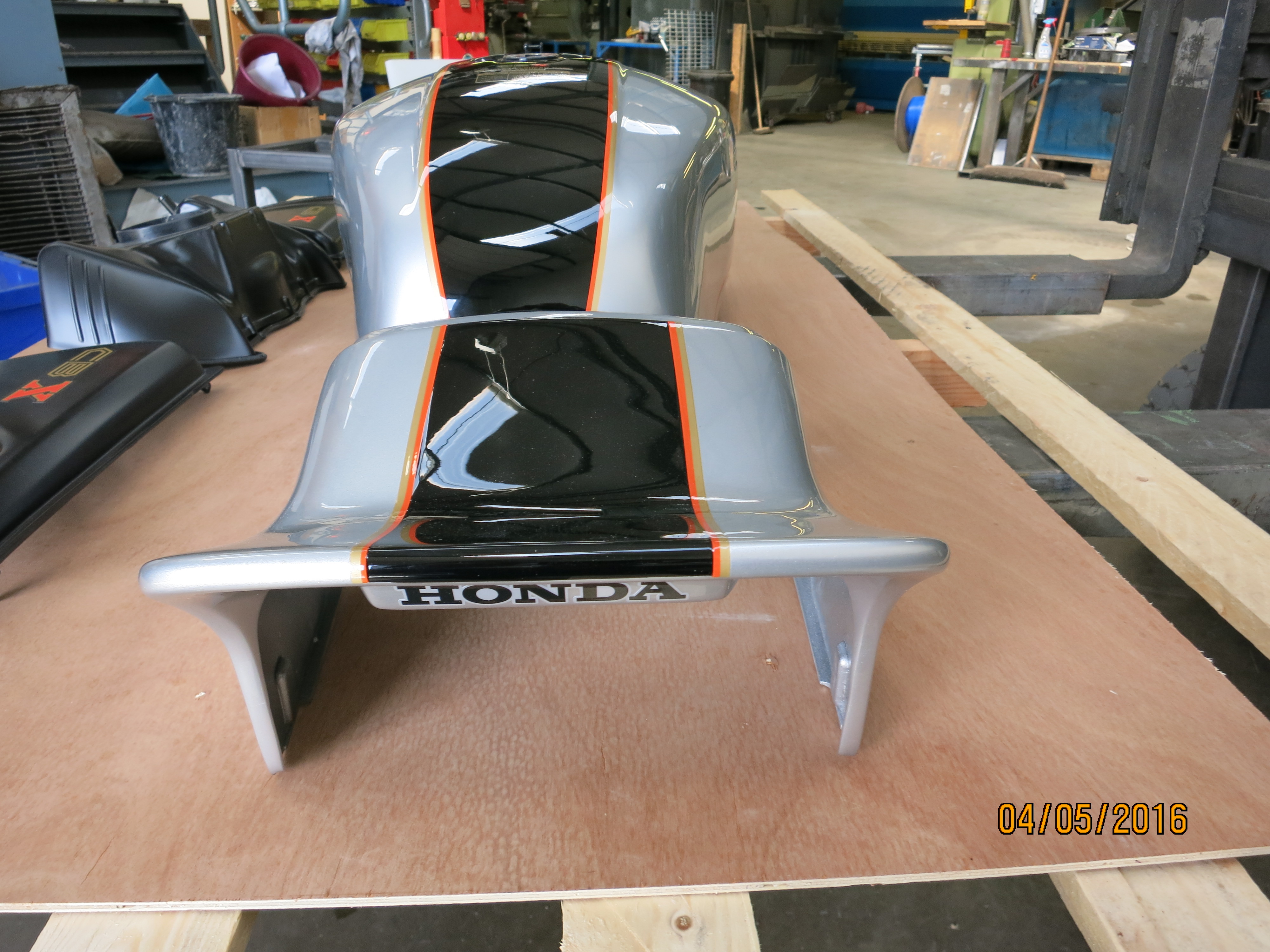

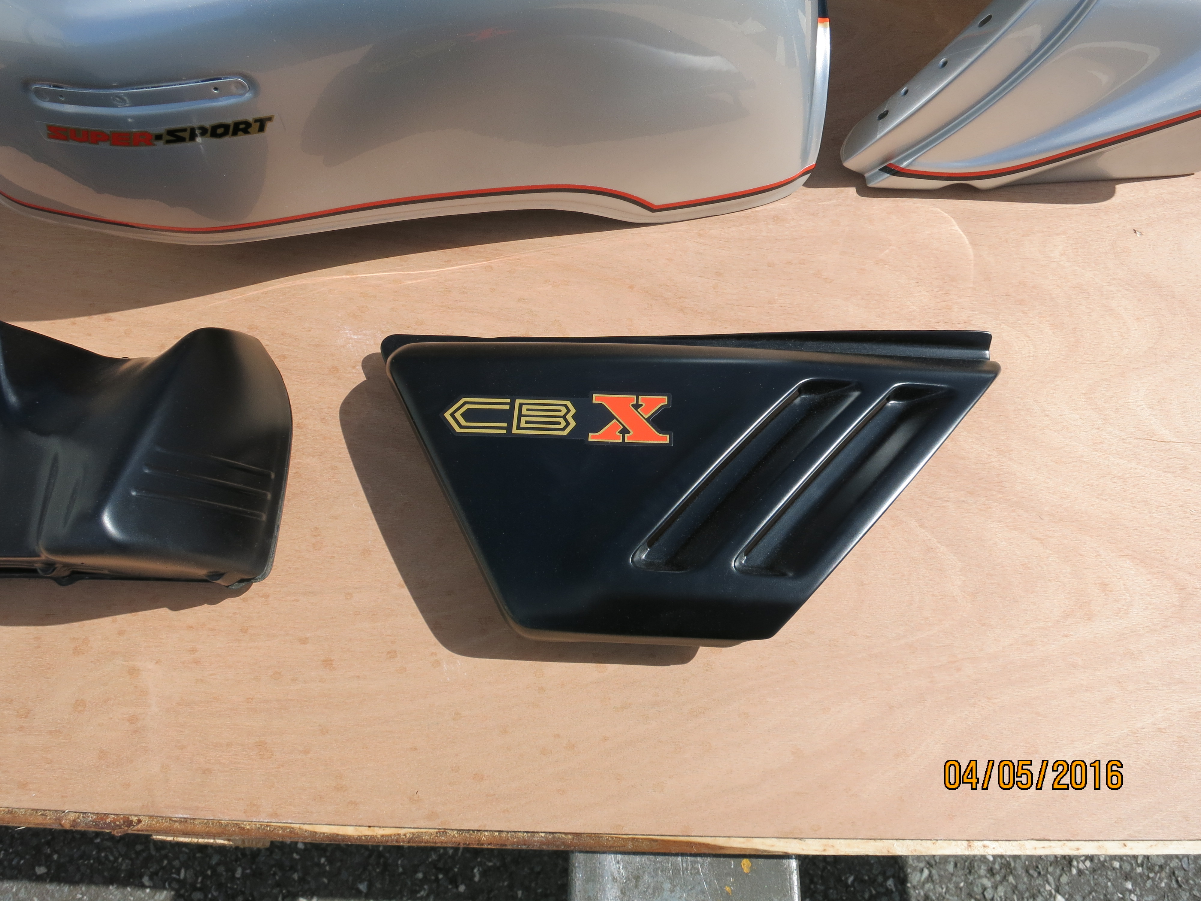

While all this work was being done I was asking round about a sprayer for the tank and plastics.
I wanted someone who was used to doing CBX's, obviously Dream Machine's name was mentioned but they are too hit-and-miss now, I heard that they have 30+ sprayers and all these sprayers can't be as good as each other hence the finished job will depend to an extent on which one you get. I saw a post on CBX site about a lad who had just had his red bike sprayed, nice job. PM'd him and the lad who did the work was only an hour away from me in Ormskirk, near Wigan.
Had a trip up without the parts to have a chat, he was just a 2 man band working out of a small unit on an old farm. Didn't advertise, which was good as he didn't need to, and specialized in 70's Candy stuff on H1's and 2's etc. He had some clients stuff finished ready to collect so I could look at some of his work, job done.
Dropped the stuff off the next week.
I um'd and ah'd about changing the colour to the red (I do like the red), but decided to keep it as close as I could to original spec.
He stripped it, pressure tested and did the paint on the tank, plastics and panels.
One of the side panels on the bike had a repair to a sprue so it took six months to find another good Hodna one (pattern one's are available but are not the same), the freshly sprayed side panels also made the other black stuff look a bit plop so I had to send them up to be done as well. Also had the headlight, back of the clocks and rear mudguard done.
If it's possible I like to do all the work myself, but this was way beyond me I'm afraid. I am well pleased with the result and glad I didn't try to do it. Credit where it's due, he did a great job and I've put two, maybe three, full bikes from other people his way........which is why he doesn't need to advertise.
