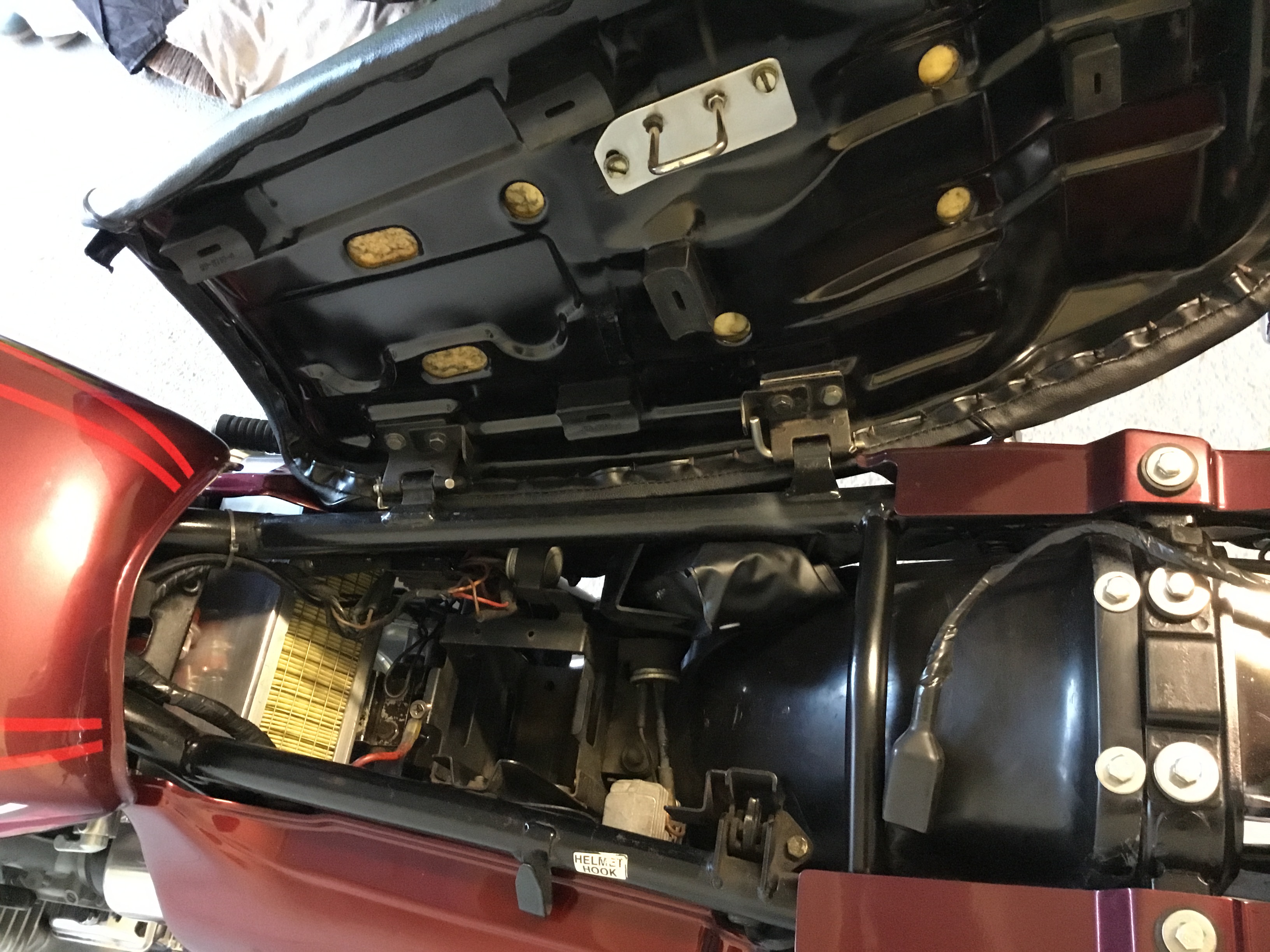

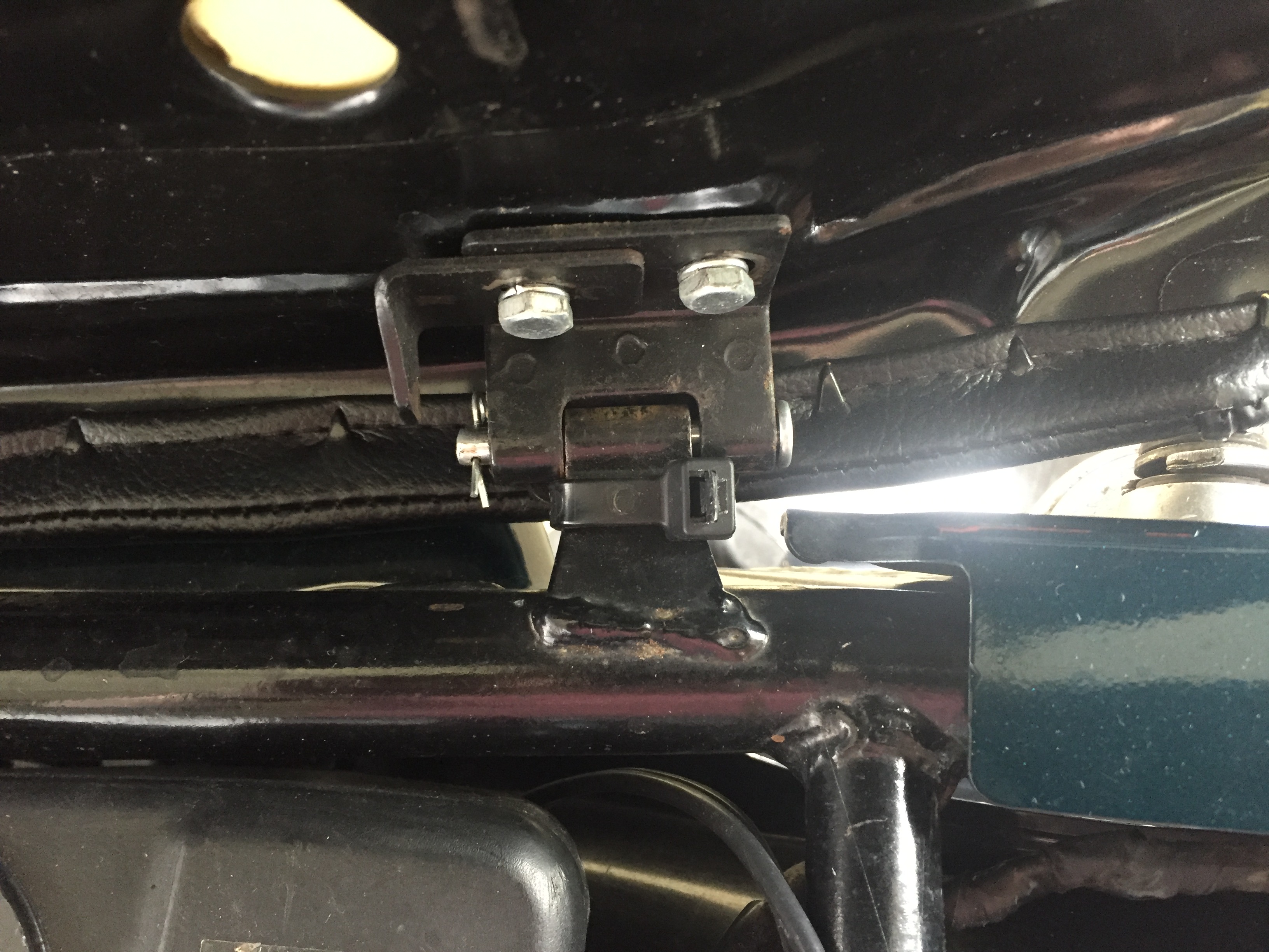

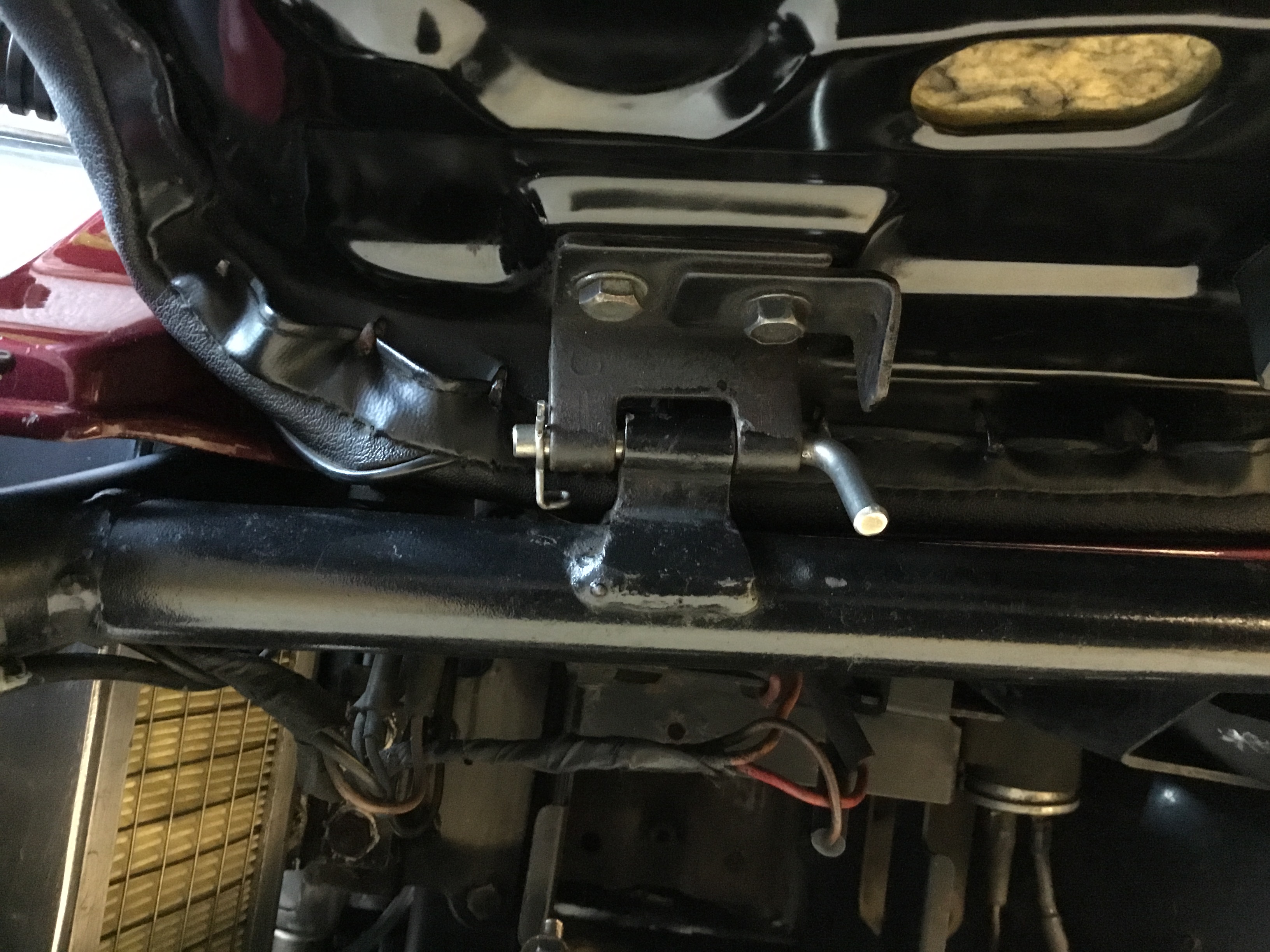

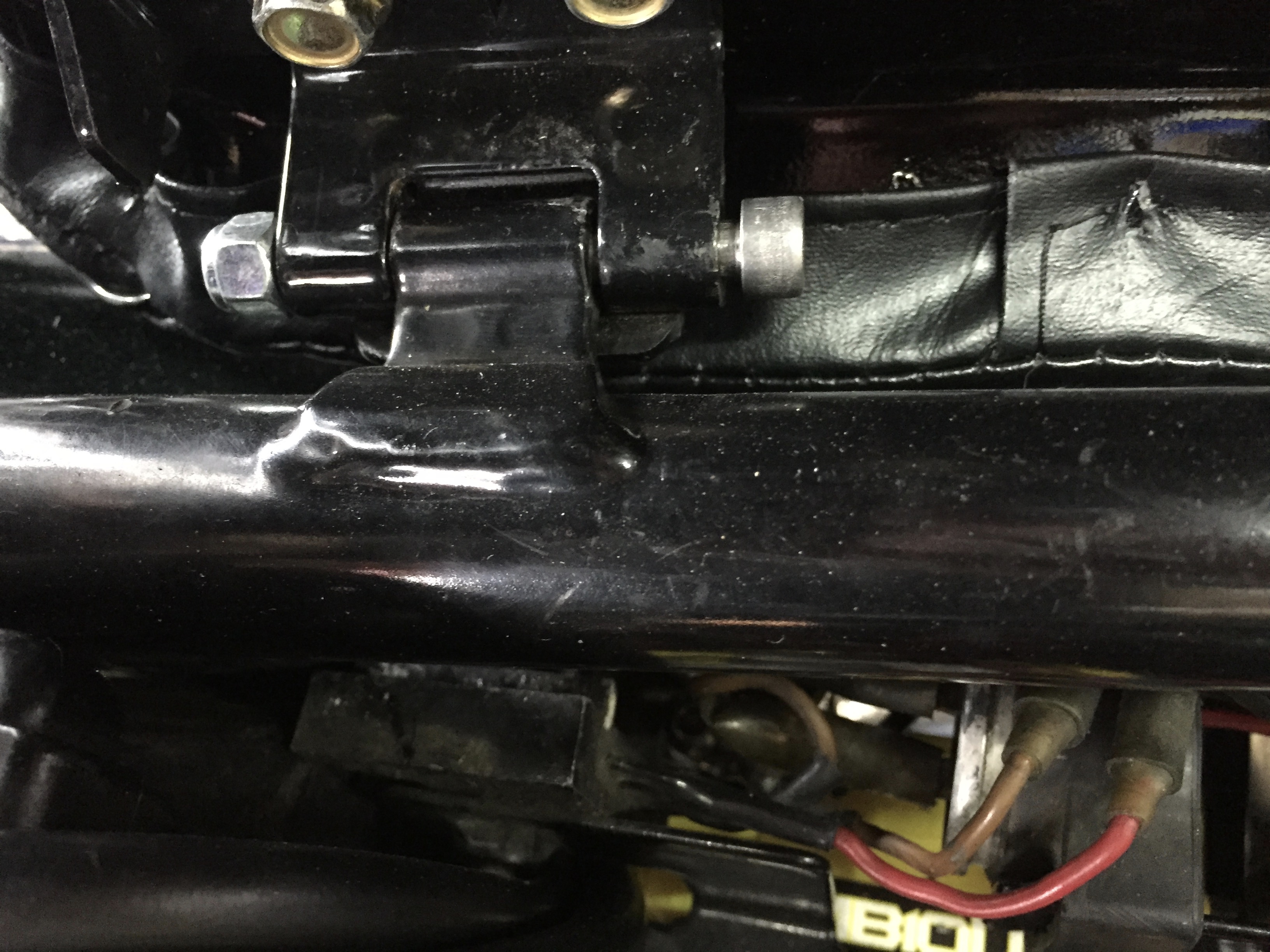

#6 PostAuthor: 1975-S1C » Tue May 01, 2018 8:18 pm
I never did get to the bottom of this, and my seat still sits on the side panel when it’s fully open, which I don’t like.
Could someone do me a favour and post up a close up picture of the hinge and how it should prevent the seat from touching the side panel please. Maybe I’m dim but I still don’t see how it’s meant to work. Or maybe my hinges aren’t right.
Cheers in anticipation of a photo
Paul

One of seat hinges has about 3mm of metal protruding from it which hits the underside of the bracket on the frame stopping it from opening too far, you can just about see it on the rear hinge of the Brown (great colour) bike picture and on the front hinge on Taffus's pictures, not the best set up which is probably why Kawasaki added the stay to the Z1000.

#15 PostAuthor: 1975-S1C » Wed May 02, 2018 7:21 pm
Nope, I’m none the wiser. I can see nothing about my hinges that would prevent the seat from hinging right back.
Maybe I don’t have the right hinges ?
