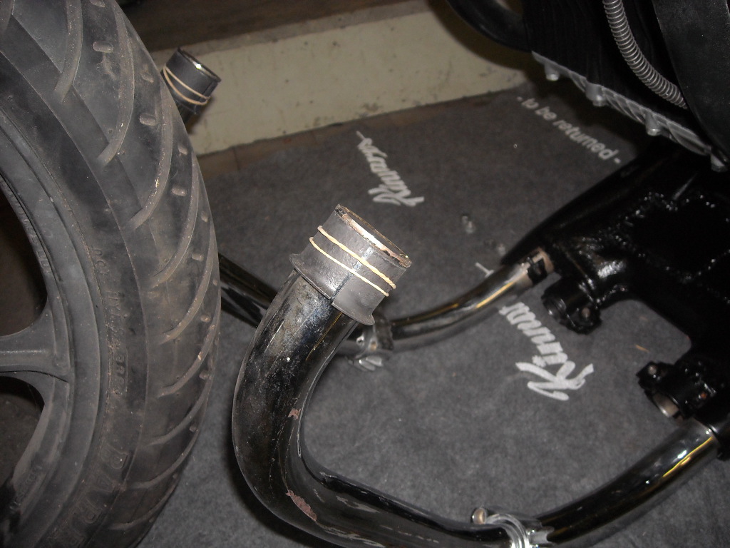

When putting the headers on, trying to hold the shells, the copper rings and mounting the exhaust crowns all at the same time, I often wished I had four hands but I don't so I use rubber bands to hold the shells onto the header pipes. After mounting the exhaust crowns they're removed by cutting them. A simple trick but very usefull.
the rubber bands on the shells

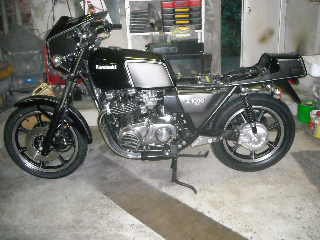

It starts to look like a bike instead of a jigsaw puzzle. A few more details need attention but I'm ahead of schedule.
left side view
left front view

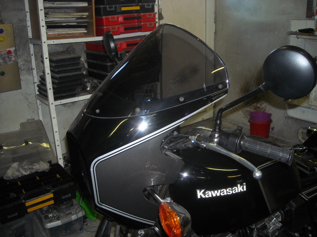

The new windscreen
A new replica windscreen for the Z1R fairing...

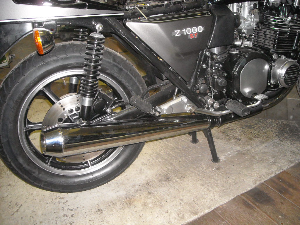

replica silencer
and a new replica Z1R silencer from Germany

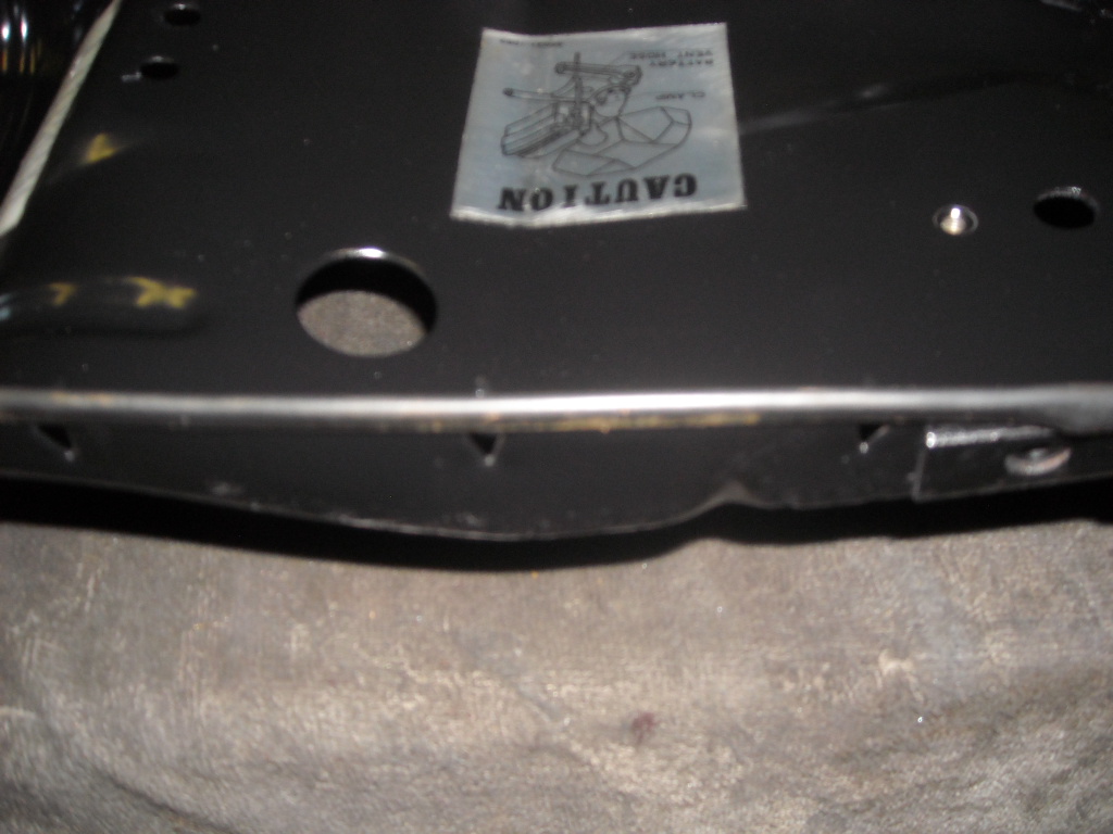

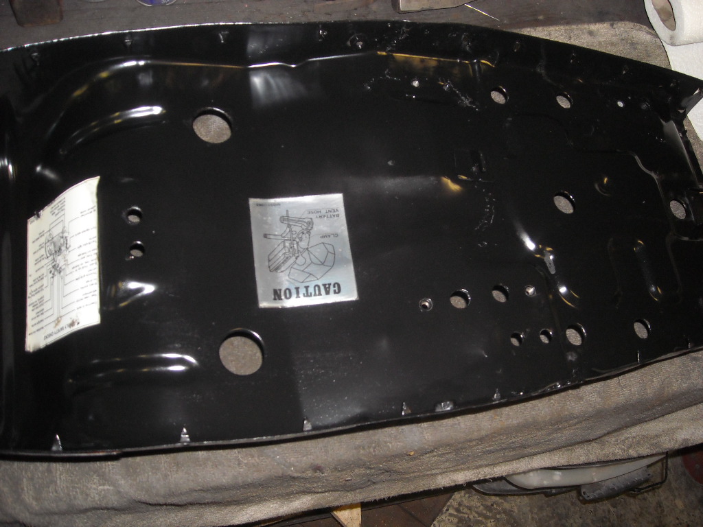

Yesterday the temperature was high enough to paint the seatpan. Allthough not high enough for drying so I took it inside for the paint to cure.
This morning the paint was dry and I was able to continue the work.
the painted seatpan
As you can see I was lucky, the original stickers were in good shape so I taped them off and I could preserve them.

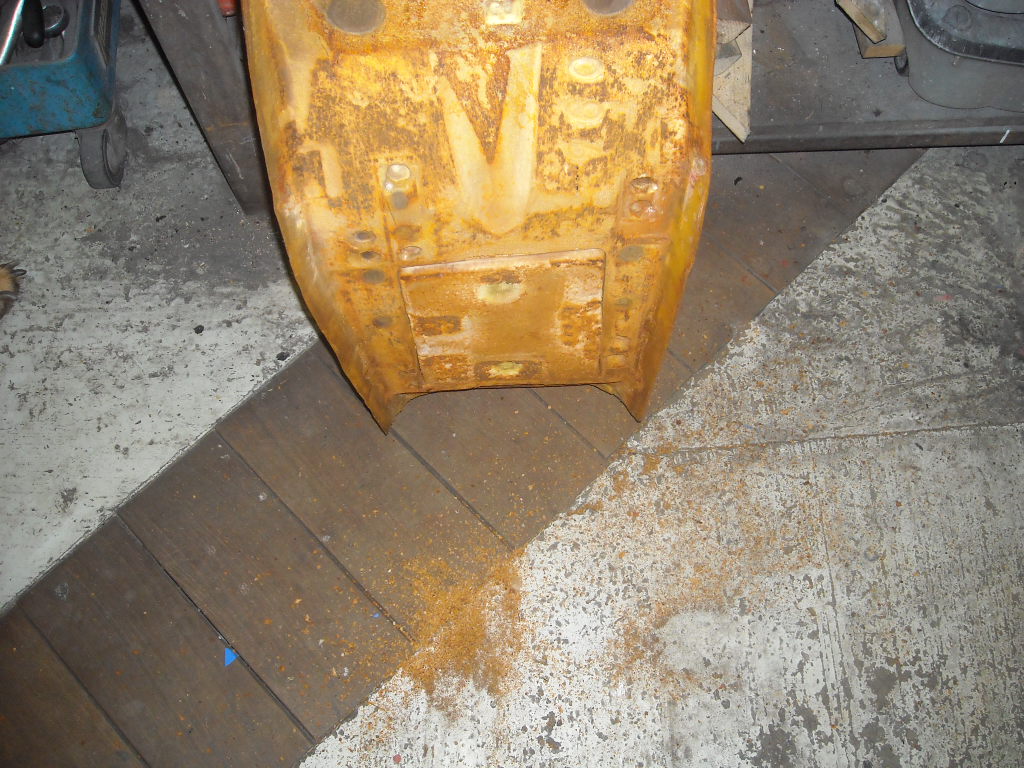

Next it was time to remove as much rust as possible from the bottom of the foam .
It's necessary to remove the rust, otherwise your seatpan will start to rust again, it's contaminating!!! :wink:
rust removed

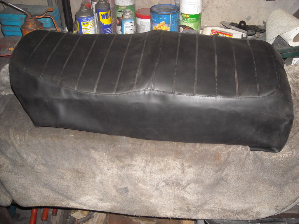

Now came the tricky part: putting a new seat cover on.
Try to put the cover in the centre of the foam, attach it on the front and the rear and make sure it's in the right place.
Once it's in the right place I start in the middle and work left and right to the front and to the rear of the seat.
the seat cover

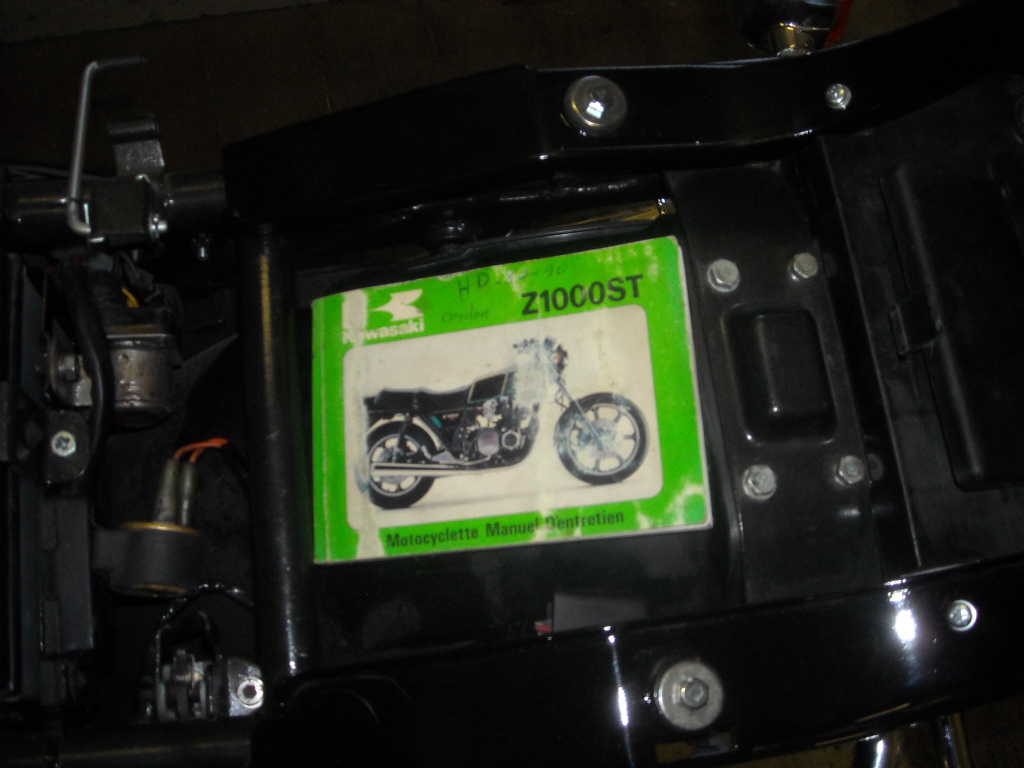

the place to put the owners' manual
At the bottom of the tail cover there's a place to put the owners' manual.
the French owners' manual
The one I have is in French, better than none.
