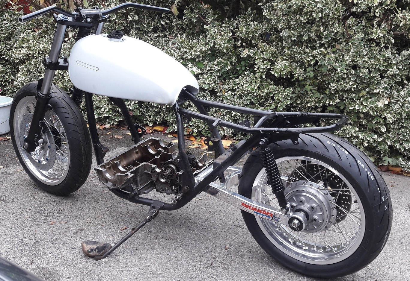

Managed to spend some time on the project over the last few days. I'm now on two wheels.
Re-cap on how bike was when purchased.
Progress as of today

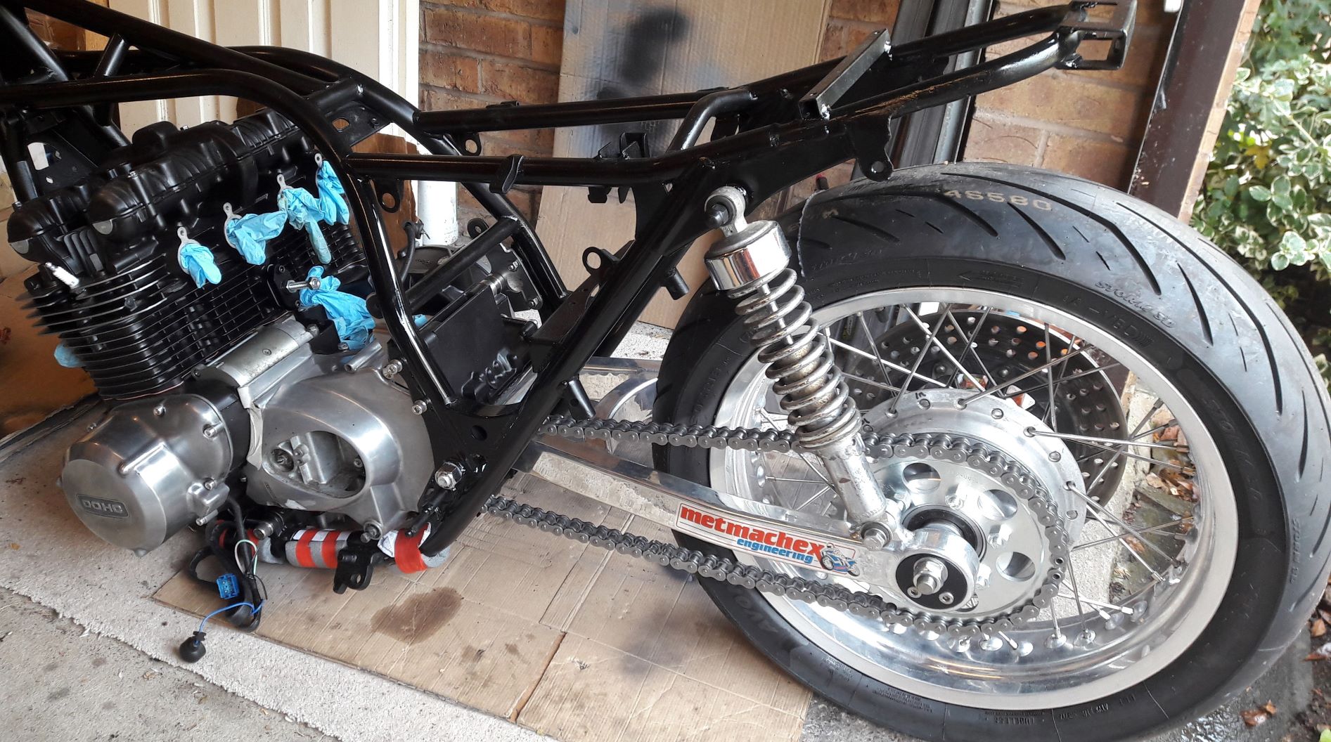

Just had the frame strengthening kit welded into place. Looks like they did a great job.
Checking alignment of chain and sprockets and clearance on frame....

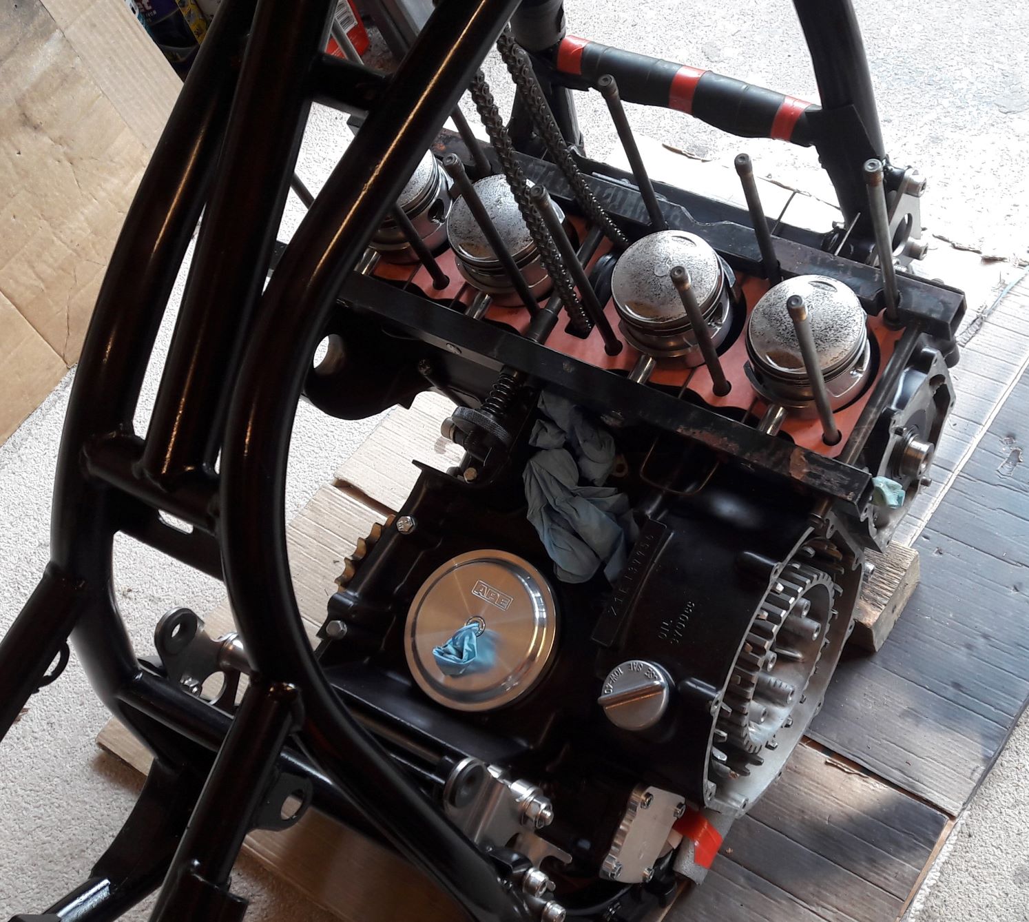

#24 PostAuthor: kawasaki_man » Sun Sep 09, 2018 7:06 am

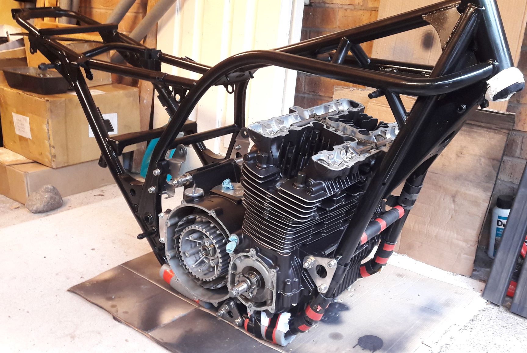

Some photos and comments on progress with the engine over the past month or so.....
The start....
Lifting handle and bar used to make the job of getting the engine back into the frame trouble fee without damaging the paintwork.
Piston ring compressor tool, despite being for z1000 did work OK with some special care. Note that the tool had to be used back to front due to the frame strengthening bar being in the way for the tightening knob.

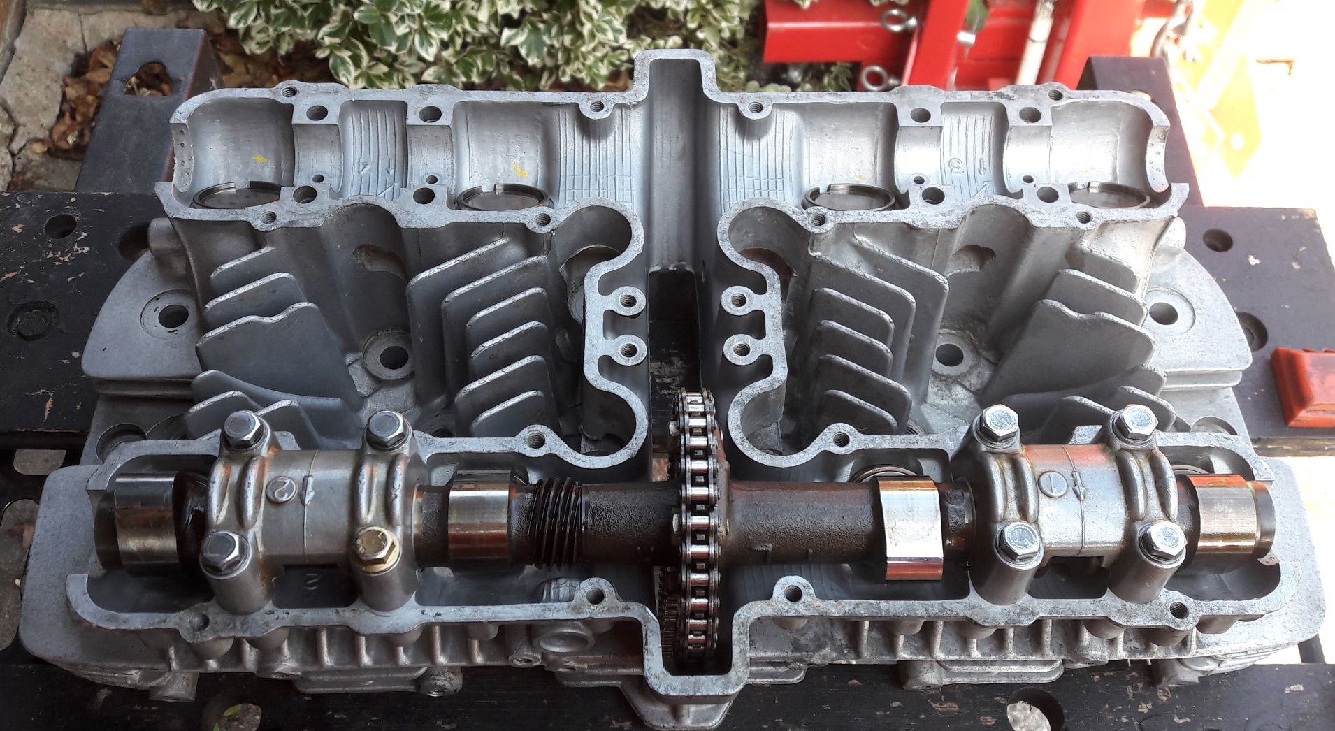

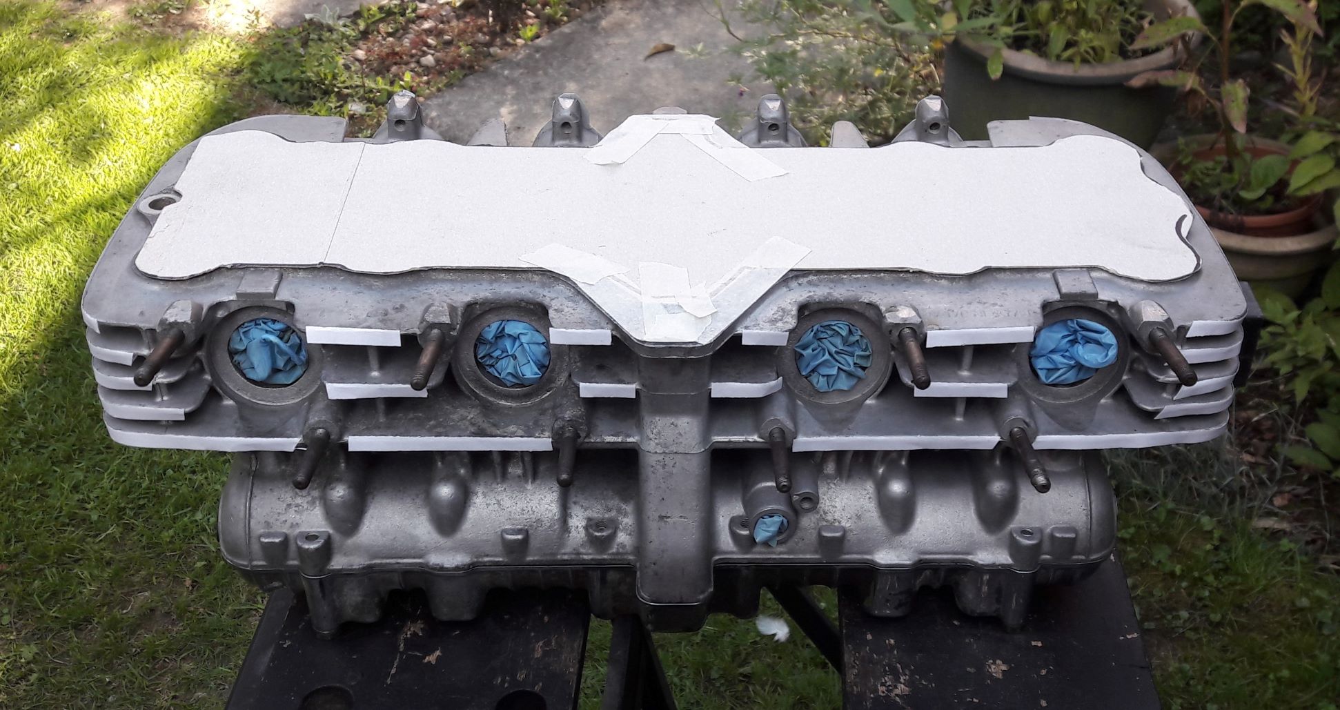

Just got the head back from SEP, new valve seats and guides. Checking the valve clearance before painting the head or putting head on engine.

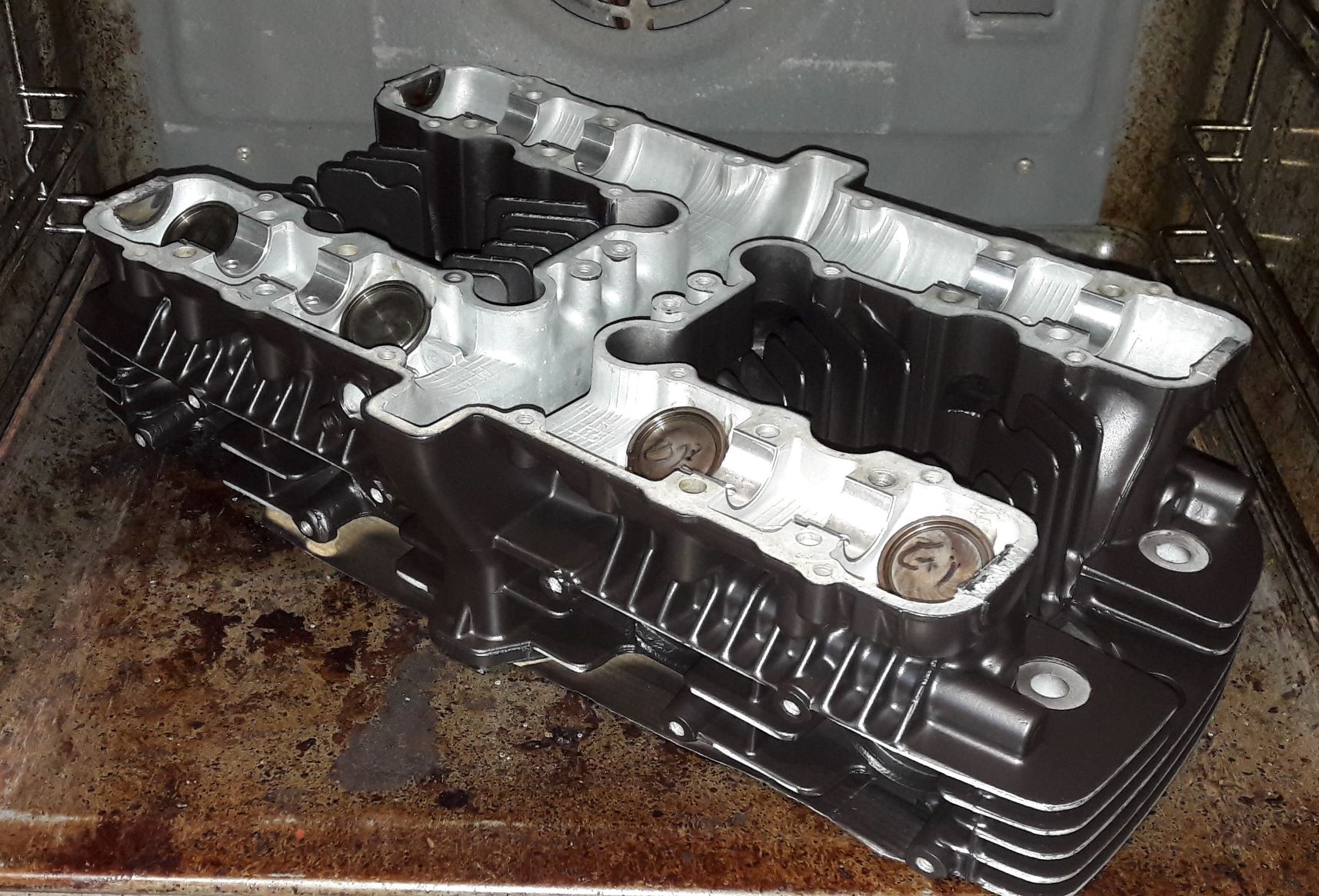

Last of the summer heat, needed to get this painting done last weekend, outside temp was 24 degC.
Underside done....
Head now completed and ready for cooking, luckily wife was out so perfect for cooking bike parts!
Head now on....so can concentrate on the rest of the rebuild.

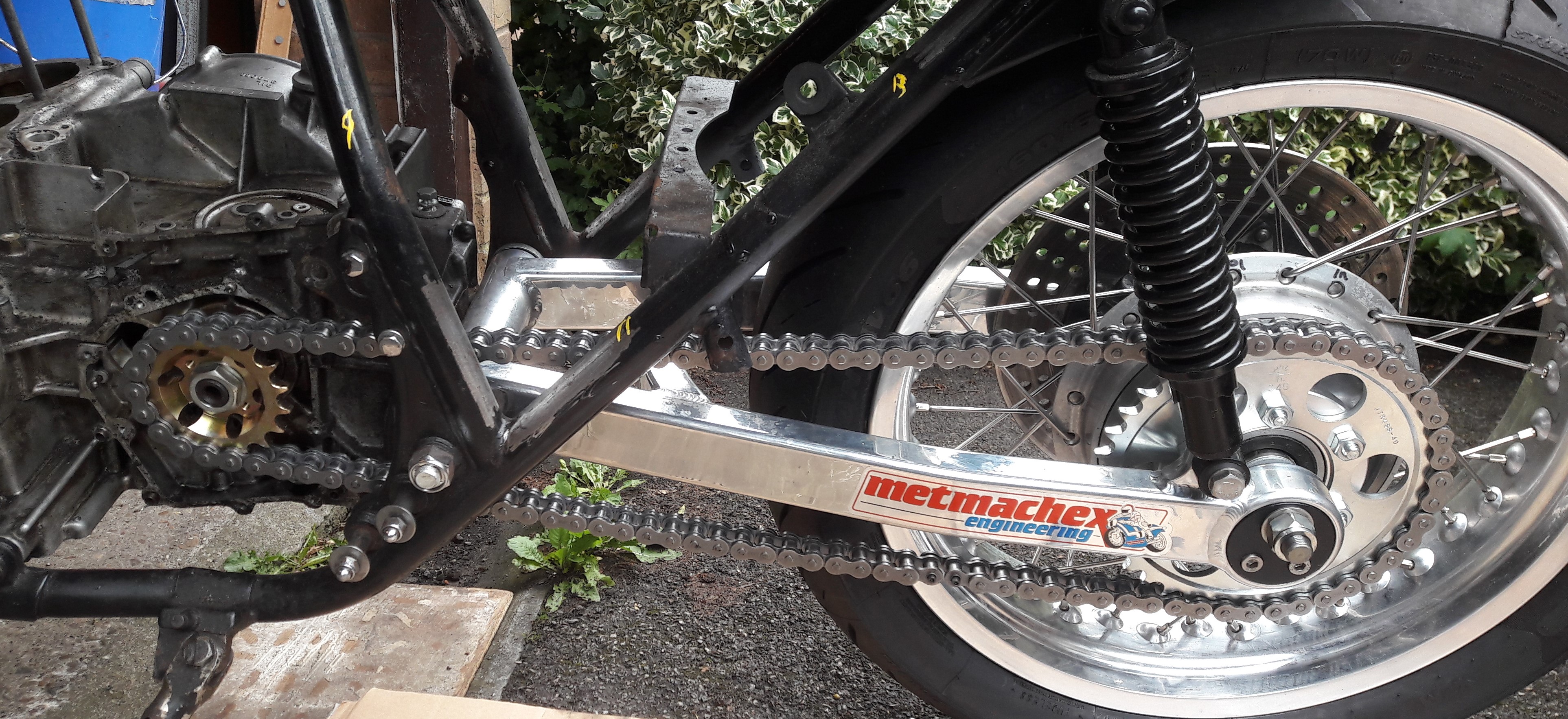

Some updates for progress on project over last 6 weeks.
Checking chain clearance with gear change cover after removing excess internal casing material.
