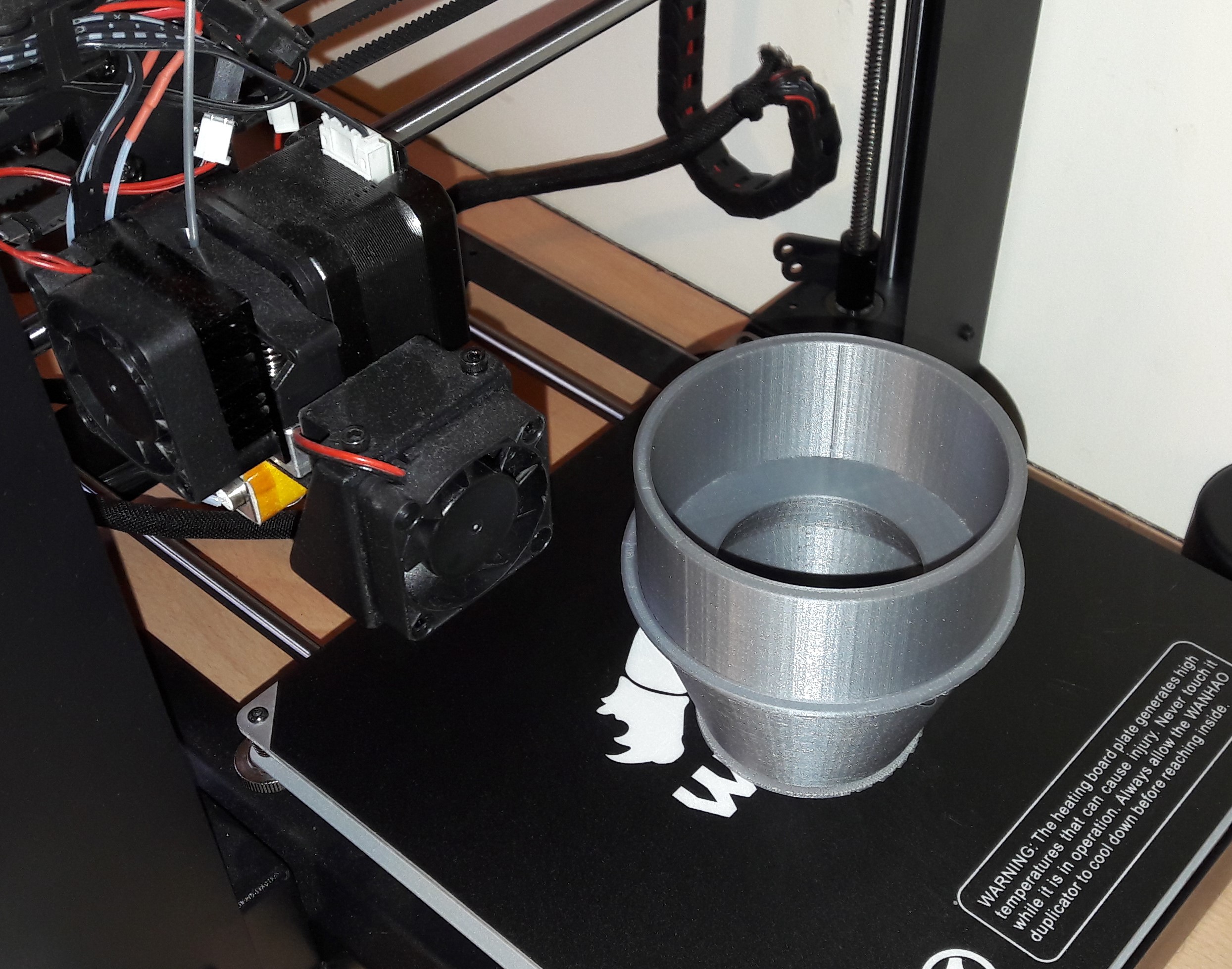

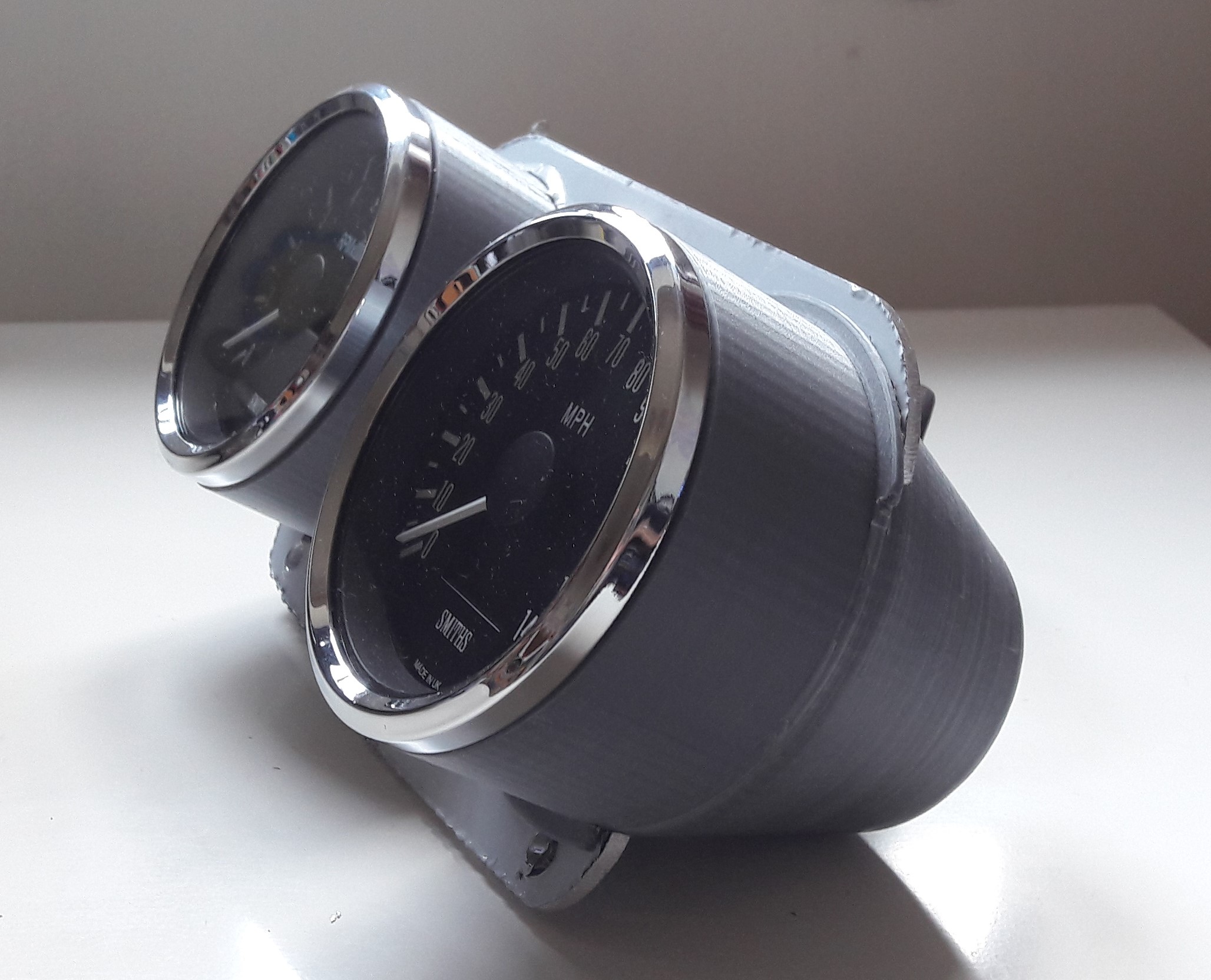

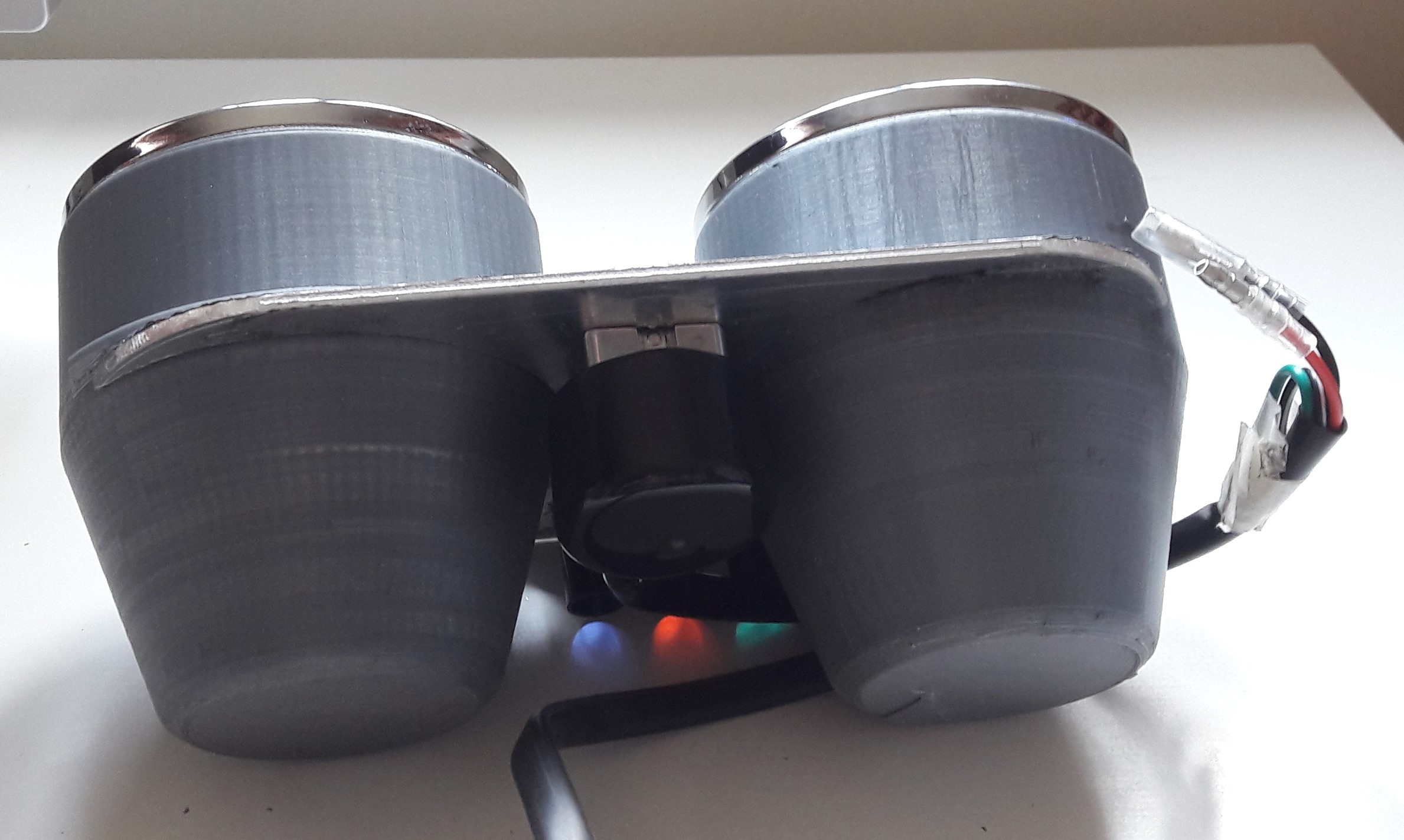

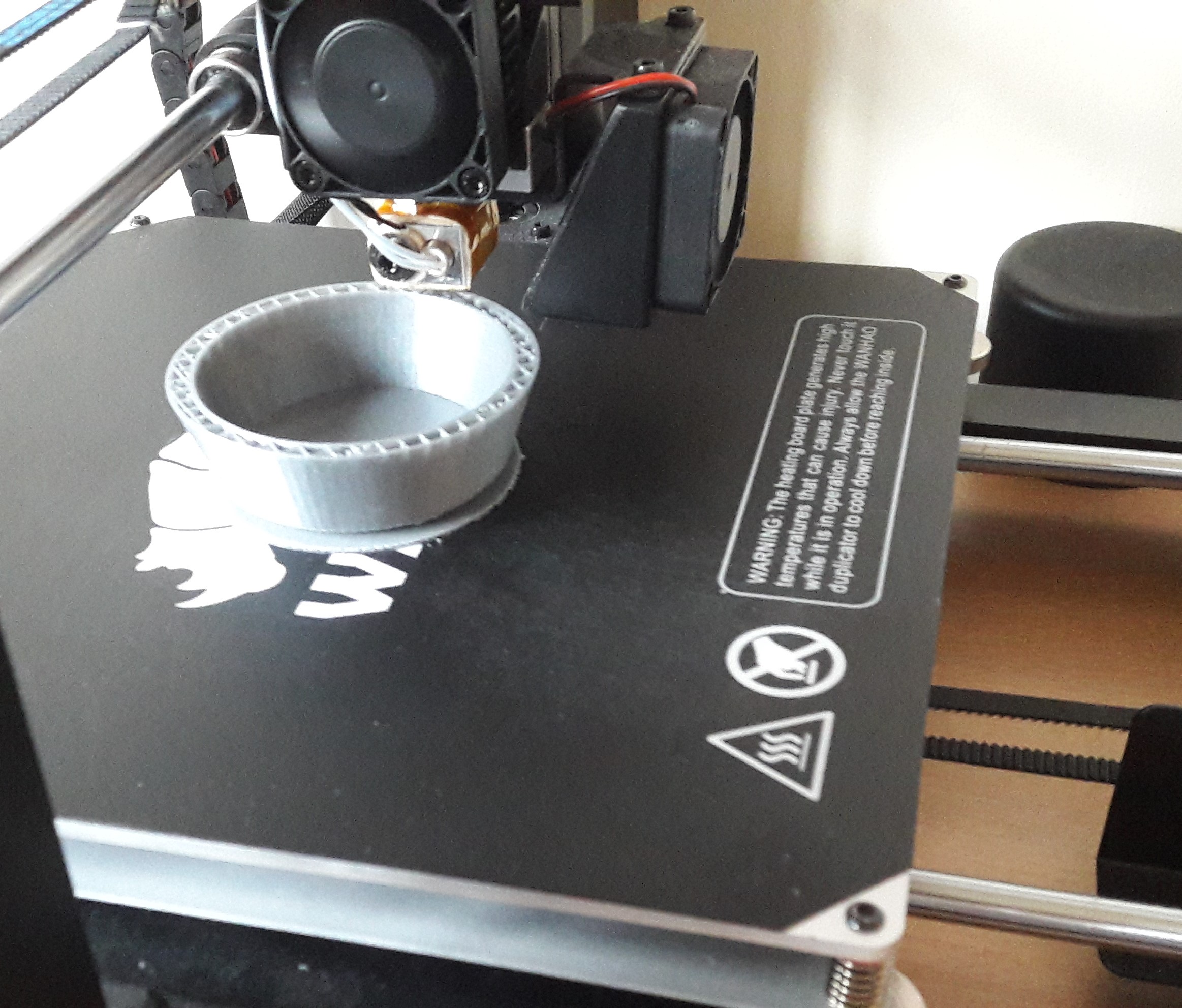

I've recently found that 3D printing has been helpful for making prototype parts and also a few final parts, such as the instrument pods. The following series of pictures show the process I've been through trying to create a new instrument console what will use new electronic clocks, but also trying to keep the spirit of the Z1 incorporated in the finished article. This is a work in progress, pods still need painting and the aluminium clock holder still has its white protective film keeping the brushed aluminium surface scratch free at this stage.
Here is the first mock-up using 3d printed console, version#1
The current status- still needs pods painted and other fittings worked-on, but seems to be coming together.

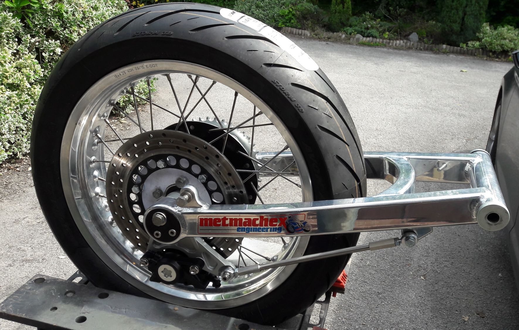

Just a quick update on progress, rear end now nearly complete, just waiting on the ISR rear disc, went this route since it seemed easiest to keep a brake and caliper holder and get the disc made. I've just received the rear wheel spacers and the rear brake toque arm so nearly ready to get the bike on its feet finally.[image][/image]

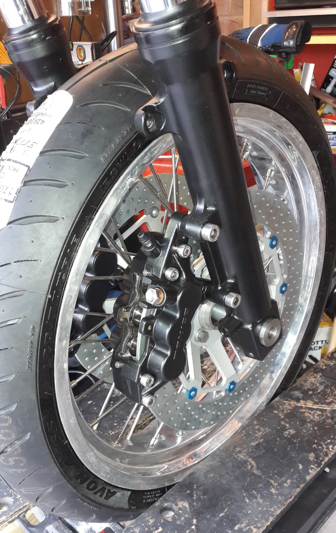

A few pictures to show some progress. I'm hoping that the final assembly of all main items can now commence. Just received the ISR rear disc yesterday so have now fitted the rear end today and hope to have the front end installed during the coming week. The rear shocks used are just a prop until I can work out what will fit.

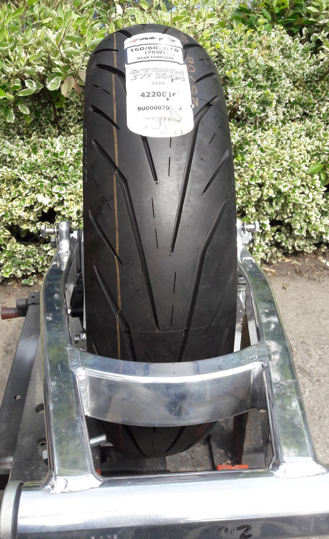

Looks great, what gap have you got in that swingarm, I've a davida and on first assessment a 4 1/2" wheel with 160 tyre wont fit
kawasaki_man
- 100Club
- Posts: 179
- Joined: 11th Jan 2012
- Location: Nottingham
Re: KZ900-A5 (Project Bike)
Hi Swirl,
I discussed max tyre size with Metmachex before purchasing the swingarm, they said 160.
I have 160 tyre on a 4.25 rim, I've just checked the clearance tyre to swingarm and it is around 17-20mm on each side. Please see photo.
I hope this helps.
I hope this helps.

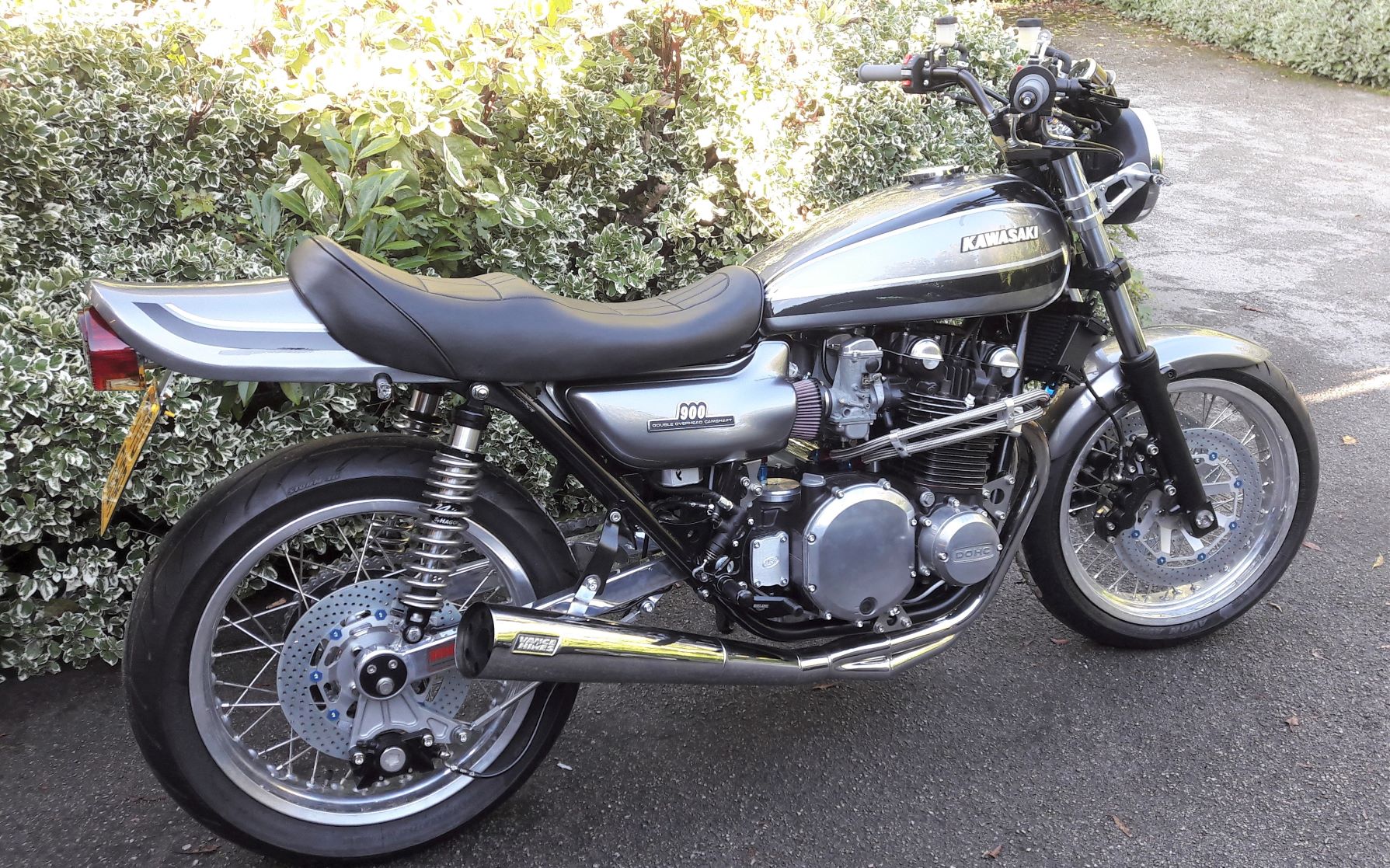

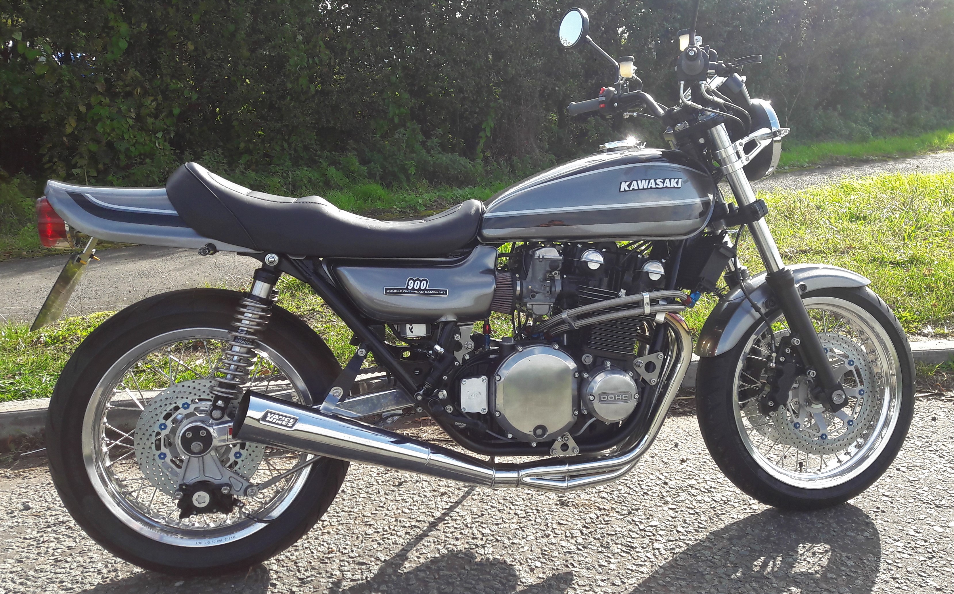

Here are the final pictures of the bike with bodywork on, briefly started the bike and seemed to run OK, however the APE cam plugs need to be sealed, oil was coming out!
I have my snagging list to keep me busy before taking it on the road. At the moment I've just attached an old Vance & Hines exhaust, but plan to have a new tail section made in due course when time permits.
Engine running!
Engine running!

Snagging list fixed and the bike is running well now, no leaks from cam plugs. The bike is taxed and insured and I have completed 68 miles on several short outings. Just knocked out 35 miles this morning before the rain showers come.
