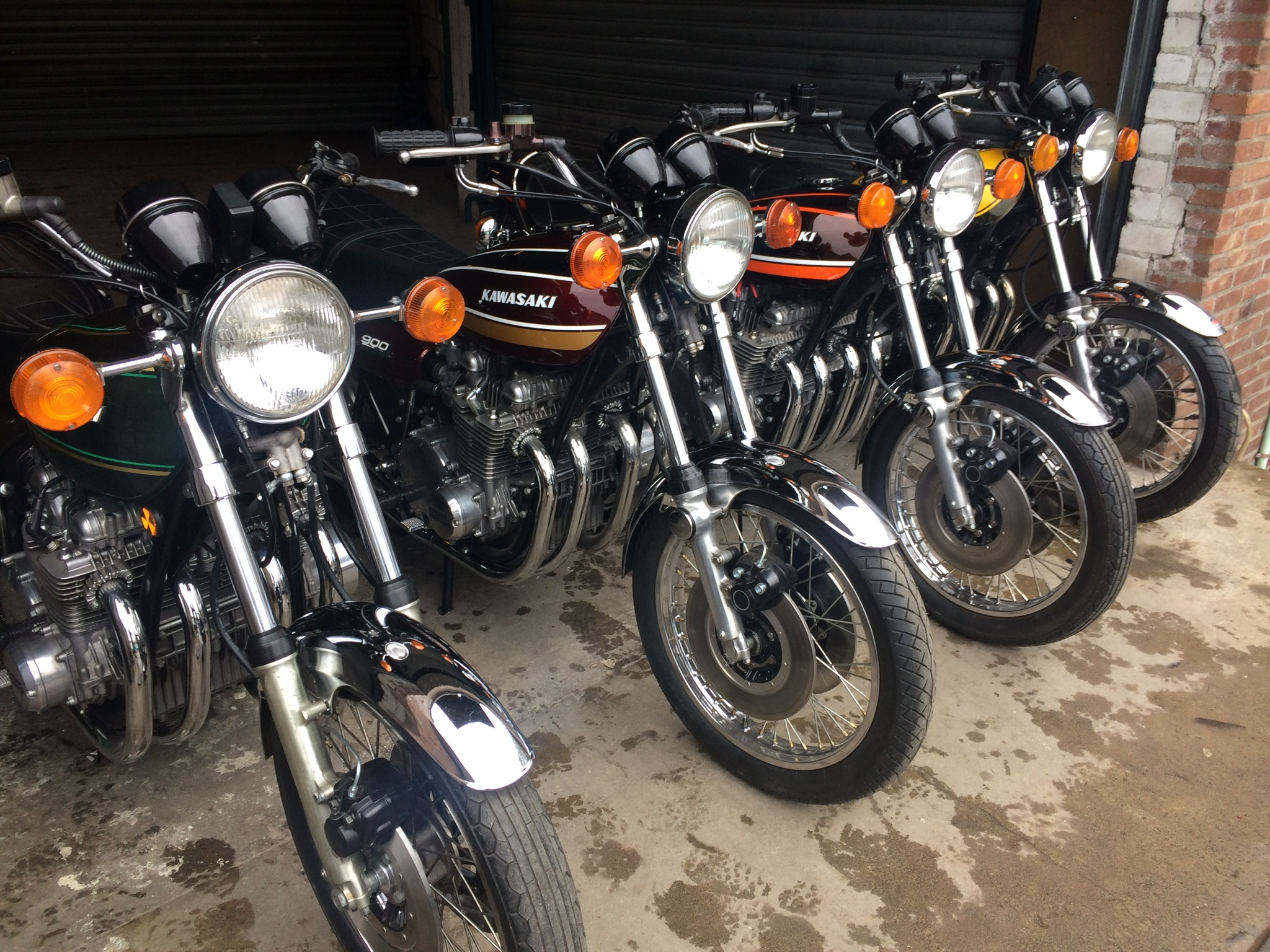

Hi Guys, thanks for allowing me to your website and forum. I am from the south of the Netherlands and started collecting Big Z’s a long time ago along with other big Japanese classics. A couple of years ago I started downsizing my collection as the years are adding up and I now want to work less on bikes and ride more. At the moment I have 4 nice complete Z’s , and I´m working on a ‘73 Sanctuary look-a-like and a ‘79 ST converted to look like a MK2. The last two are still work in progress. Here a picture of some of them

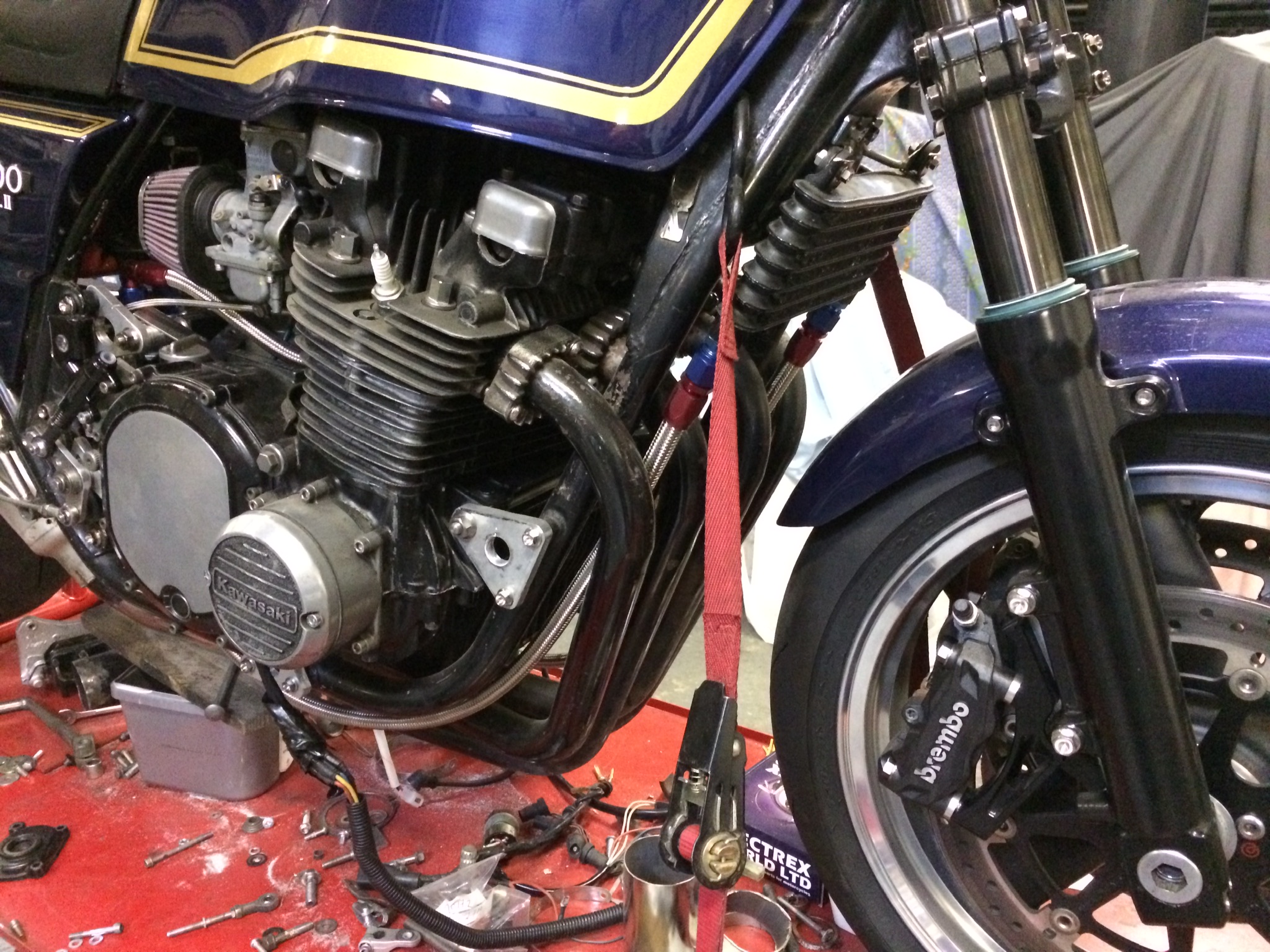

And some pictures from the ST converted to MK2... stock ST bodywork in slightly modified MK2 colors, frame modified for VFR single sider swingarm with Triumph hub and wheel, ZX10R monoshock and homemade link system with adjustable dog bones. ZRX1100 forks with DLC coating , radial Brembo calipers on adapters and KTM Superduke discs on adapters. GTR1400 master cylinders left and right, modern Blade switch gear. All modern electrics with a MK2 replica wiring harness and modern fuse box. Home made footrests with Tarozzi shifter and brake lever. Exhaust has a remote operated valve but not entirely sure if it stays.. Electronic Speedhut gauges in stock surroundings and GPS. Engine rebuilt , hydraulic clutch, 19T up front comes with outrigger bearing welded in stock looking engine cover. Oil cooler with thermostat and also titanium and stainless bolts and nuts on frame and engine and handmade engine brackets ... Frame and engine still to be painted..
