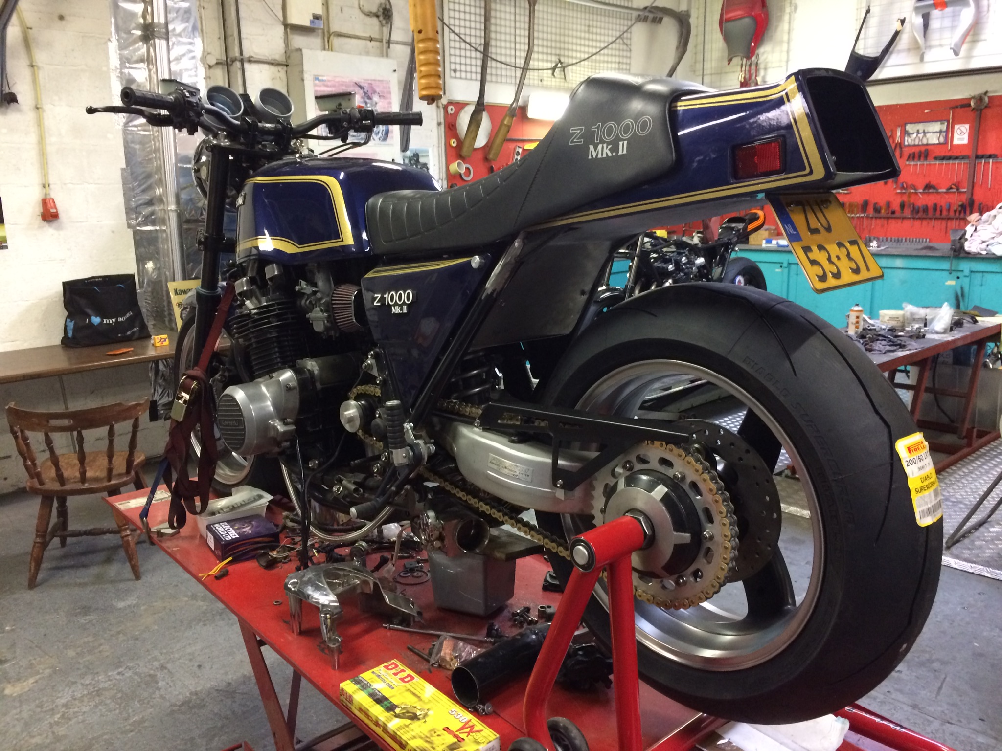

That ST/Mk2 is stunning, is that a MK2 tail and seat then
Re: New here..
Mathh wrote:And some pictures from the ST converted to MK2... stock ST bodywork in slightly modified MK2 colors, ..
Scratch the above question (note to ones self, read the thread don't just look at pretty pictures)

Re: New here..
Swirl wrote:That ST/Mk2 is stunning, is that a MK2 tail and seat then
actually the seat is for a MK2 and made to fit. Moved the hinges on the frame and made a small subframe in order to keep integral strength of the seat instead of hinging it in the glassfibre only. Also added a push button lock and a seat stopper.

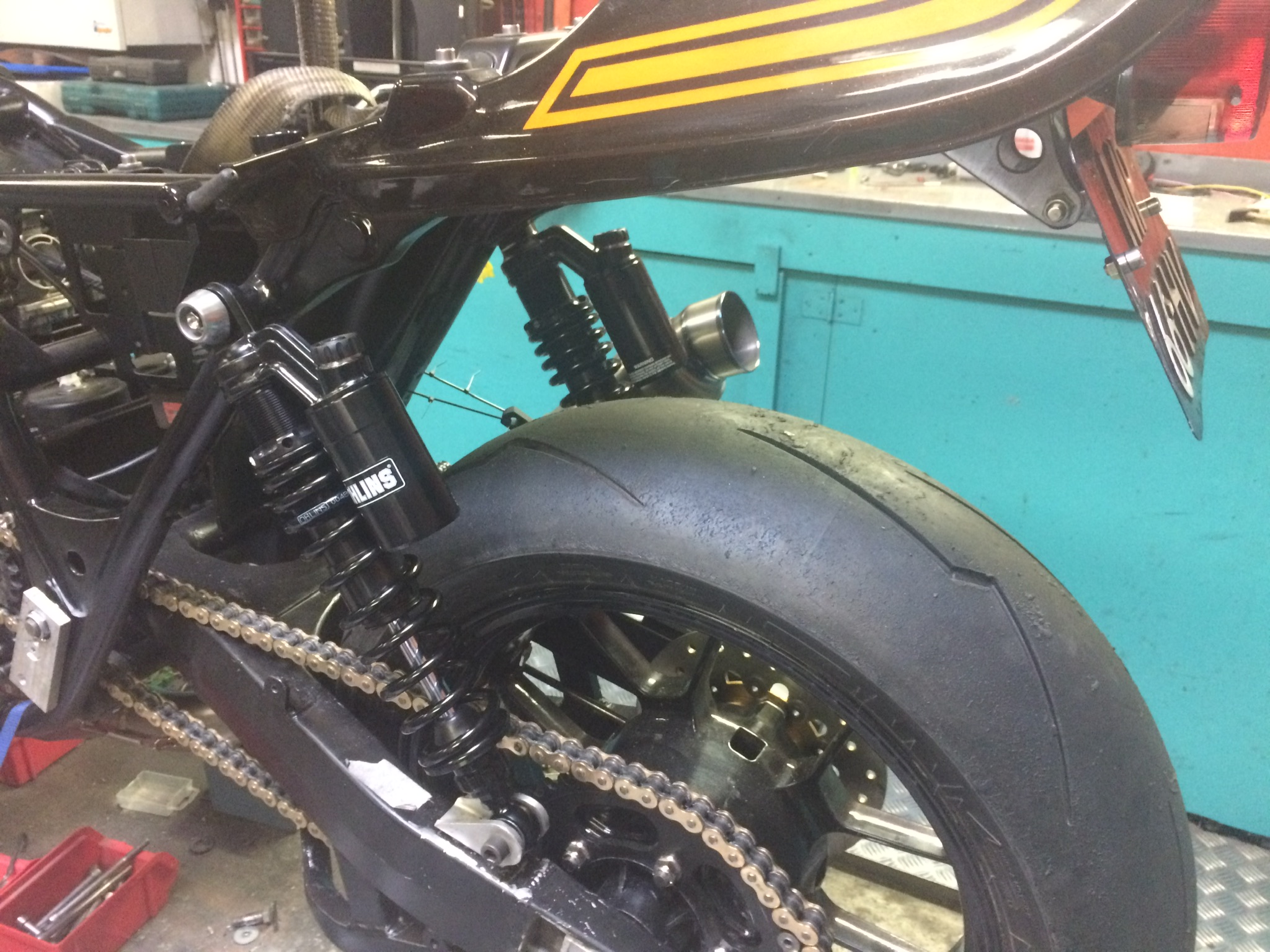

I got my late Santa gift today .....
Looking great ... still need to weld the brackets to the swingarm ..
