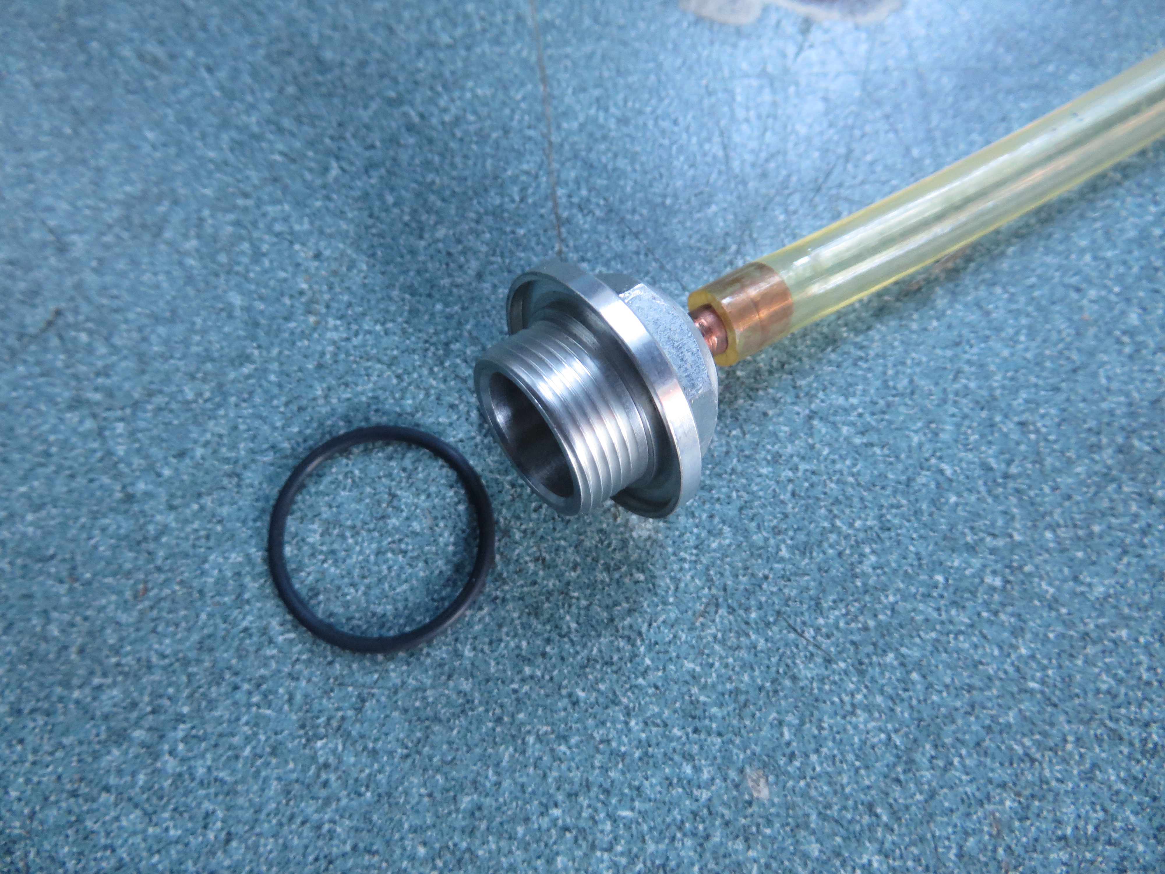

As above from Julian but got pizzed off with that so bought another alloy bottom bung, the one with the 17mm hex on it. Drilled a hole in it and rivetted / glued a short bit of brass tube into it. Attach a bit of clear tube and use it whilst its running to set the fuel height dynamically which is far more representative of real world scenarios. Cant say what height my floats are because i dont need to measure them, just to know when set that the fuel level is 3 - 4 mm below the gasket face. Its also better at getting them all the same. Bung was about £15.

I will definitely make up a new float bowl screw with a clear tube fitting for setting up the actual fuel level, but for now i think i will lower the fuel level on no.1 first to try and eliminate the problem, then set all the others to match.
