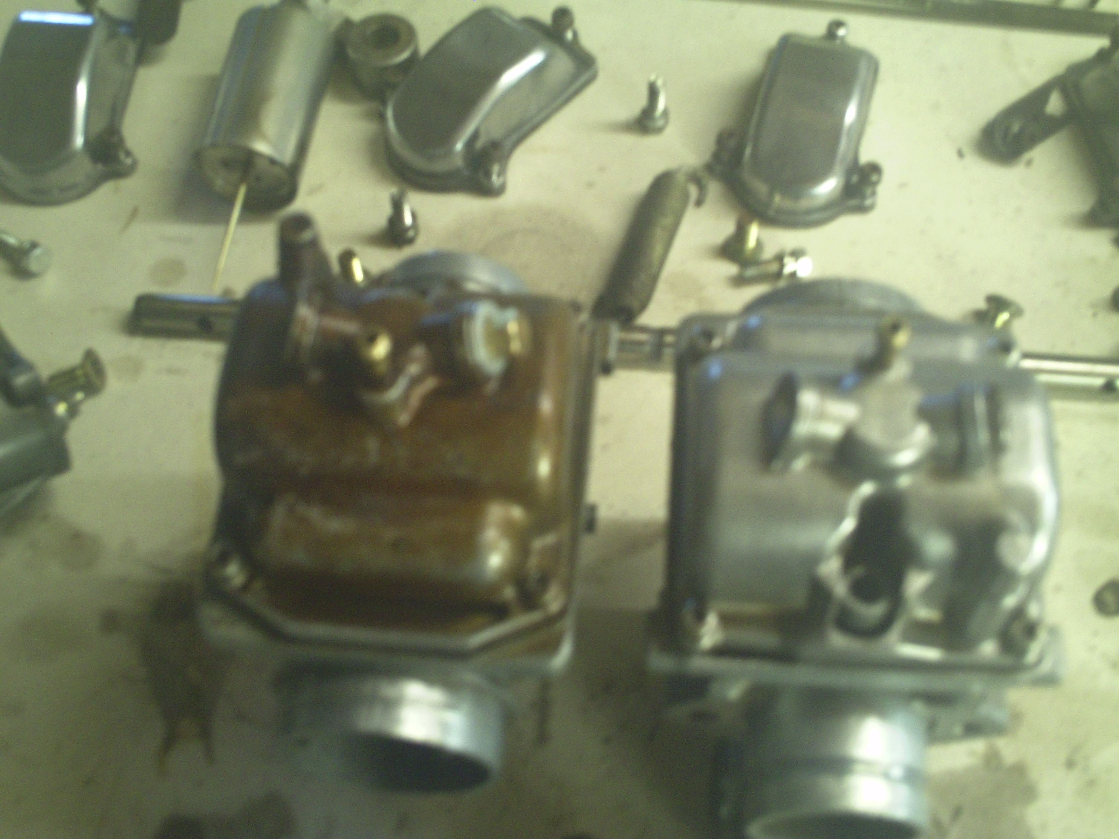

Ignition timing spot on as expected. No. 3 carb was running rich, couldn't get it off yellow on 'colortune'. So carbs back off.

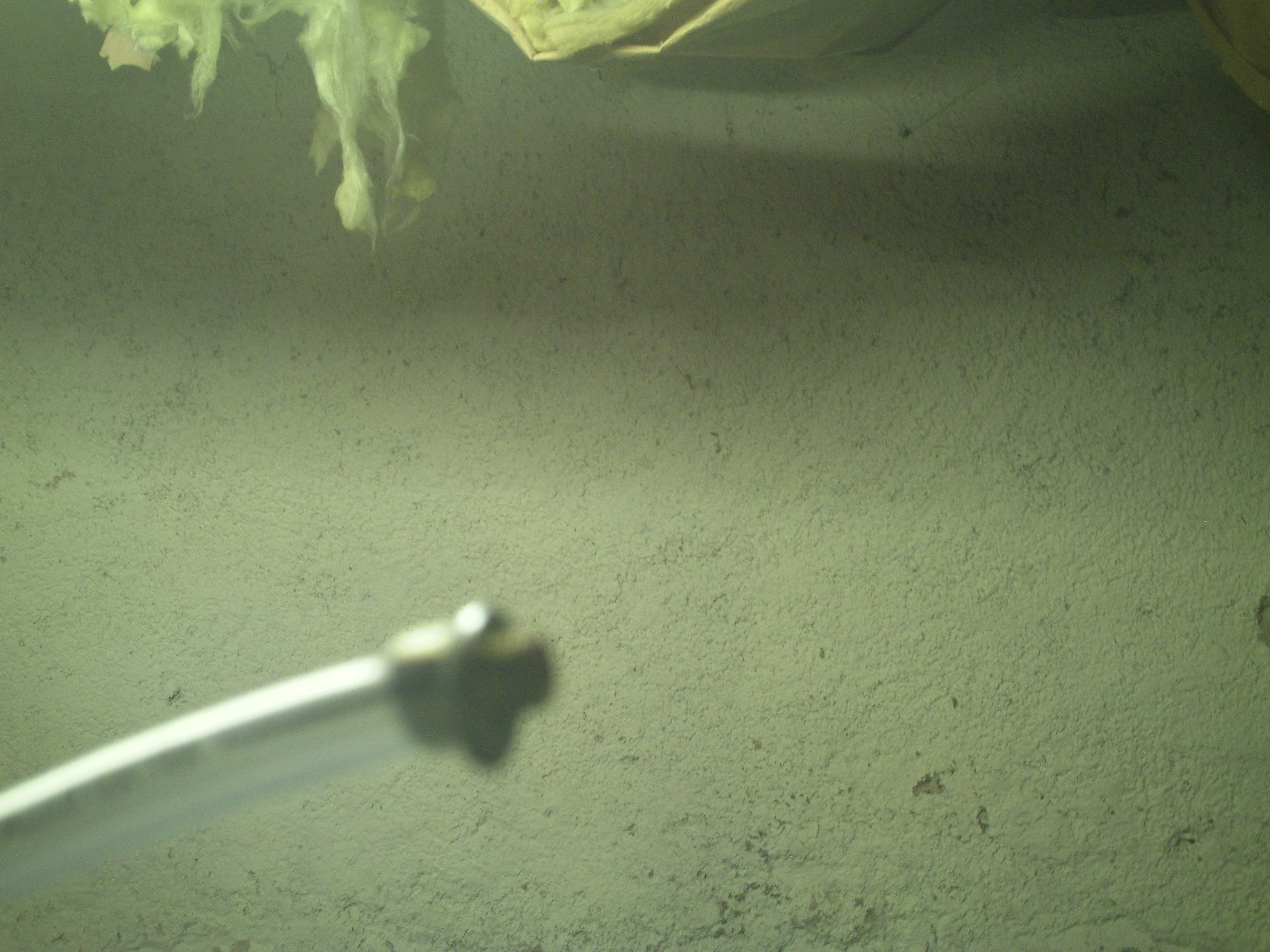

Checked the float heights using an improvised tool
Picture quality is crap, but it's a gas cooker jet with a 3mm hole bored through the centre. I wouldn't like to use it with the carbs on the bike, but separated and held in a vice it did the job.
Whilst stripping the carbs I took note of all the sizes for the 'brass bits'. The mains are 130 instead of 110, I expected something there due to the pipes, everything else is stock.
I also measured all the O rings and the bores/pistons and am going to put together an o ring carb rebuild list. After all the brass bits can be cleaned. I do know off the top of my head that for the choke plunger a 7,94 x 1.78 fits a treat.(I have a few from a Lucas Epic fuel pump rebuild)
This time they were completely stripped, mounting and all.
If they're clean on the inside, why not make them clean on the outside?
Physical sync done with some mig wire and back on.
3rd kick (I haven't got a battery bigger than 4ah at the moment) and she started, ticked over and everything.
Next job, mixtures, 'colortune' out, all carbs now bunsen blue...nice.
Mercury next. Stunned, only no. 4 needed adjusting after the original static set up. All within 1,5cm...nice.
Time for a run, no popping, no farting, clean on low end and accelerates through to 10 without issue.
This is with no air filters.
Put the them on and it bogs after 7000.
I set the carbs with no filters because I don't know the consistency between the 4, none is better than an unknown. From this I think the mains are possibly oversized and/or the filters are shite (the latter I already know).
