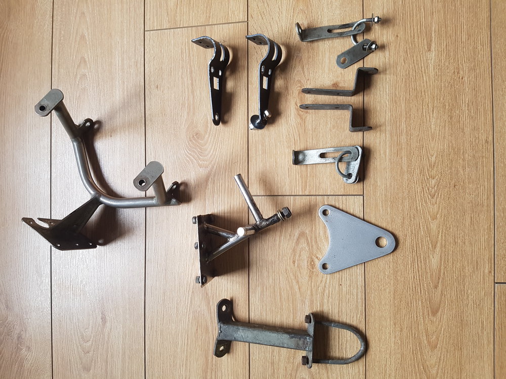

I seem to be having trouble trying to establish how the front fairing fastens to the frame etc and have taken pictures of the brackets that i have currently.
I am to fit the dual seat with the shorter tank cover and also wondered how this fits onto the frame. I unfortunately cannot find anything to guide me so any help is greatly appreciated.

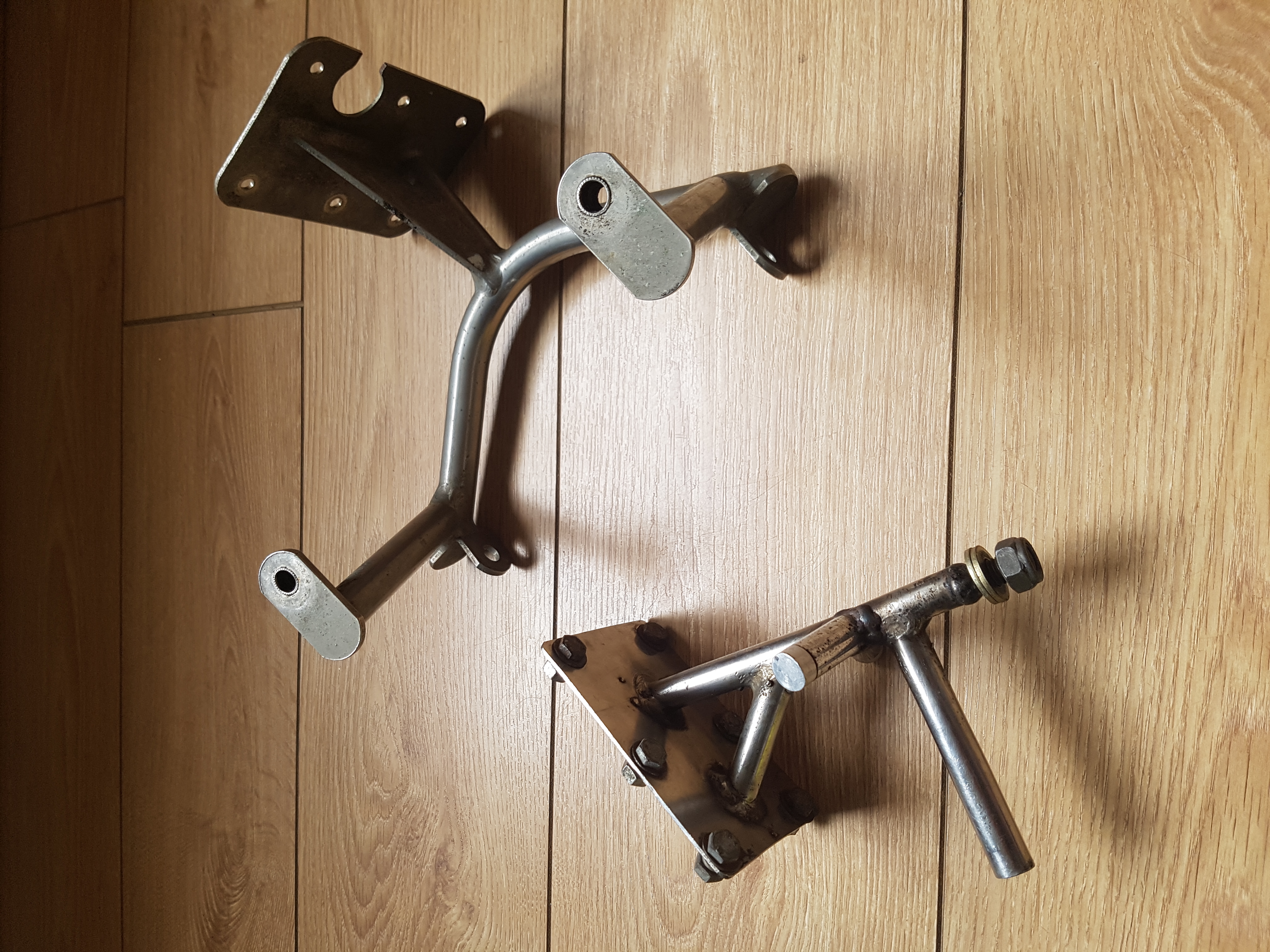

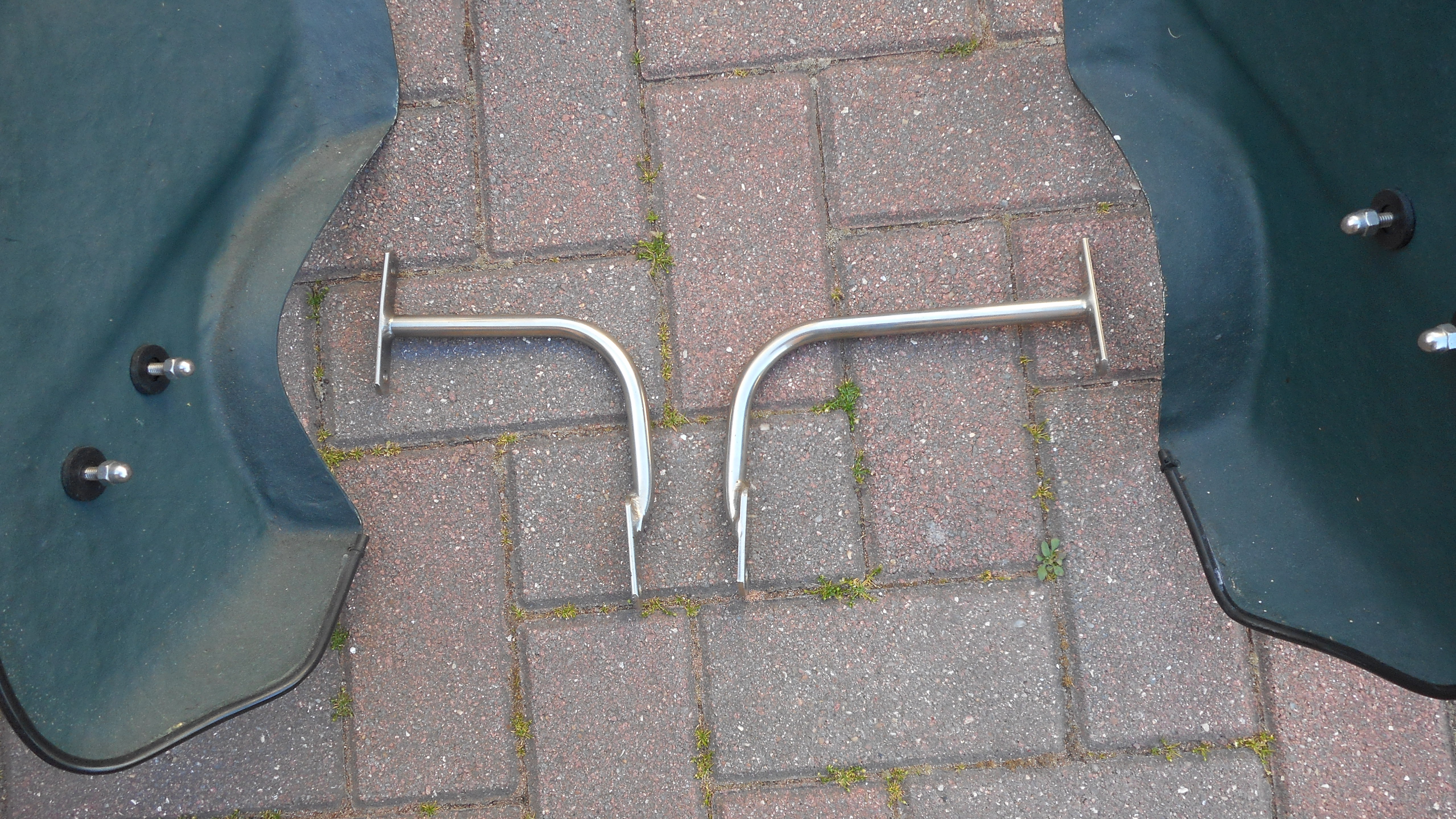

Blimey , that's an assortment . The big bracket is mounted to the plate on the headstock , the fairing bolts down to it , the 2 ears hold the headlamp , the cut away hole is for the wiring loom . The triangular plate is an engine mount , the rest appear to be home made . You're missing 2 large brackets for the fairing rear end. I own a later Rickman Kawasaki and can supply photos if you need them , Bob.

When I attach the big bracket to the headstock though, it doesn't seem to want to fit to the fairing at any point

#5 PostAuthor: crossthread » Wed May 27, 2020 6:26 pm
crossthread
Posts: 69
Joined: 15th Oct 2017
Location: Devon
Re: Rickman Kawasaki 900
#6 PostAuthor: crossthread » Wed May 27, 2020 6:29 pm
Hope that helps , any thing else just ask for specifics.

Thanks so much for the pictures. It'll really hell together with the info I got from Foz.
