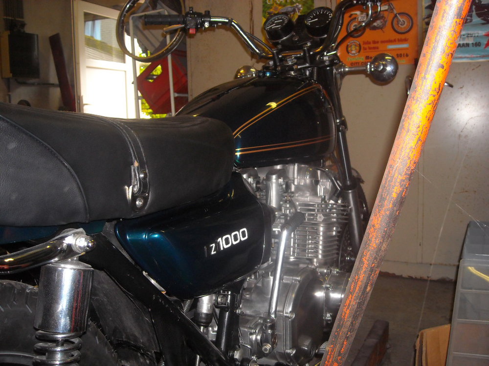

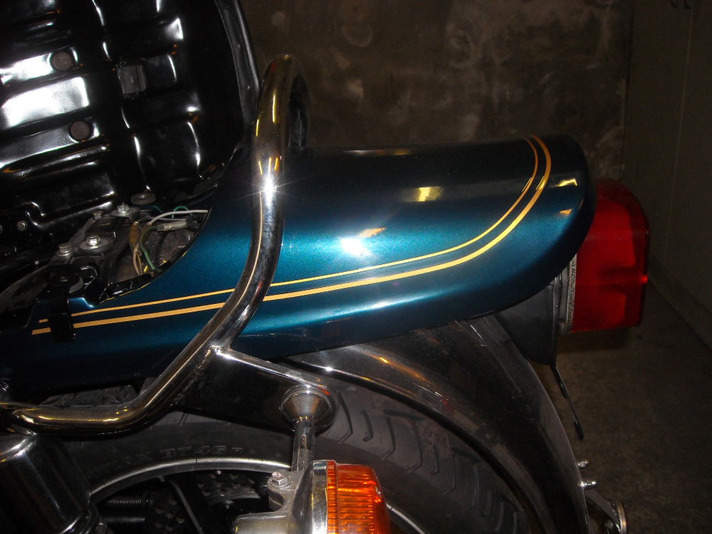

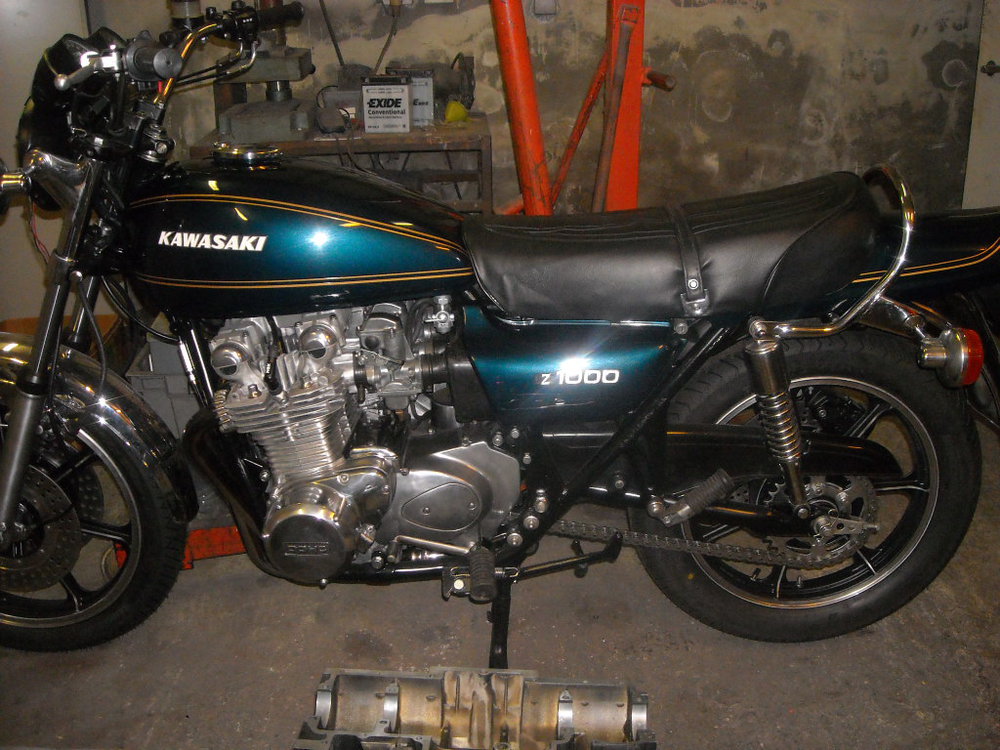

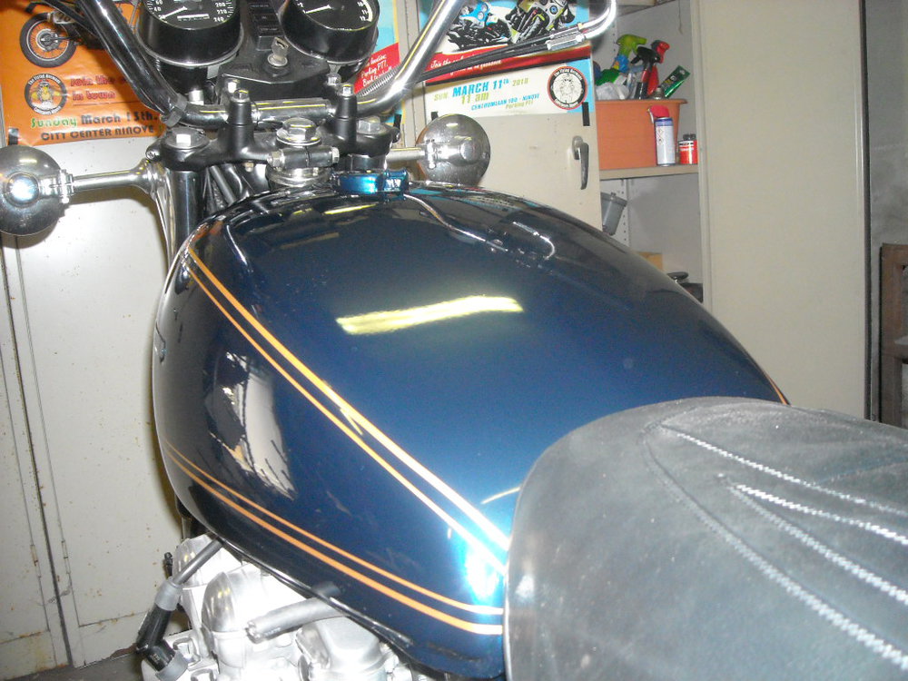

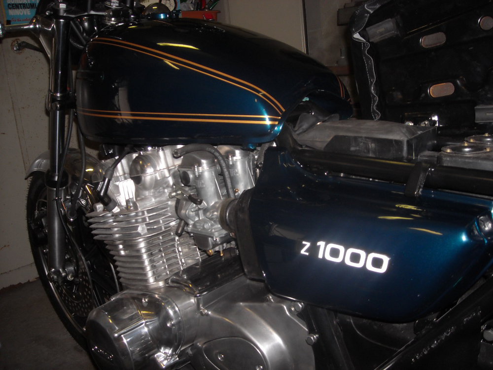

the paintwork is done ! The body parts are mounted, only a few parts are missing before completion.
The paint is a bit darker than I expected but it has that "shade" that makes you wonder if it's green or blue, depending on how much light and what kind of light is shining on it.
I had a few runners in the clear coat but i managed to sand them off with wet and dry number 2000. Afterwards I polished the body parts and I'm very pleased with the results.
Just see for yourselves.
the tail after polishing
the right hand side panel
the left hand side panel
the fuel tank
the almost completed bike

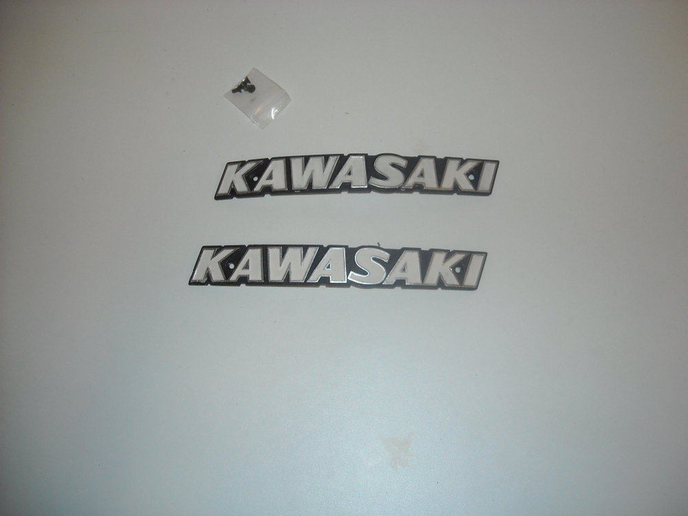

I also repainted the fuel tank badges. They were a bit damaged and the paint was chipped off at several places.
I use humbrol enamel for the black and white and allclad paint for the chrome. It's applied with a small ( number 0 ) weasel hair brush that I use for modelling.
the repainted tank badges
She's almost finished now.
