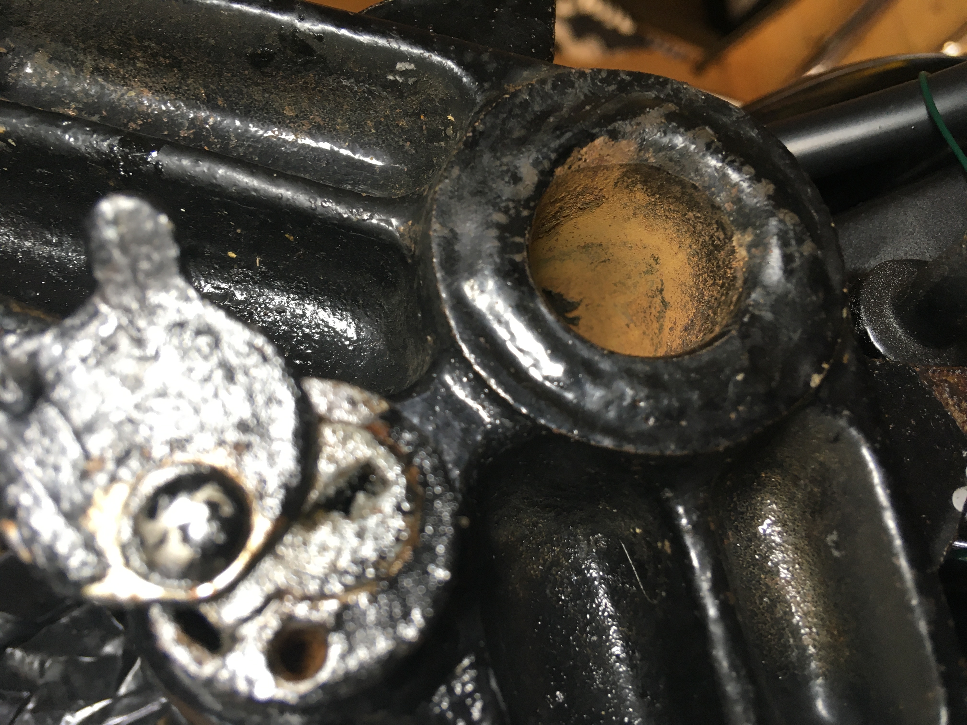

Having trouble with removing steering lock which is positioned at the base of the bottom yoke.
There is a hole beside the barrel but no locking grub screw visible.
Any ideas welcomed.

remove the metal cover & knock pin & it should tap out from the top end of the steering stem

Thanks for the tip, drifted out with ease. :up
