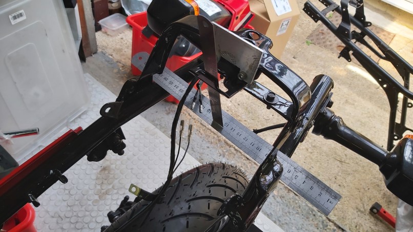

I started by fitting the seat cowl as I thought that would be a good place to start and it would allow me to then trial fit the seat and adjust it's mounting brackets if necessary. However, with the seat cowl fitted, the rear of the seat was sitting to high at the back and would not "latch" into the seat lock properly. After a bit of head scratching, I dug out a spare frame I have and took some measurements between the two. This showed my seat lock bracket was out of line and needed "tweaking" a bit. To save damaging the powder coat, i fabricated a bracket to bolt onto the seat lock bracket to give me some leverage to line it up. A couple of "tweaks" using a pair of mole grips on my fabricated bracket had it back in line !
Measuring the height the of seat lock bracket and fabricated plate for leverage.
seat bracket.jpg (111.91 KiB) Viewed 91043 times
With that now sorted, the seat cowl went on nicely and looks the part :)
