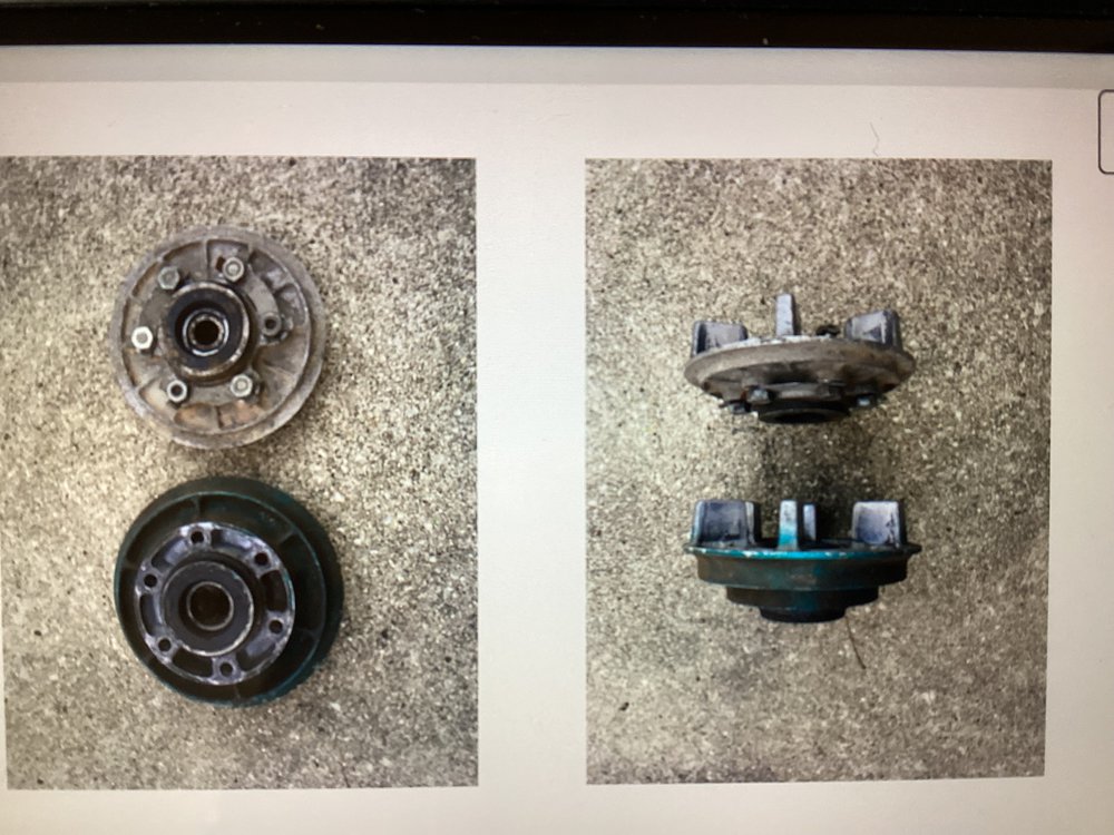

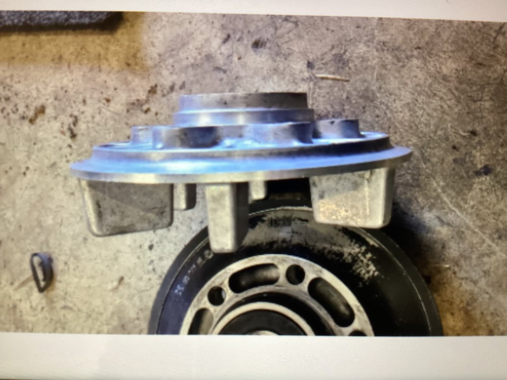

A couple of pics. (Hopefully)
The silver coloured sprocket carrier is the A1/A2 wire spoke wheel type. No other will fit.
Getting hard to find !
you'll need the matching cush drive / shock absorber rubber as well.
The spacers are also different lengths from the ones in the Ltd. wheel

DeadZedDave wrote:A couple of pics. (Hopefully)
[image]IMG_0473.jpegIMG_0472.jpeg[/image]
Had a feeling that i might need the carrier as well
