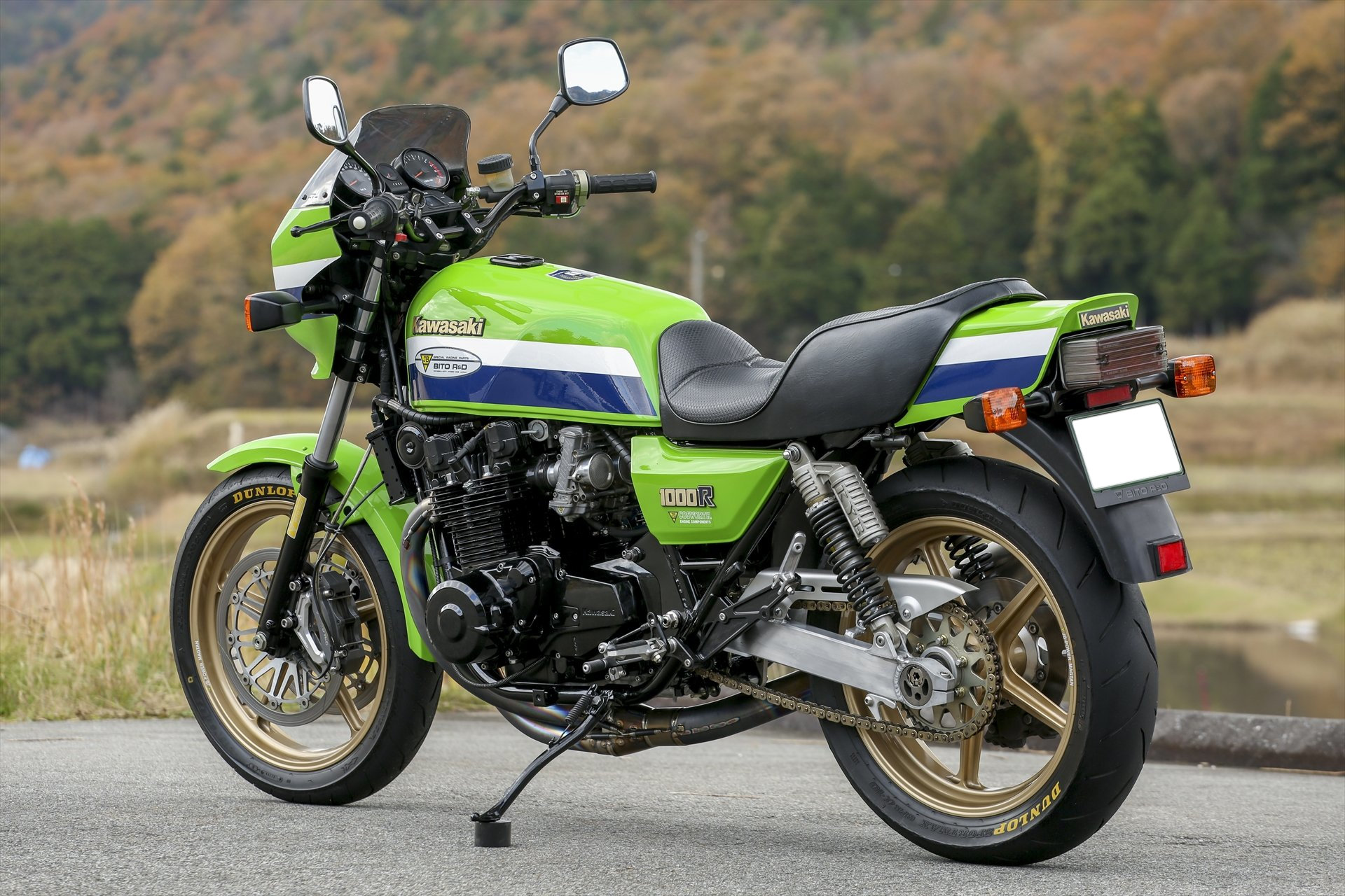

Missing rear indicators, and rear mudguard, but intend to buy a repo job from Debbens, but how do the rear indicators actually mount ? no holes in the frame ( like the Z1 ) but also no holes in the mudguard?
from images it seems they mount behind the tail lamp but Im not sure how ( image of this would be appreciated greatly )

Rear indicators mount on the tail light bracket.

#3 PostAuthor: ADRIAN H » Fri Jan 10, 2025 5:52 pm
Pictures of the rear end, of a Z1000R - same mount on Z1100R

Rear indicator mounting method as already shown, same on all.
