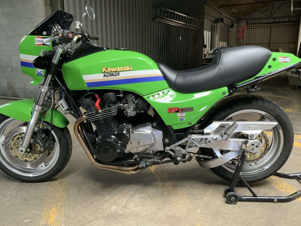

biggest things to check are ECU, Air flow meter and Fuel Pump - all very expensive if not working. As Angus said Injectors can be rebuilt readily.
Fuel Pump - if not putting out 45psi then a new pump.
ECU - guy in Germany can rebuild but not cheap.
Ideally a mate with a running GPZ to test the ECU/air flow meter. Pump needs a pressure gauge setup to test. I had issues with mine and it was only putting out a few psi. Rebuild kit made no difference. New pump needed - OEM equivalent horrendously expensive.
But early FI bikes when running well are glorious.

LIke Chris says there could be snakes waiting fir anyone who buys a non running project, i know i got bit with one of mine. There is a complete finished bike near exact the same on ebay, thats 2 grand more (buy open to offers) than you would offer for the project bike and looks like its a tight build. You could end up putting the same into the project bike but with less the stress.
