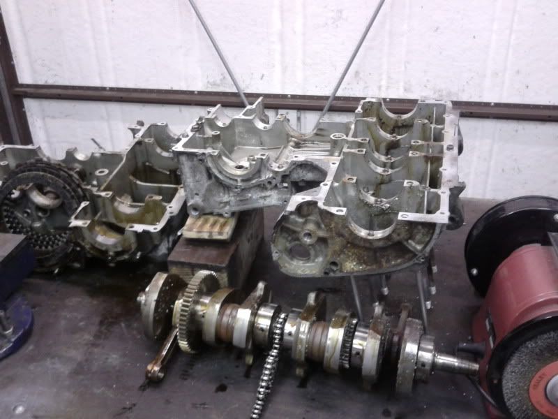

Cases apart today and crankshaft out. Studs will be done during the week. :D :D
Clutch basket springs all shattered: Was this a drag bike in a previous life :(
Cases apart & crank out ready for Chris Appleby..
Clutch plates all knackered too..
More to follow........ :P

The springs can be replaced, again Chris Applybee does this properly :shock:
I've worked on very early '72 bikes and never seen any rubber cush shox but have heard of them being fitted. Any one got any images :?:
The bearing tolerance on this basket is as new so I'll use some German rust treatment to remove & inhibit and it should be fine.

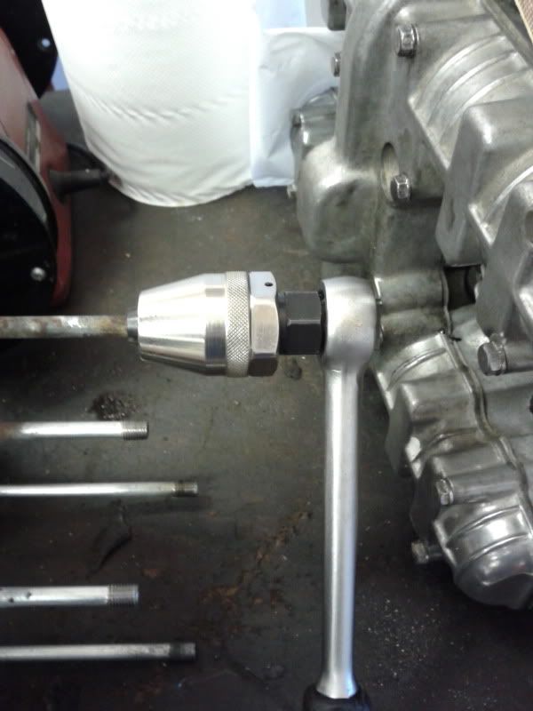

A few more images showing the tool I use for removing cylinder head studs, if they don't come out with a standard ratchet then its time to use the 3ft breaker bar. I soak these in Release agent for 24 hrs then apply some heat with a blow torch then use the tool. :D :D
Everything is either away being vapour blasted, polished or refurbed so not much more to add until new year.

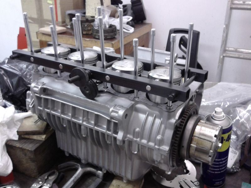

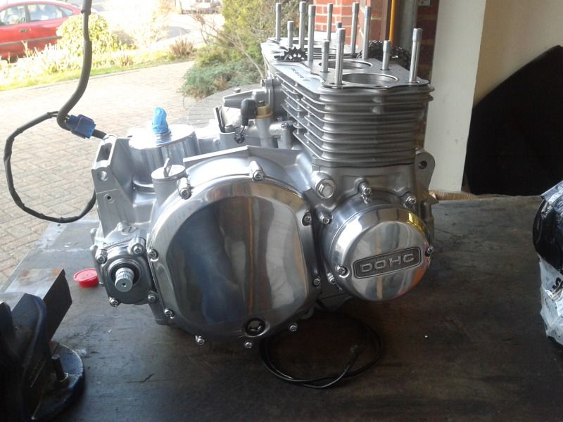

Here ya go..
Top crankcase with studs in place:-
Bottom Crankcase prepped:
Selectors in:
Camchain old vs New:
Bits BZP's:
Crank in, chain fitted & cases together:
Prep for barrels:
Some cases fitted:
Head & camcover on:
Finished awaiting collection.
