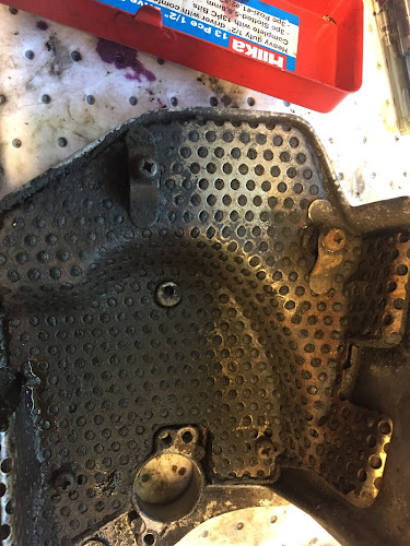

Sunday was mainly spent stripping the final components off the cases
Noting that there is a break in the windings of the stator - pretty sure that it's as it should be though
Cleaning off more blue goo.

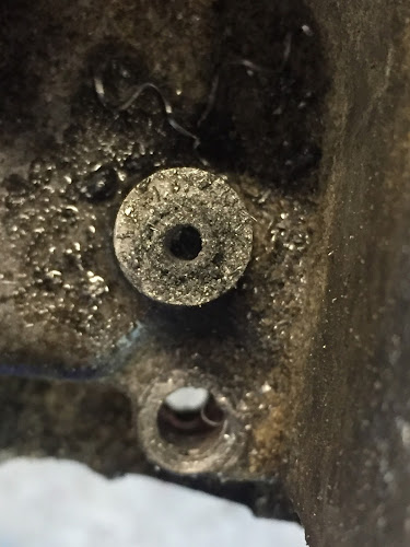

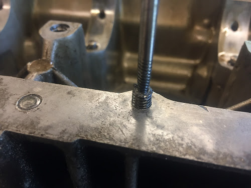

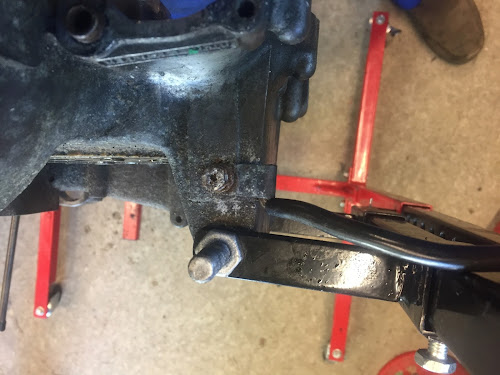

Drilling out and re-tapping seized and sheared casing studs.
Loads of heat - I'm always amazed how much of a friend a heat gun or gas torch can be on seized threads.
Re-tap the threads once the studs is out to make sure everything goes back smoothly.
And check it -
Not really sure if I need to take the studs out or not - they seem pretty good - took this pic for reference given there are three different lengths.
Another sheared casing stud - rare for me to use an easy-out and actually have it work easily!
And she's out -

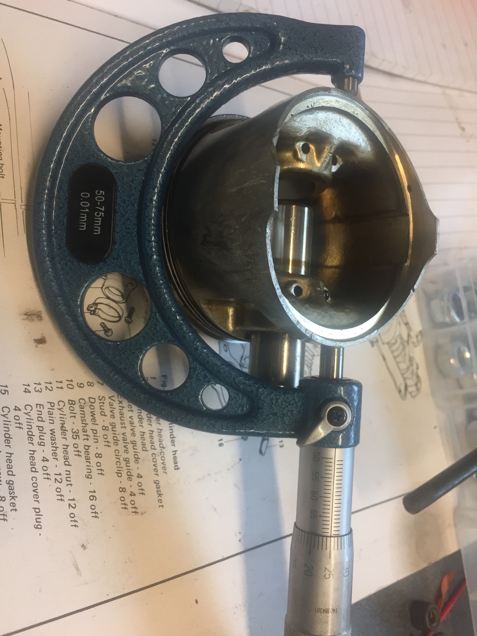

I thought that I would measure up and inspect my pistons and cams last night -
The pistons measure 69.25mm +/- at the skirts. So I think it's standard with no previous rebore. They are in really good condition just coked up on the crowns. They don't have any oversizes marked on them just KL250? Is this right? I suppose the numbers would add up, I have a KL250A1 as well!!

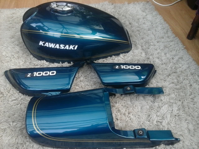

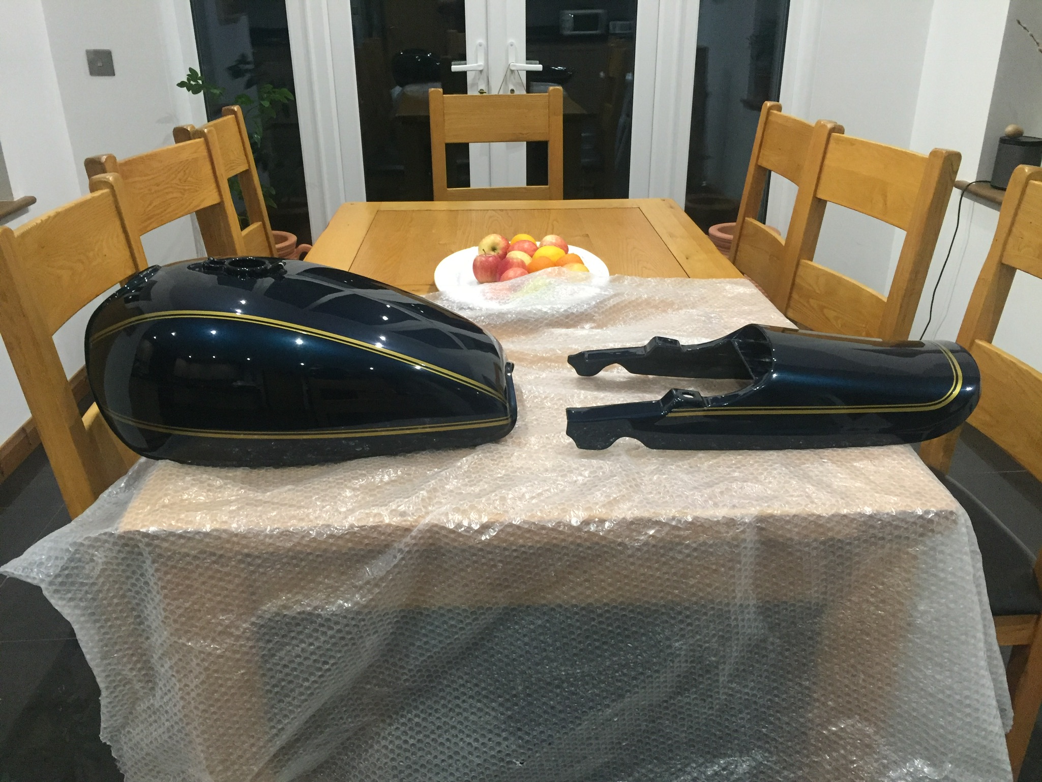

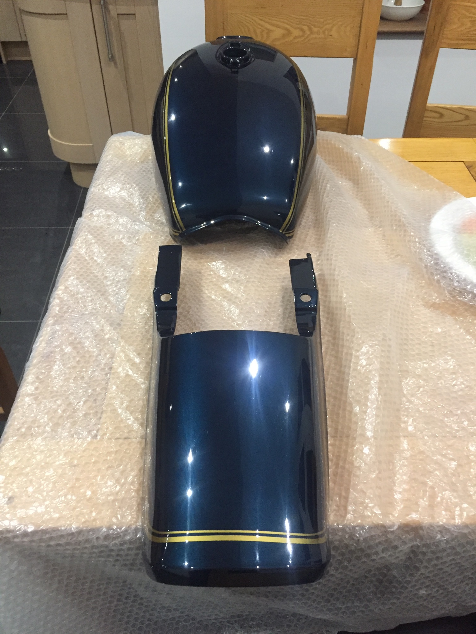

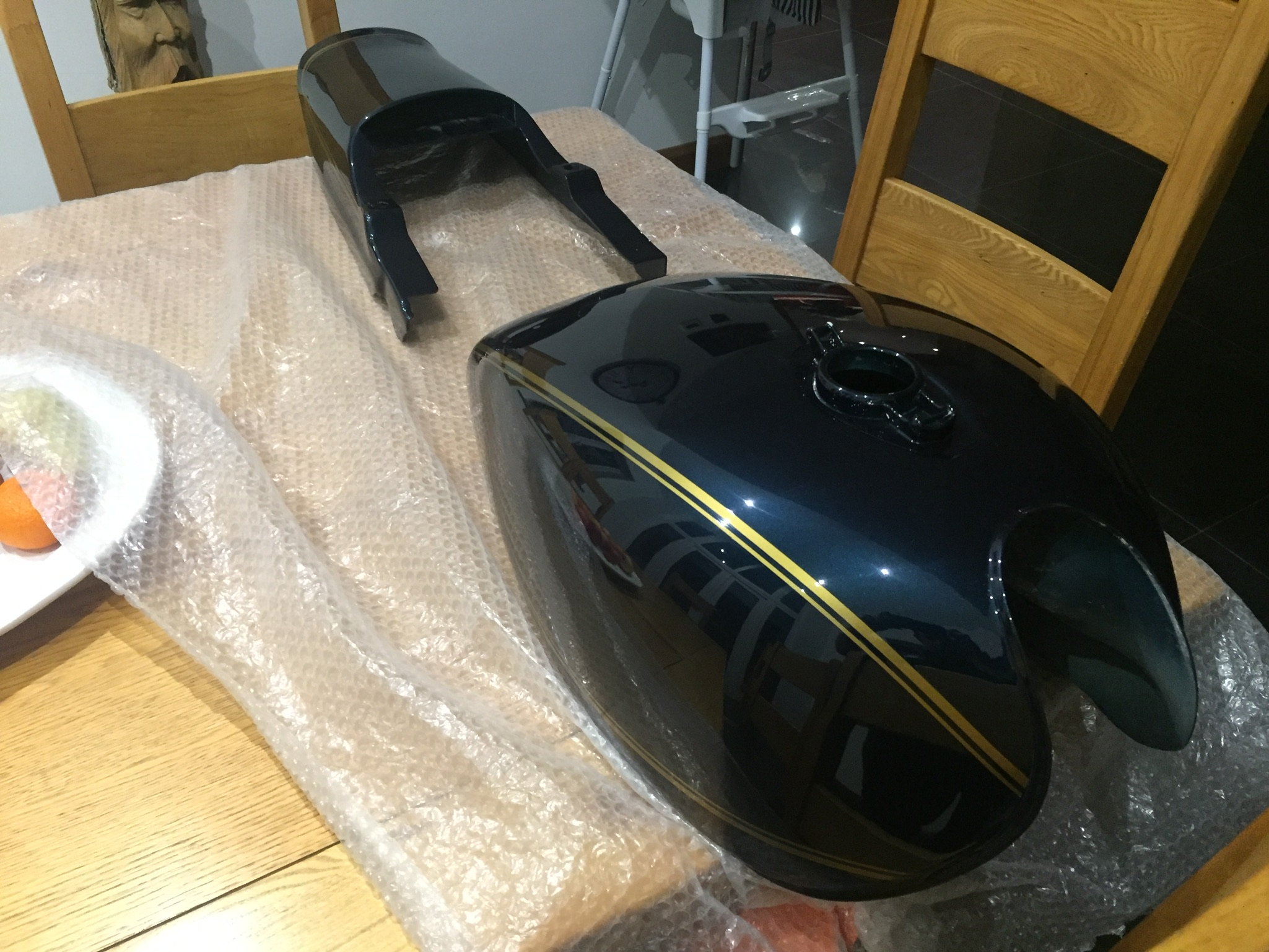

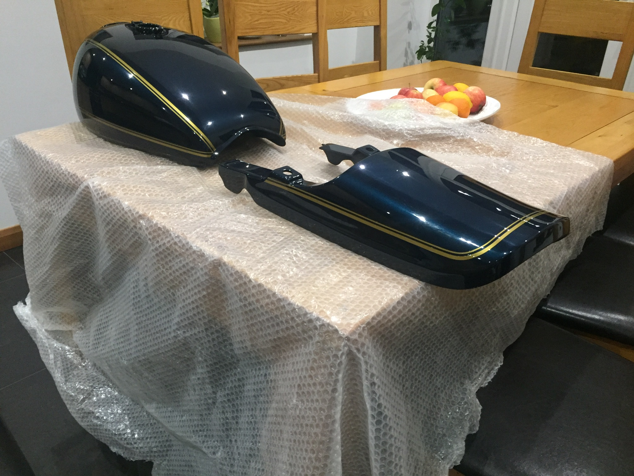

Picked these up this morning from Justin at Mark Skinner auto-bodies. The colour is Mazda Noble Green. It has a deep metallic fleck, and depending on the light conditions the colour appears to range from deep metallic blue, reptilian iridescent green to a classy rich purple.
Any way I'm just off to mop up!

#27 PostAuthor: DavidZ1R » Thu Nov 30, 2017 9:32 pm
Nowt like a different colour for a rest

#29 PostAuthor: csx355 » Thu Nov 30, 2017 9:45 pm
Hi Dave - I think yours is a little lighter than mine and probably closer to the original as a result - your panels are looking spanking.

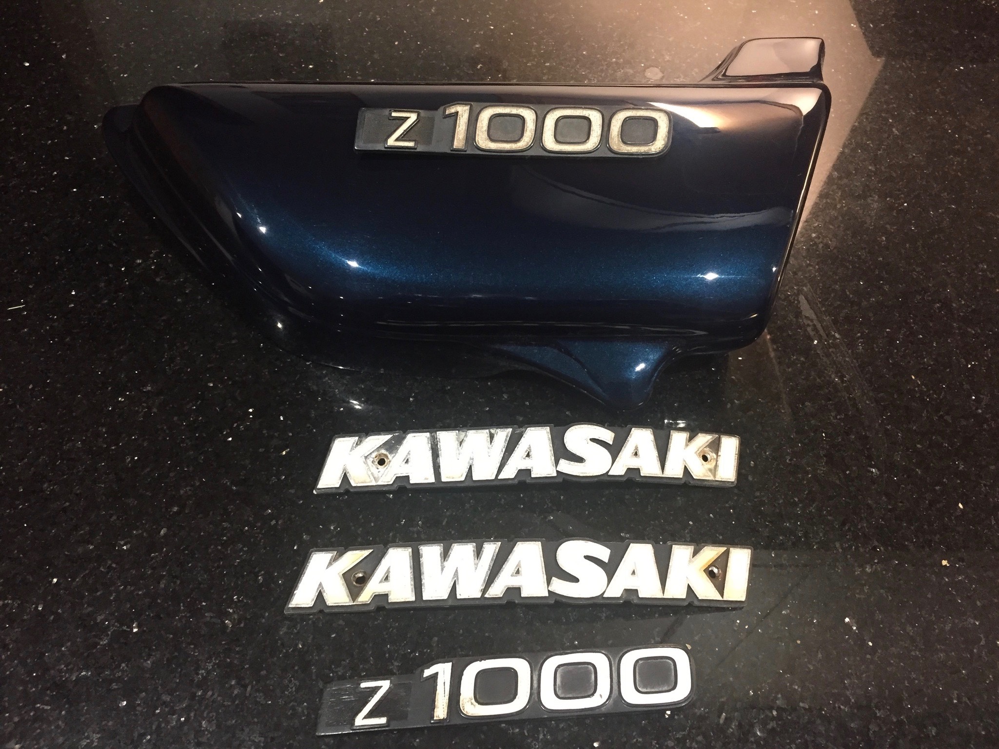

I love this part of a build. I'm tidying up the badges and will probably have a dress rehearsal on Sunday. Still have a lot to do but getting the panels done is always a real incentive boost.
