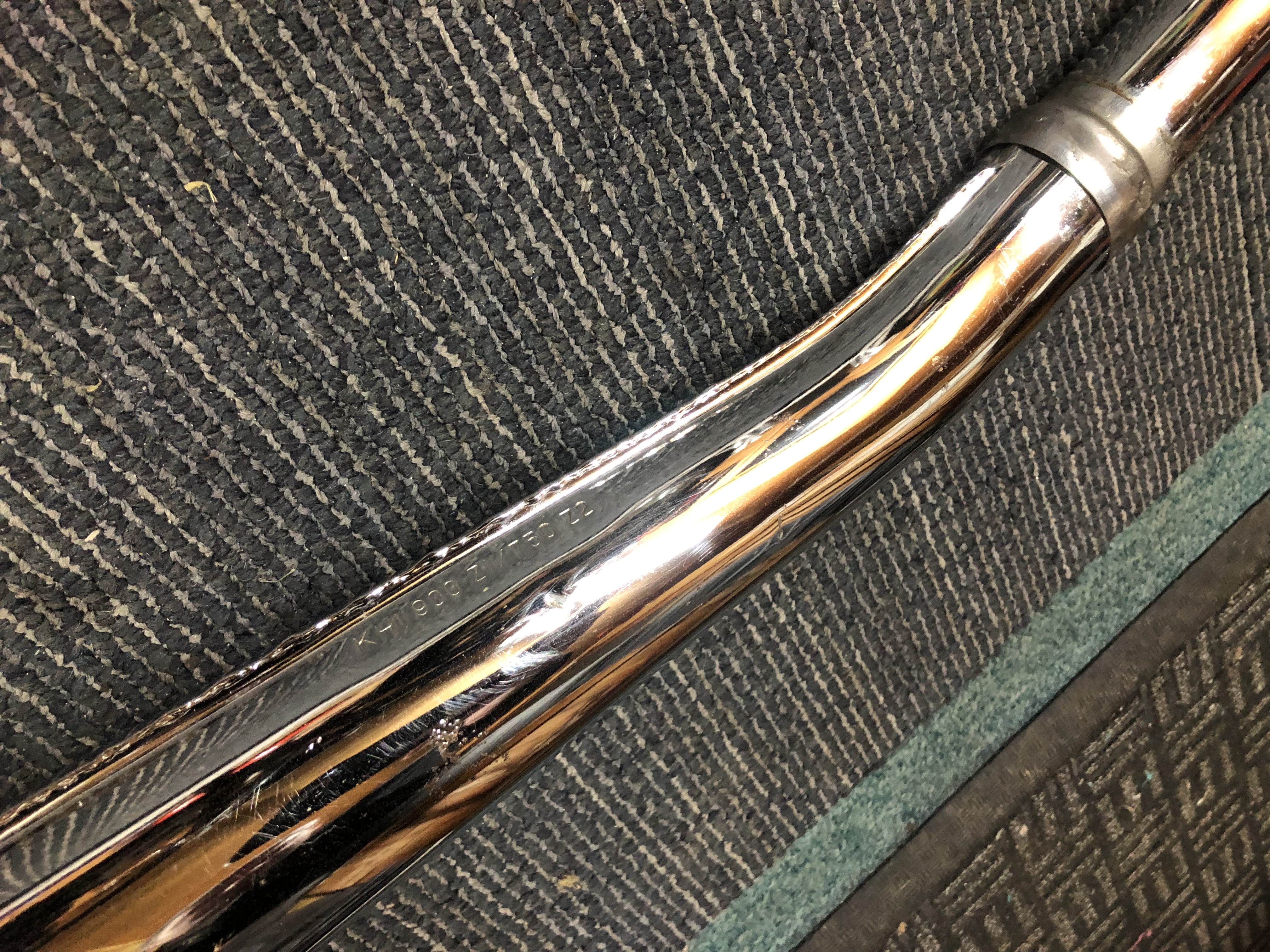

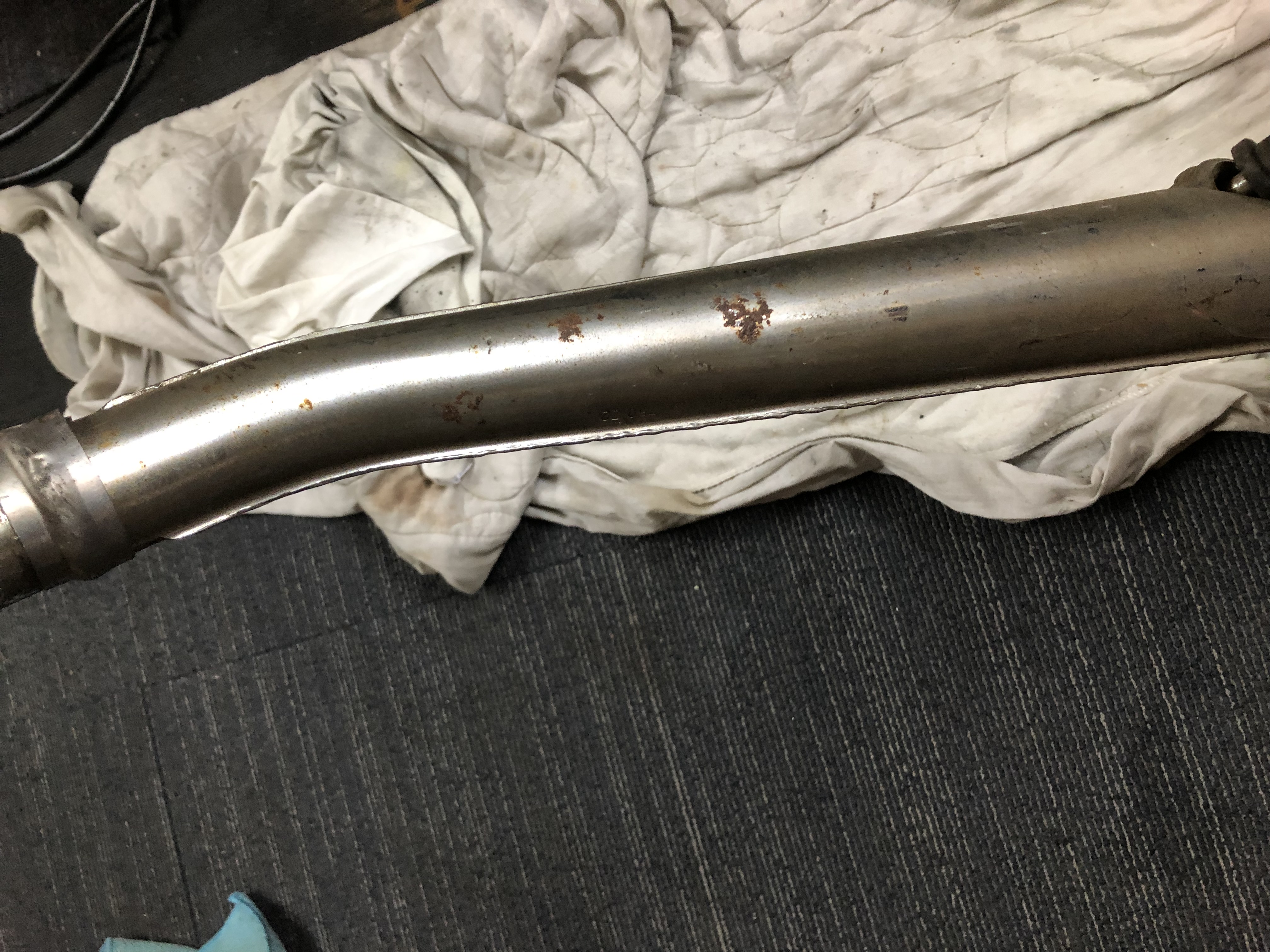

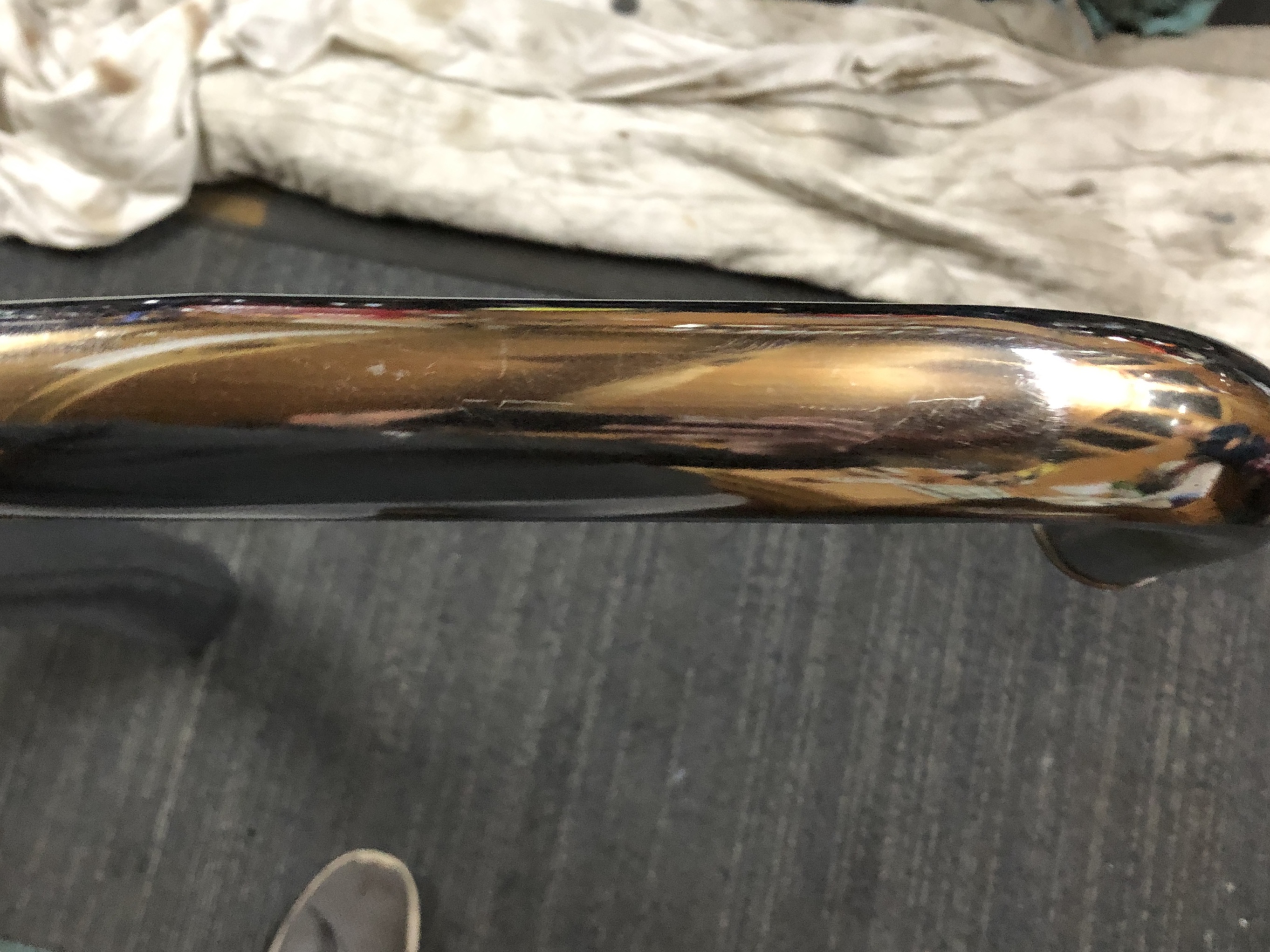

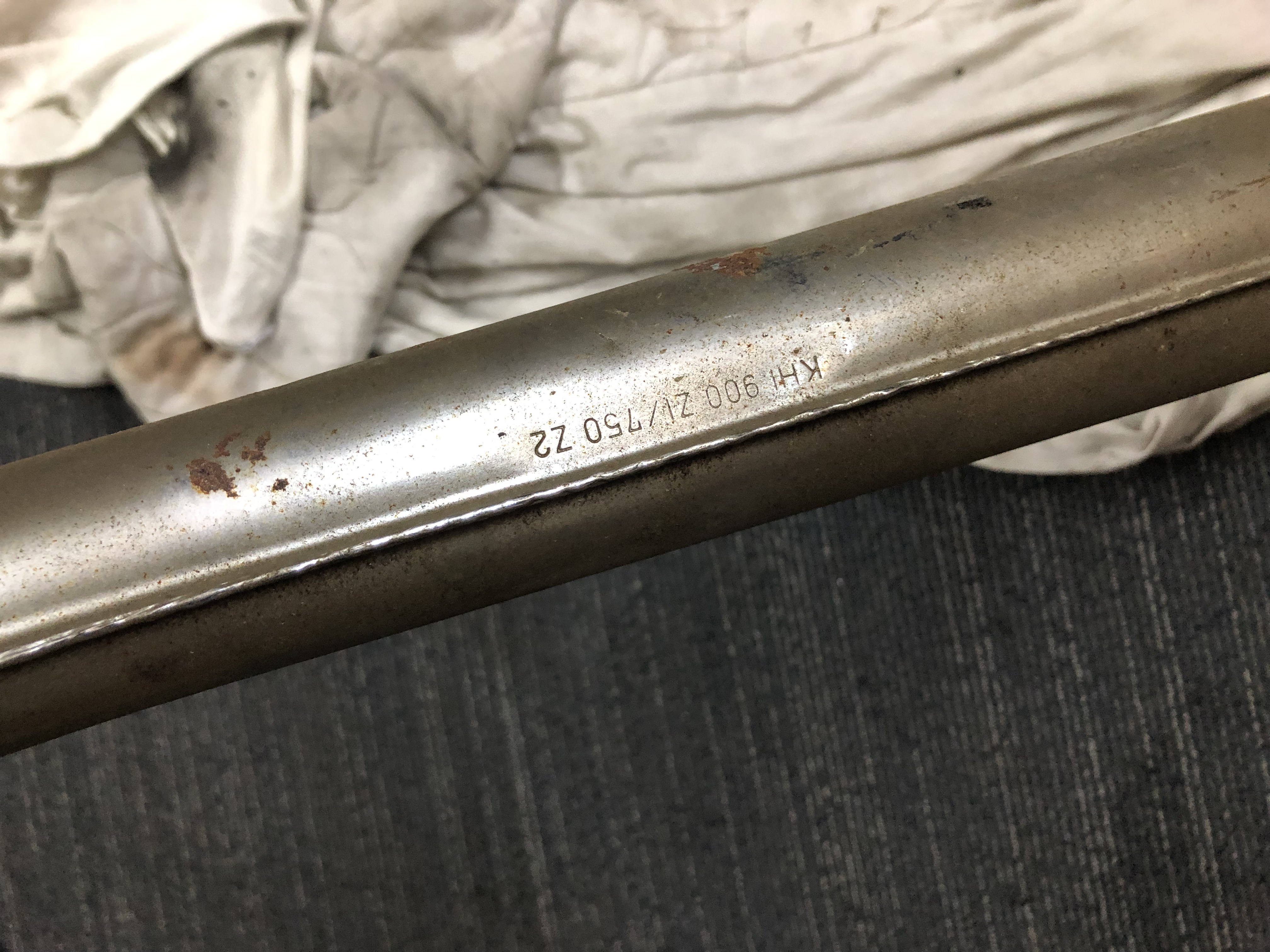

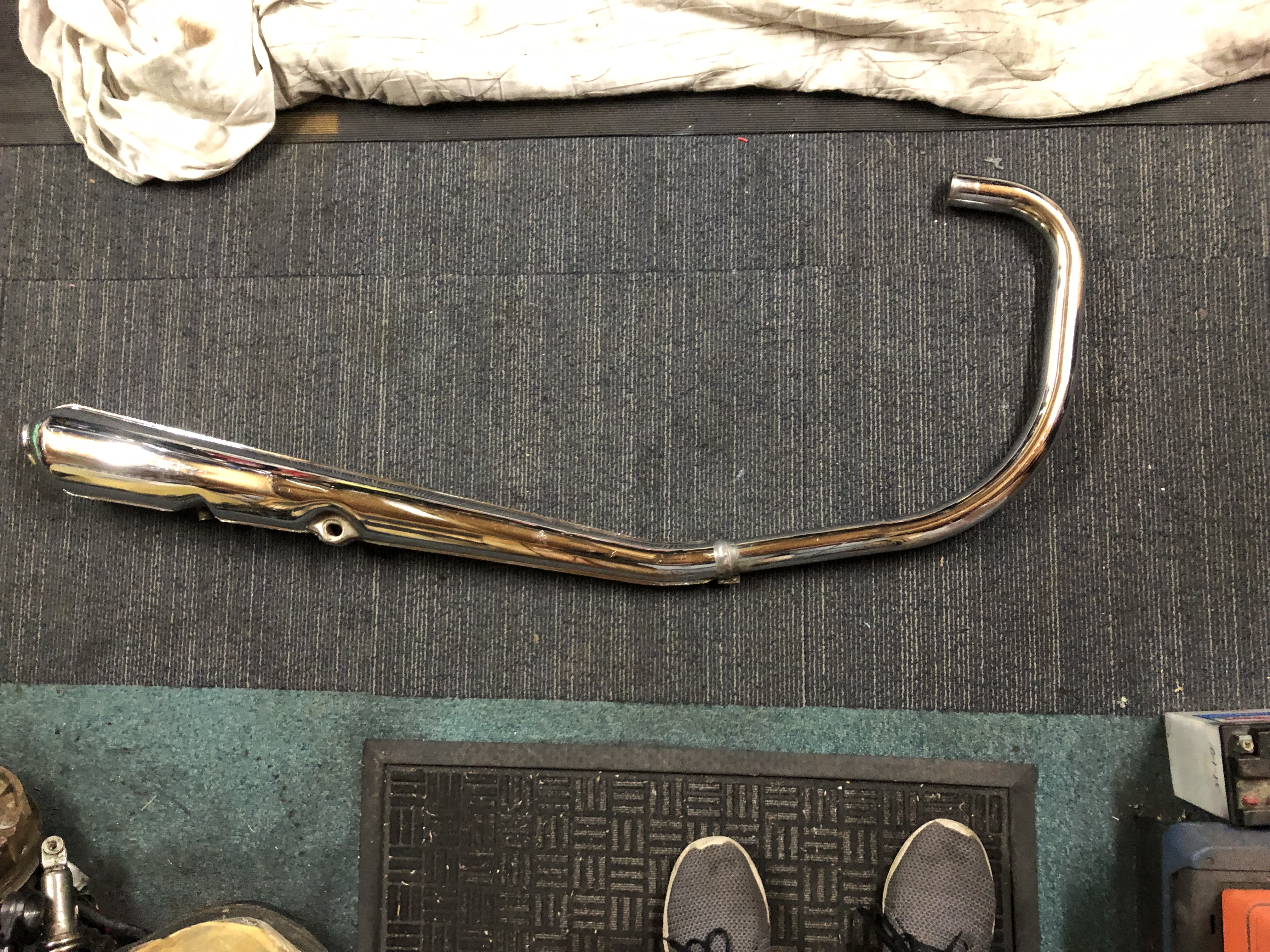

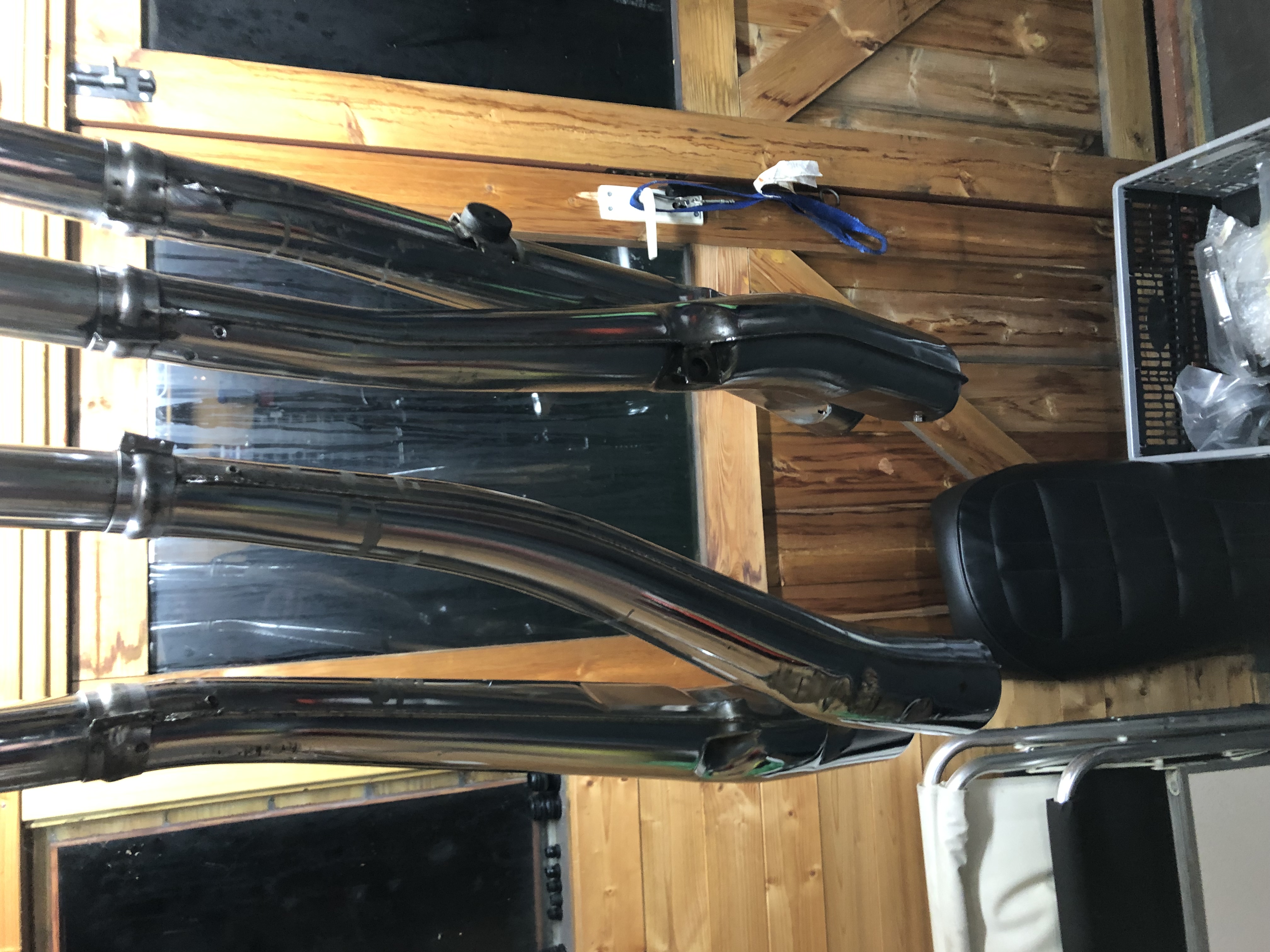

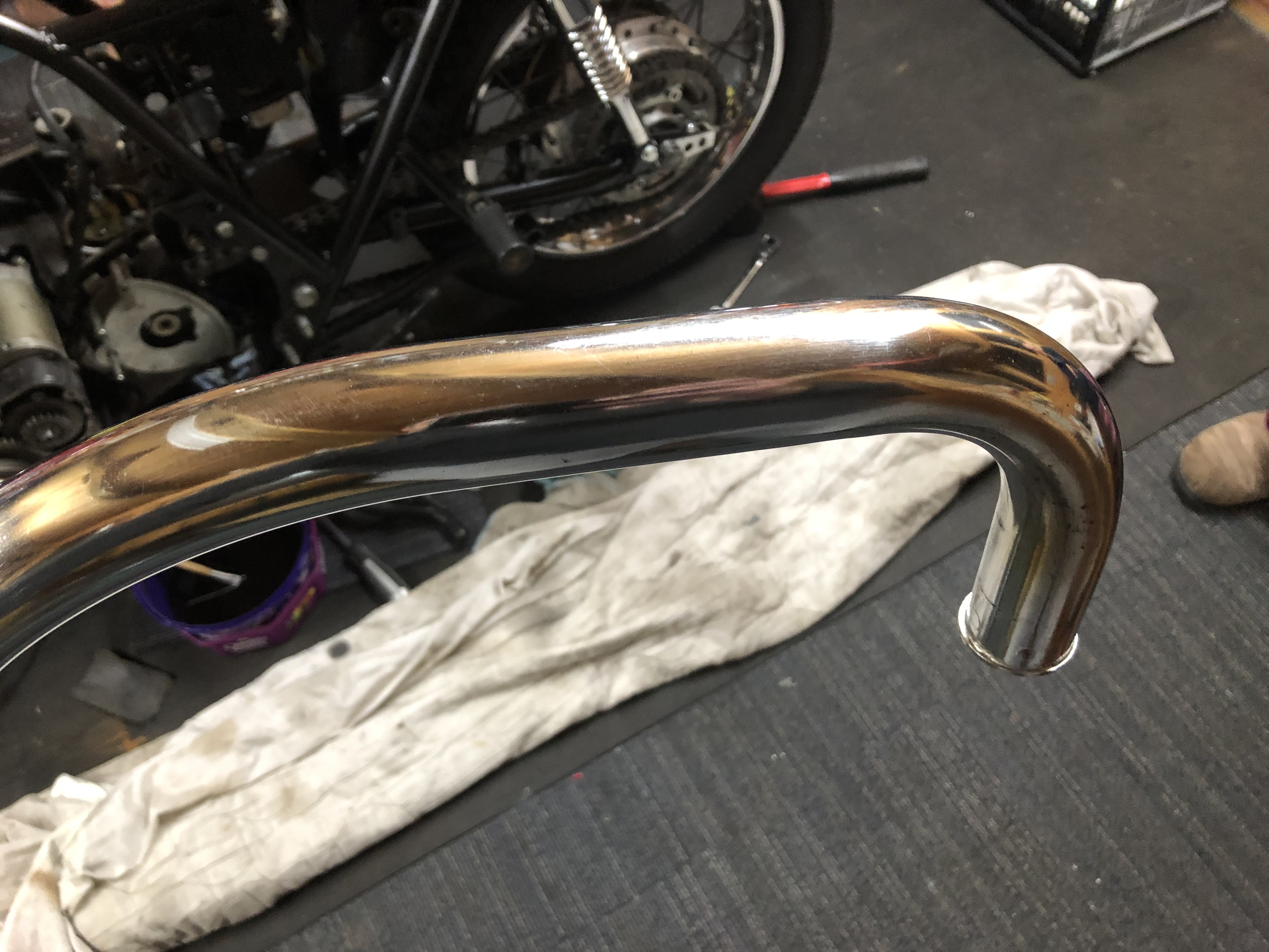

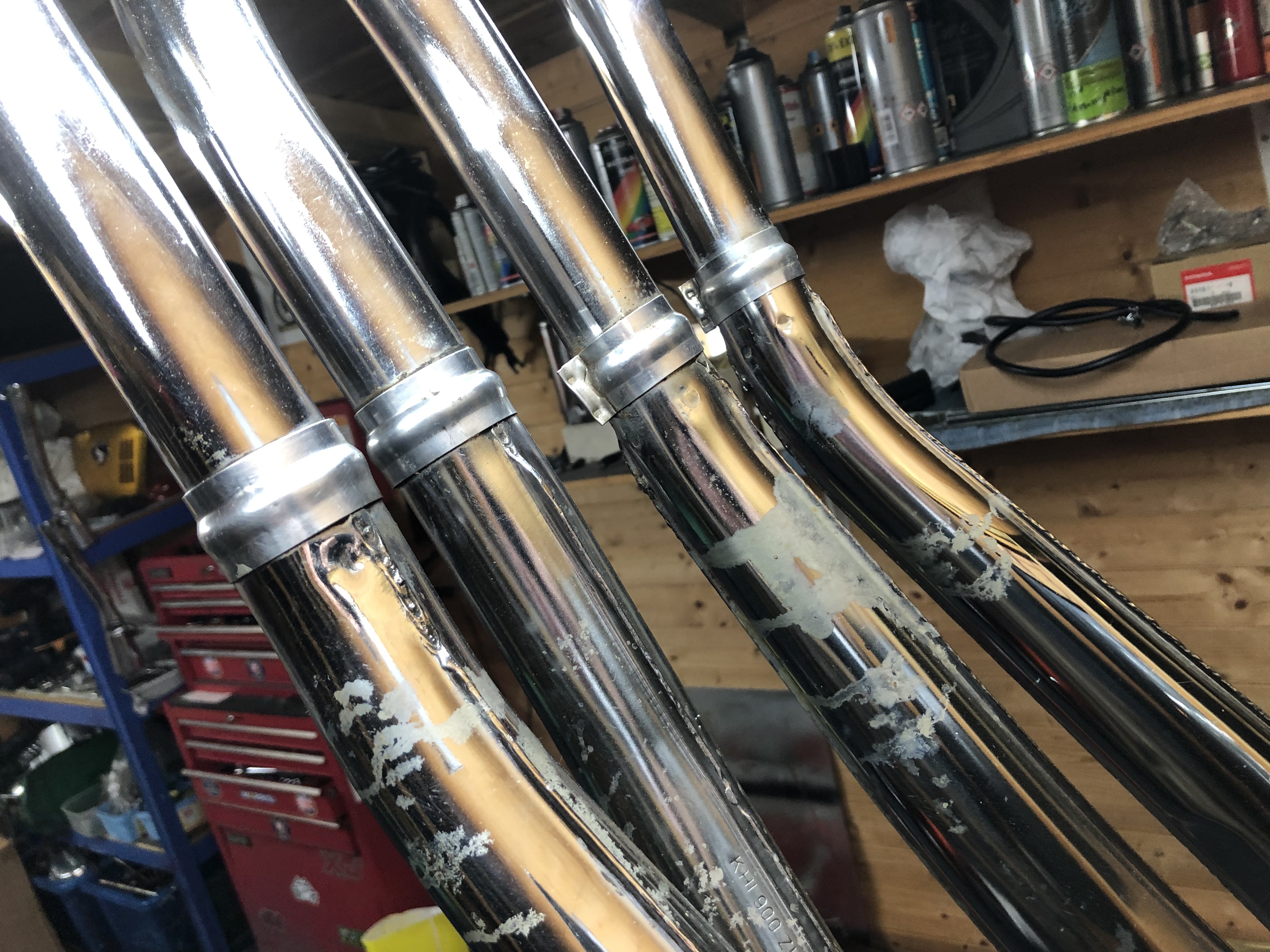

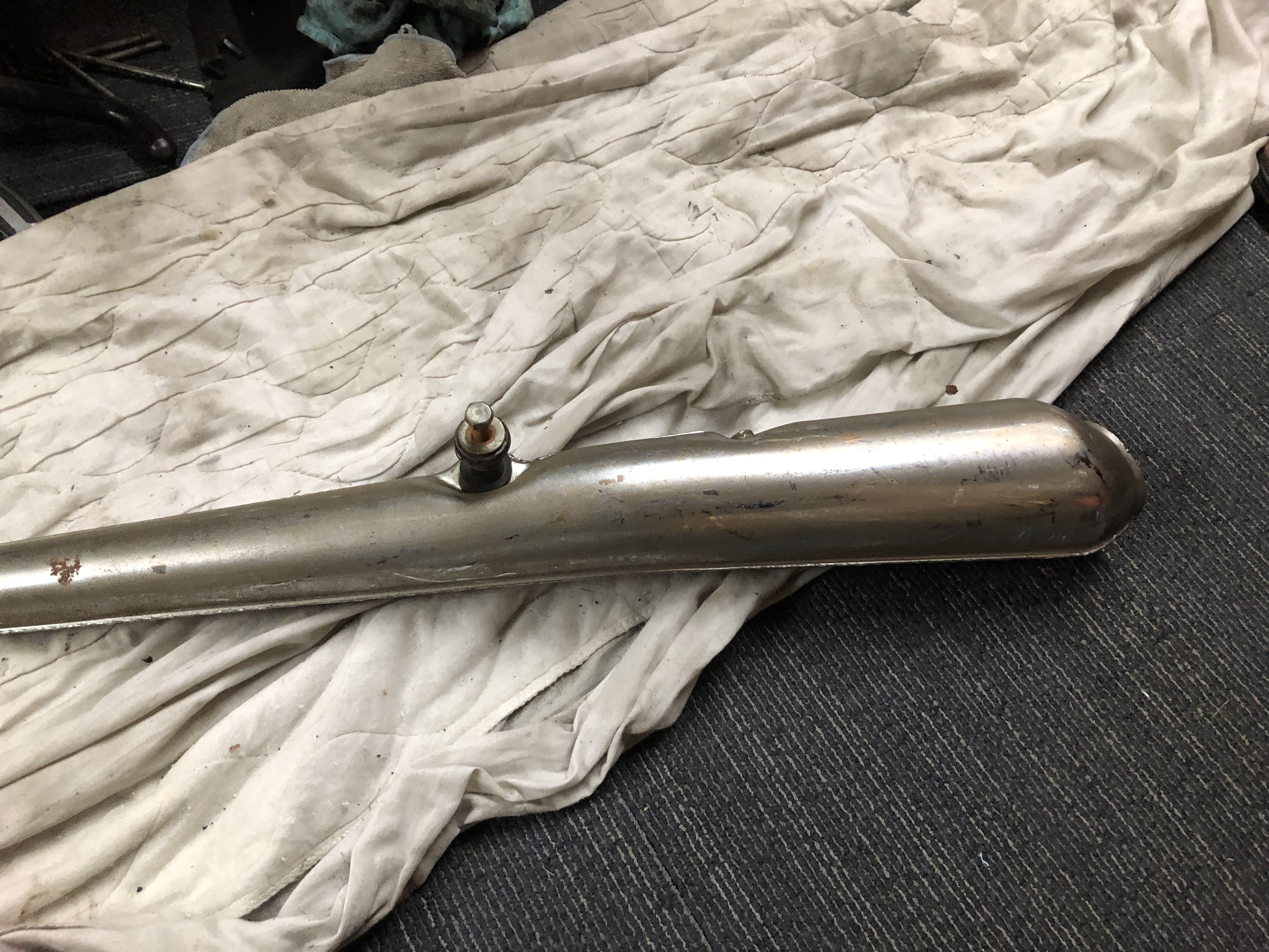

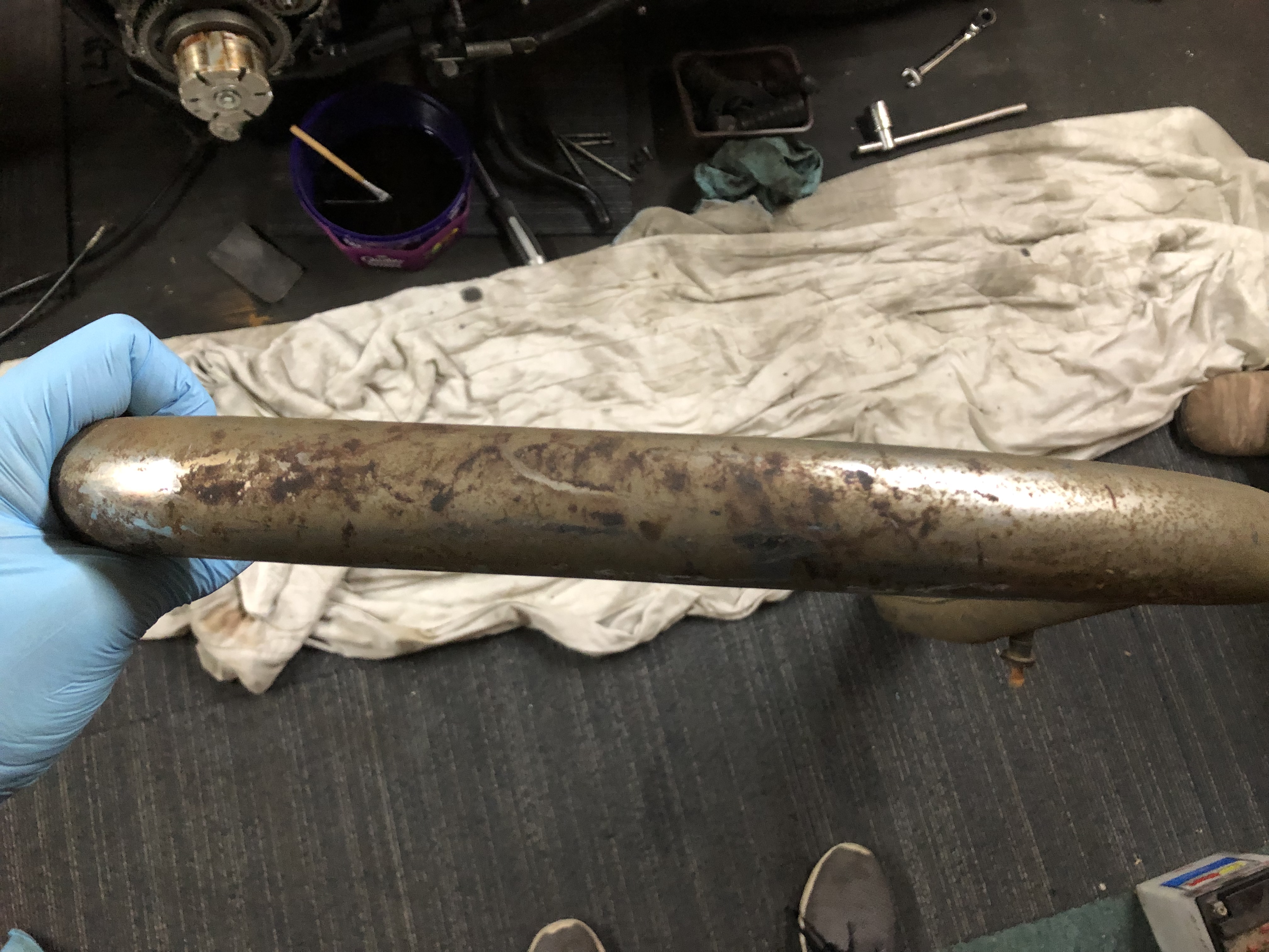

Spent some time cleaning the original exhausts. My go-to polish is now Quick-Glo (supplied by Nigel on the forum). It's superb stuff & leaves a nice wax sealant behind.
Hard surface rust was removed with a brass hand brush (light pressure applied with some WD40 as a lubricant). Given how rough they looked, I'm pleased with the results. I may well invest in a set of unstamped/no-clip pipes in the new year, but for now, these will do & fit the patina of the bike. Just a shame the lower RH pipe has some damage/rash. I imagine finding a correctly stamped, good condition replacement will be nigh-on impossible.
Before pics:
After pics:

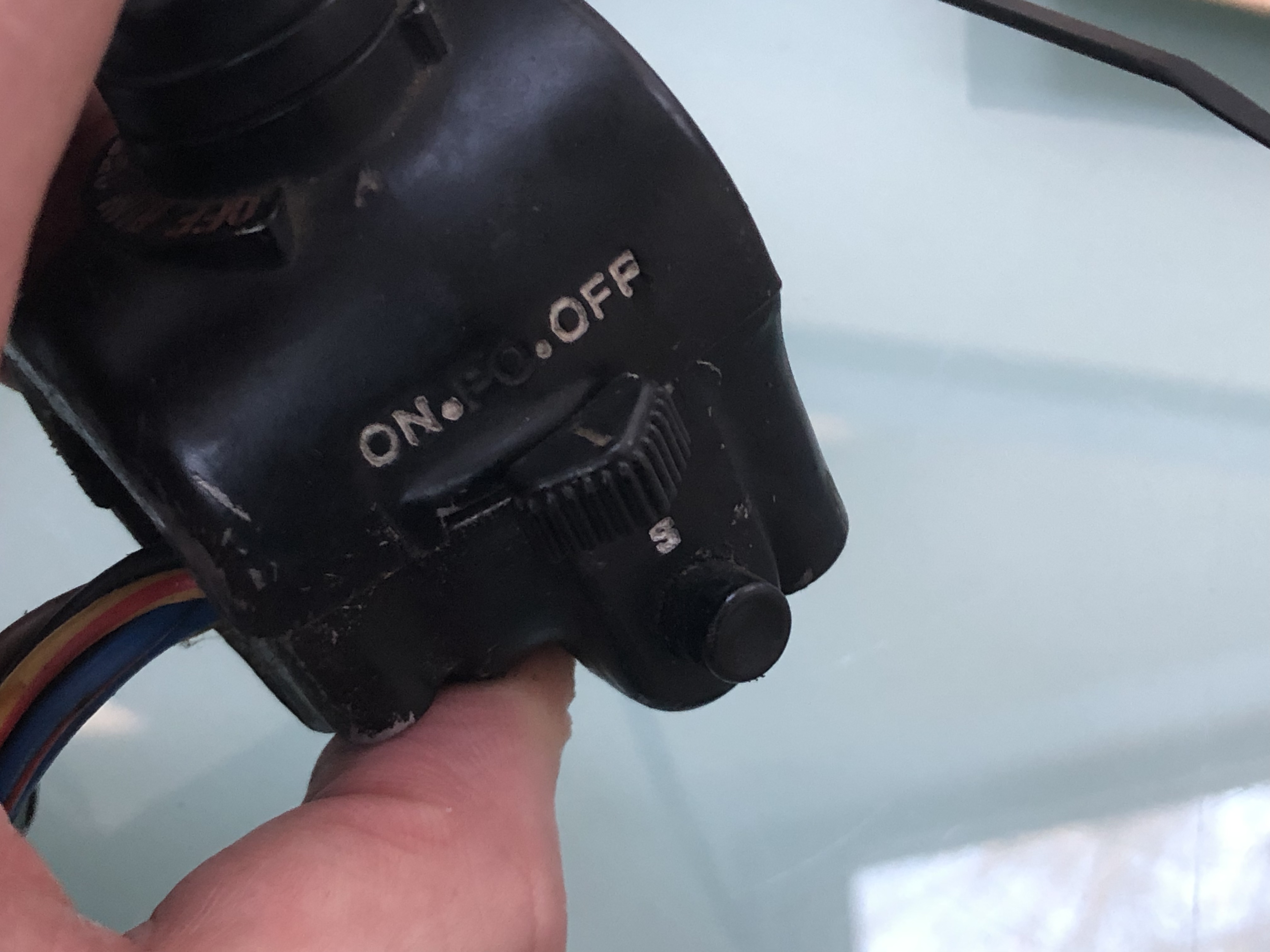

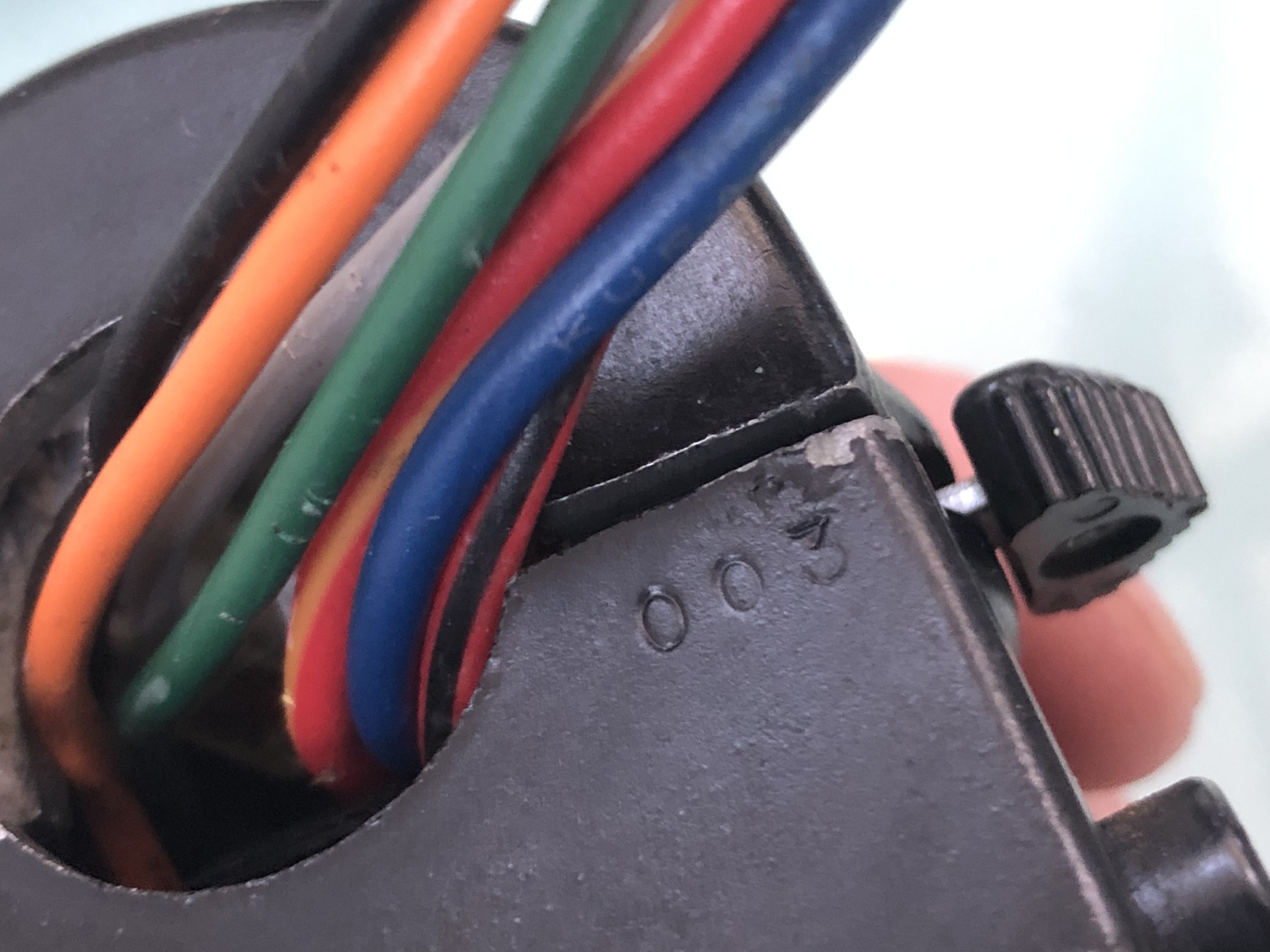

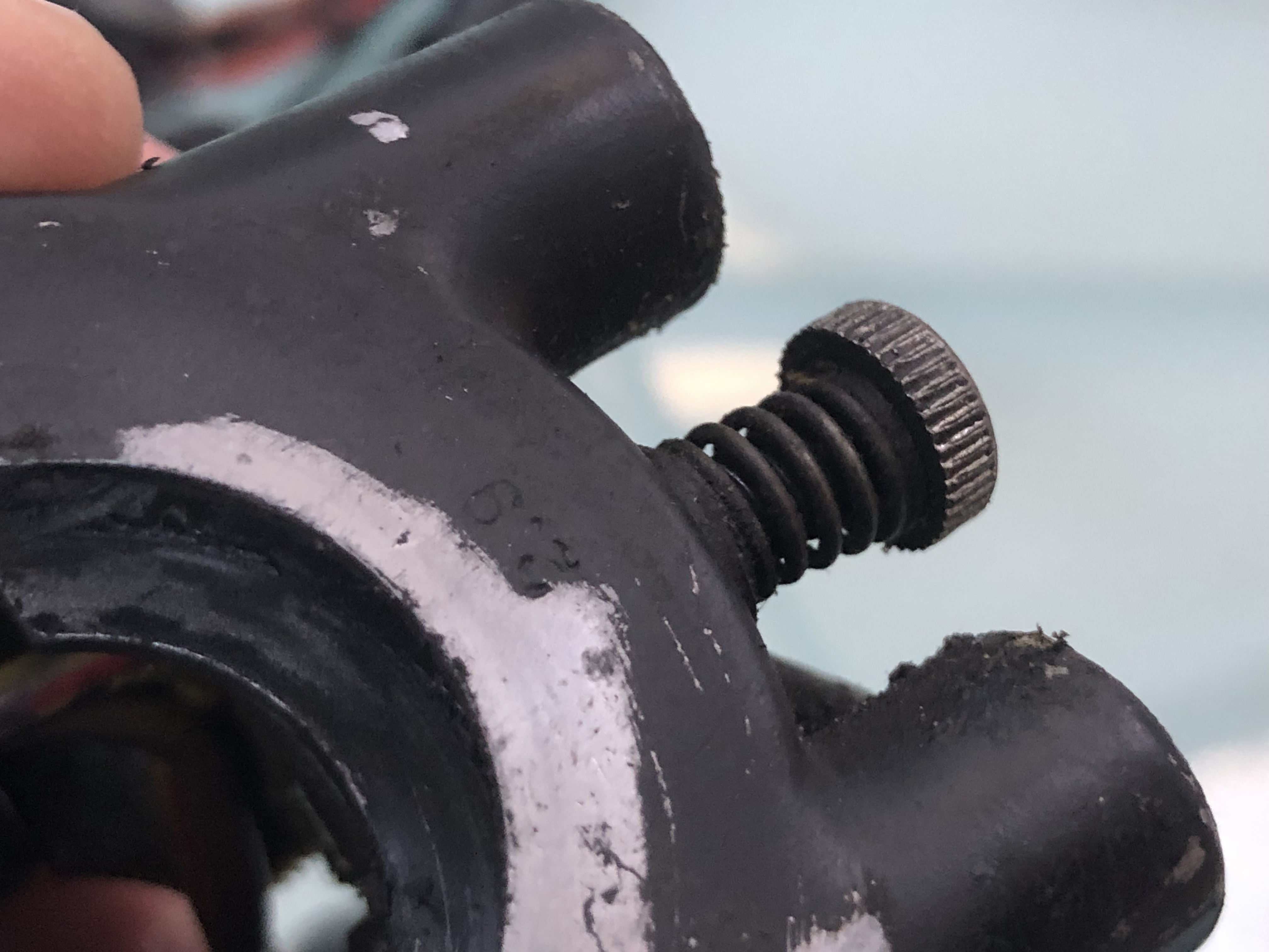

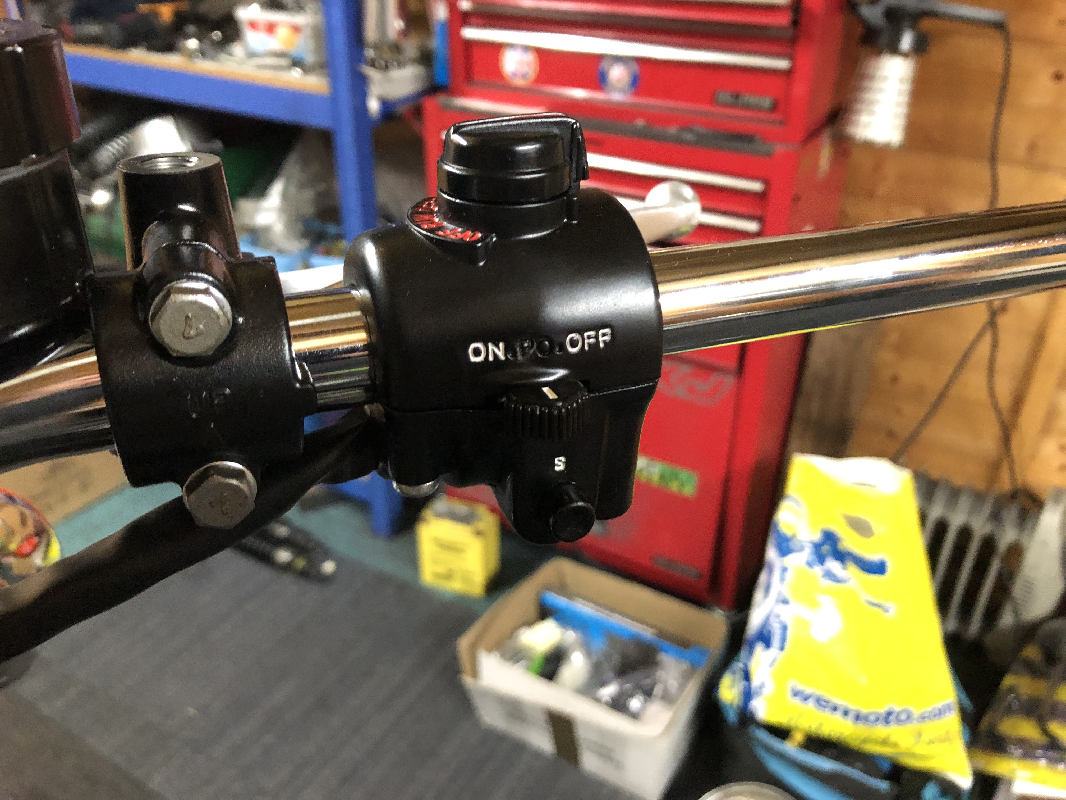

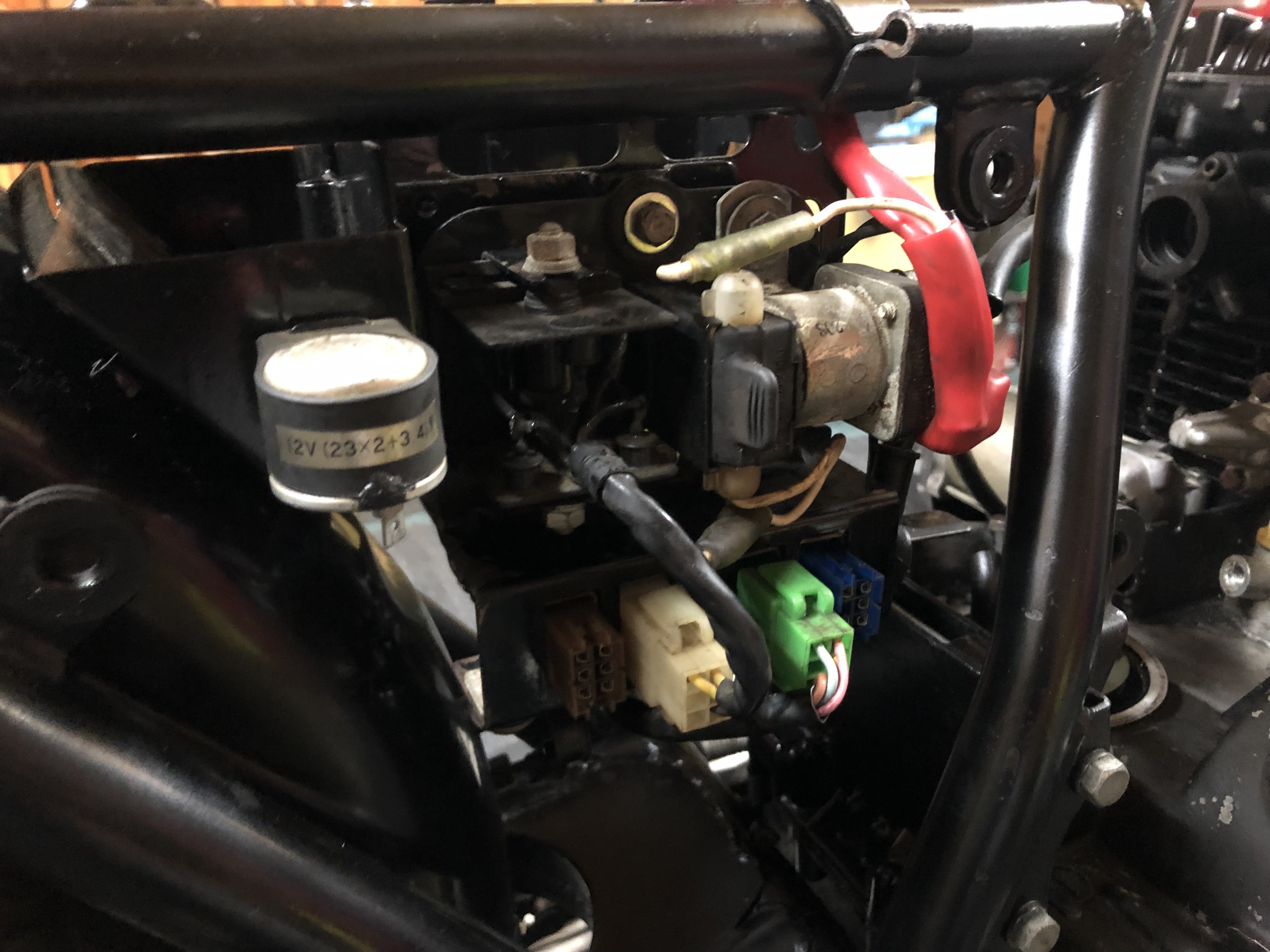

Original electrical panel lightly cleaned & reinstalled:

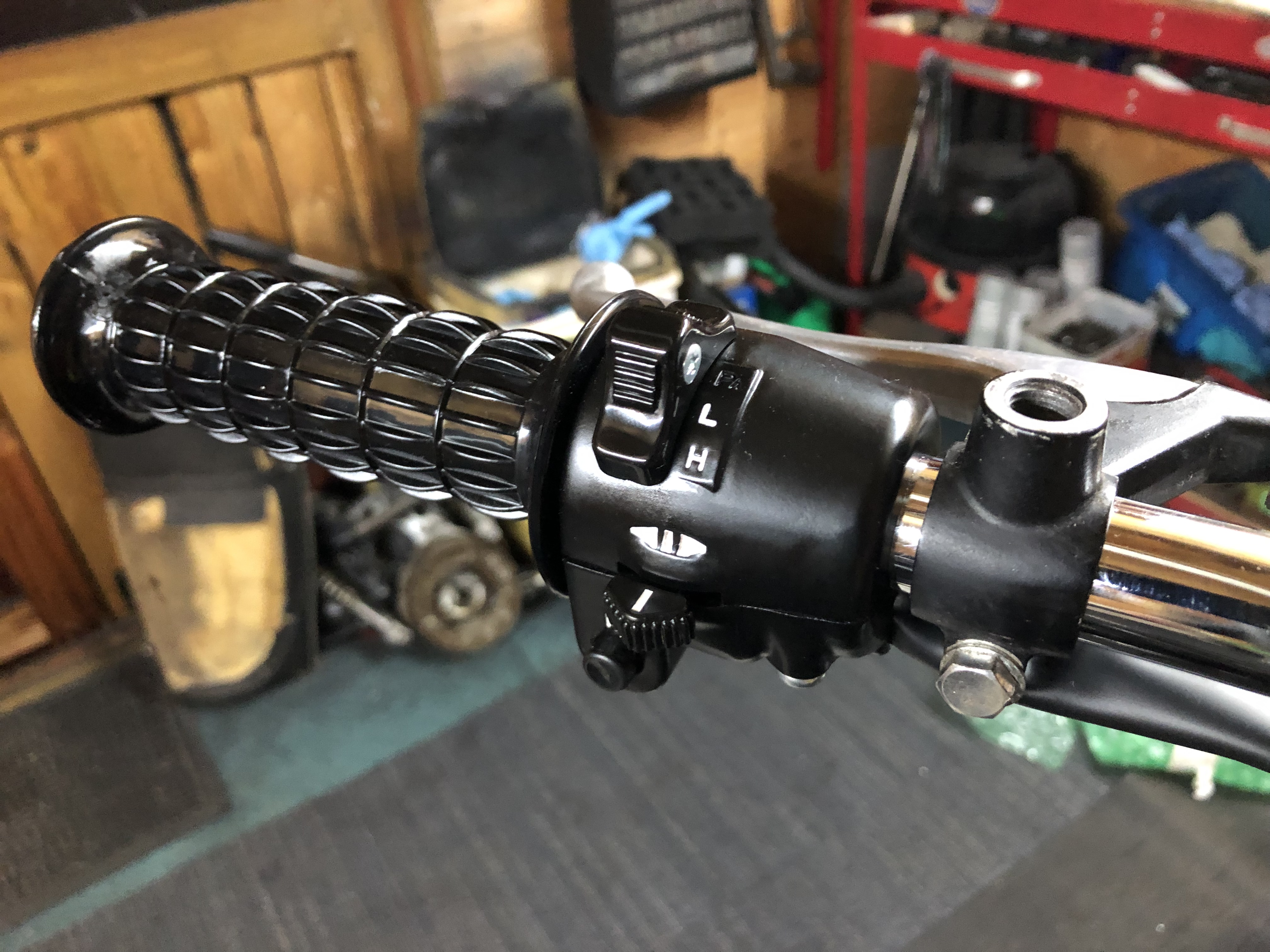

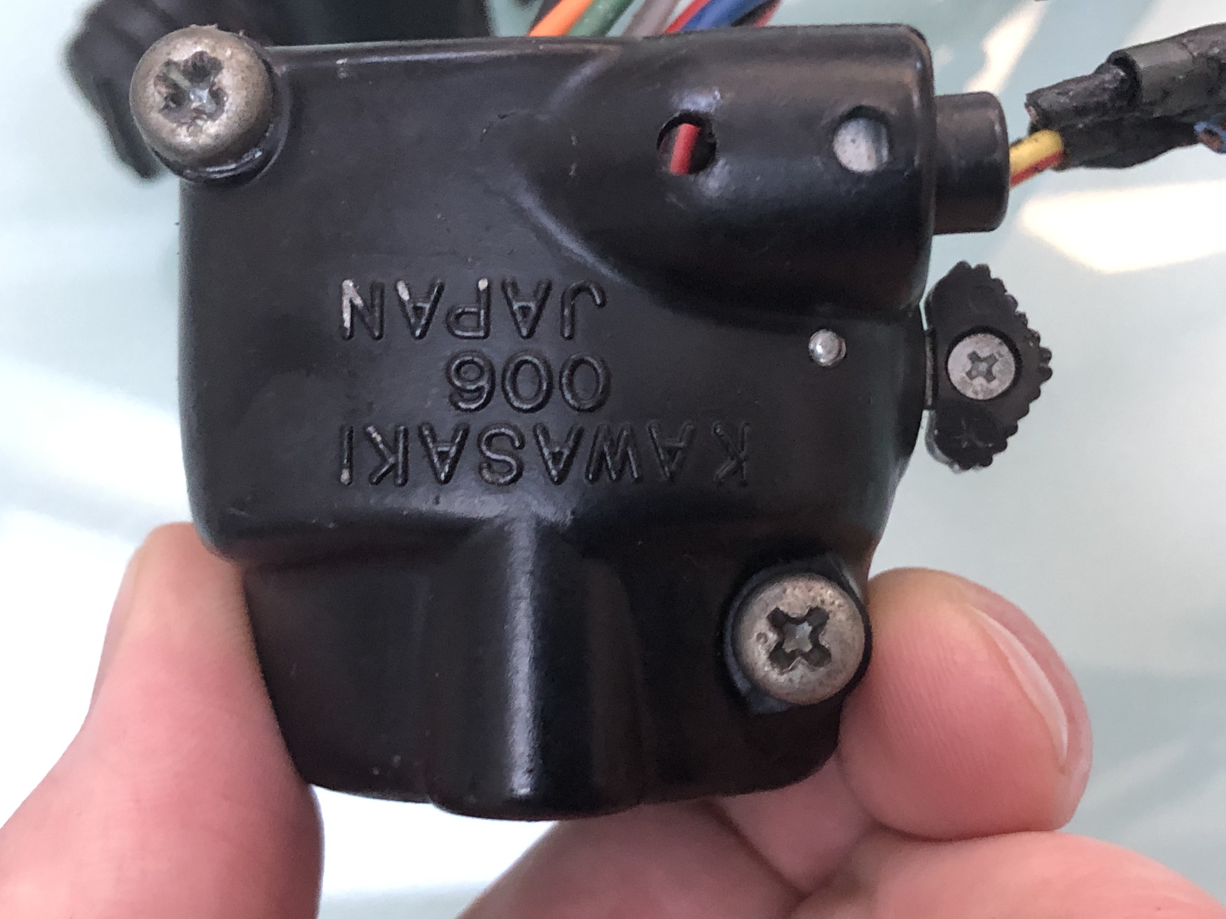

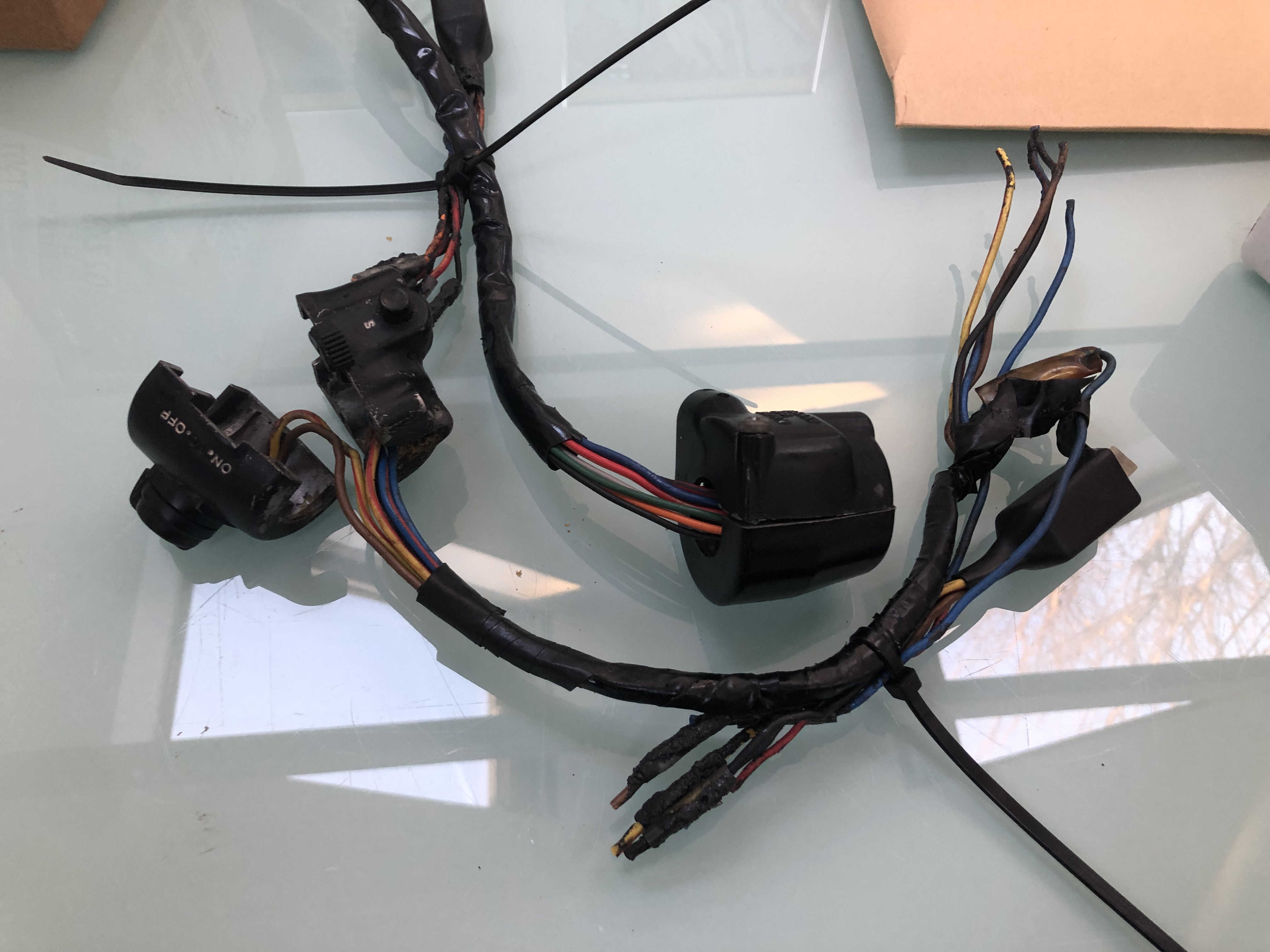

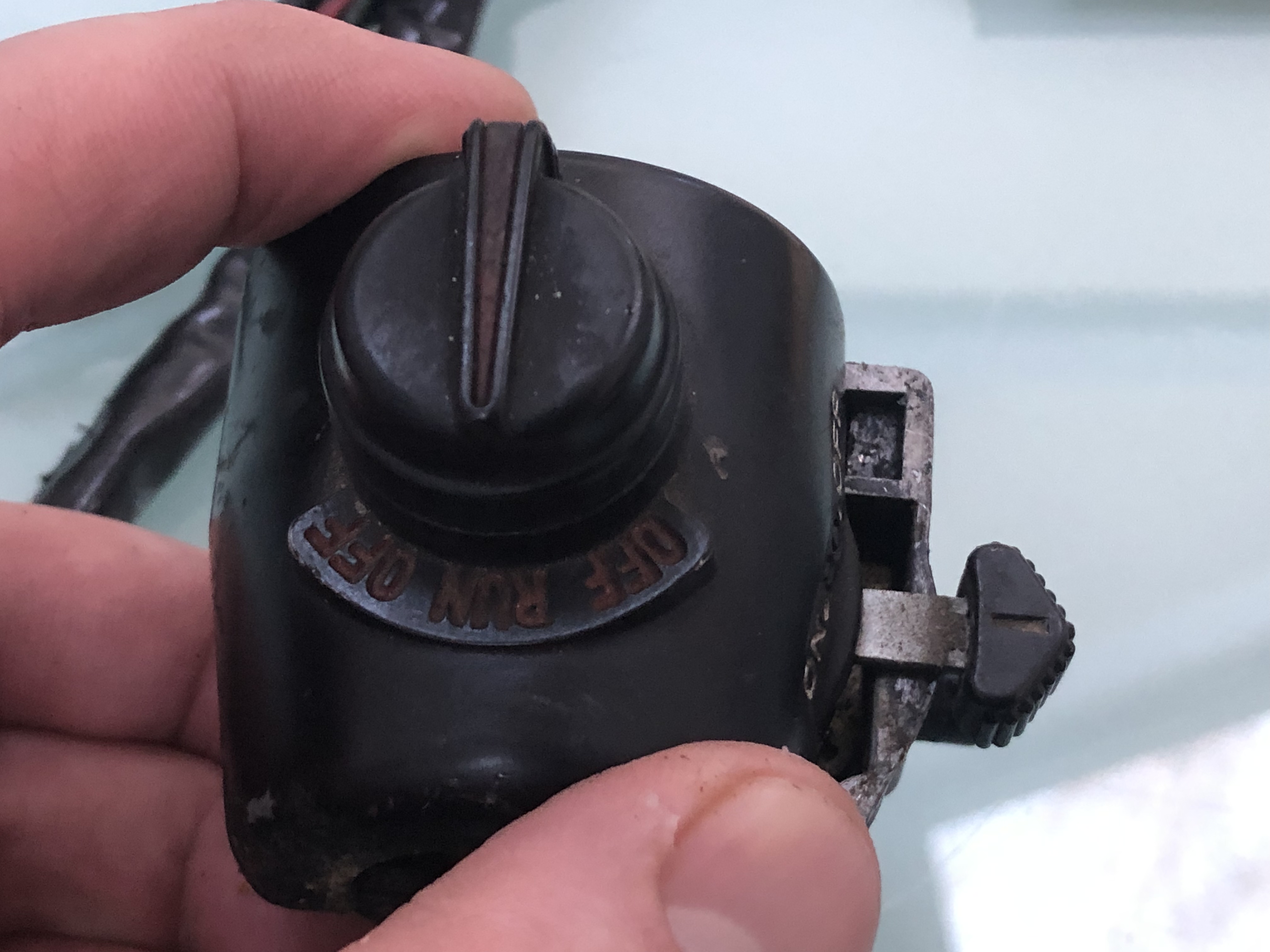

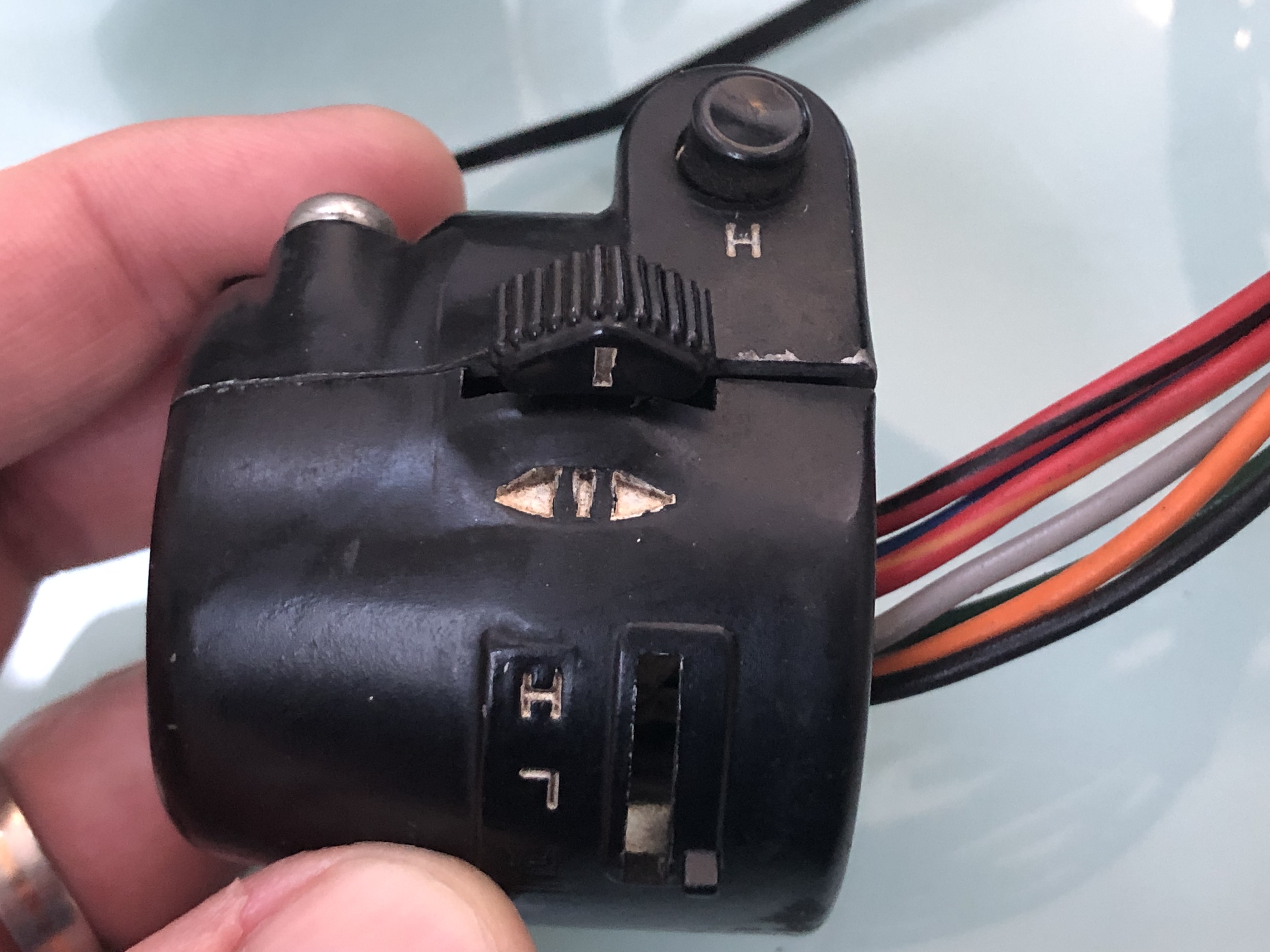

Refurbished switch gear re-fitted (thanks to Brown Critchlowe for doing these for me). Managed to source a NOS Kawasaki LH rocker switch to replace the broken original:
Before refurb:
After refurb:

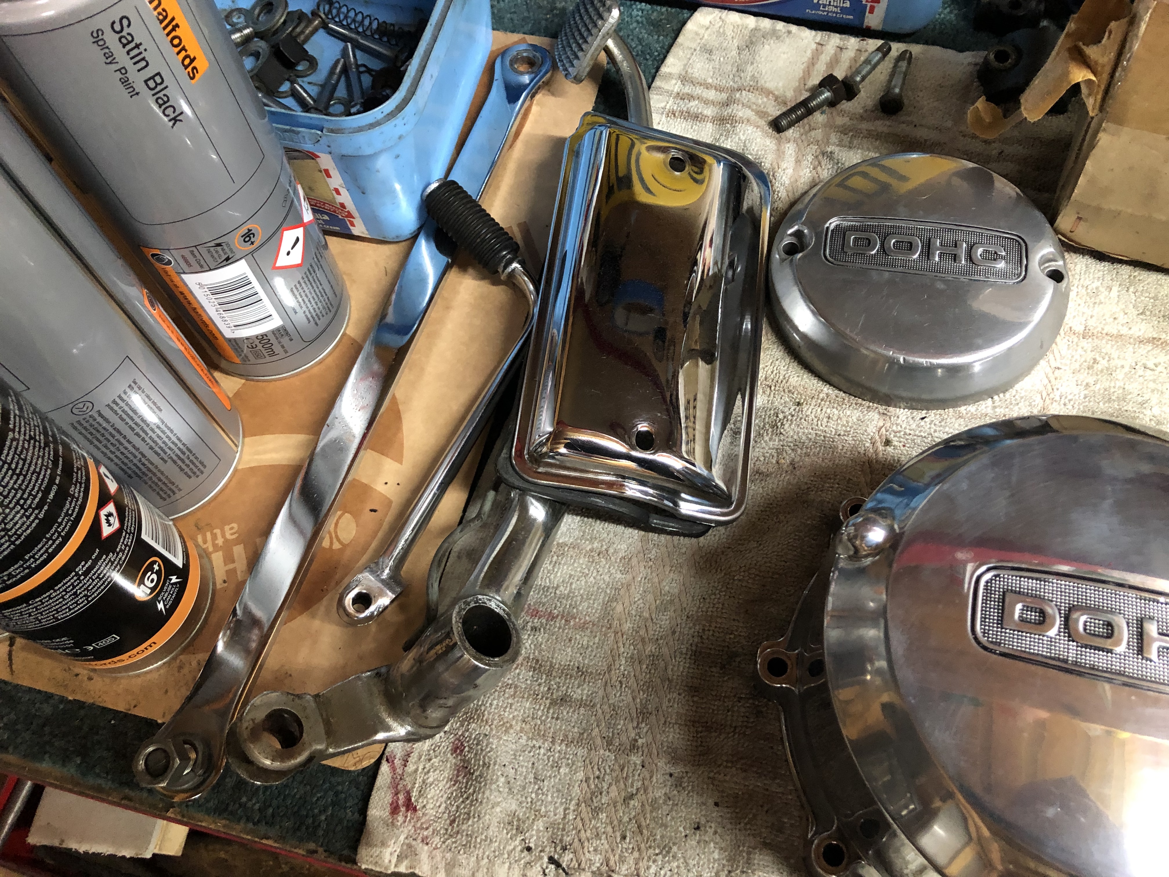

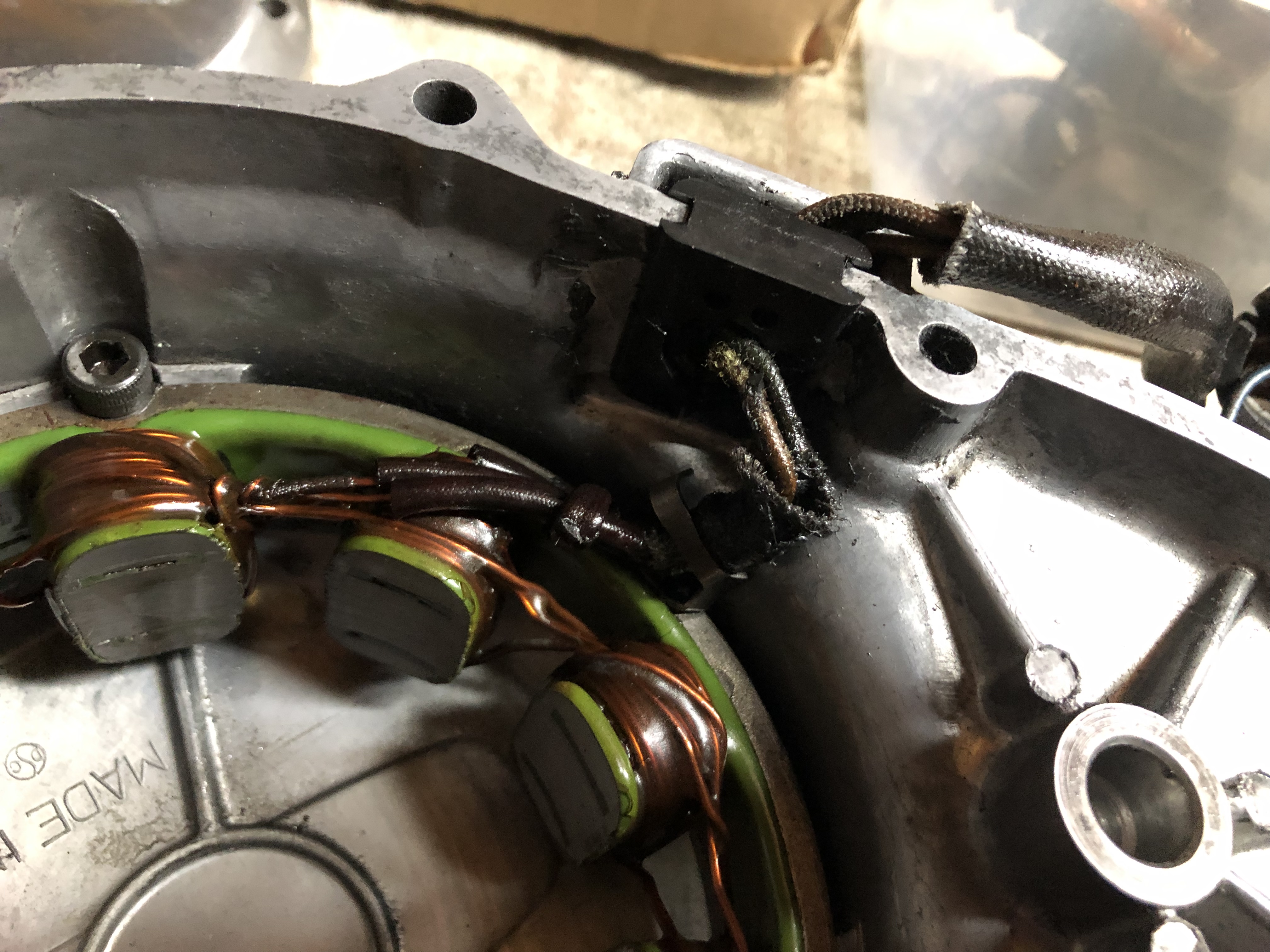

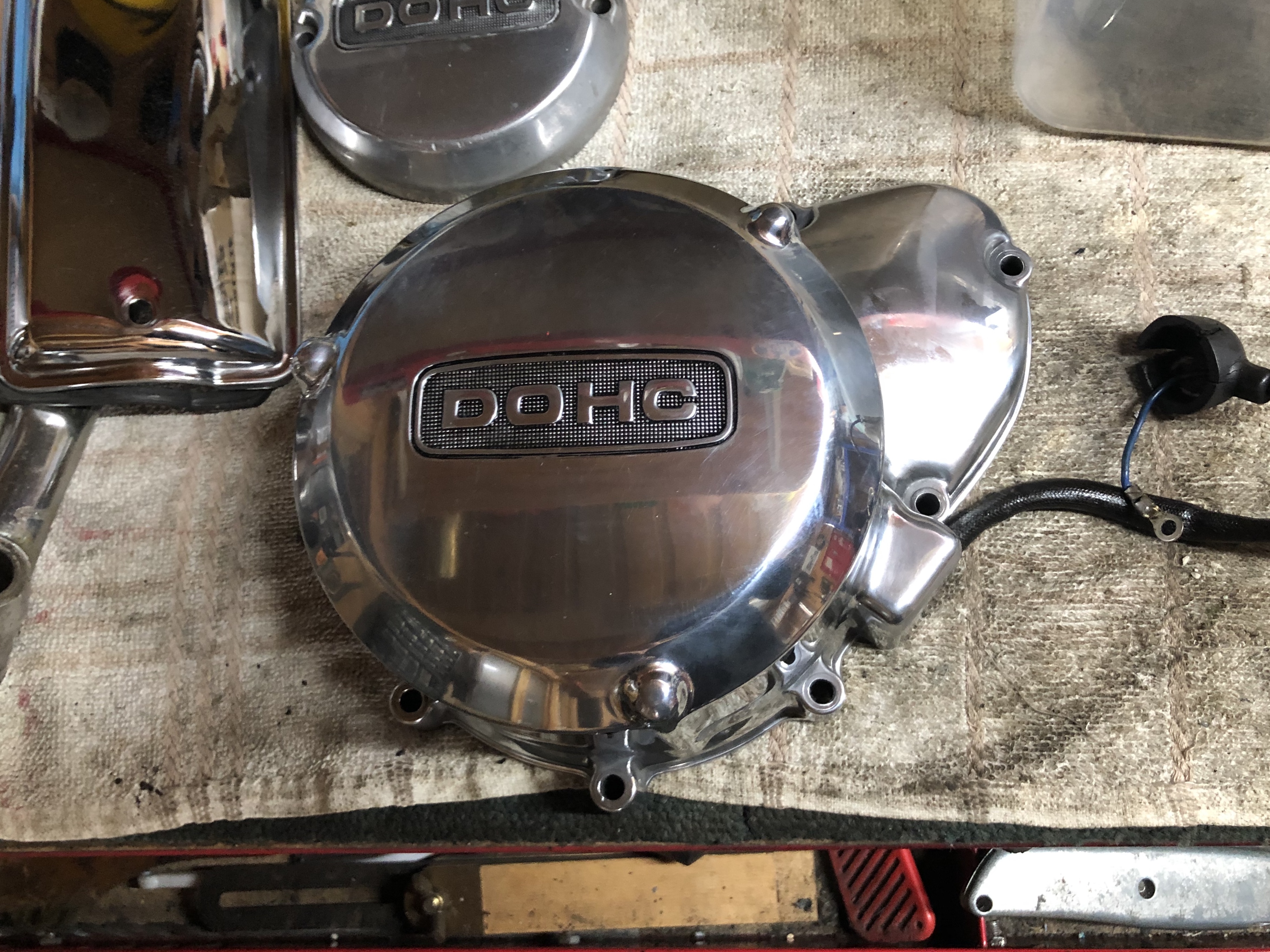

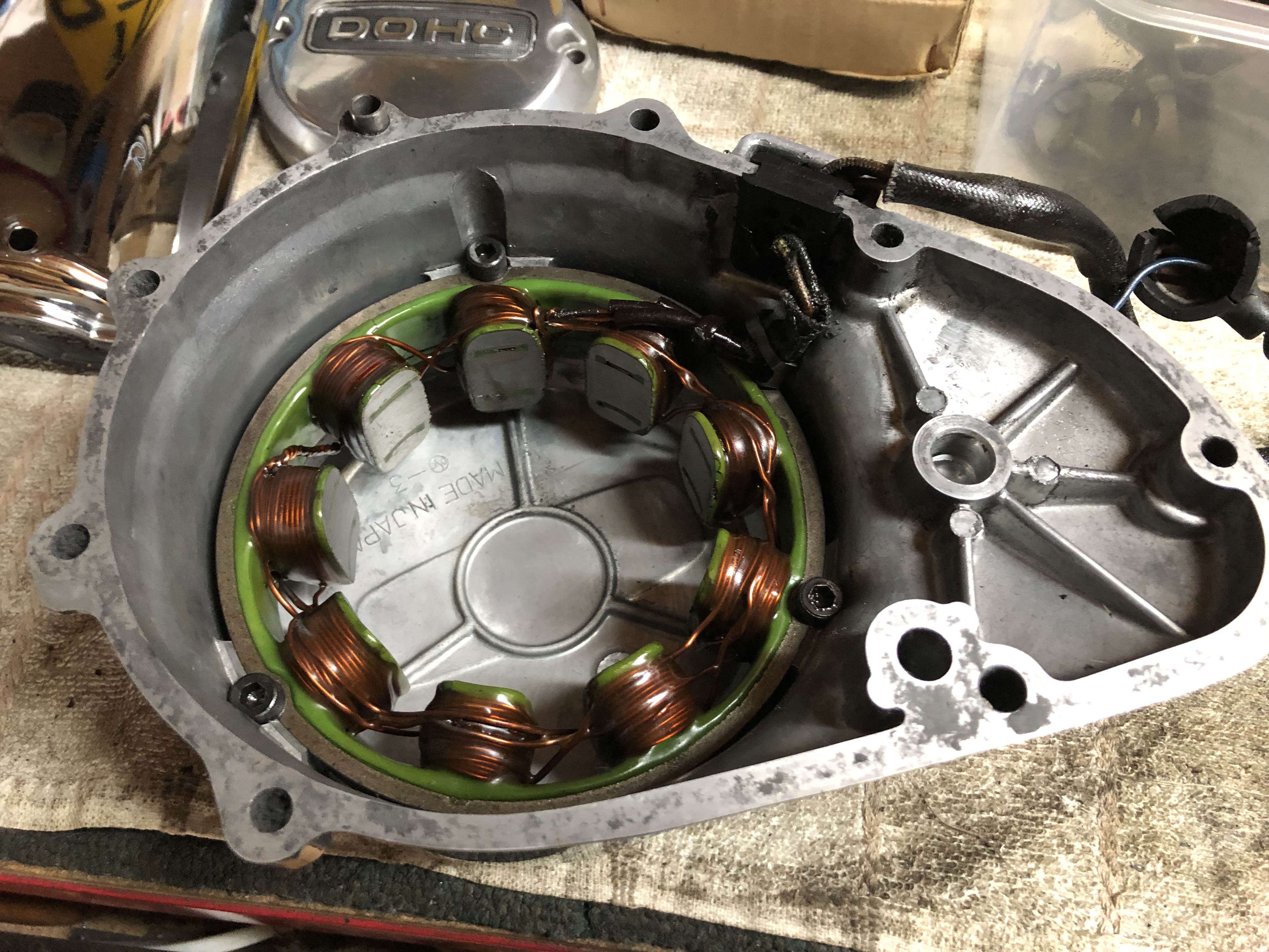

Alternator cover polished & new alternator harness guide grommet fitted - will probably add some black silicone as well to ensure an oil-tight seal:
Original chrome brake stay, brake lever, gearchange lever, starter motor cover polished:

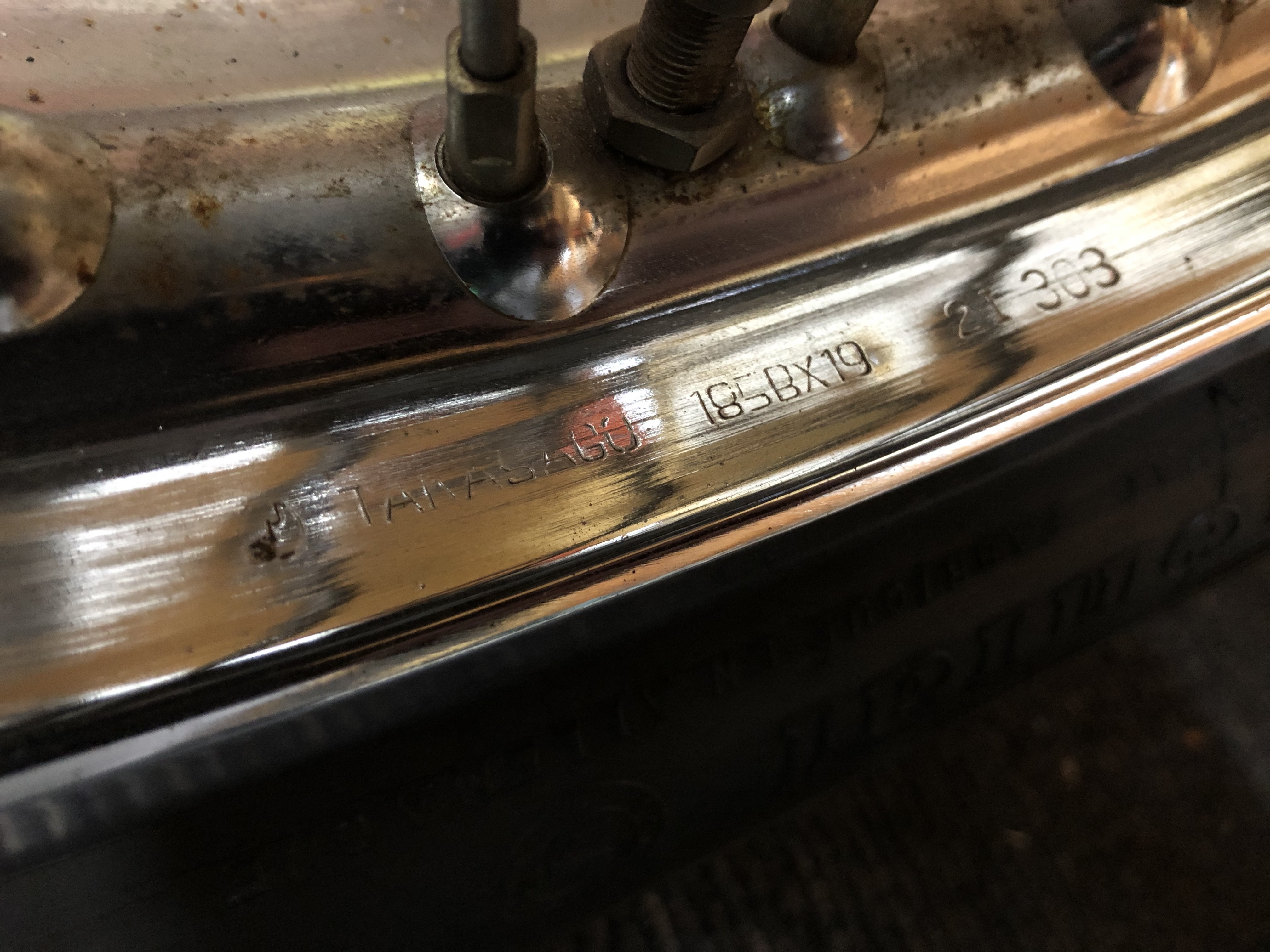

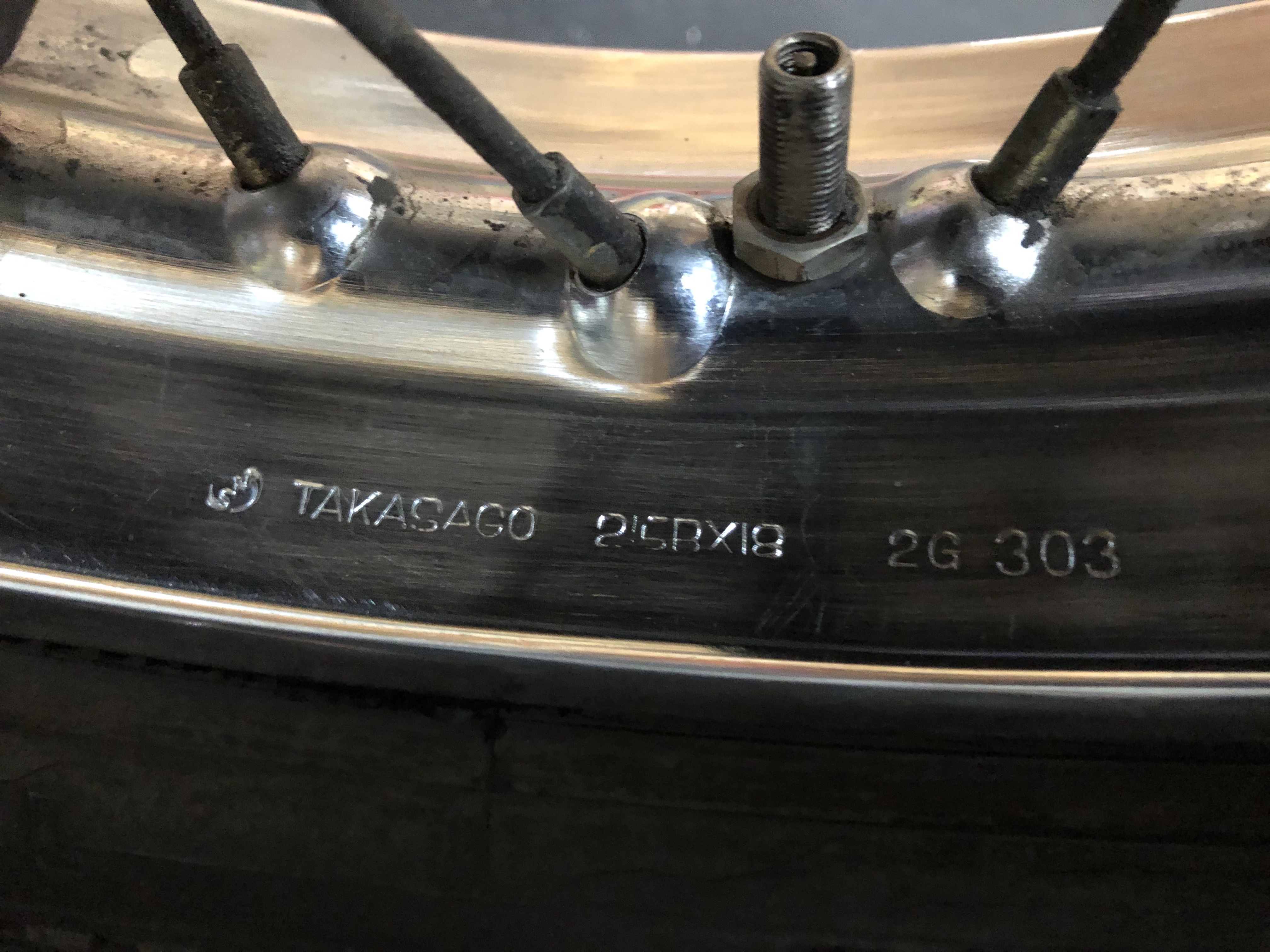

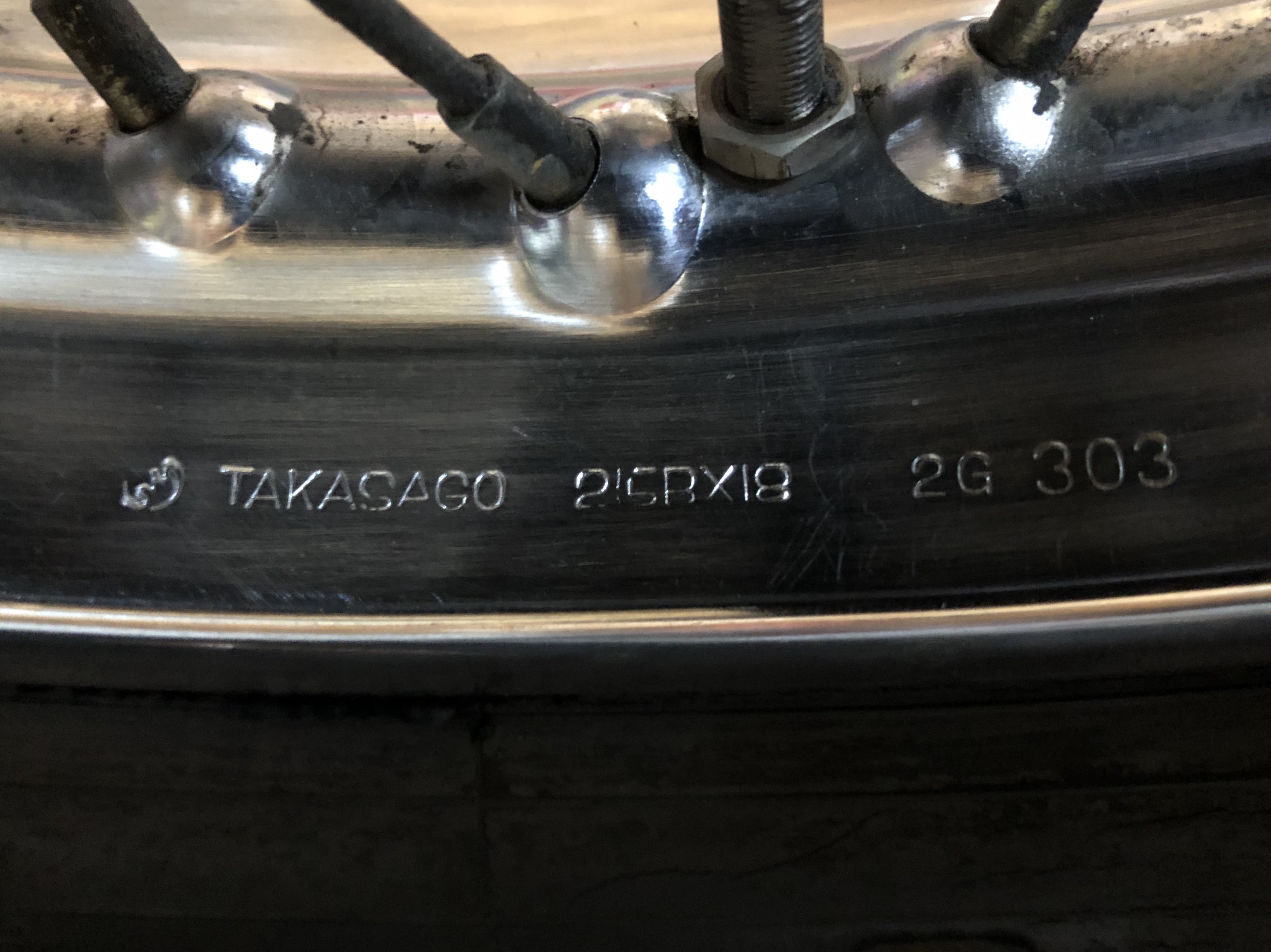

Quickly cleaned the date codes on the rims - seem plausible for a 10/72 date of manufacture for the bike.
Front rim: 2I 303 (September '72)
rear rim: 2G 303 (July '72)

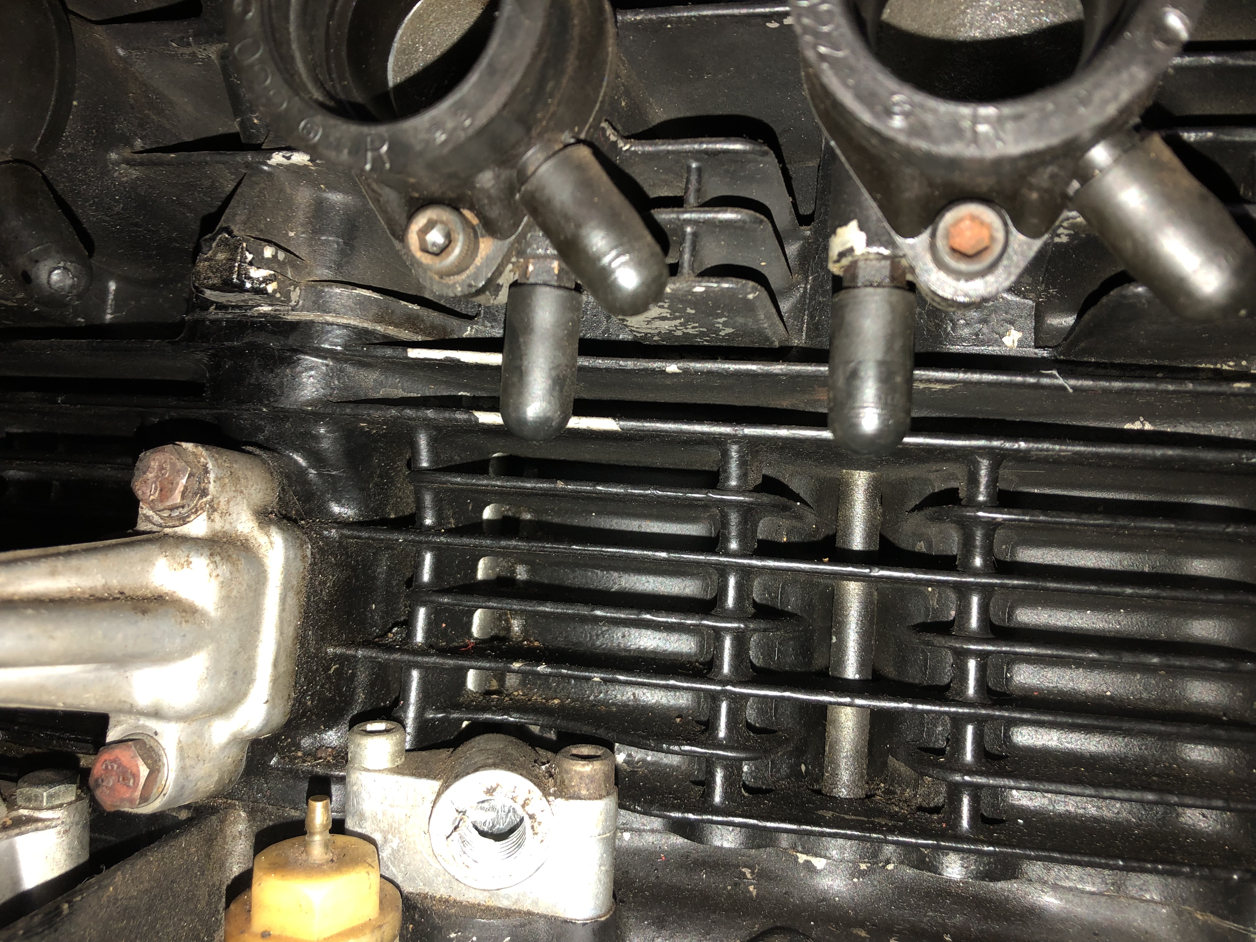

Early head with integrated vacuum take-off ports. The carb holders have obviously been replaced at some point as these have the later integrated vacuum ports as well.
Anyone ever modified these to look like the original early no-stub type? (not sure I can be bothered :blah ).
