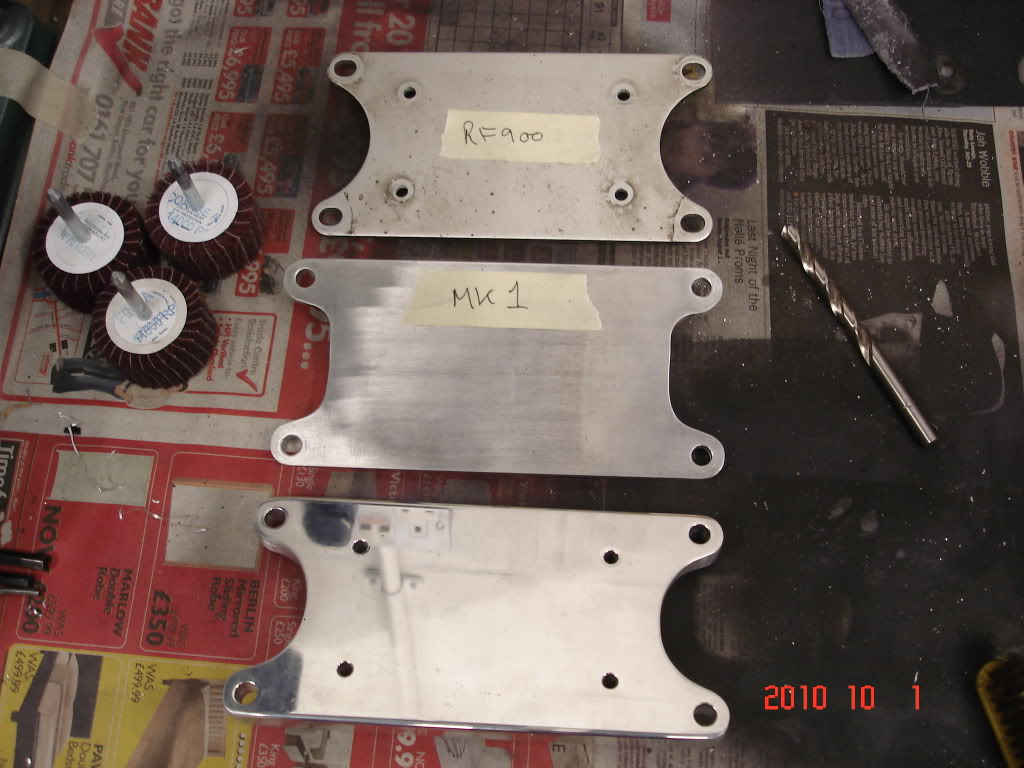

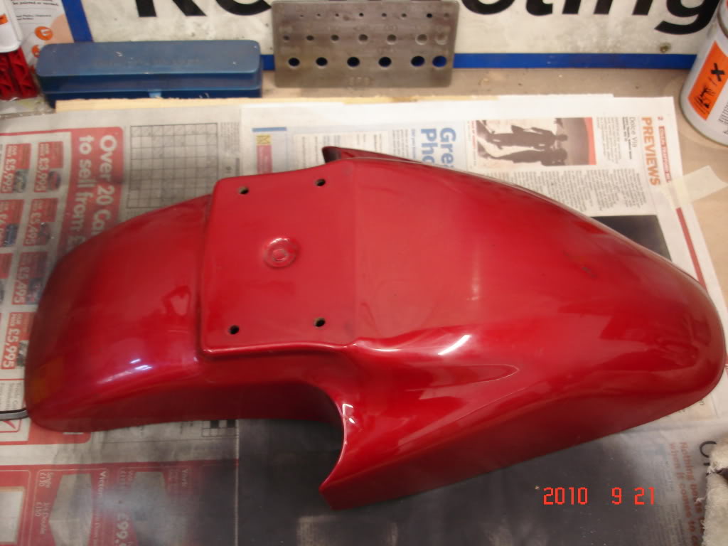

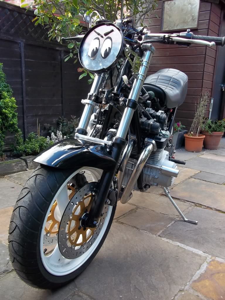

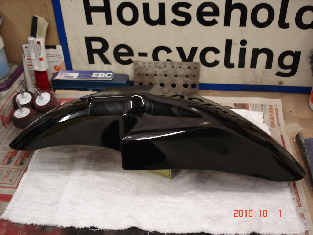

Backtrackin' slightly (pre meltdown) some might remember the front mudgaurd im using - Suzuki RF900, bought from a breakers for a fist full of Yen ( well ...£15 actually) Reason being couldnt find a decent Yam FZR one an this wasnt far off the right dimensions.
Had it sprayed locally for a trade of a few beers (cheers Andy) in 2 pack and then made a fork brace to mount it - material blagged from M&A sheet metal (cheers Smett)
Anyhow that was all sooo last year an finally got round to doin' summat with all these bits an bobs.

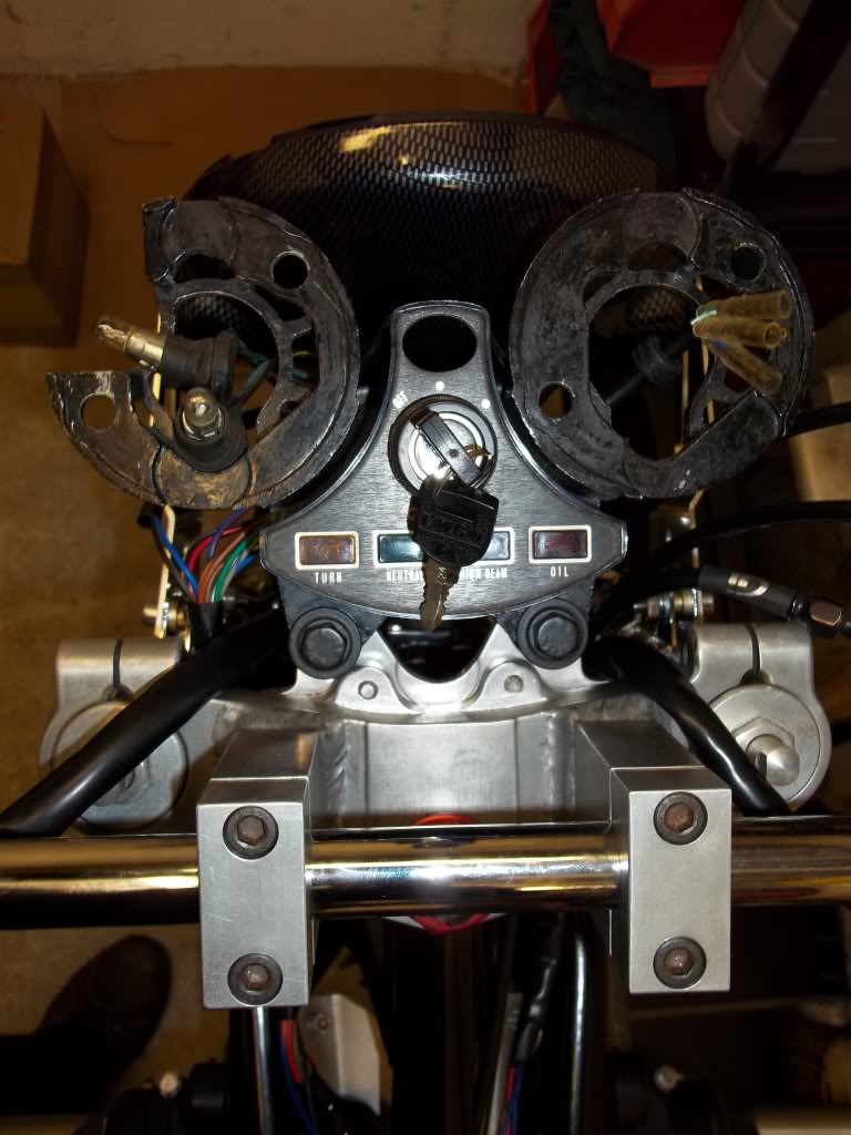

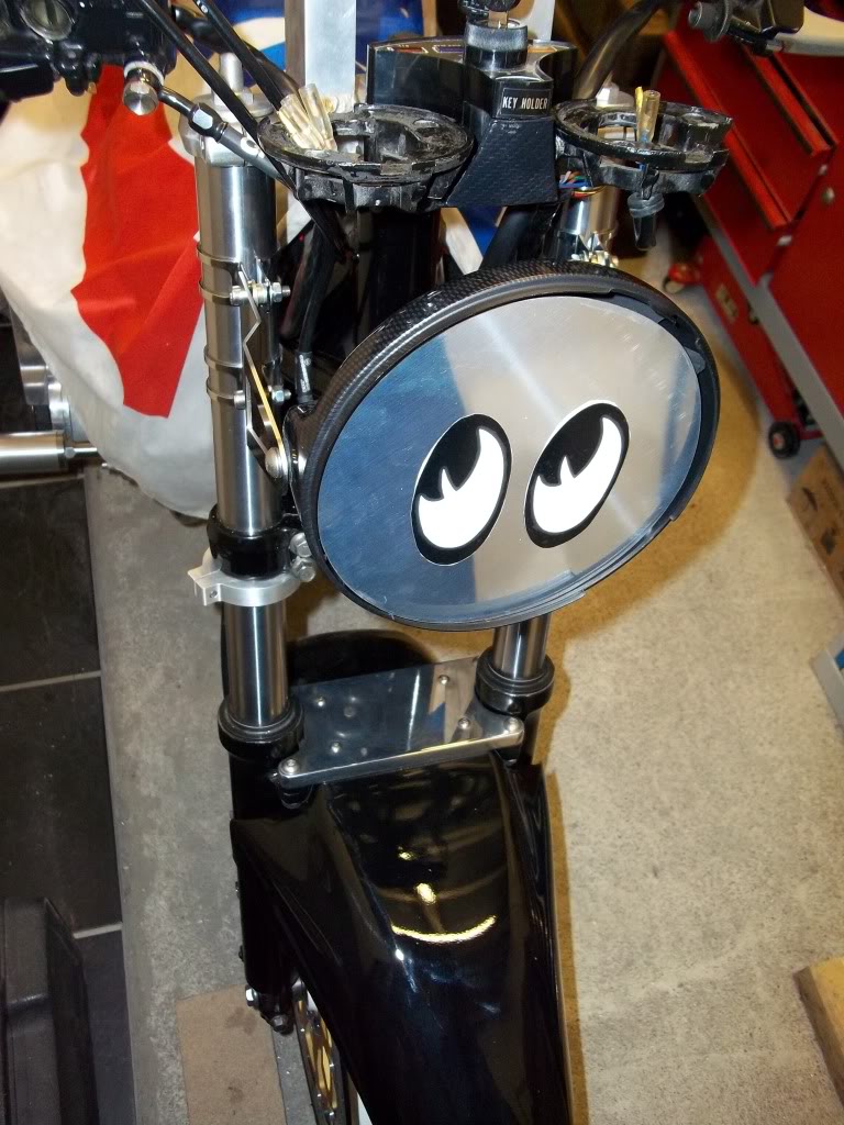

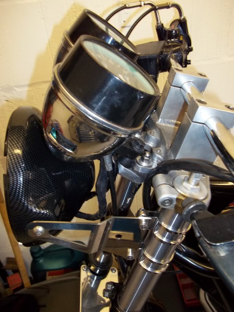

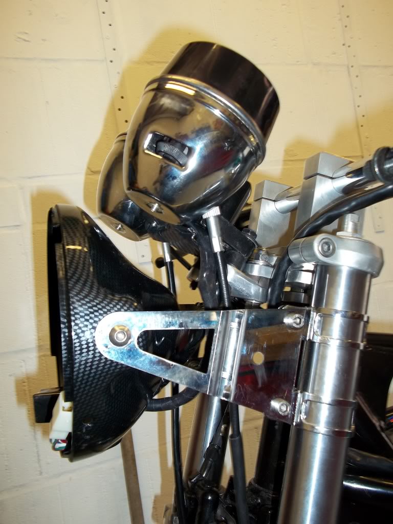

Had some doubts about the headlight brackets when first put them on,looked miles too far out, but after putting the clock bracket on......
well.... i'll have to see how it looks when the clocks are in.

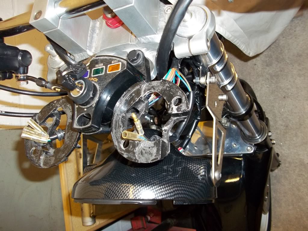

Still have to cut the neoprene foam for the clocks and sort the wires out (kin wires :swe :? :grr :confu - me - eleck trickery - :down )

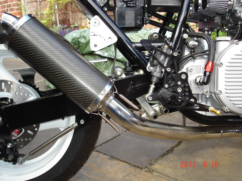

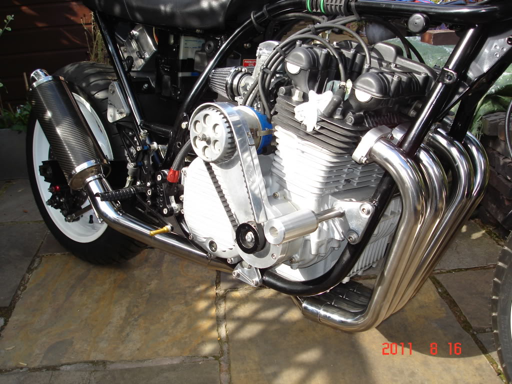

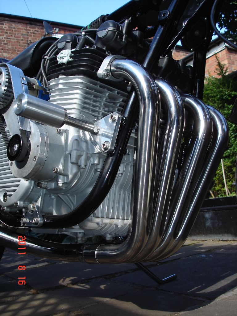

Soooo, thought as the bike aint in the kitchen no more (if were cookin' is it a barbeque then?) i put the zorst on - as Jim Carey would say "like a glove"

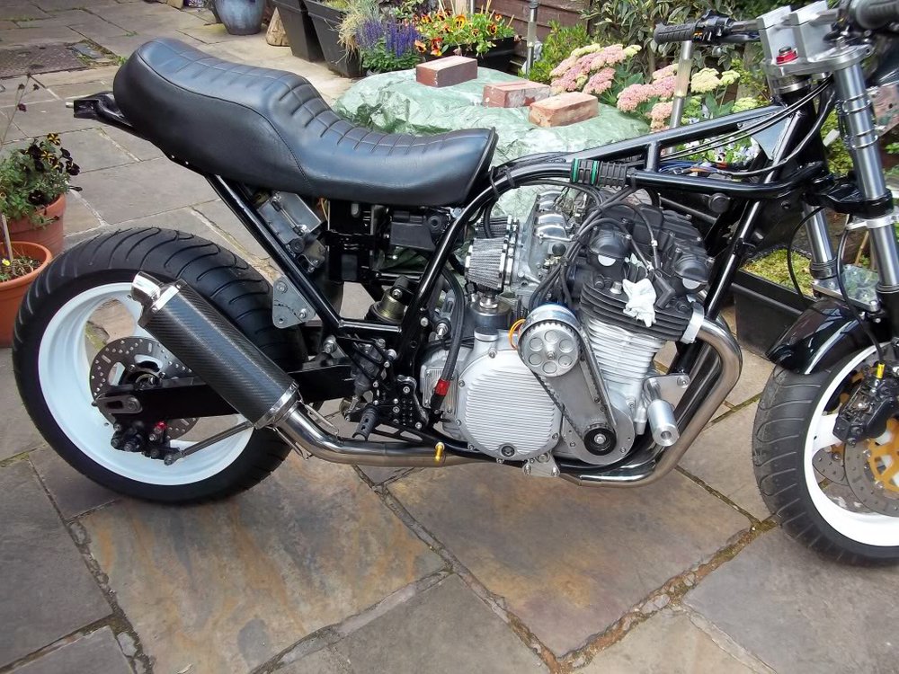

I can now sort out the rear hanger bracket (another aftermarket Yam item) i'll need to cut it about a bit and have it rewelded and also sort the rear footpegs.
Slowly coming together tho'
Having sat on it with the rearsets where they are, im happy to measure up for the rear brake line ..... one day (lazy bastard me)

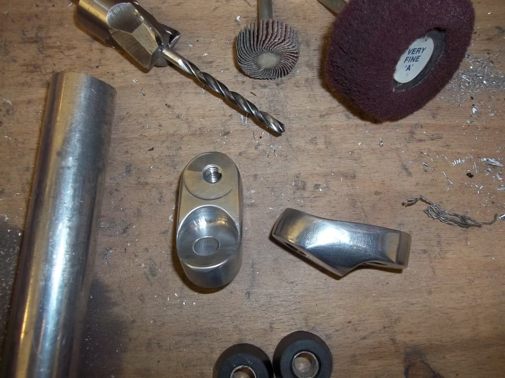

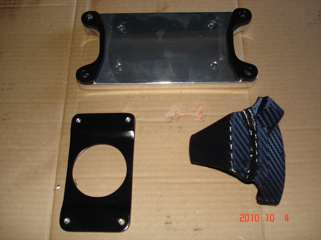

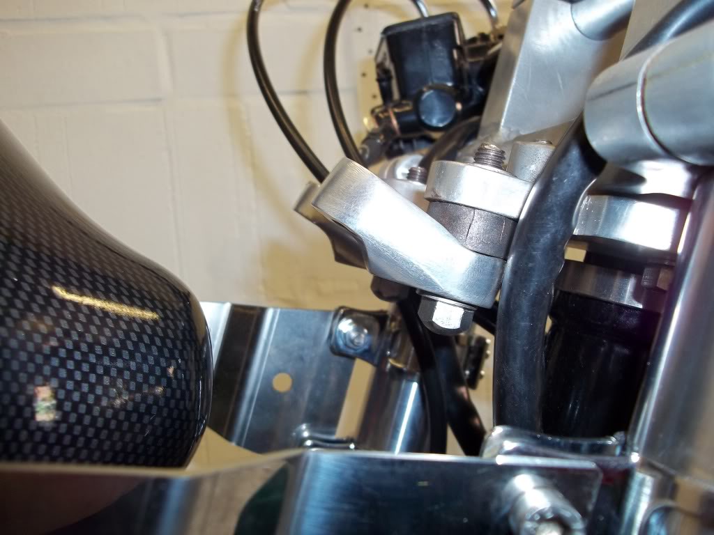

Now that the front ends on, ive realised when the clocks were on they 'sat' too flat and needed kicking up more. After giving it some thought (a minute with a tab an scratch of the nads) i recond on cutting some inch bar and with a bit of drilling, spot facing an a tickle with a file summat could be done......
several hours & loads of brews later and i had summat that looked 'half right'
First idea was to make some blocks and just sit them on the yolk bracket, but..... theres always a but isnt there.... after placing the rev counter on there found that the cable was a little tight, ah well.
So this is how it ended up -

Some added rubber bushes then raised the clocks slightly (the 3" risers werent helping here :roll: ) admittedly could of done with more of a kick angle but.... well yer makes yer choices so i'll stick with it.

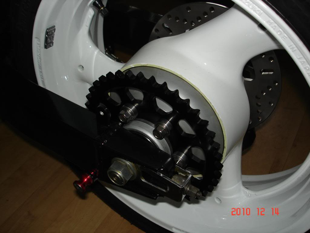

So a while back id bought a chain riveter (bought at Machine Mart made by Laser) ......about time i used it.

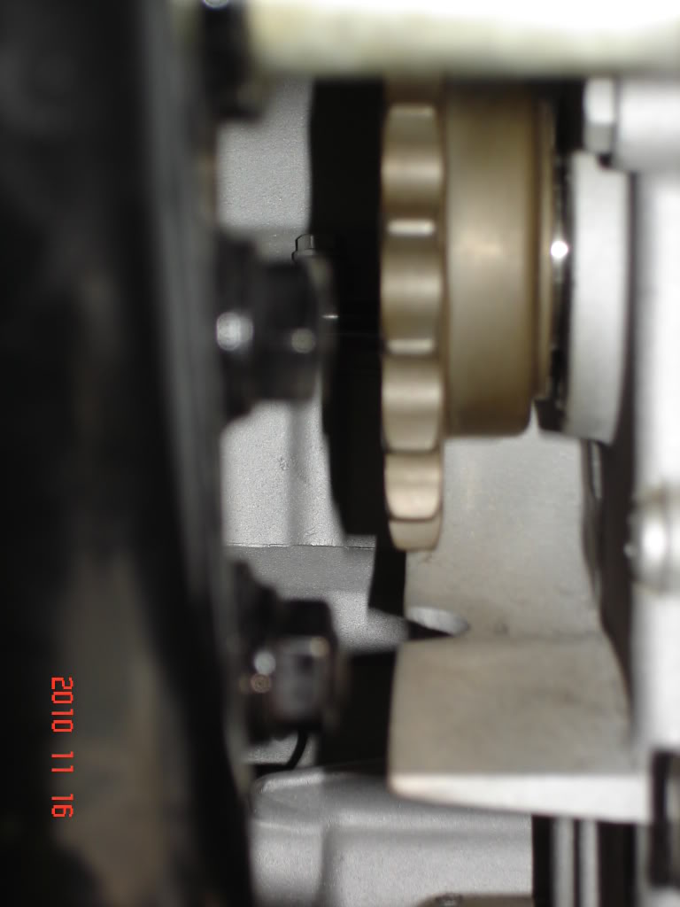

Front sprocket is 18T 5/8 offset
Rear 40T made by Talon

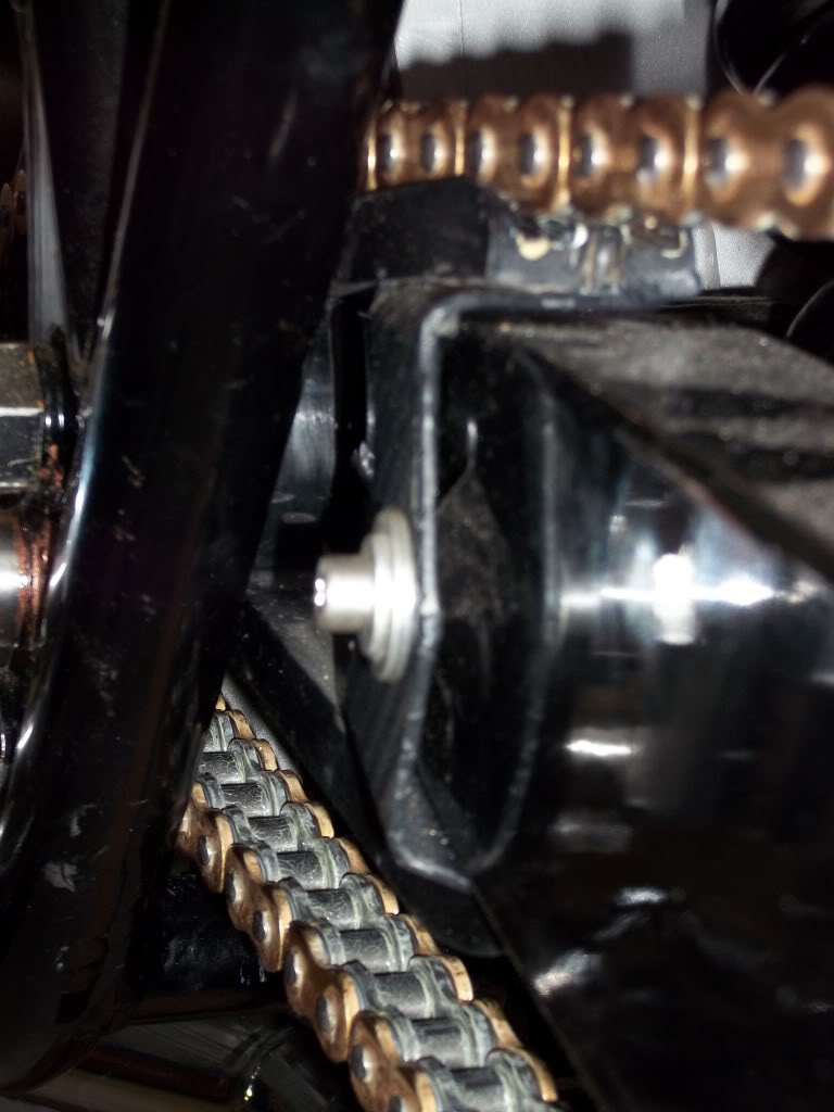

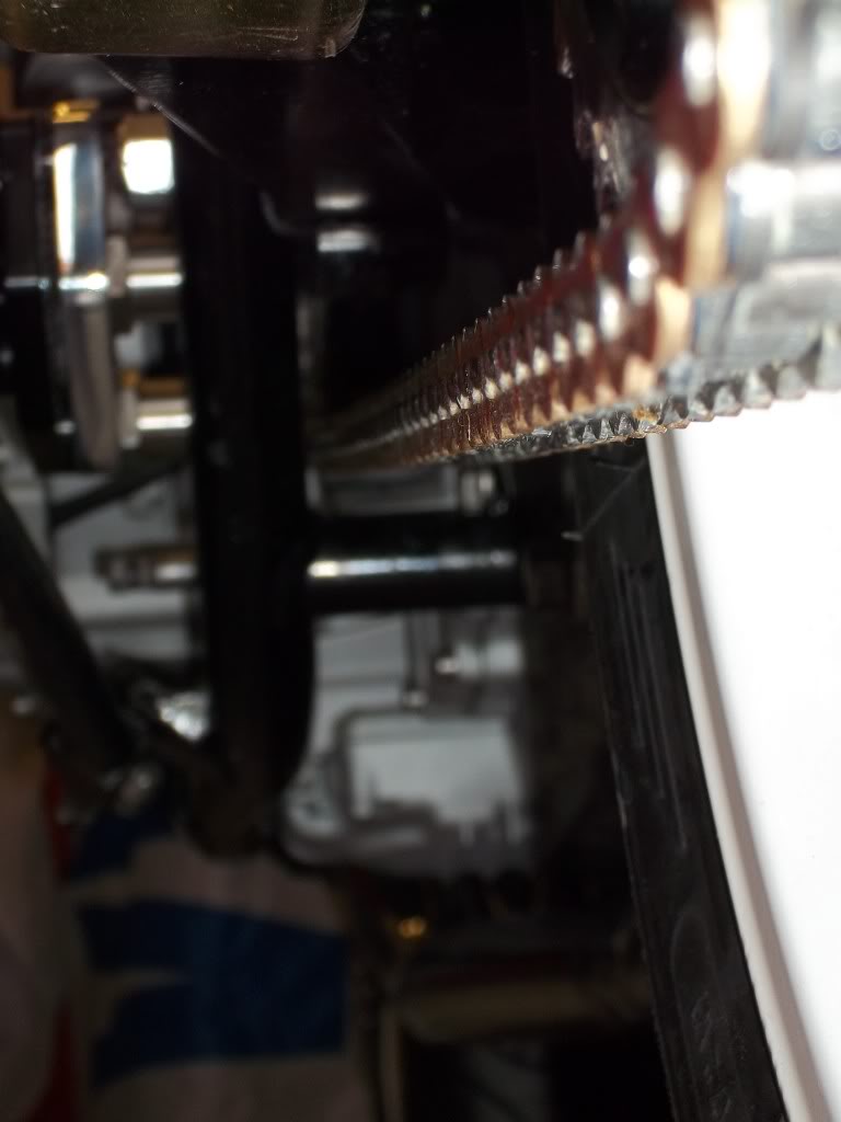

So with the chain on ( a DID 50VM X Ring ) i could check frame / tyre clearances.
Wots up DOHC
sanderz
Posts: 850
Joined: 2nd Mar 2010
Location: Manchester
#39 PostAuthor: sanderz » Wed Aug 24, 2011 3:29 am

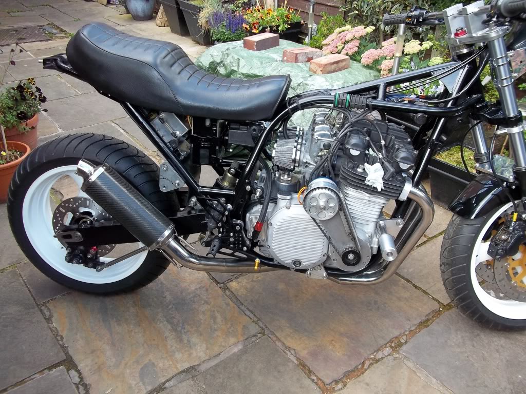

Rear wheel is GSXR1100M
The rear sprocket carrier was machined down 7.5 mm to bring it in line.
Its close between frame and tyre but it has 'even' clearance on both and the chain run is straight.

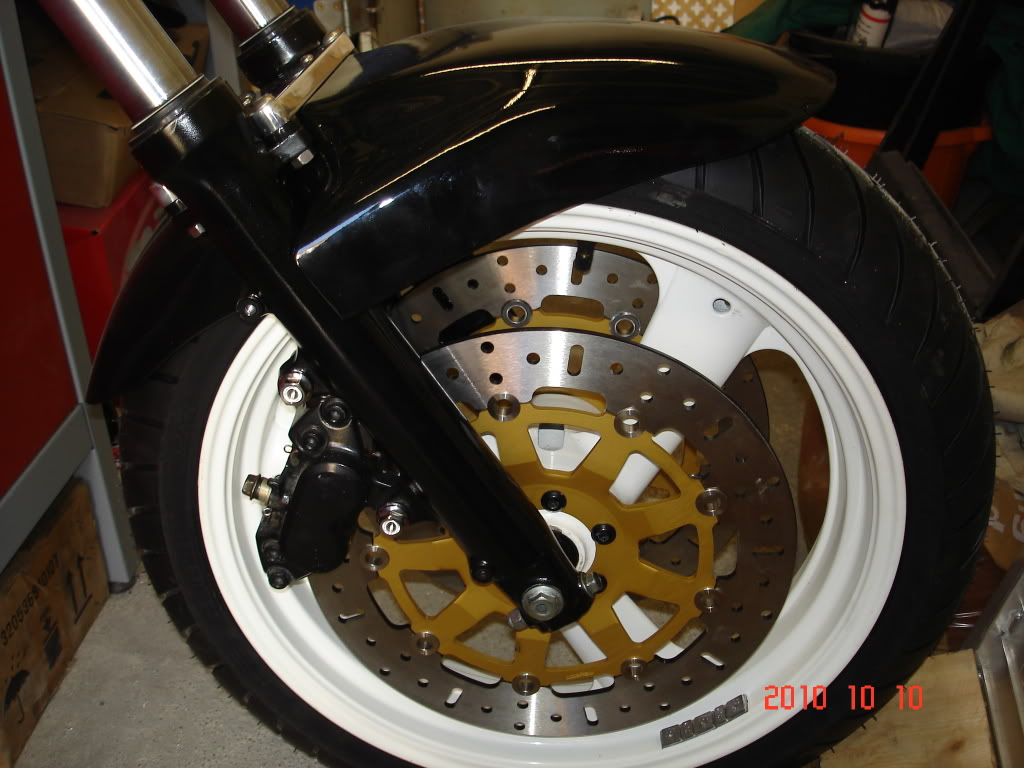

The forks measured 780mm from top to spindle. Yamaha FZR1000 Genesis 1988 (41mm) Think later Exup are 43mm.
Complete front end - yolks, forks, wheel & discs are Genesis. Mudgaurd is Suzuki RF900.

sanderz wrote:Rear wheel is GSXR1100M The rear sprocket carrier was machined down 7.5 mm to bring it in line.
I got a 17/180/55 Suzook rear wheel - and had 5mm taken off the carrier on the Mk.II :wink:
