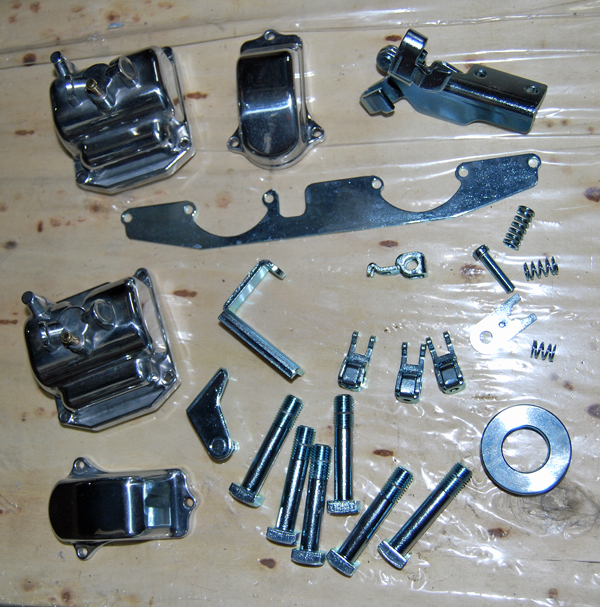

First to be unpacked was the chroming - not a bad job - not as good as Mikey used to do - but Hey-Ho.
With a topped up Mojo - A new genuine rubber went on the gear lever - a nice shiny stainless bolt - and - on it went.
I then replaced the temporary pattern rear brake lever with the re-chromed original - looks exactly the same - but it's original.
Original torque arm and rear brake arm are good to go...
Then after tea I opened Mikeys Plating and Polishing - Sunglasses at the ready! :cool

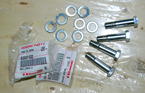

Last was the back ordered genuine parts - the cost of re-chroming the caliper mount bolts 'n' washers was a no brainer - more than getting new ones!

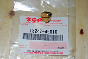

The original carb drain screws were a tad used 'n' abused so I treated her to a new set - Suzuk1 bagged items are identical and were cheaper than the Z-Power ones I got for the Ltd.

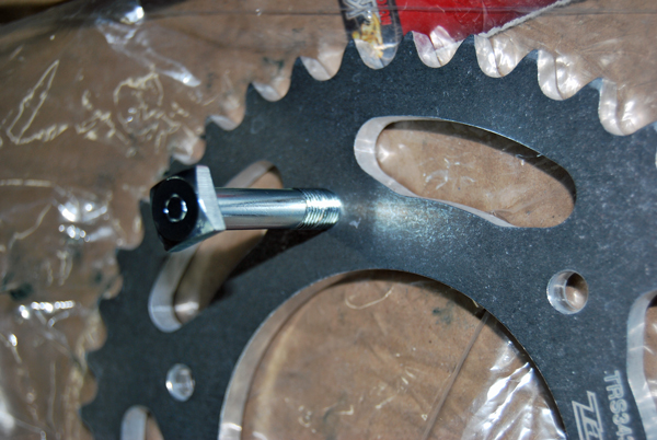

Found a slight issue with the 530 rear sprocket - wrong size mounting holes - a quick wizz through with a 10mm drill will solve that..

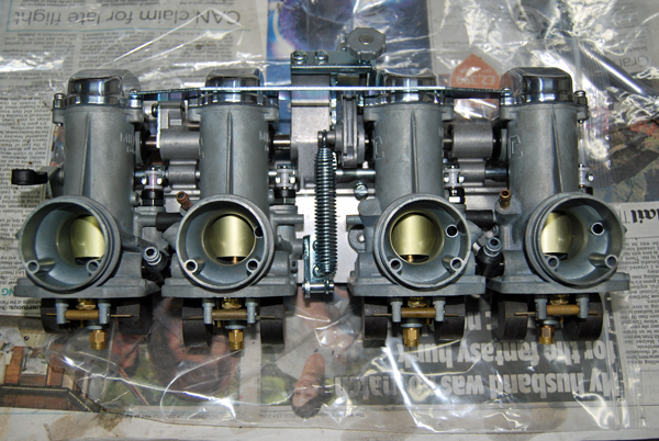

Despite the Siberian conditions inside the garage Carb assembly continued a pace.
With the carbs dressed I set the lift height and fitted the choke bar and lifters.
Just the float heights to set and they can go on.....

Back to the carbs.
I converted an old drain plug to make a fuel level gauge, after running a drill through - an old spray can tube was fed through the plug and glued in, then some pvc tube pushed over - works a treat.
Clymer manual says the float height should be 22mm +/- 1mm, and the fuel level should be 3mm down from the carb body +/-1mm.
With the float height set at 22mm this gave a fuel level of 1mm.
After gaining experience in setting up the Ltd - I found those particular 26ss carbs to be a touch sensitive to float height - erring on the side of caution I opted for the -1mm to give a 2mm measurement - time will tell if this is wise....
Everything double checked and we're ready to fit - fingers crossed.
