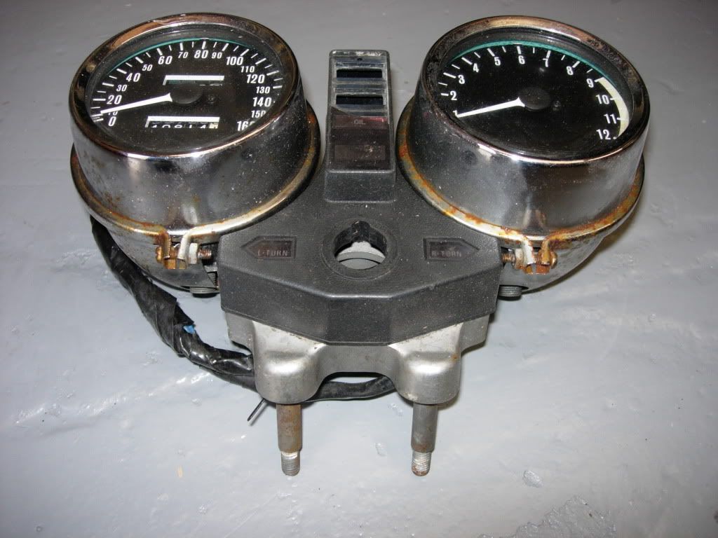

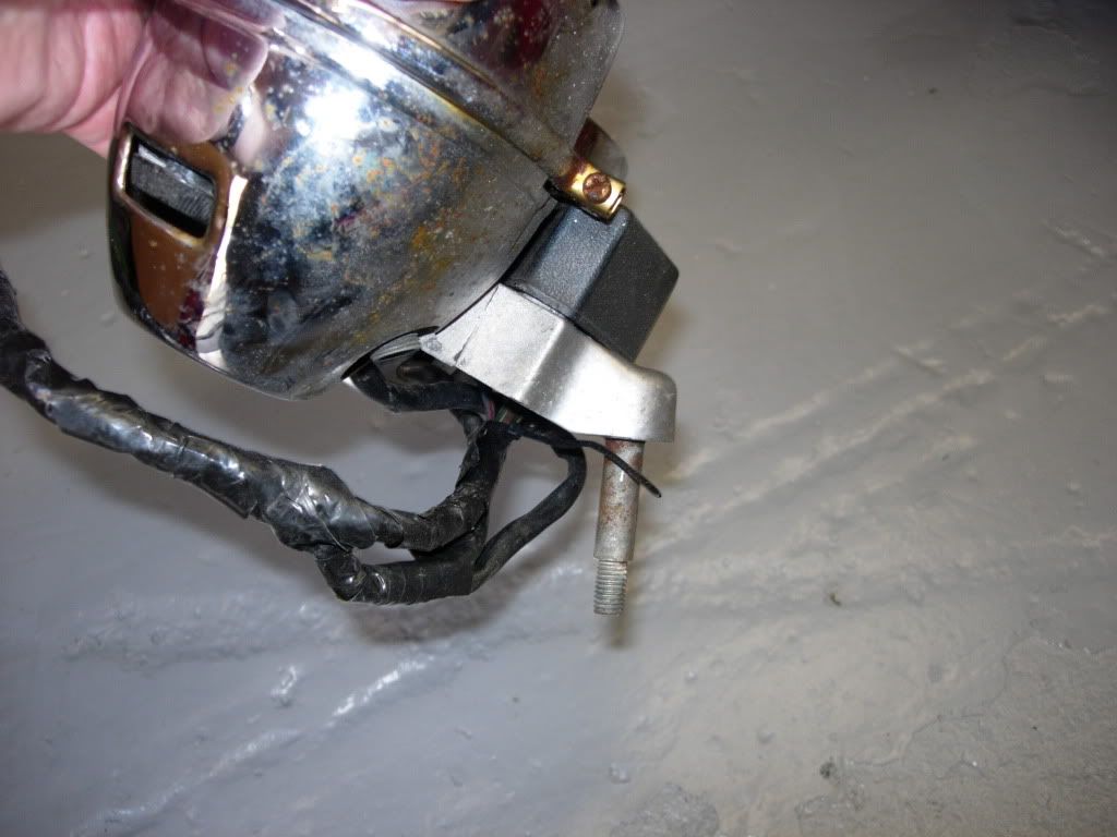

Ian, these are the clocks that came from that top yoke. Mounts are 55mm centres.

yep they are A4 clocks, my bolt holes dont even line up with the yoke. i have the early clocks, search time again lol.

You could use a Z650 clock mount( B or C Series) as they have 55mm Centres for the mounts as per my build, and I suspect are the same as the later z1000's probably cheaper too!

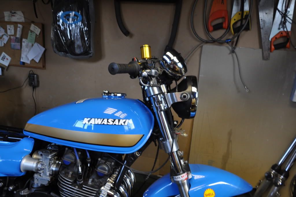

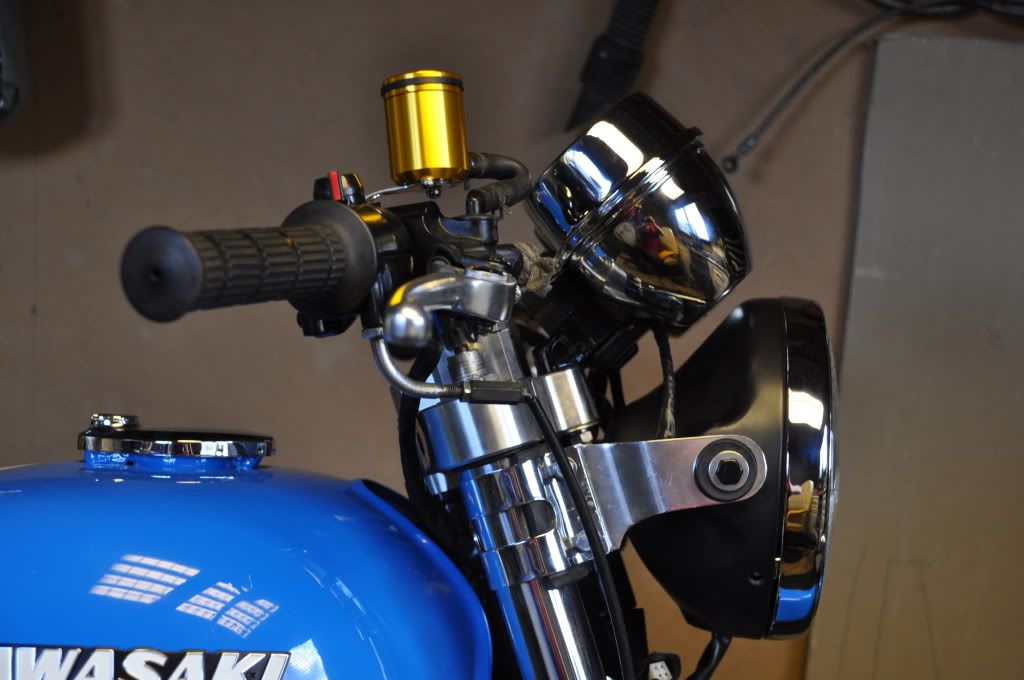

I used an A4 bracket and transplanted my clocks and electrics onto it
Number plate on looks the dogs, i have a big plate for the mot but it may drag on my tyre lol

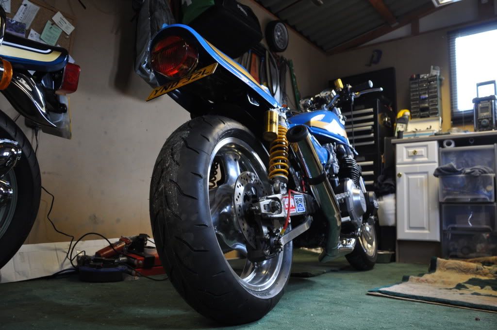

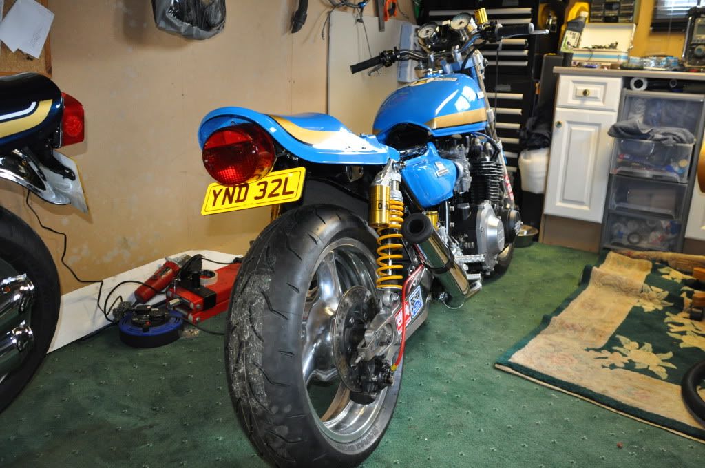

That's looking good now Ian.
There's a good chance the club will have a stand at Andrew Greenwoods Donington show in June, it'd be nice to have that on the stand. :sou
