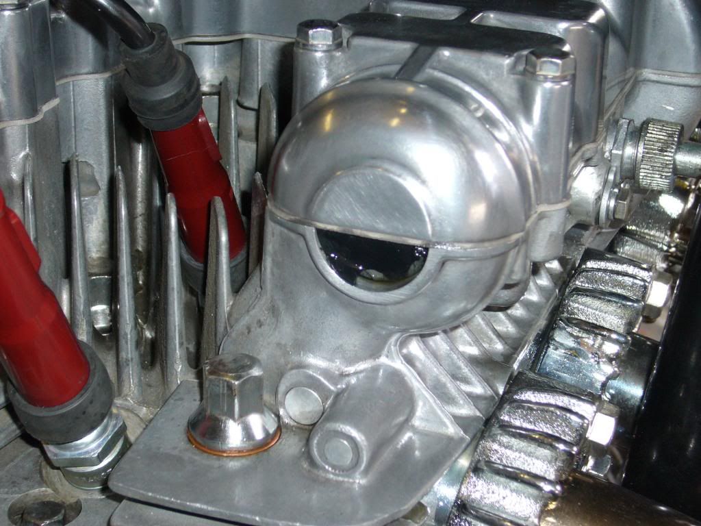

hello chaps help ive just fired up the motor after a rebuild, i fitted some new rubber cam end plugs[vesrah from z1 ent] fitted with a little gasget cement, i let the motor run for around 7 or 8 minutes, then noticed one plugs [no4 exhaust] had sucked in and was leaking oil , i took off the cover and fitted an old plug, started the motor and once again one of the new plugs started to suck inwards [no 1 exhaust] again replaced with old plug, started the motor now no 4 inlet is doing the same has any one else had this problem :?: have i done some thing to cause this problem :?: or could it just be very poor plugs :?: :?: :?: :?: thanks alan

Hard to tell from your pics but you are fitting the plugs with the concave side to inside and the lip to the outside,i use RTv silcon and let it nearly cure b4 fitting cam cover,degrease hollows with carbs cleaner b4 fitting.

hi paul yes the plugs are in the right way, i did wipe clean but didn't degrease the hollows with carb cleaner, i thought the sealer was intended to prevent oil leakage not stick the plugs in position, i assumed the plugs would be held in under pressure, i think i may need to refix with a silicon sealant, is rtv a special sealant :?: can i pick this up from any bike shop cheers alan
