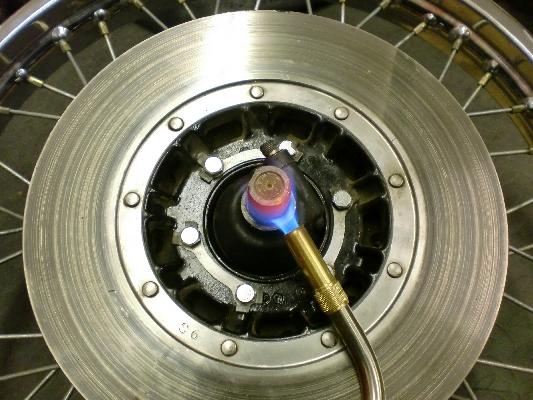

Before I take a hacksaw to the flipping thing and post in the axle wanted section.....
Any suggestions on getting a Z1 front axle undone?
It's been soaking in penetrating oil for two weeks... no joy.
I've tried heating the speedo side till it's smoking.... no joy either.
I've tried pounding on the end of the spanner.. no joy and now I've just shattered a vice trying yet more leverage.
It's got to come out as I've a noisy bearing in the hub (and probably very cooked seals now!).
Any suggestions?

#2 PostAuthor: z1bman » Tue Apr 03, 2012 7:10 pm
heat the axle nut on the speedo side until it goes cherry red that should free it. best to do it with welding torch or map gas

#3 PostAuthor: ruffle » Tue Apr 03, 2012 7:13 pm
OK - guess I've nothing to lose; and that's not as energetic as cutting through it :)
if you hear reports of a garage fire in East Northamptonshire... it's me!!

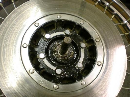

#6 PostAuthor: ruffle » Tue Apr 03, 2012 7:31 pm
Thanks Z1bman!! That's a beer I owe you.

#7 PostAuthor: Garn 1 » Wed Apr 04, 2012 10:17 am
Beautifully illustrated Ruffle, you even got the cherry red part right.
I've never had to do that, however, it looks as so it works.
