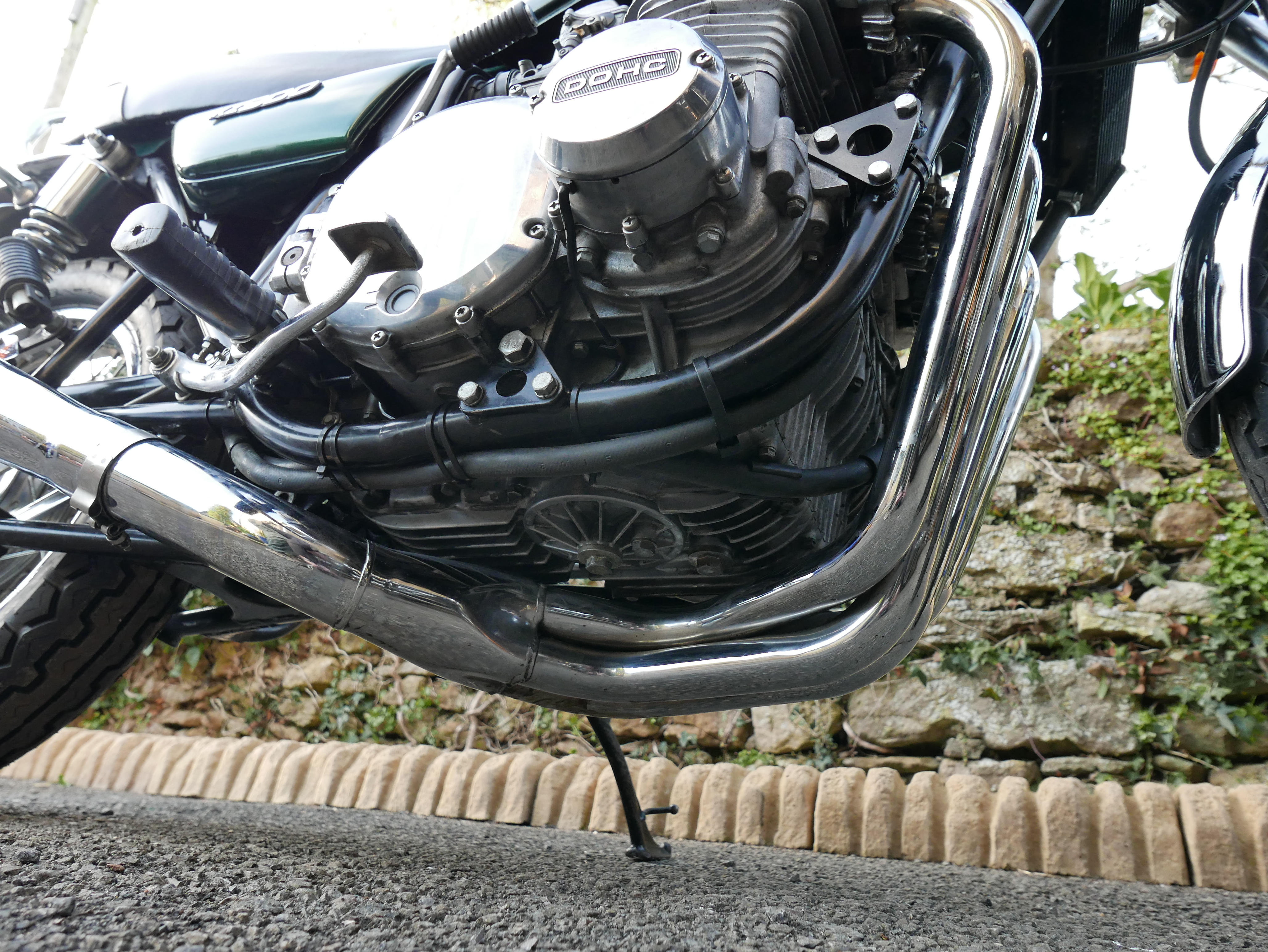

I fitted mine (on the A4) running under the engine as the cooler has bottom feed (snigger)..... and I like this option better than around side of motor as it's less obvious.

consider a few things when 'trial routing' ; on one of mine I've done the same as pigford = underneath (I managed to catch a oil pipe on the exhaust downpipes
) you must makes sure there's no chance of movement / enough clearance as the oil pipes go past through the downpipes.
