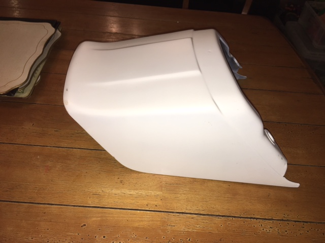

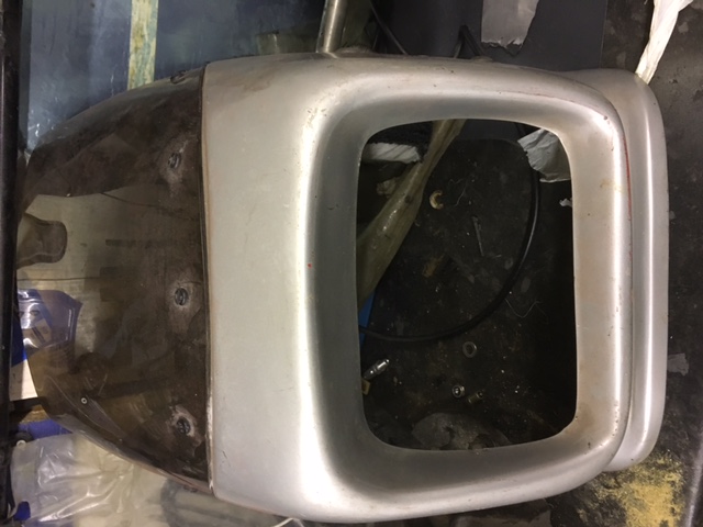

Tank,
Tailpiece
Seat
Frame (but did know where there was a scabby one!)
However Jack (london calling) true to his word kindly donated :
(and a load of useful brackets and odds and sods.)

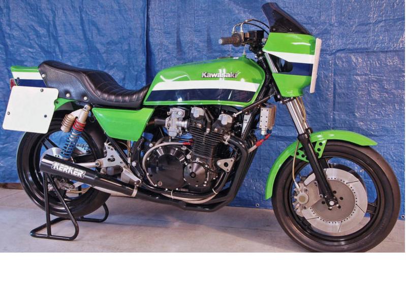

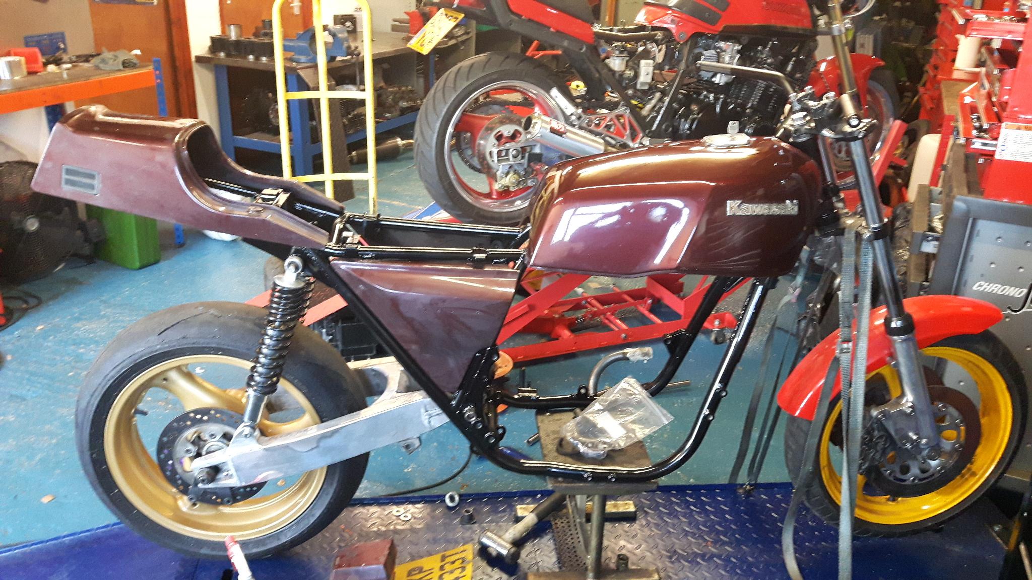

So the big question is will it end up like
Or more like what I really want
(But probably not green!! Just to be awkward really, as the green is great but Robw's is green)

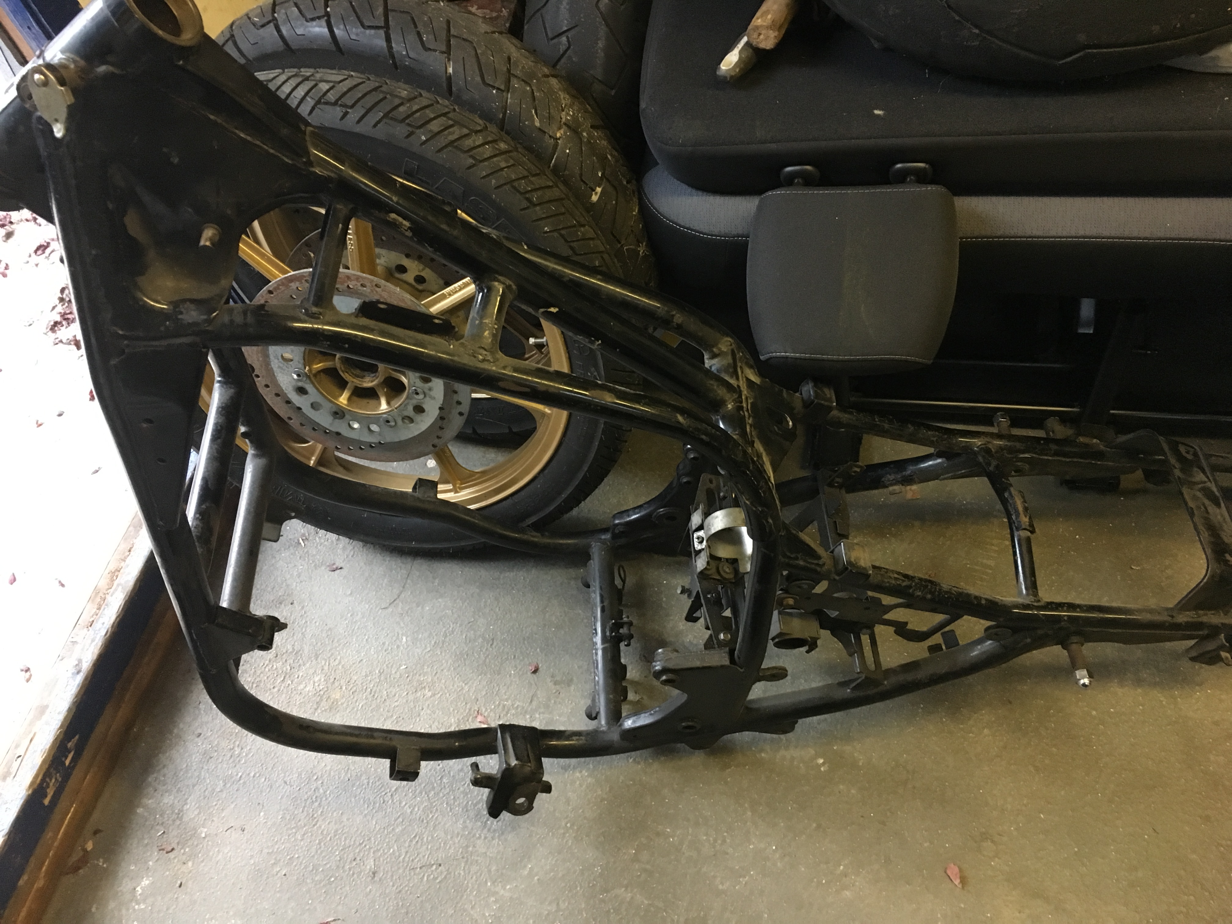

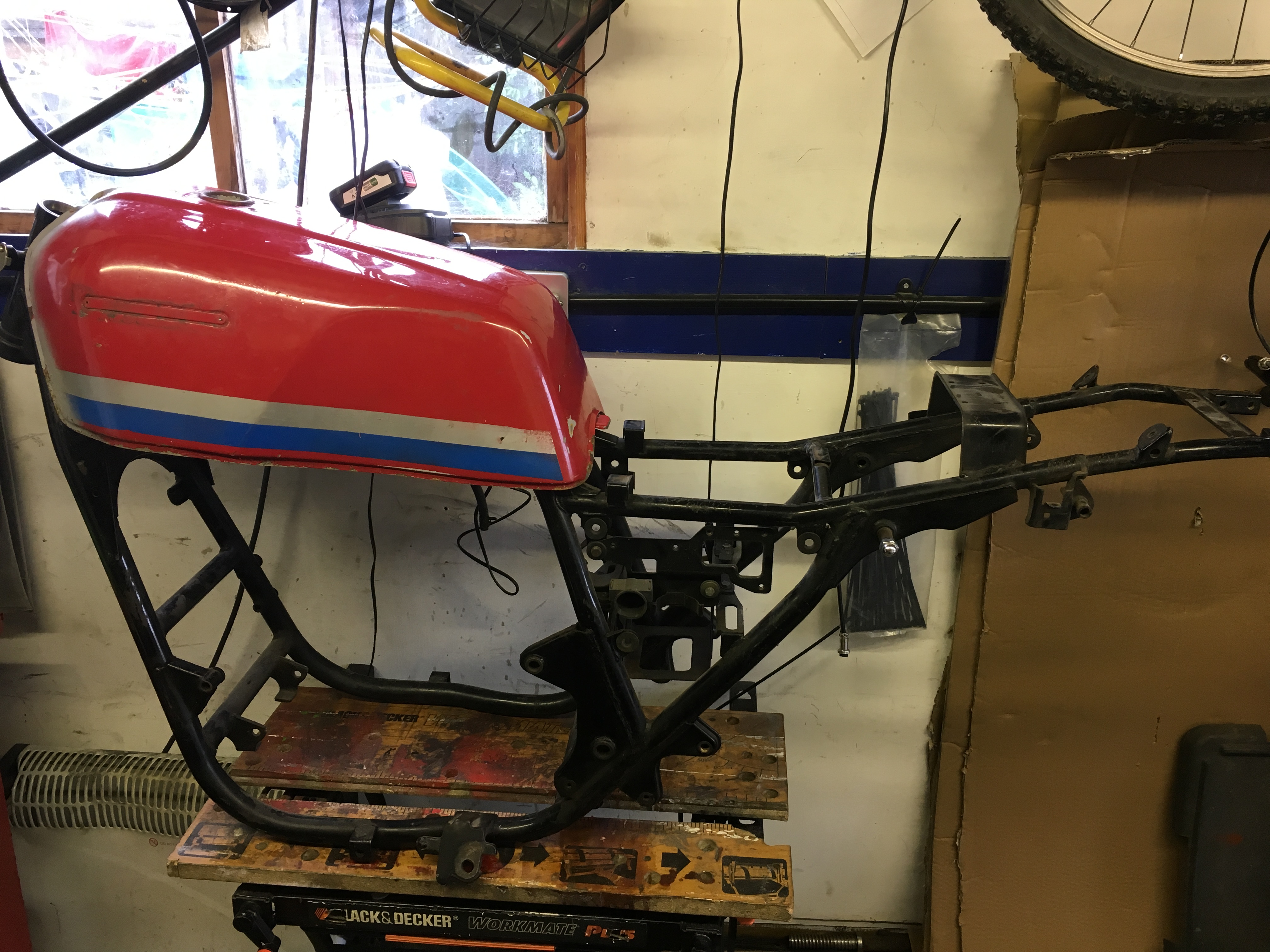

Haveing also put out some feelers out for a decent frame
Pluto has obliged and is bringing me one to Cadwell,
Robw Has a standard seat for me and a battery box.

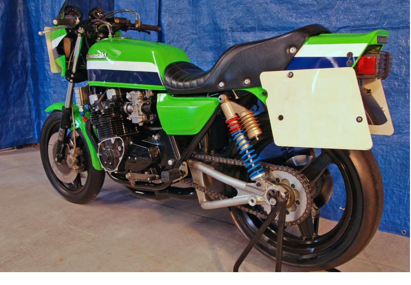

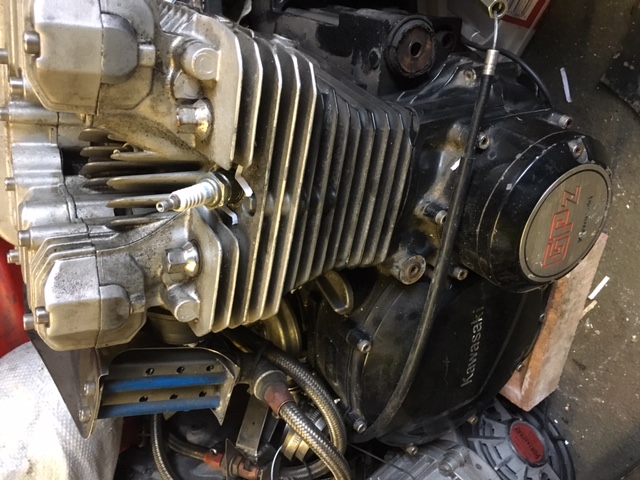

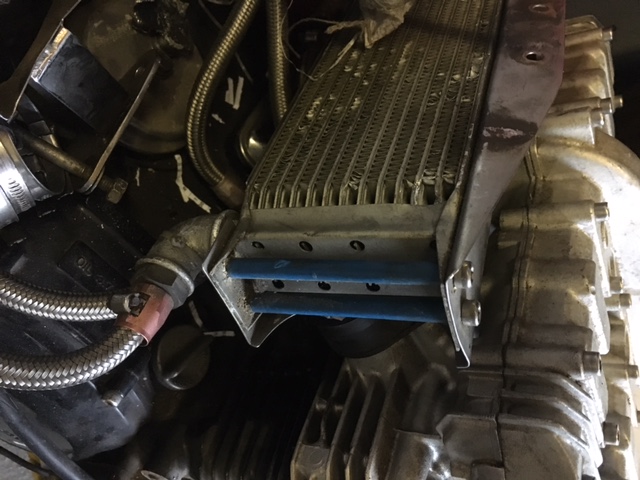

I also managed to source,these from coose and ebay
Which turned out to be :
So what do I need next?
A set of ZRX Discs £7.50 plus p+p from ebay
thats that sorted!

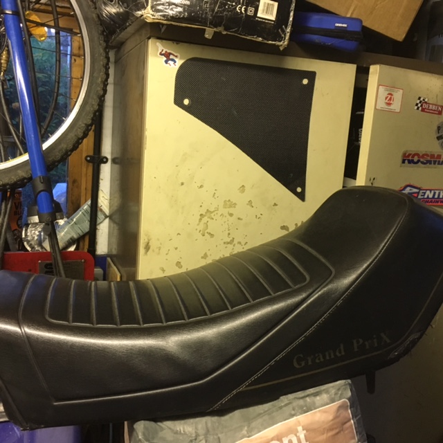

Re: One piece at a time!
I hope you're happy with the seat, and it arrived unscathed?
yes please Lee.
Coose Seat arrived fine thanks mate.

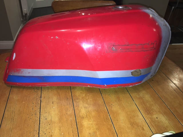

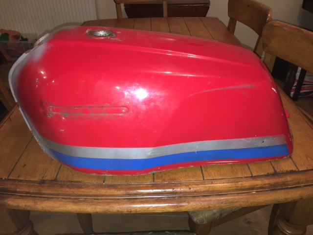

Would the B1/B2 tank now be surplus to requirements?
royp the red tank above is a B1 But thats the only tank I have so unless I find a better one thats what I'll be using.

Gpz 1100 forks and yokes turned up at the weekend along with my returned Slabby wheels.
Found a spindle in a box that fits the forks and wheel combination.
Then Spent some time messing around with disc and brake combinations and the best option seesm to be ap lockheeds.
Unfortunately the discs I have are either 320 or 310 and neither will work with the set of Ap brckets I have, so I ned to either,
source some zzr1100C discs or get brackets made with 5mm more radius.
Will probably go with the bracket option as I need to have wheel spacers knocked up anyway.
Coose good to meet up at Cadwell, yourbike is properly cool and with some clever solutions. ( e.g back wheel)
At Cadwell I also managed to pick up my frame and some std wheels and a footrest hanger (kipkawa) So most major bits are there.
