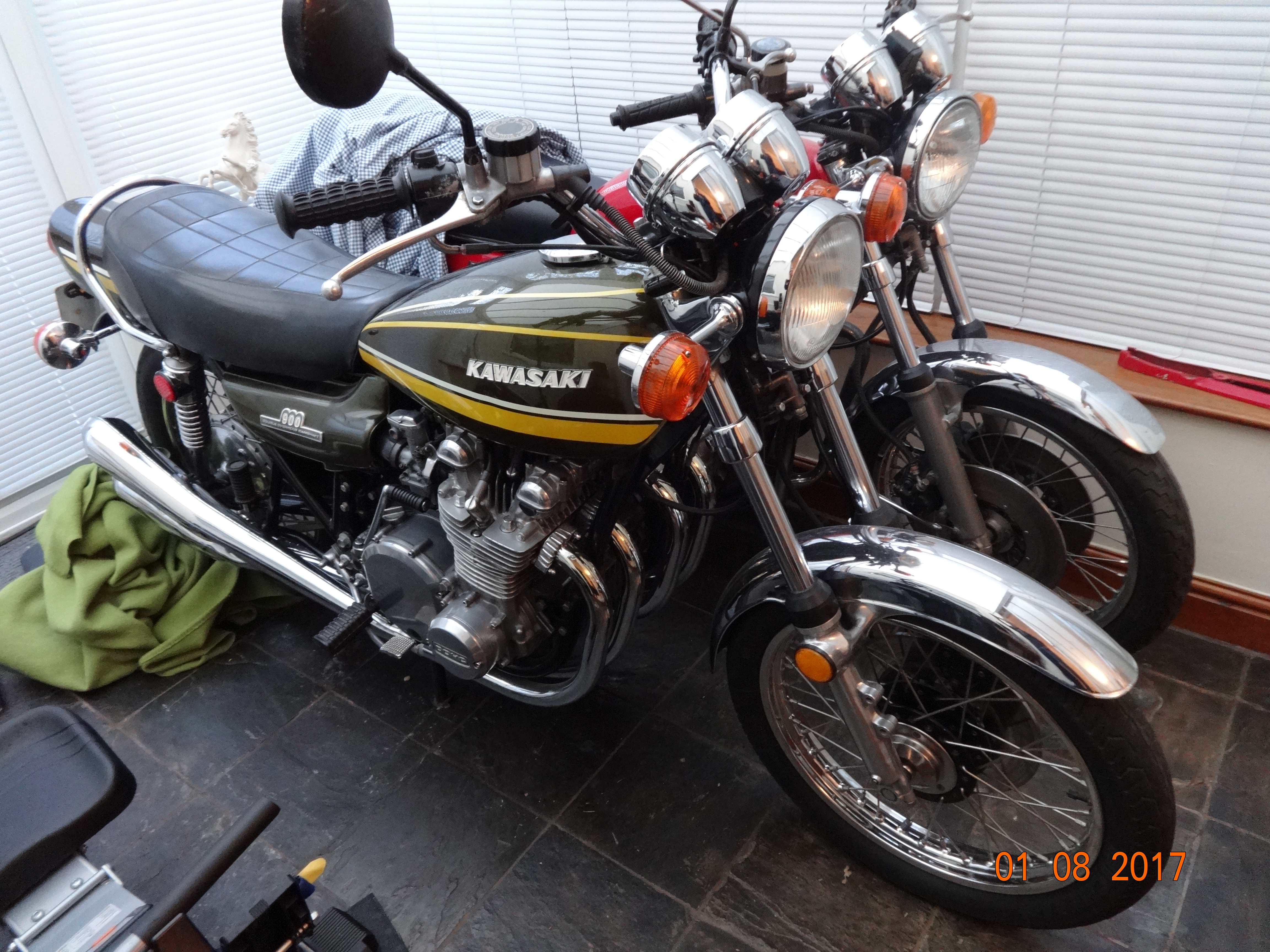

Hi , after a bit of advice please. I still have a couple of old zeds that have sat there for far too long- life somehow gets in the way, one since 1999 the other hasn't moved since 2010. Both remain decent as have sat in the conservatory under cover so haven't suffered the winters so hoping won't take too much to get road worthy . Anyway the time has come to either sell or see if there is an Indian summer of riding left in me so considering putting one back on the road -the 900 if it doesn't cost too much.. Point of the post is does anyone know of someone they can recommend in the Merseyside area who can do or help me with the work that is reasonably priced? There is an oil leak on the engine from left hand side (not sure where from)which is main problem I need help with -front brake cylinder leaking too plus the standard re commissioning stuff. Tried to add of photo of bike -hopefully it works. Cheers Bob

Left hand side oil leak is probably from the alternator wires (they all do that sir) and is an easy fix with some decent mastic. Brake caliper leak will doubtless be the piston seal which will have dried out with being stood, again a cheap and easy fix with a set of seals from the usual suspect/s.
If you're planning on selling I personally wouldn't bother paying someone for all the recommissioning stuff as it won't add that much to the value. as long as the bikes are running and presentable that should get you a decent price.

Oil Leak on left hand is most likely from where alternator wires go into alternator casing. A relatively easy fix.
Calliper seal also relatively easy to sort.
