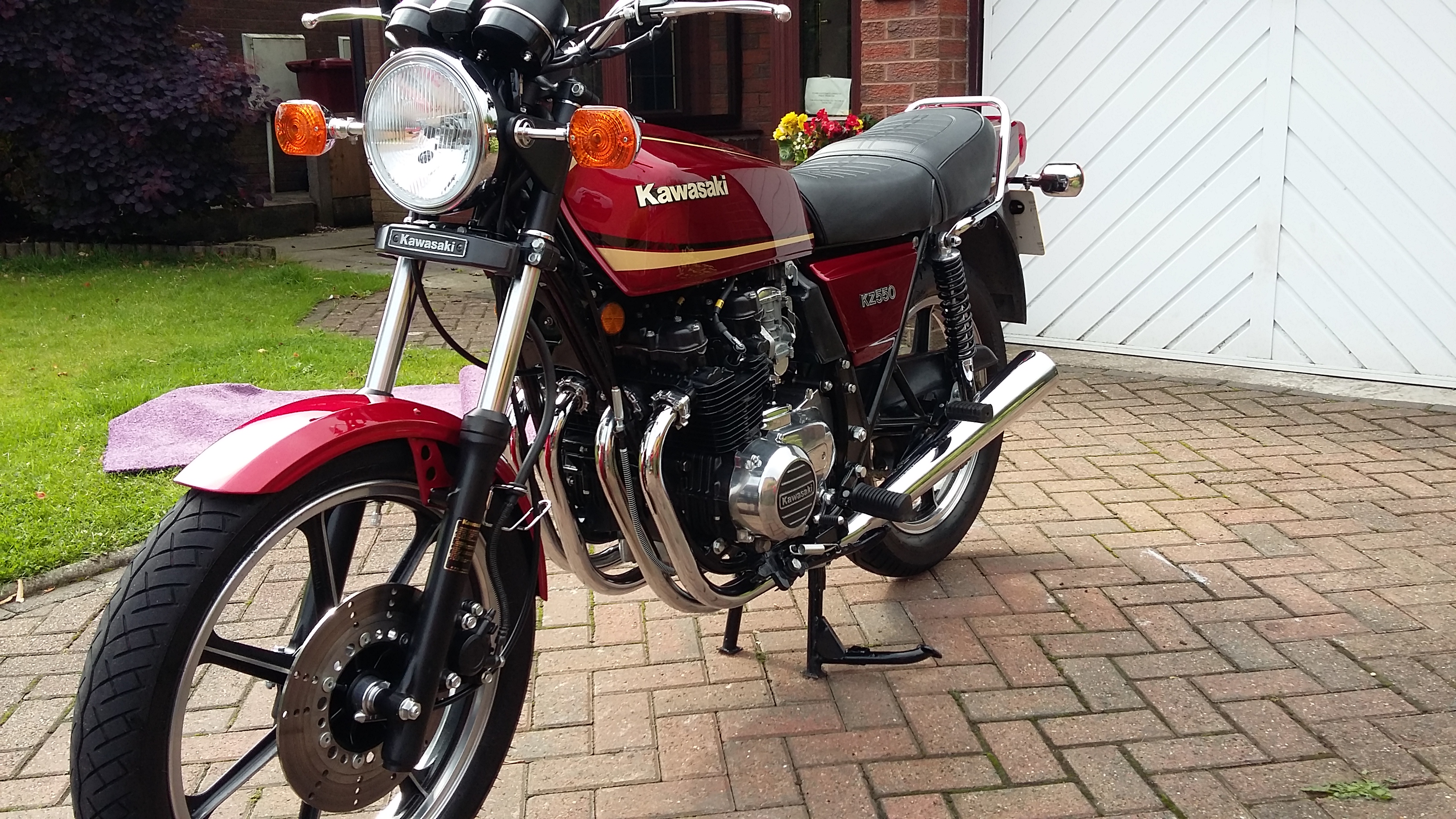

DavidZ1R wrote:Not my z1 but my kz550,
Nice - Any photos?

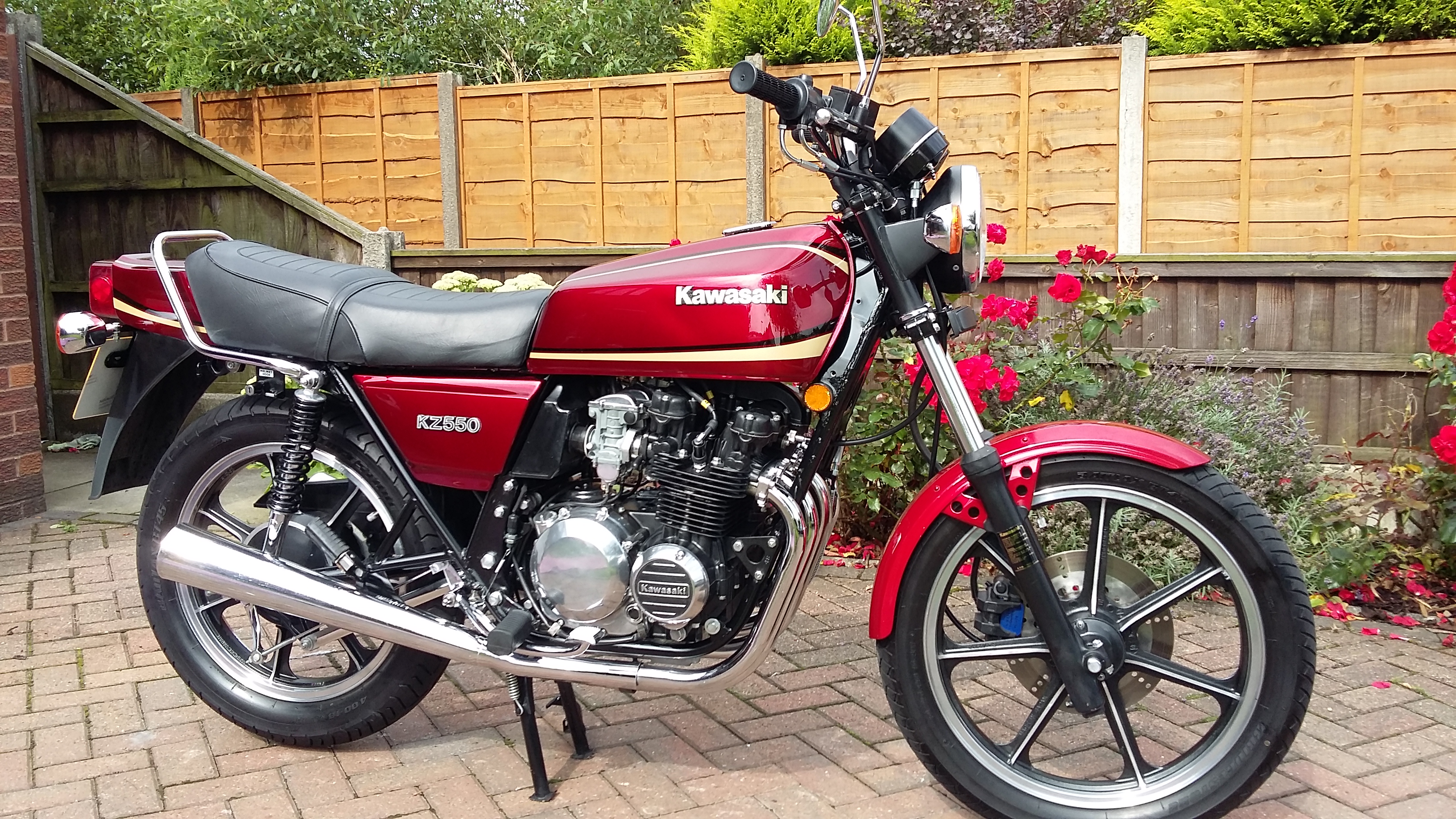

#12 PostAuthor: DavidZ1R » Sun Apr 01, 2018 7:46 pm
Here you go, great fun to ride, when it feckin starts, if you want look on YouTube, ,, 'kawasaki kz550 rebuild'

#13 PostAuthor: Kwackman » Sun Apr 01, 2018 7:50 pm
DavidZ1R wrote:Here you go, great fun to ride, when it feckin starts, if you want look on YouTube, ,, 'kawasaki kz550 rebuild'
Thanks!
Wow, that's a disgustingly clean example!
Those exhausts set it off nicely too.
Thanks!
I'll look up youtube tomorrow.
Lucry with the pipes, both nos, left cost me £9 , honestly, the right £120.
