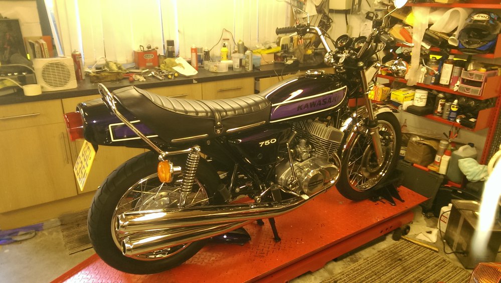

#23 PostAuthor: RAYZ1 » Sun Apr 07, 2019 10:15 pm
marmck wrote:This is my old H2C ( 1 of only 76 imported to the UK ), Have a chat with someone who has had one , They drink petrol , eat plugs , even when set up properly they surge ( want to be thrashed ) at a constant speed . But they are a gorgeous looking bike . Had mine for 4 years , sold it 7 years ago 4 £12K so make sure as with any classic it is all correct before buying ! Good luck
Ha ! I bought it for 11k 3 years ago, was running far to high s compression , came with dyno chart showing 85hp! , stinking fast until it ran hot , wisco o/s pistons had the cylinder pressures at 180psi , 0.5mm copper head gaskets sorted that and runs much kinder without over heating, cyl running at 155psi now

#24 PostAuthor: marmck » Mon Apr 08, 2019 5:17 pm
hi RAYZ1 ,I found out that Rick Brett did the initial resto on it , but it was in candy red ( did you get the pics of it in red when you got the bike ) when he did it , I do not know if he did the engine work I never, I just replaced a few bearings & seals .It never over heated even on a 120 mile round trip (petrol stops included ) but the oil pump was set slightly over the set line , as this is how I got it , that is how I left it. When I got it , it had a Kh 500 front end & Higgspeed spannies with it . I sold the spannies & restored the front end ,still had the 305 front rim on when I sold it , I also got the seat strap & strips for it & chain oil tank & fittings & other bits , enjoy Martin

#25 PostAuthor: RAYZ1 » Sun Apr 21, 2019 8:27 pm
No it has the 750 front end , Rick did know the bike , don’t know if he did the engine work but doubt he would leave it at 180+psi on each cylinder , it was a rocket when cold , but did get hot and bothered , I checked everything eventually reading the work shop manual when it mentioned excessive compression, duly checked and far to high , runs sweet now. Had to replace the check valves on the oil lines as 2 were passing when stationary.
Too much oil can make them overheat as well , causes a weak fuel mixture
One thing was one of the top yoke pinch bolts had stripped the threads , it was tightened in with a piece of cardboard ,really . Anyway as these were blind holes managed to pick up a top yoke
Incredible what people will do, I mean that’s near lethal
