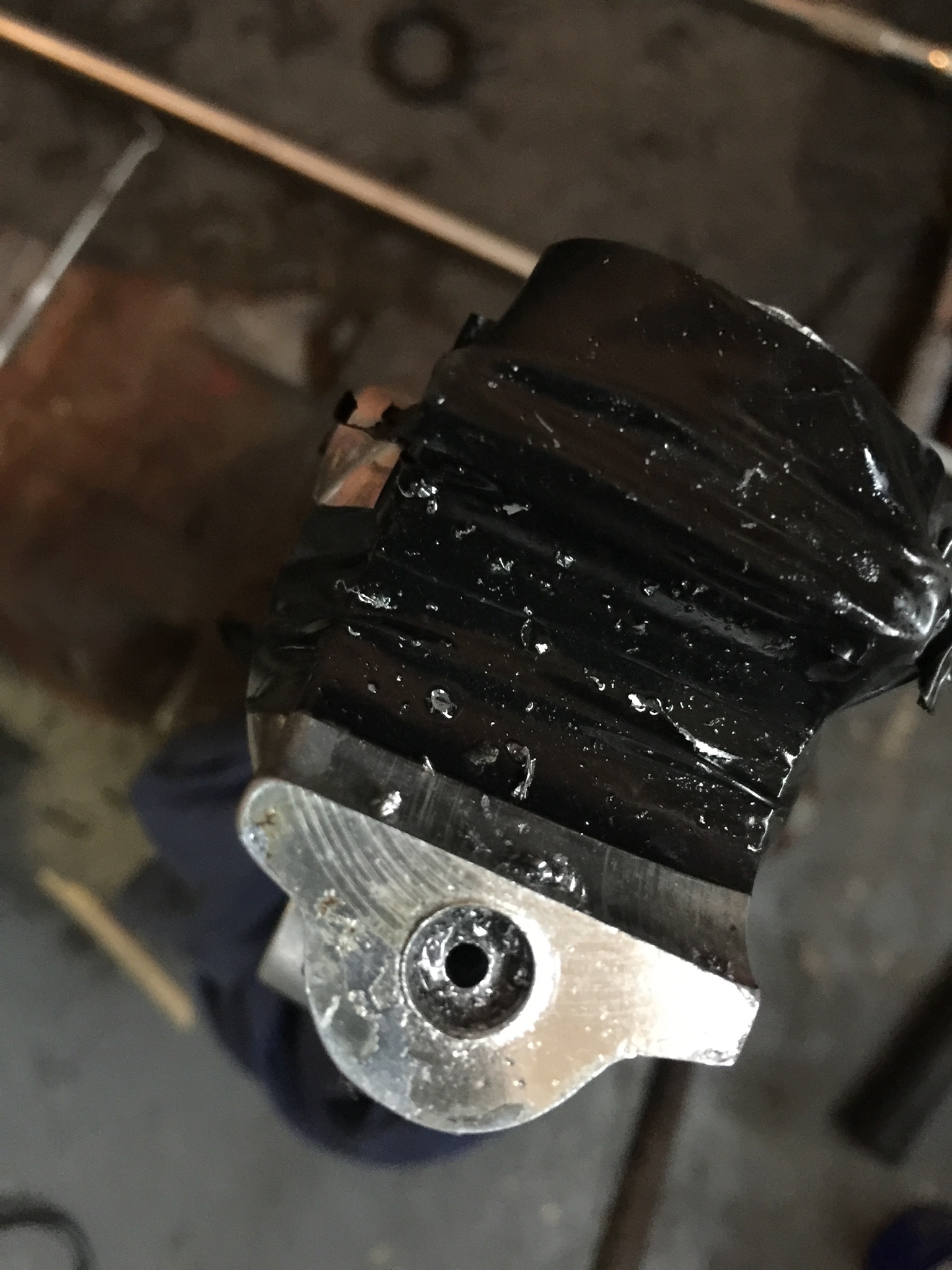

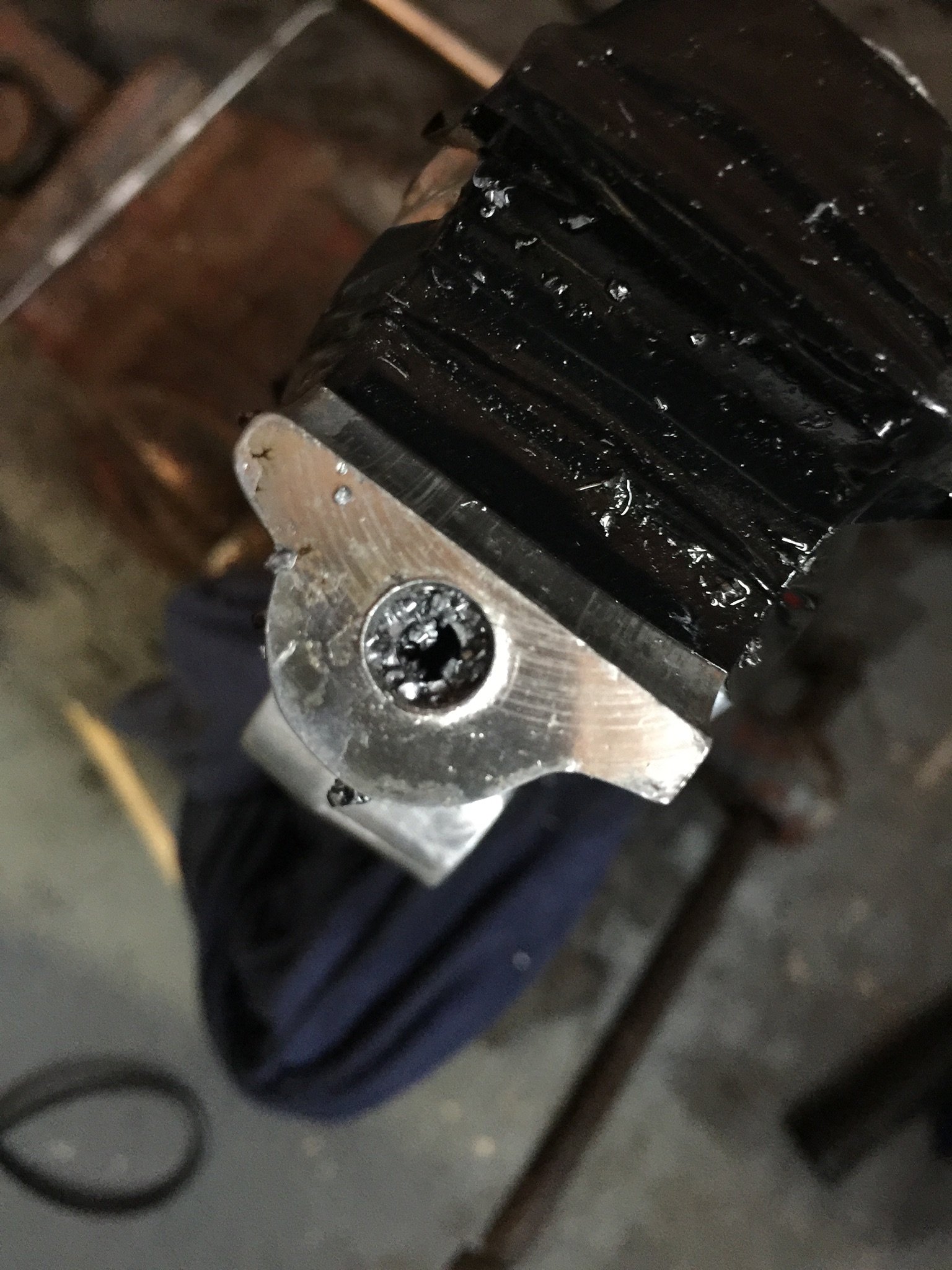

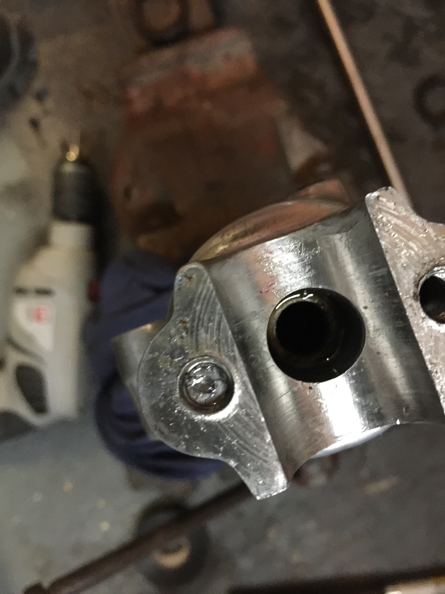

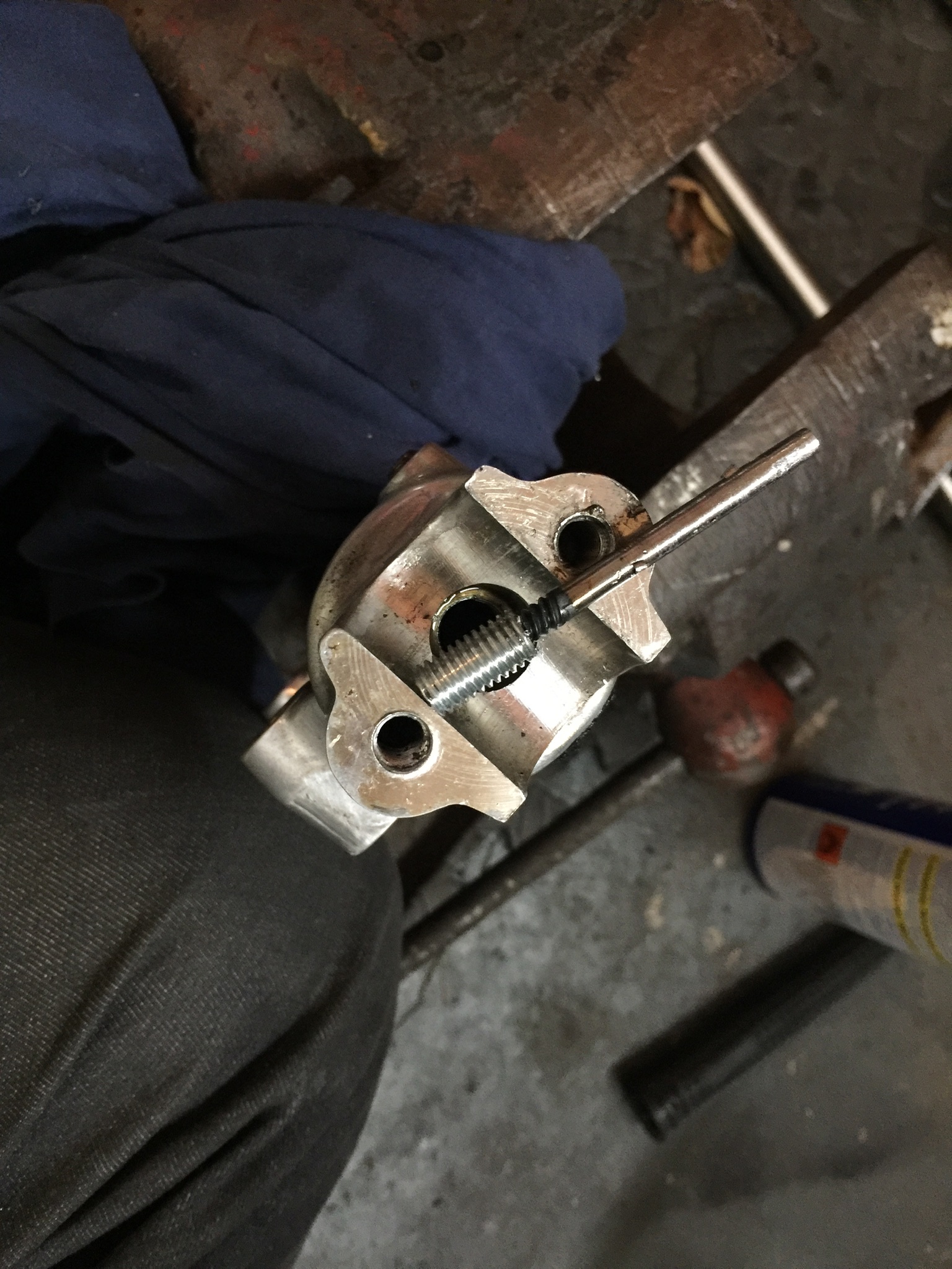

#7 PostAuthor: deka » Wed Jul 10, 2019 8:37 pm
It was time to bite the bullet and give it a go
Filled the stud hole with releasing fluid and covered over and repeated for a few days
Centre punch
2.5mm pilot hole
4 mm drill
Inserted a screw extractor and while using a large amount of heat bingo out it came
