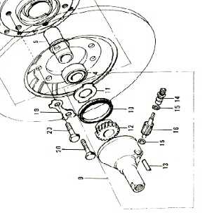

Not had the the one on my a4 apart but had a 650 one apart many times and guess as they look the same externally they are the same internally. There are two prongs which stick out the drive and locate into two recess's in the hub which creates the drive rotation. If the drive is stiff from no lube or has locked up for any reason as the hub is still rotating those two prongs would either get sheared off or be bent out of the way by the hub continuing to rotate.

#6 PostAuthor: warren3200gt » Fri Apr 24, 2020 9:24 pm
Having said all that it is more likely to be cable failure than drive failure but heres a exploded view of the drive
