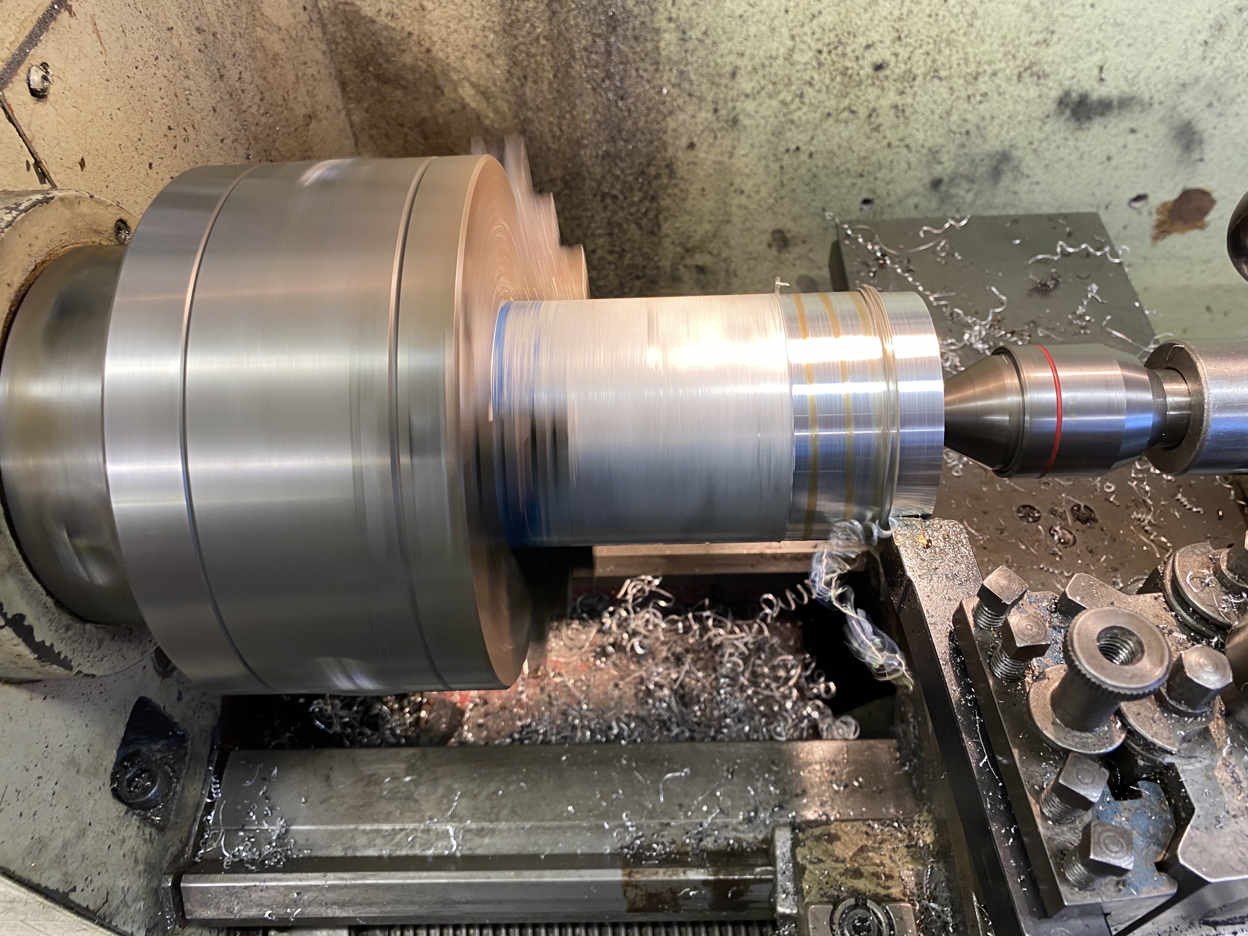

Thanks for all the help.
With the pix and useful research I can now make one.
I was toying with a ZRX master cylinder. I check with the wholesalers and discovered that the Rex repair kit is the same as the 900R, so I have ordered a pair of master cylinders from a second year 900R from DK.
The nearest bit o bar I had was 75mm so the first job was to turn it down to 65mm. I need to do a few drawings and get some more dimensions from a 900R slave piston or Rex one. It can be up to 40mm deep and still clear everything.

I had a look at the cost of a new GPZ900R slave piston on Cradley Kwaka and given how reasonable it is I thought I'd buy one and save myself some time machining stainless.
I'm going to make it similar to the Falk one, but I'm going to machine off more 'unnecessary' material to make it lighter and more 'production'. I know no one but me will see it, but I'll know!
