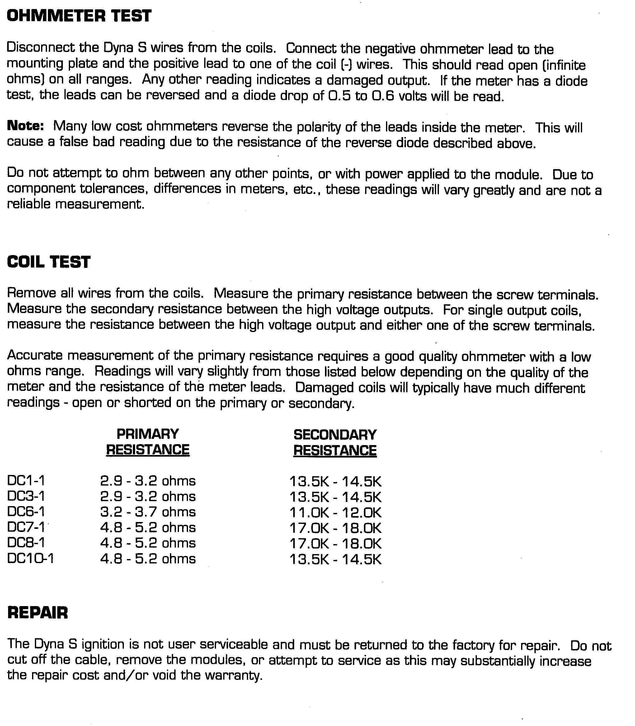

Is it posible to check the pick ups on a DYNA S ignition as got the feeling ones packed up ! tried swapping wire and both coils work ! Bought it 25 years ago so recon warrantys a no go !! :blah :blah

I believe you can check them - do a GOOGLE and you can download the manual for them for free :up
