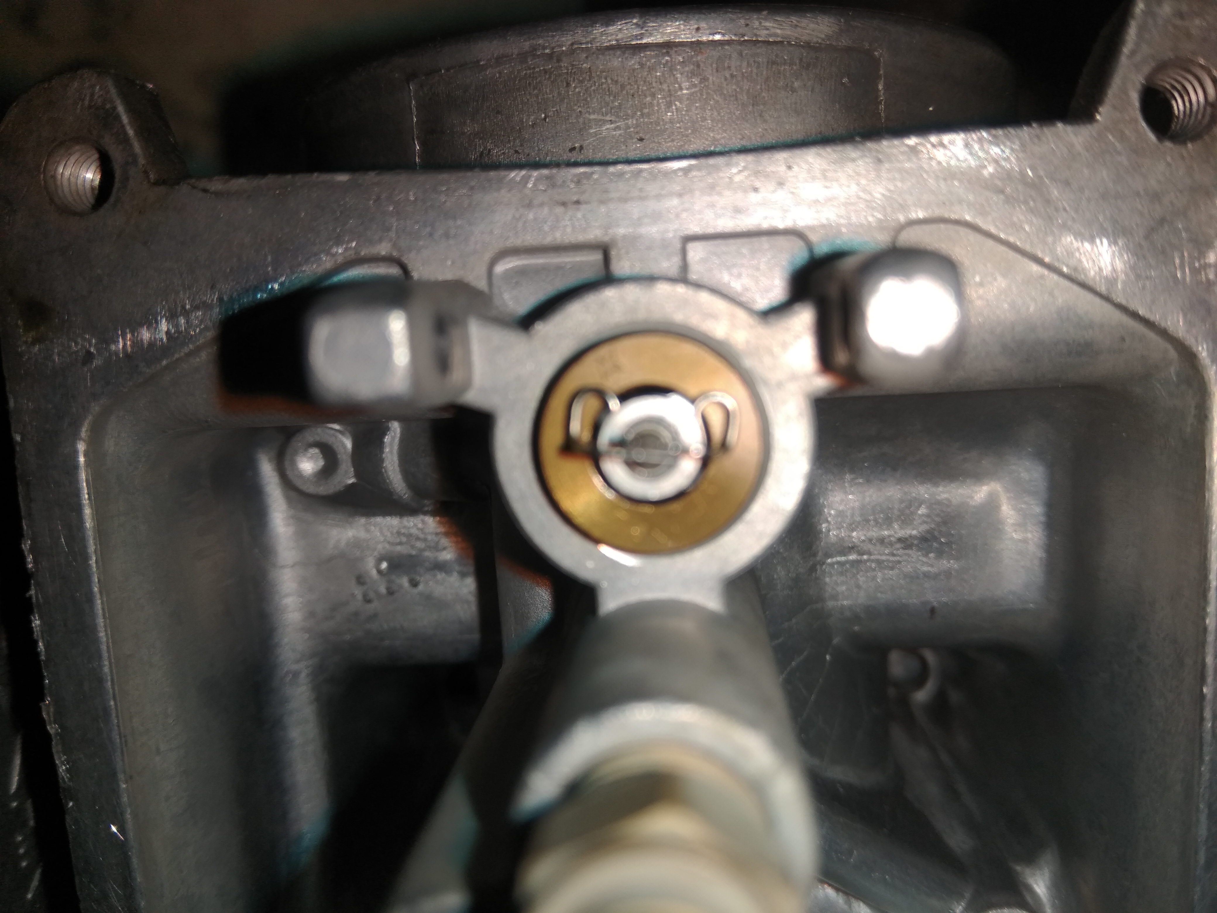

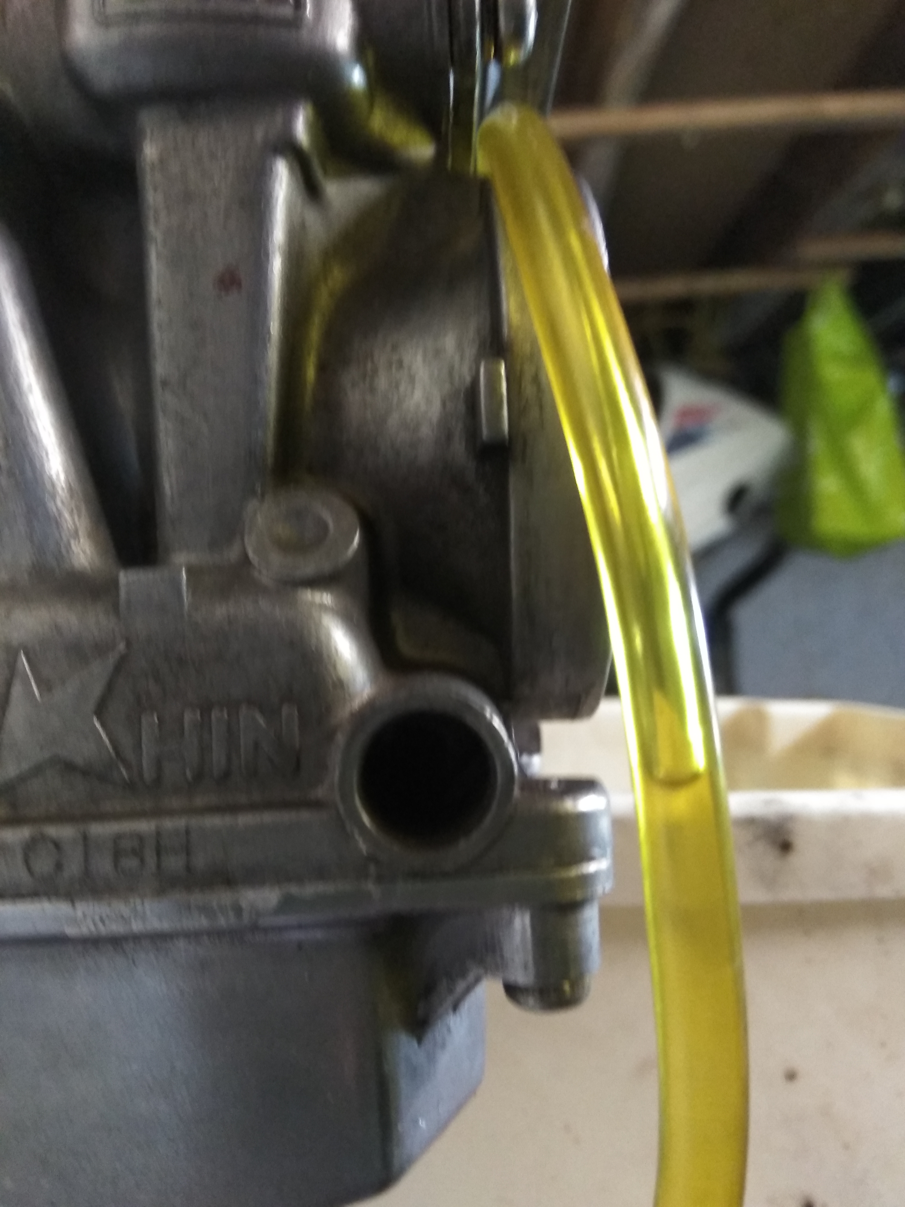

Went to carry out your test Al, the bikes been on it's sidestand all night and I could smell petrol. No 1 was leaking out of the Pilot and main air jets, presumably because that becomes the lowest carb on the sidestand. Carbs off. Fitted some clear tube to the drains and checked the fuel heights. All of them are about 5mm above the mating surface.
I'm unsure what the height should be but am guessing this is too much. I've read elsewhere that a provisional measurement of 17mm should give a rough idea when the carb is angled slightly upside down so as not to put too much weight on the float valve....they are 17mm but this doesn't guarantee fuel height.
On other thing, does it matter which way round the float valve is placed regarding it's 'ears'?

Re: Keihin CVK34 carb set up
If they were CV's as in Mikuni BS34 the fuel level is 3mm + - 1mm below the gasket face of the body from memory. Cant say for CVK from Keihin but 5mm above looks like asking for trouble but it may be the case. Reading another thread the level on another bike was at the gasket face and the owner seemed happy with this concept but that may not be factory either. It looks like you have a serious fuel leak problem to fix before the spitting habit gets fixed in any event.
What is odd though is that with the fuel level appearing to be potentially too high, the fuel level available to the pilot circuits should be excessive and you should be getting an overly rich condition and not a potentially lean one. Confusing.
If you can find the correct fuel level setting it is best to do it on the bike with the engine running in the manner you have done statically with the clear tube on the drain outlet.
Whilst there; if you leave the tube attached and fuel tap open and engine off. After a period of time has elapsed you can see visually if any are passing at the float needle valve if the level in the tube increases.
Similarly; if you (under the same conditions above) run the tube down into a container, after an initial surge of ten seconds of full flow fuel, you can assess the recharge rate for each float and float valve arrangement. This will give a good visual representation of the speed at which each bowl replenishes itself. Relevant because; some cabrs have a limiting stop at the bottom of the bowl and it is possible to adjust the floats to be almost trapped between the two limits and end up with diminished dynamic re-fill even though the static fuel level may appear to be spot on.
General consensus is pilot air screws at; 2 turns or a touch more from fully seated but again it would seem dependent on the market they were sold into and the prevailing environmental legislation in force in that country / continent.
Dont know about ears on the float needle.
Thanks Al, I saw on another site (same carbs different bike, think a twin) no more than 1mm above the carb body so I've gone for that. I've set one carb up now at + 0.5mm so will measure the float height with a depth gauge and reset the other three the same. Should give a ball park setting to allow me to wet set them, then leave them off the bike with fuel on to see if the levels creep up, then have a go on the bike.
Never thought of doing a dynamic check with the engine running, that will be the final confirmation, and as you said, leave the tap on prime for a while to reconfirm the valves aren't seeping.
