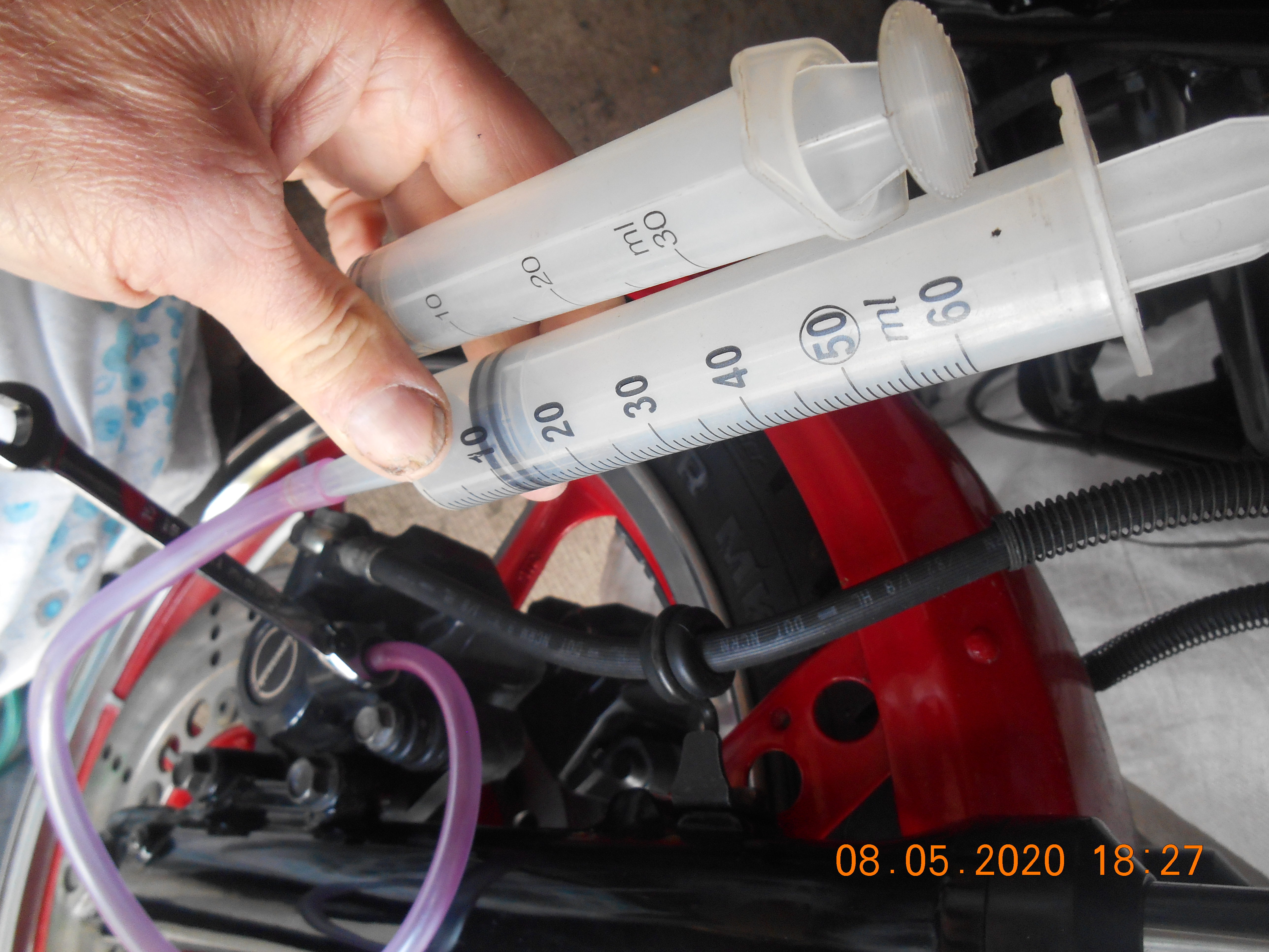

This is a method I learnt whilst in the aviation industry. Pipe runs in aircraft are long and take a torturous routes. Back bleed from the caliper. I've used this on all my bikes with standard brake set ups [ there's been many ] and its 100% effective and only takes about 30 mins max for a twin disc set up.
Use a large syringe to feed the caliper and a small one to remove bled fluid from the reservoir. Bleed one caliper a couple of times then switch to the other. Alternate between them a couple of times more. Air likes to rise and will always head to the reservoir. If this doesn't work then the systems got a leak or suspect component.
