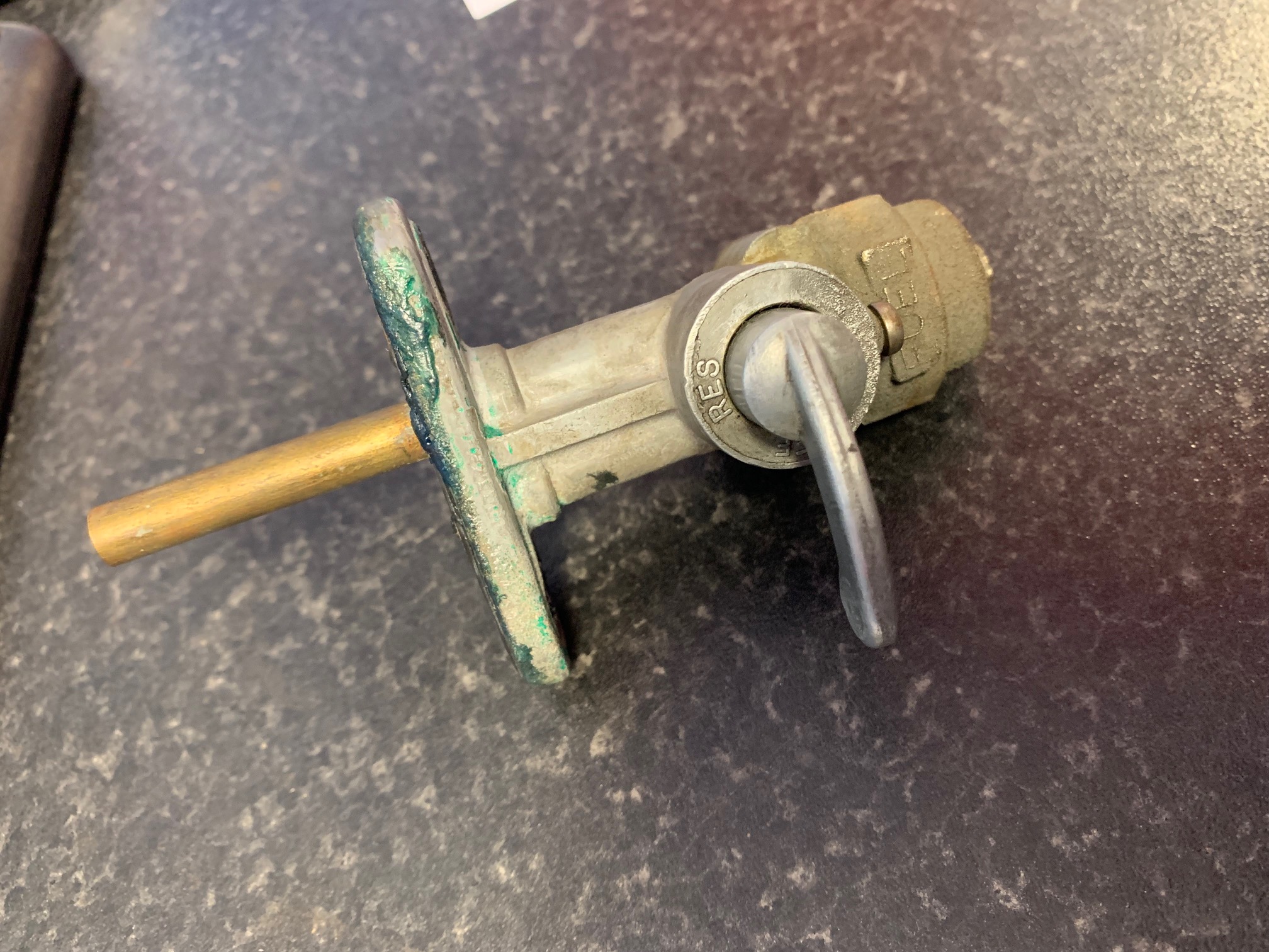

Hi,
Would anyone have a tap for my 650B1, can`t seem to source one the same (obviously with two supply pipes, mine has one missing) , pic attached...
Cheers,
Roy

Hi,
The other hole doesn’t have a pipe in it as such, it just has a small plastic bodied filter lightly pressed into the hole in the tap body. It’s about 20mm tall in total measured from the tap body.
Z Power do a rebuild kit for the tap itself and if the plastic tapered valve insert is undamaged it should rebuild just fine.
