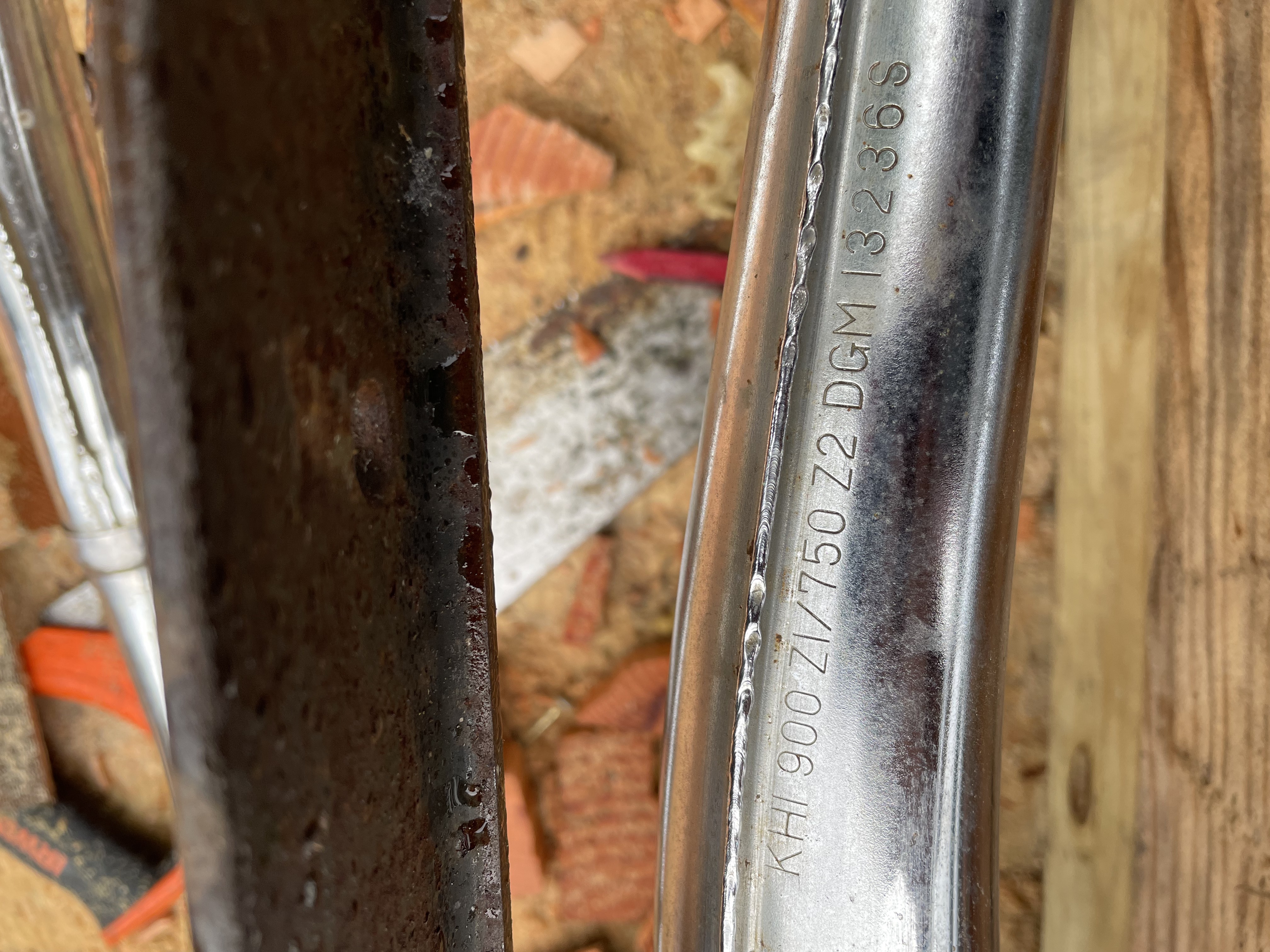

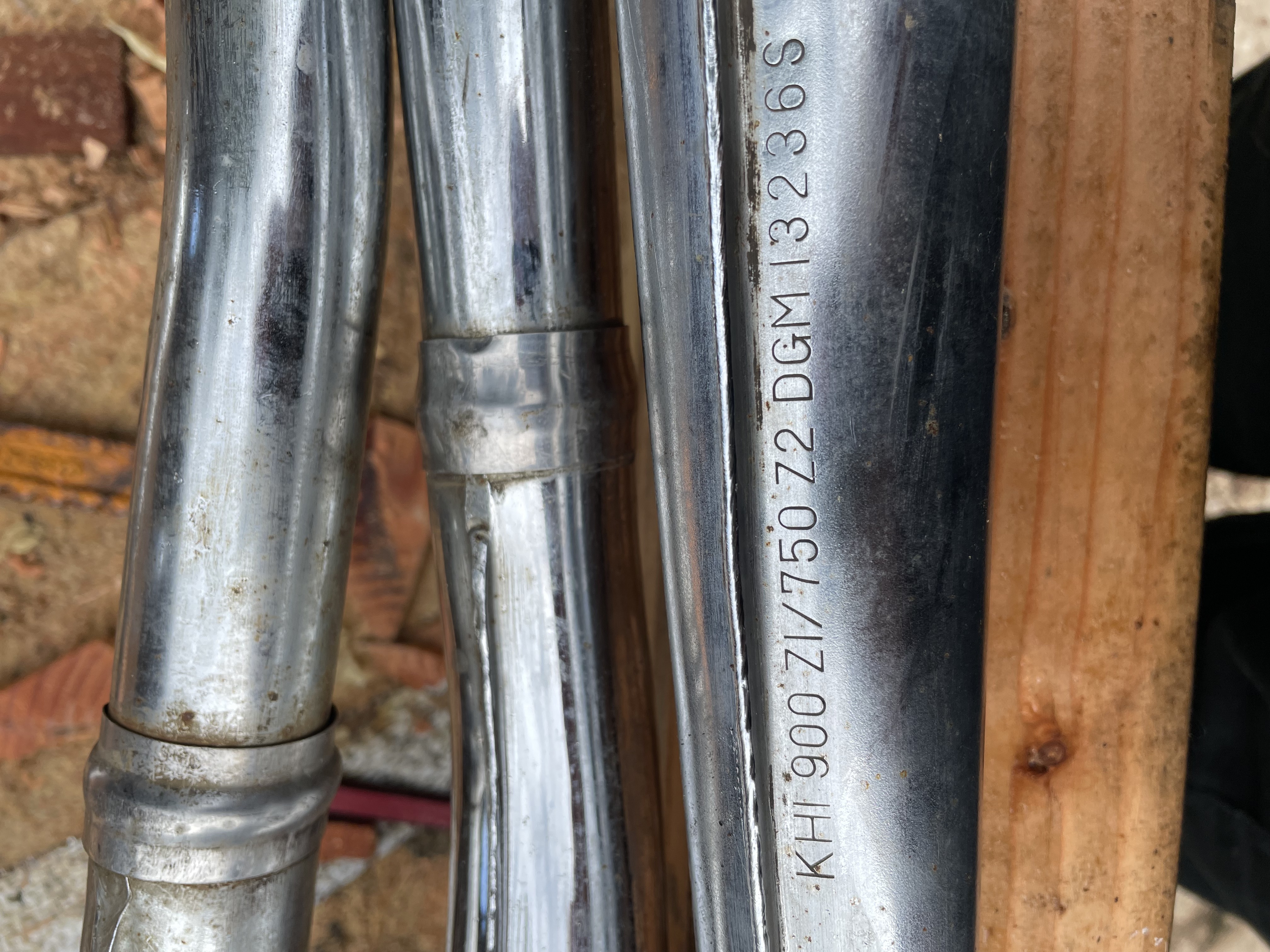

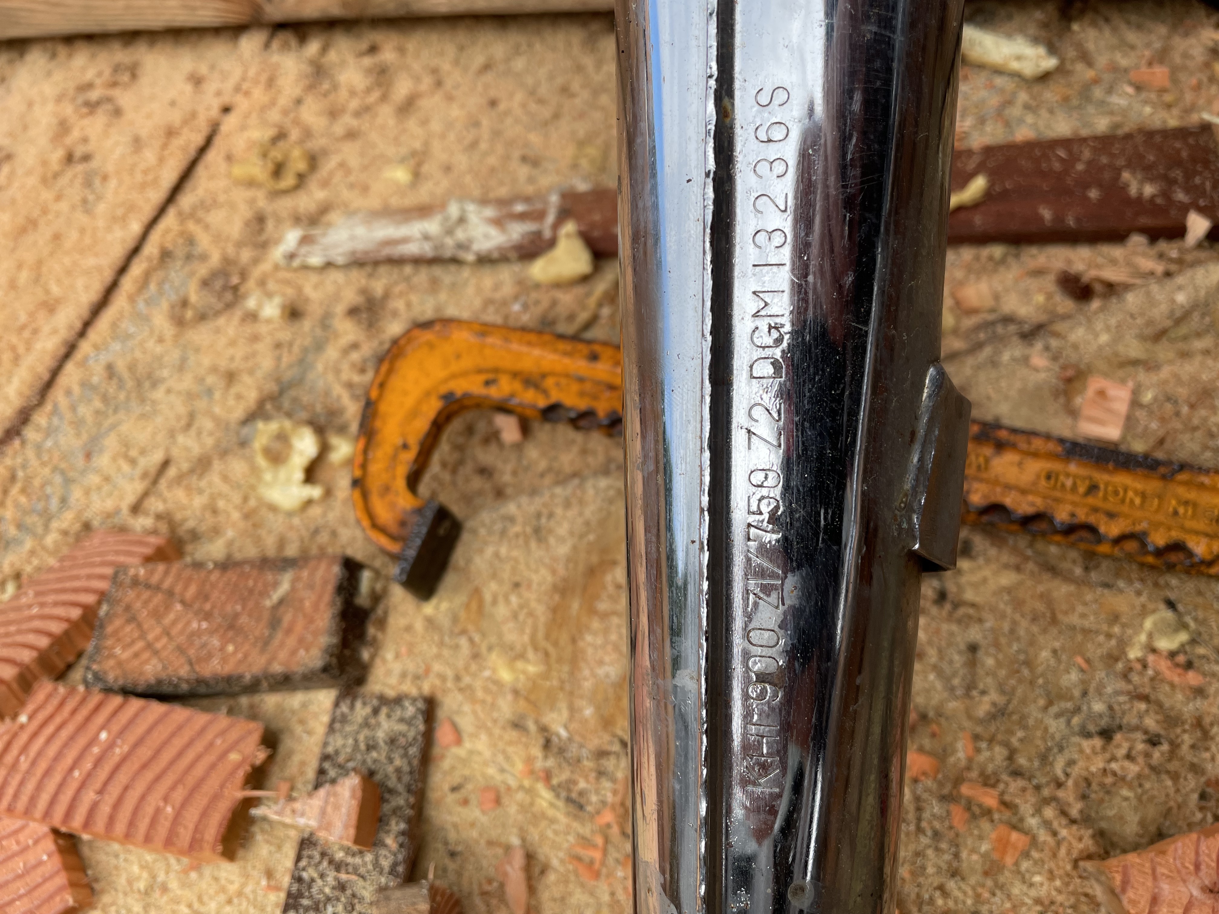

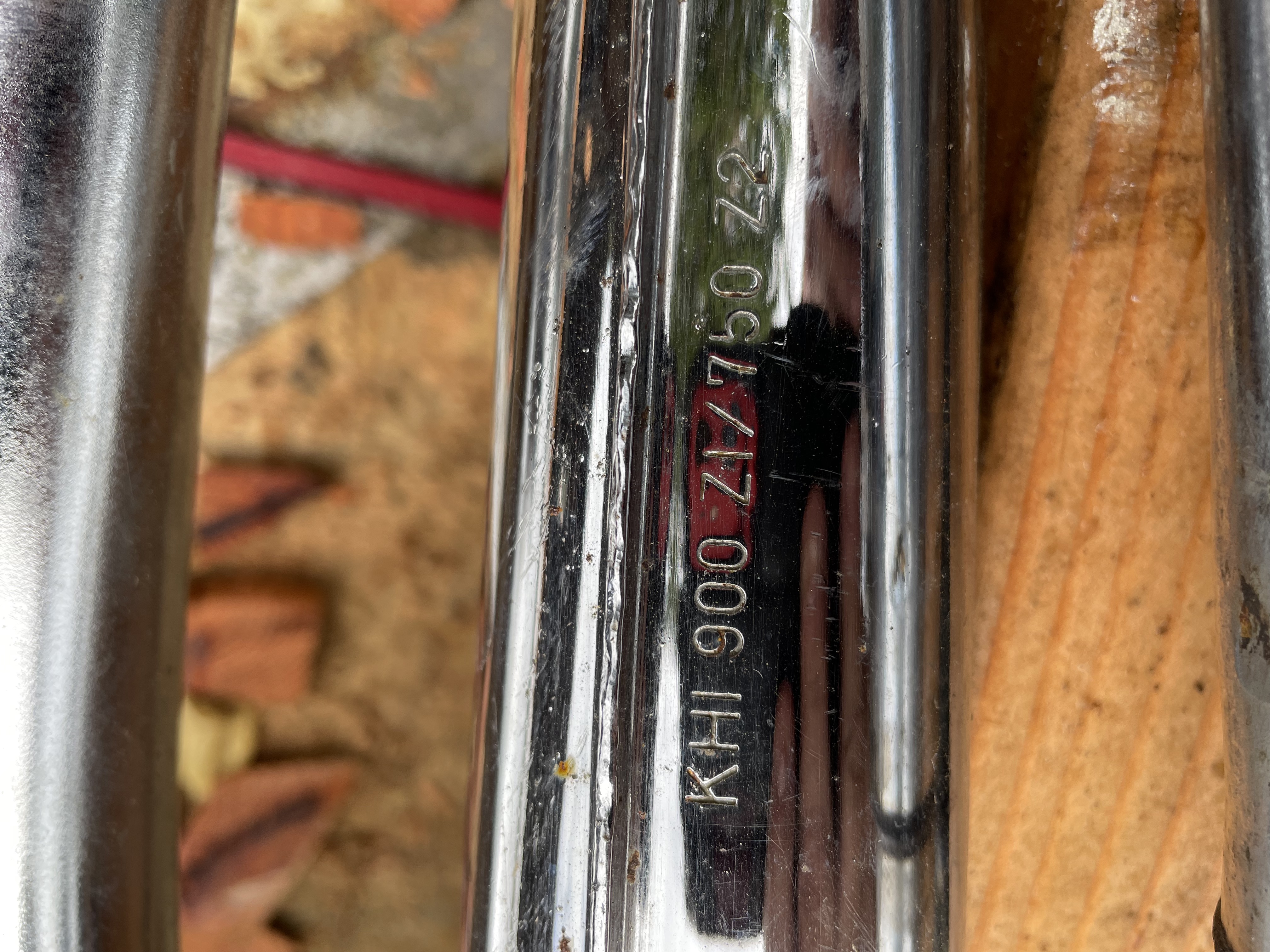

I have come across what i believe to be Z1/Z900 exhausts in varying condition can anyone tell
me what they are of please :)

Thank You :up
