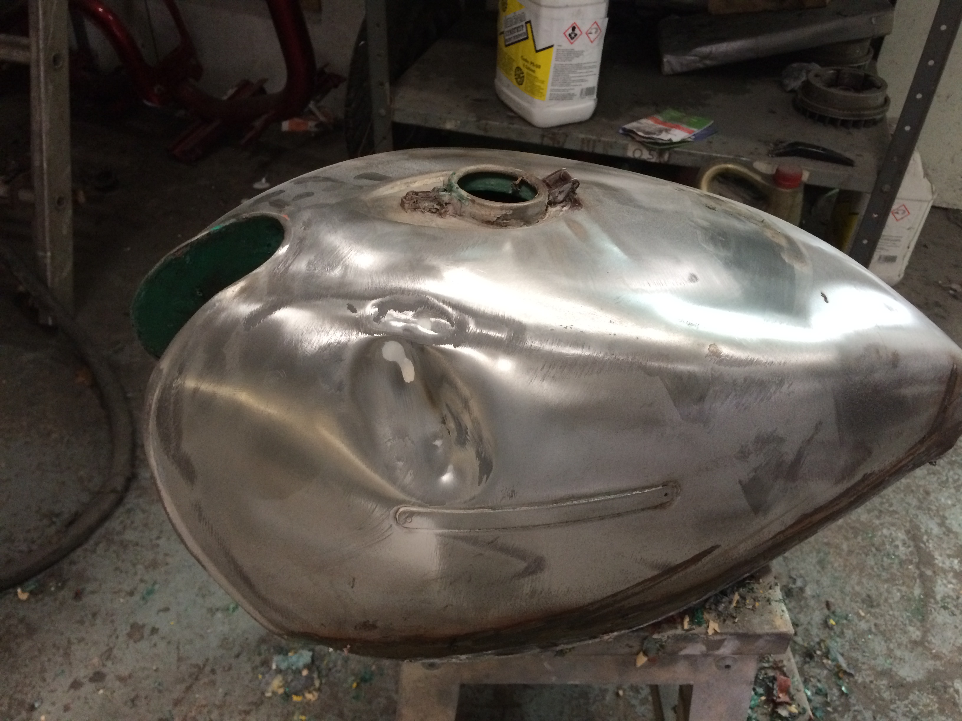

After a little incident in the shed I now need to repair the tank from the z1000.
It has quite a deep crease in the side which would take about 3 tins of bodyfiller :lol:
I think it's well beyond my 'skills'.
Anyone any ideas on how to proceed?
Pressurise it? cut and weld?
I don't want to bin it as, apart from this, it's pretty clean.
Thanks in advance.

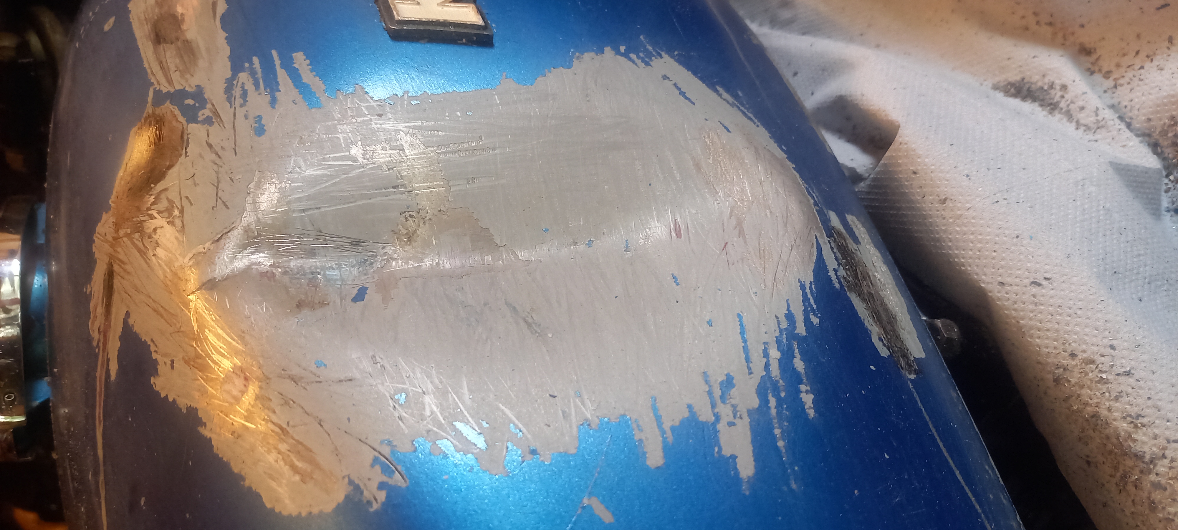

If you've got a spare inner tube, stuff it in the tank down that side and SLOWLY in flat it. That will get most of it out and then heat it and tap any high spots back down. These will be at the end of any creases. A skim of filler and your good to go.
Don't cut it out, it's not easy to get a leak free weld unless your ever good at it.
It doesn't need cutting unless it's at this stage! (courtesy of a po)

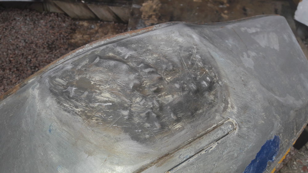

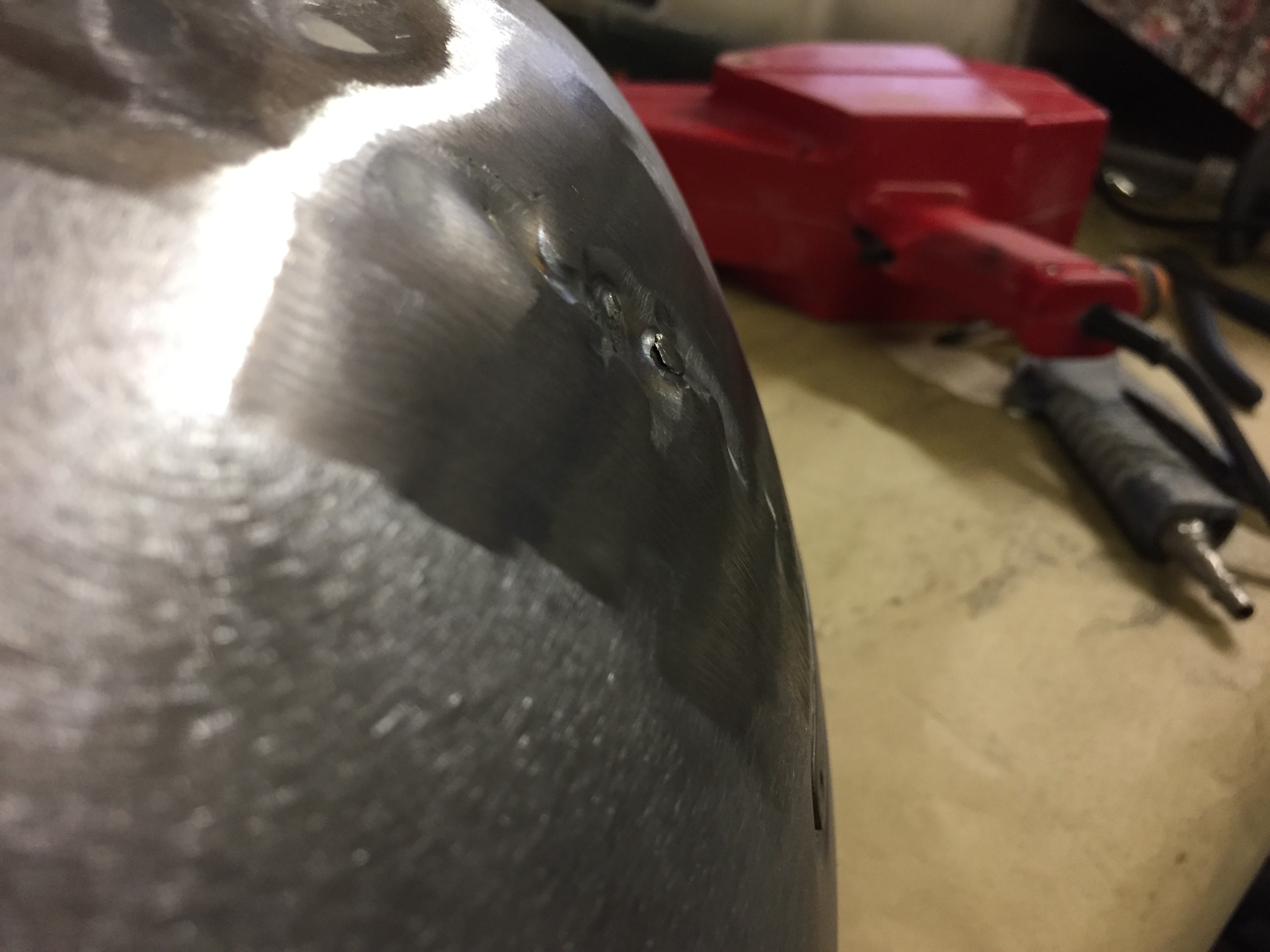

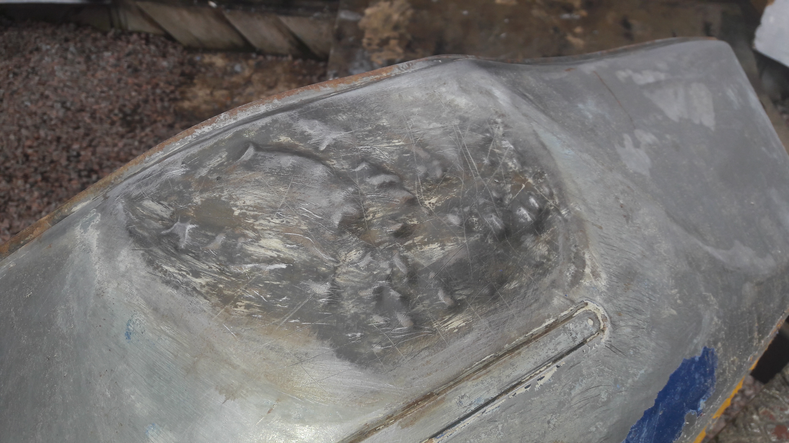

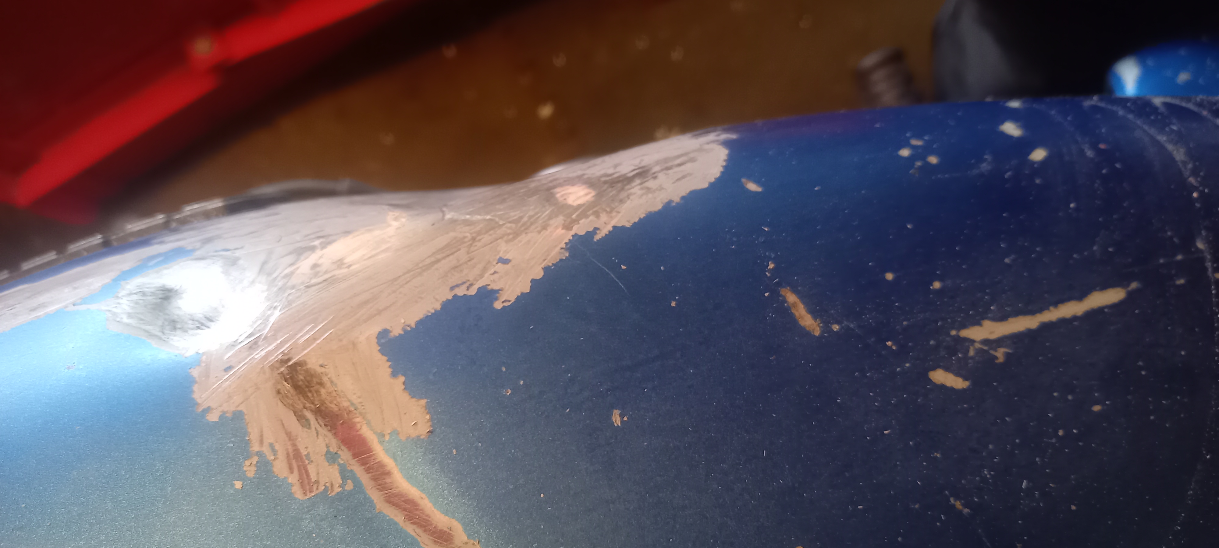

Mine was similar . Before and after pulled with welded sticks
