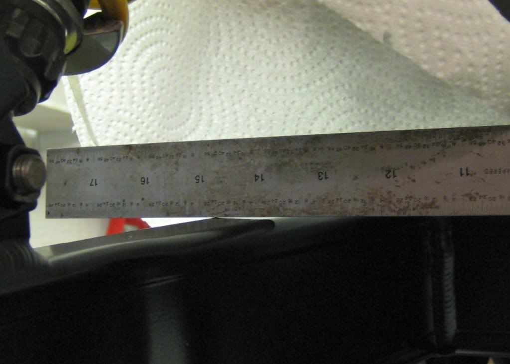

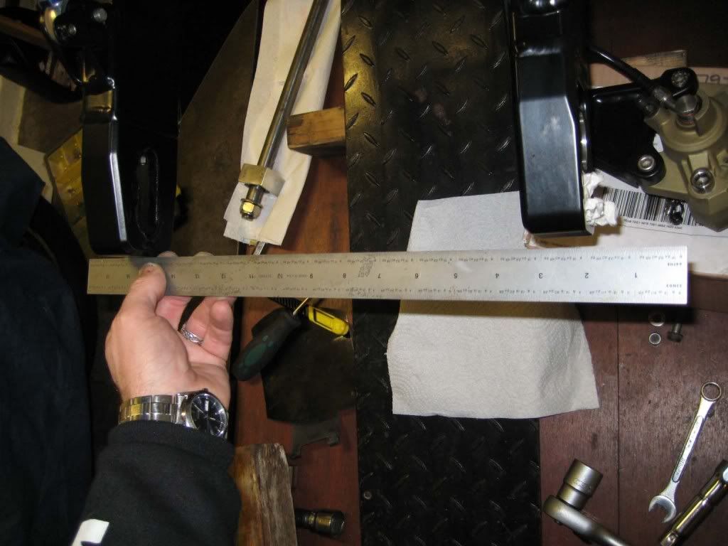

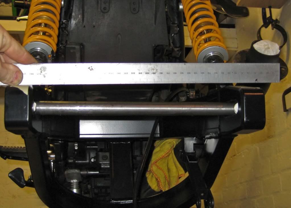

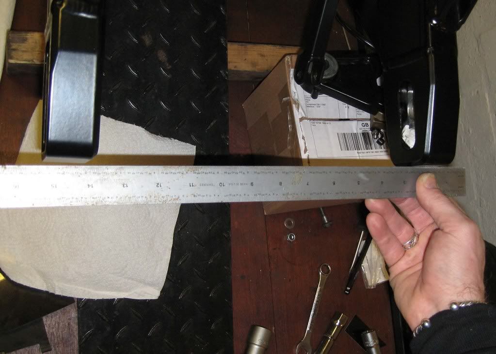

After the problem with the chain hitting the bracket I thought I'd check a few things just out of curiosity, be interested in your comments. When I Emailed the pix over to them they said that everything was within tolerance. I just expected everything to be a bit more 'lined up'. There's no problem with the bikes handling though......
