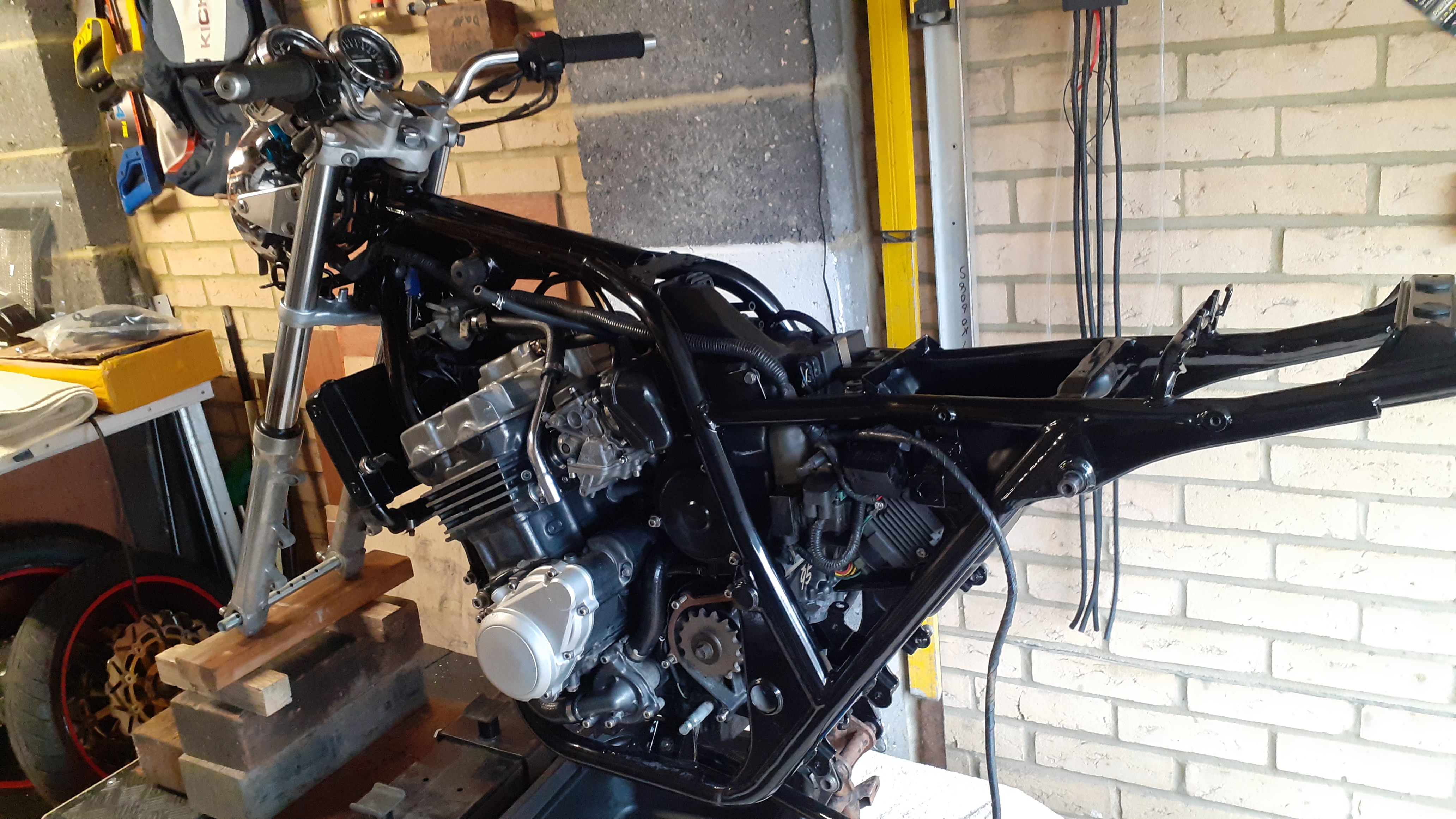

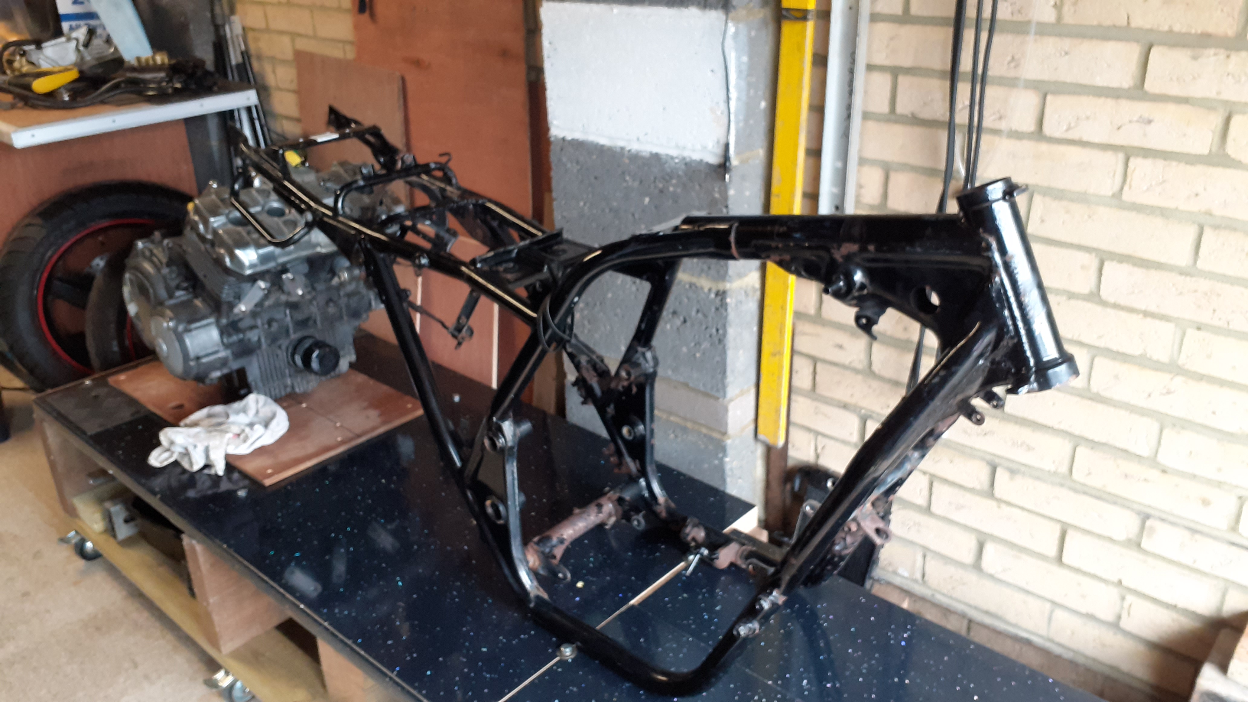

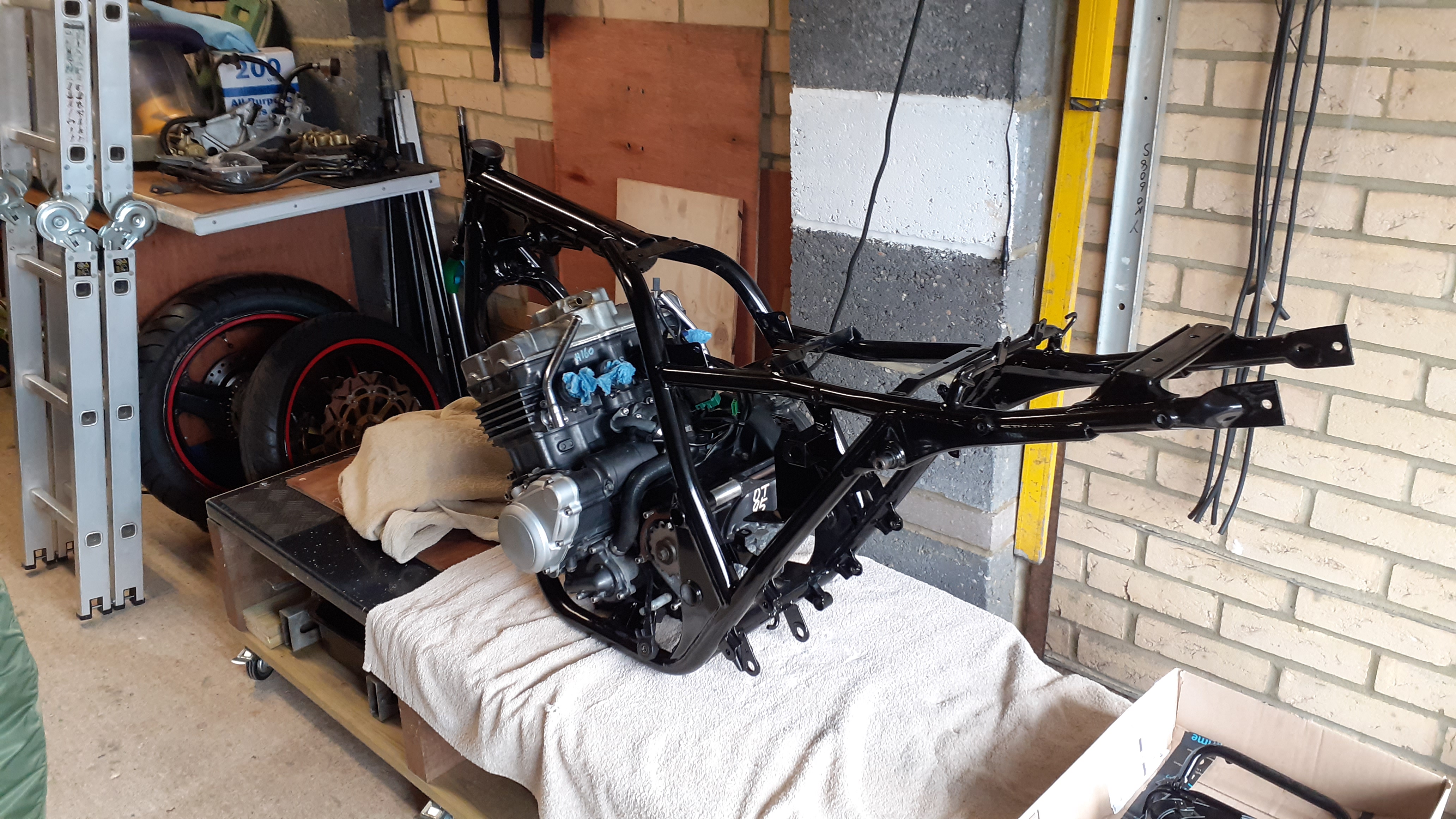

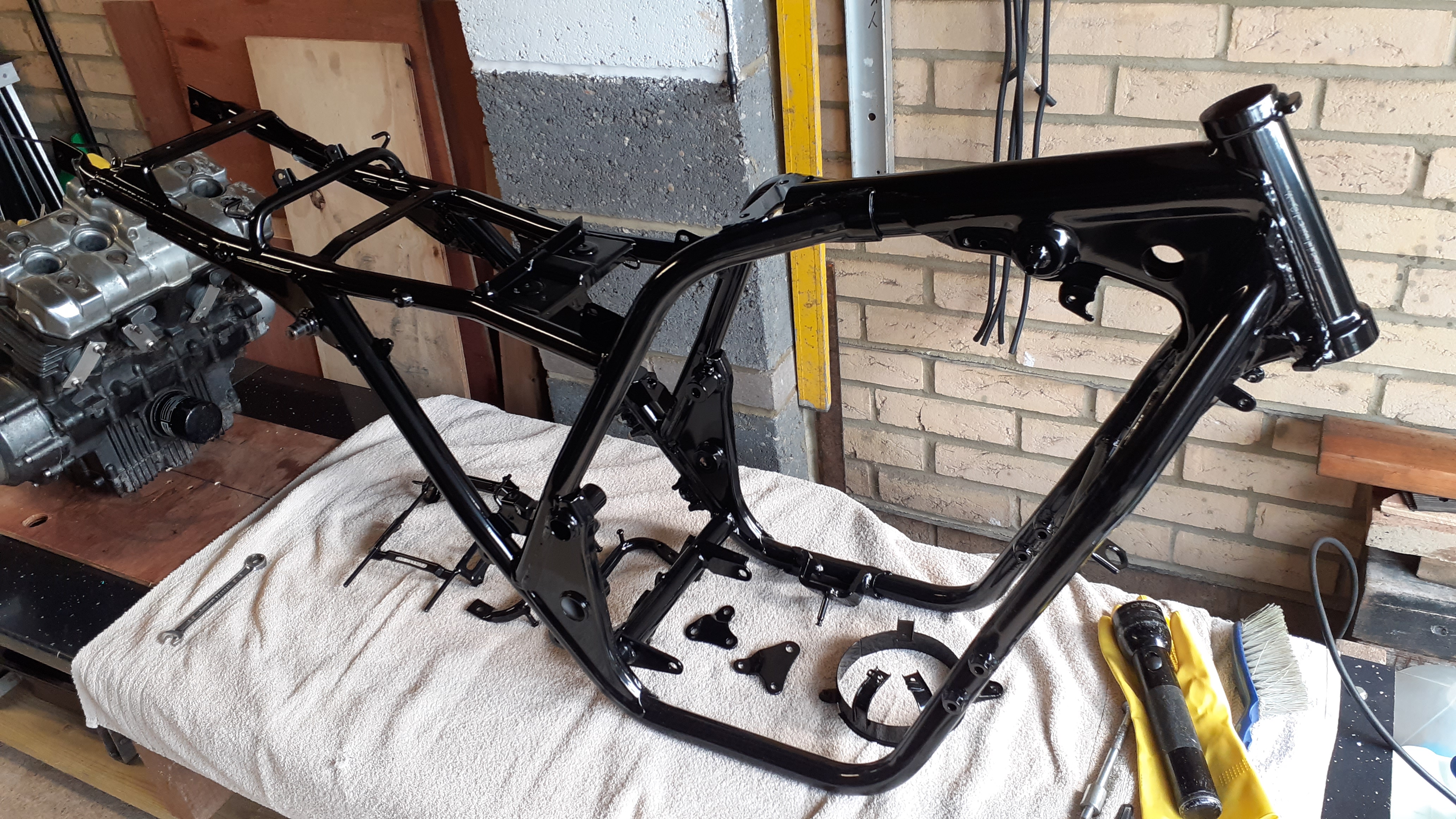

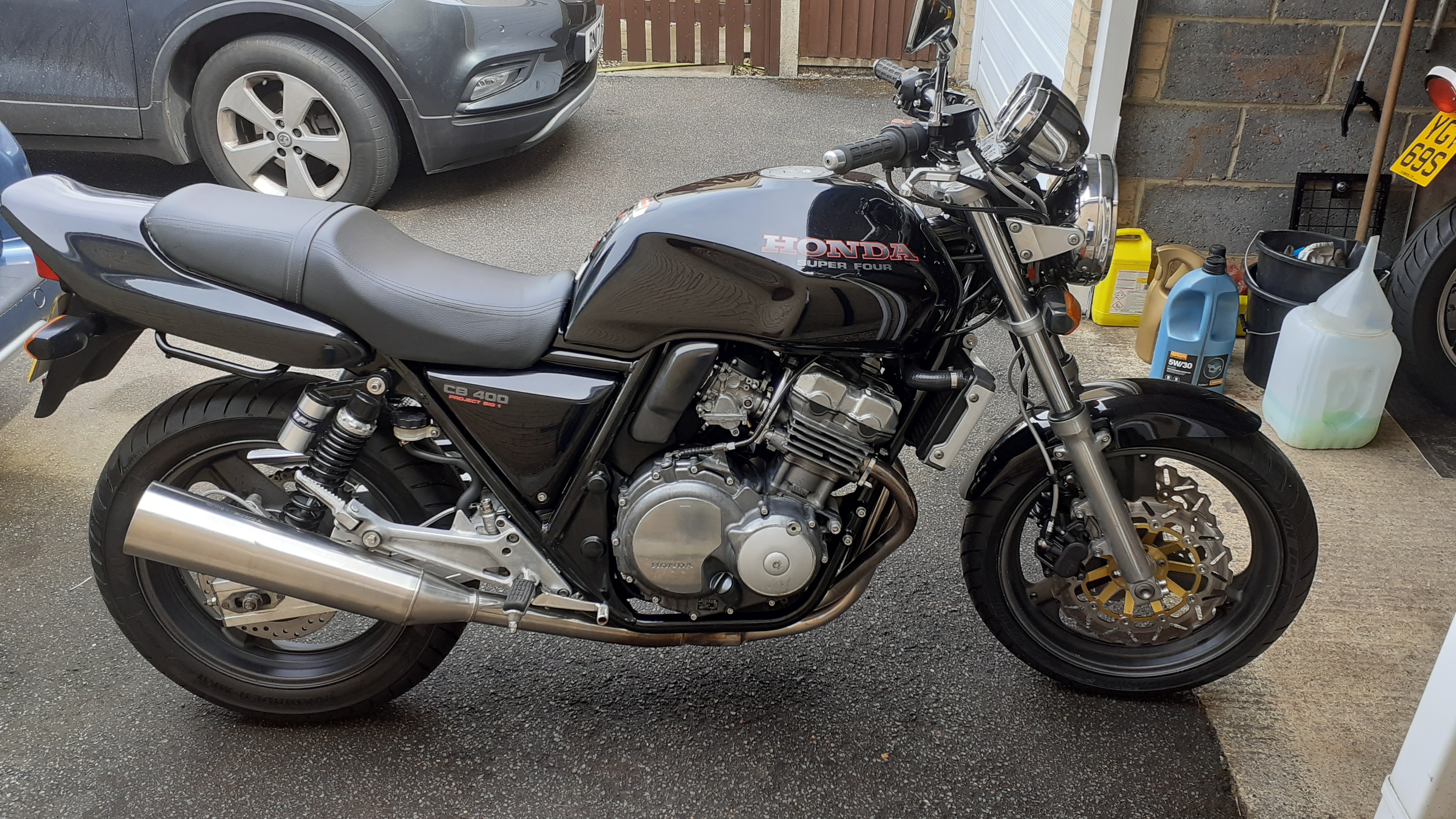

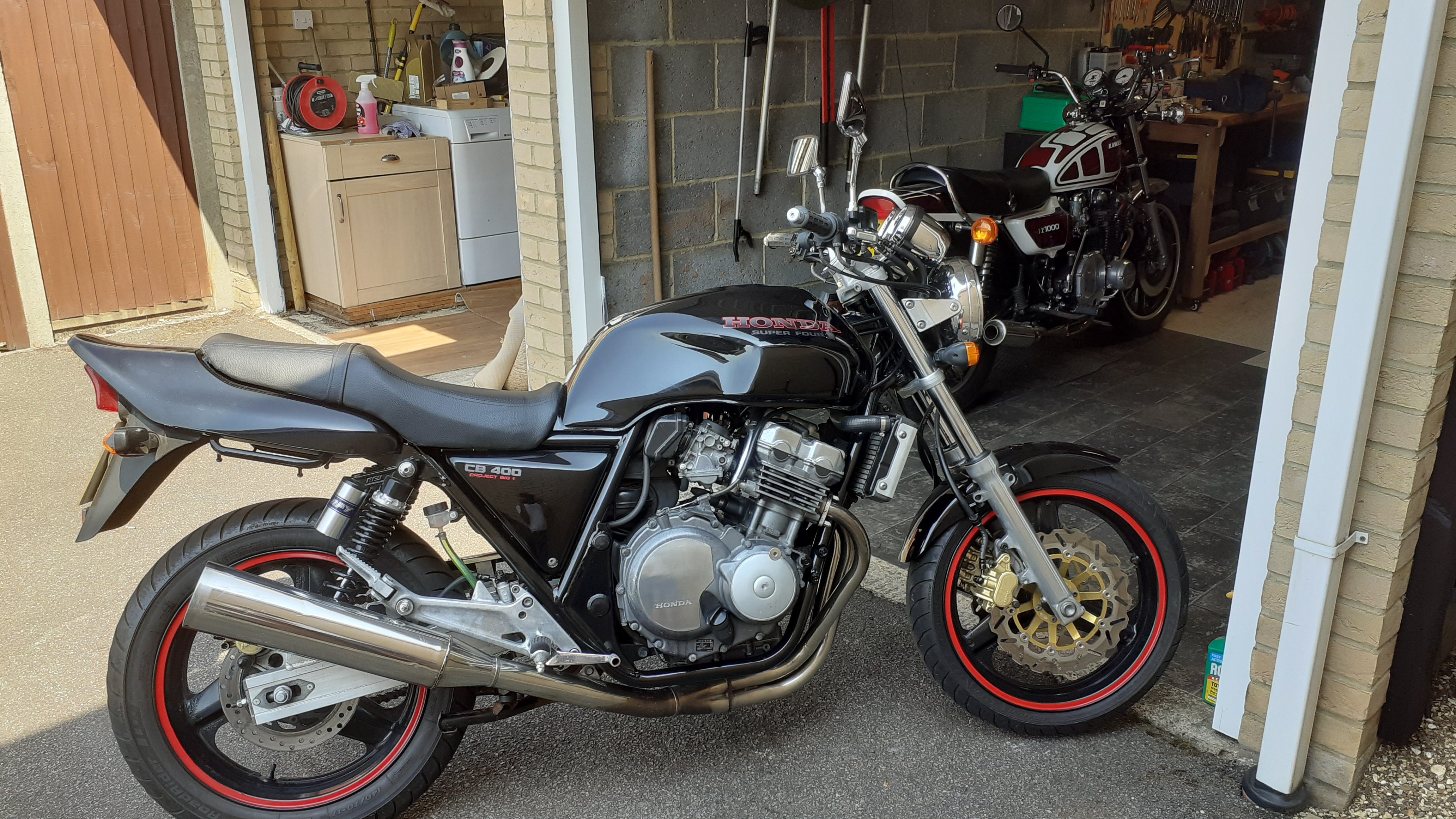

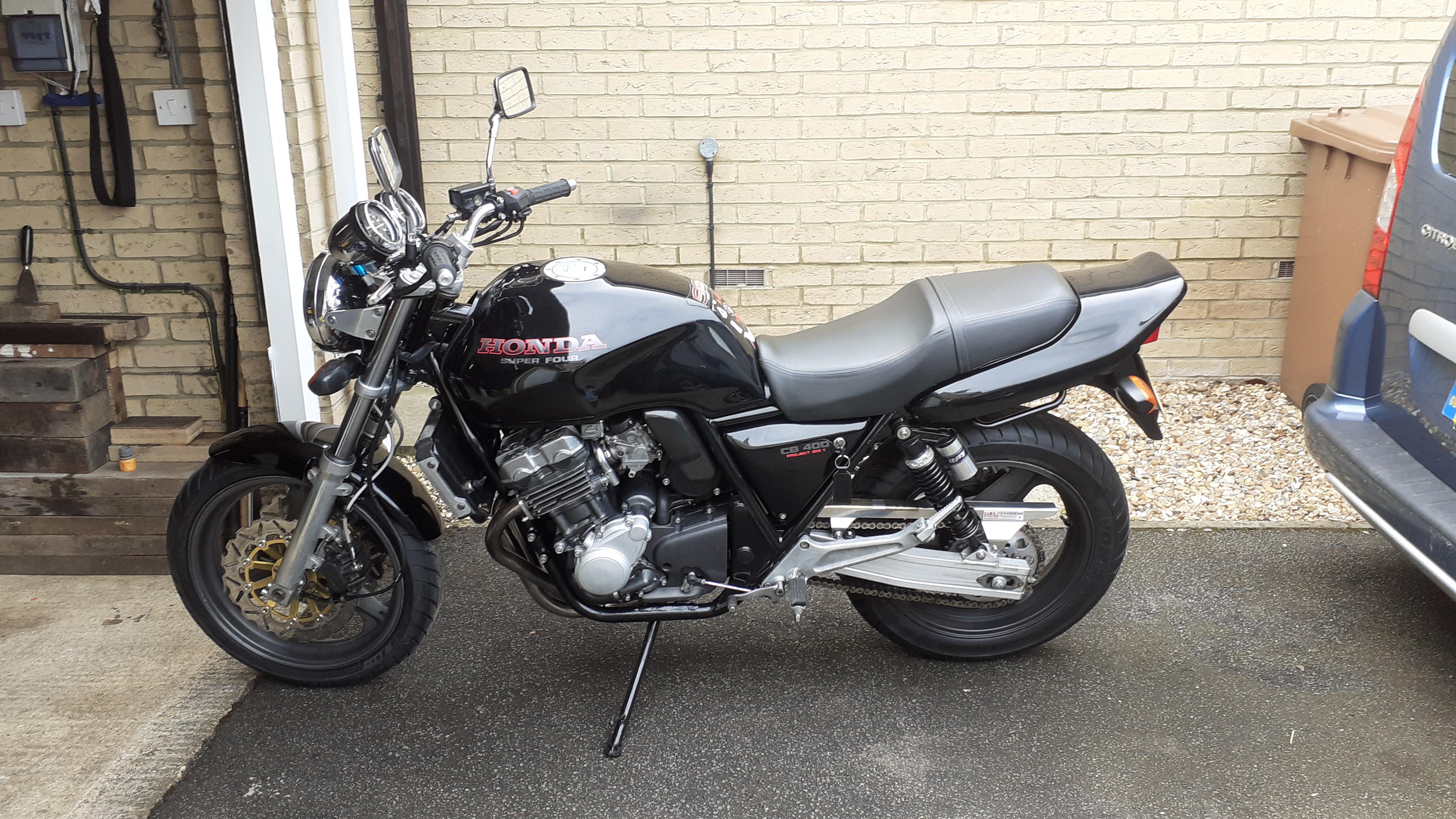

Thought i would give my little Project Big One a freshen up as the frame was so rusty. so stripped, frame and motor cleaned, frame blasted and powder coated and motor back in in the last two weeks, most bolts on engine replaced with stainless as originals are really scabby and front motor mount bolts replaced with stainless also.

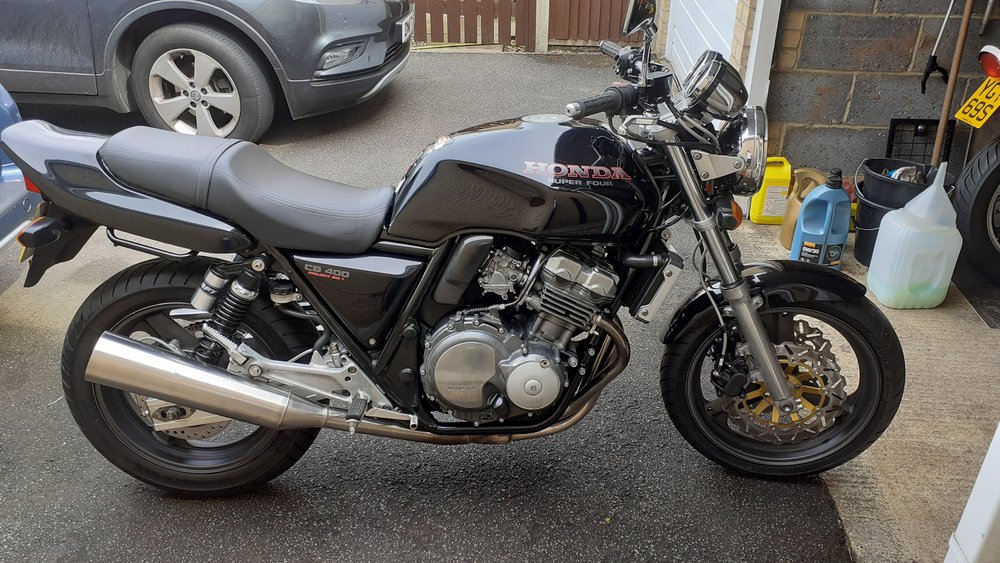

#4 PostAuthor: kev edwards » Thu Apr 08, 2021 6:21 pm
A little more progress, also oil and coolant in.

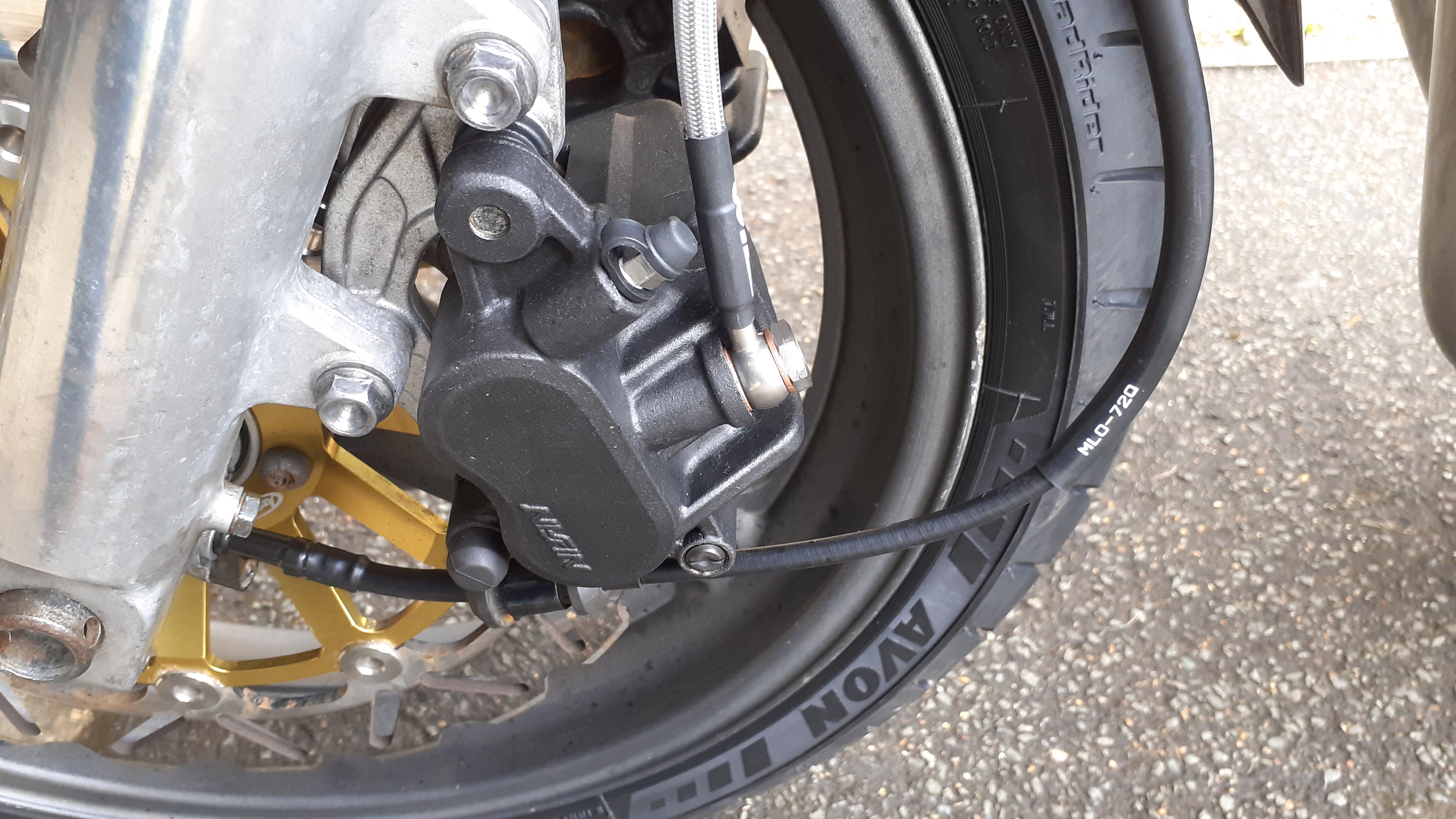

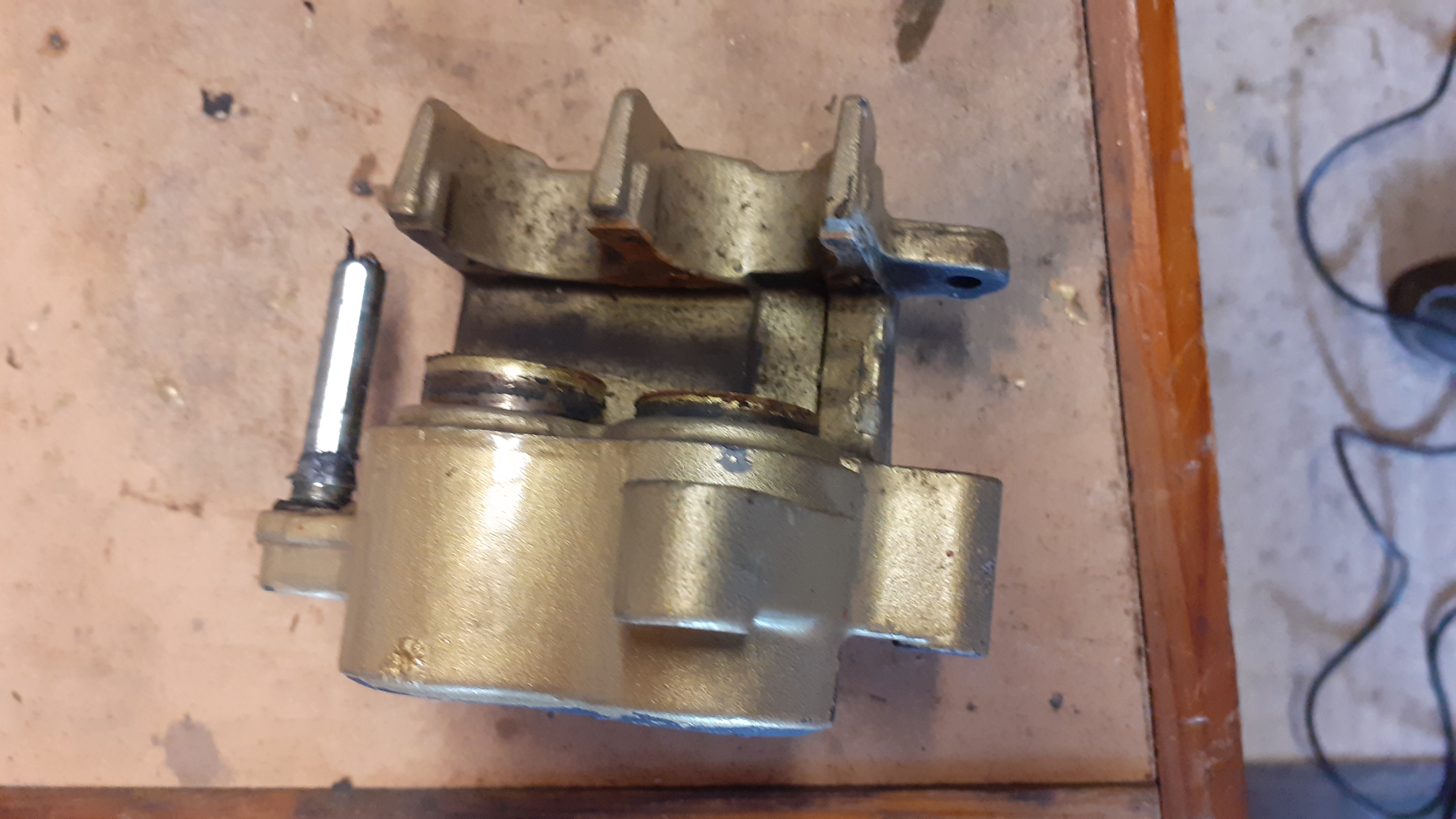

#7 PostAuthor: kev edwards » Sun May 09, 2021 6:17 pm
Took for a couple of shakedown runs and performing well, last weekend was spent stripping the brake callipers of some badly applied gold paint down to their original dark anodised finish which was not too special, so i brushed on a Zebo type product and they have come up well, as with all good clean ups it was not cheap, surprised, not.

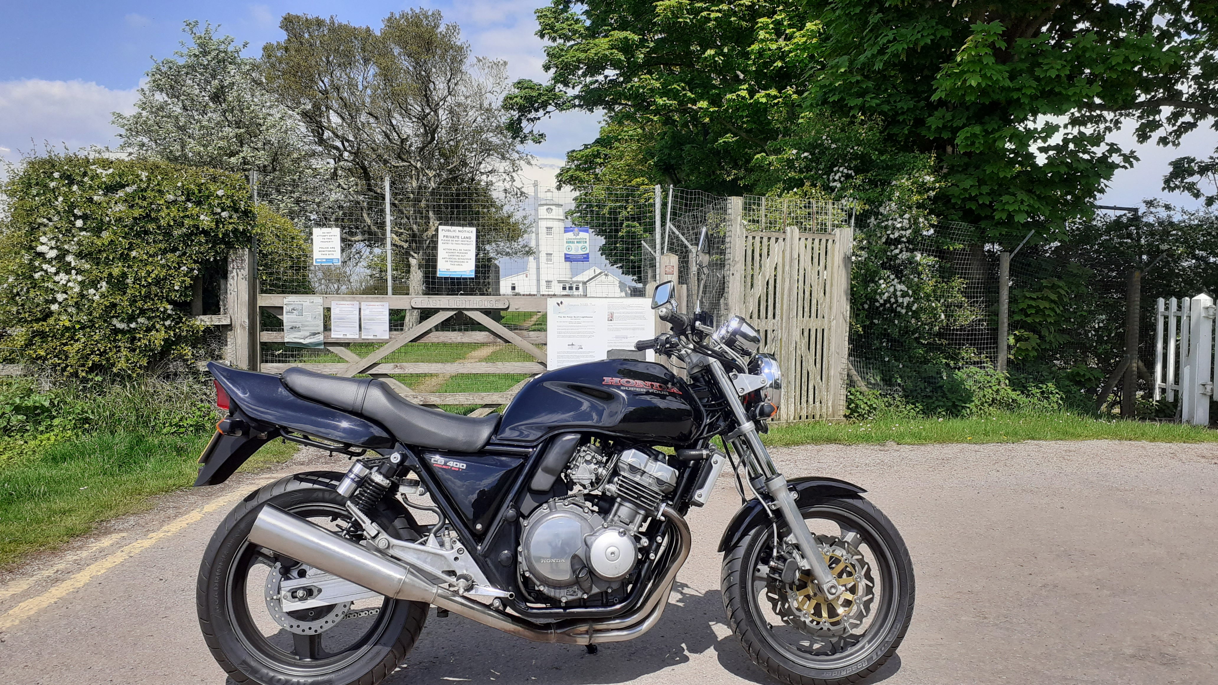

#9 PostAuthor: kev edwards » Wed May 19, 2021 4:24 pm
Gave it a 30 mile blat today, went really well apart from almost zero damping on the rear, RFY shocks that came with the bike, so new shocks soon, went up the Wash.
