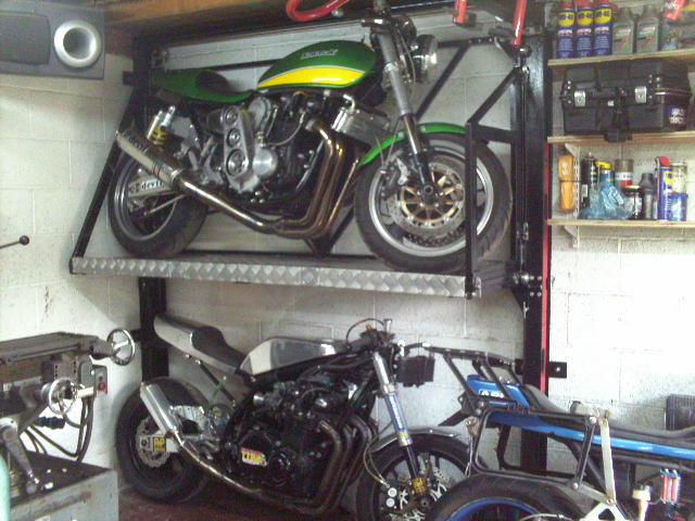

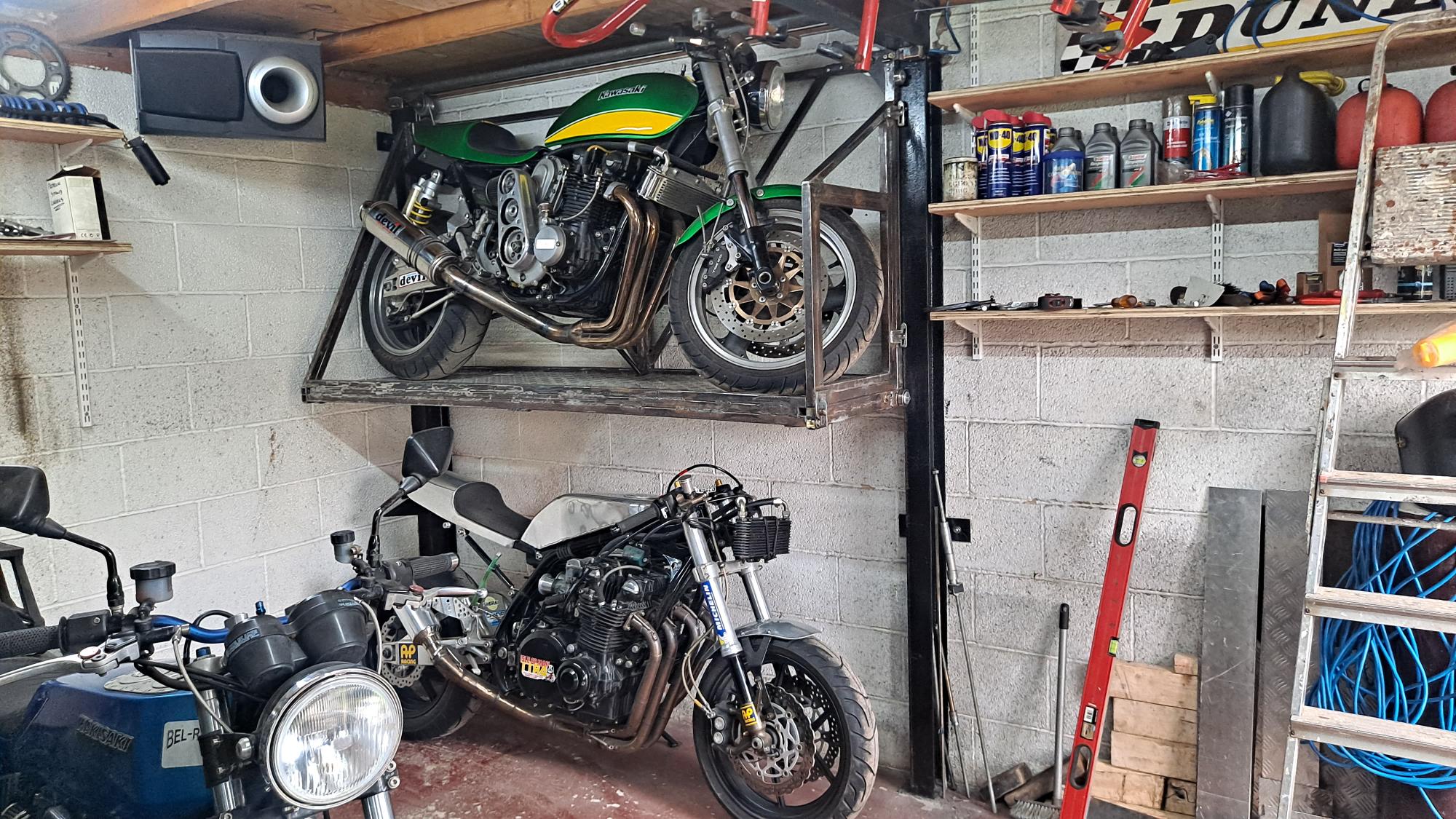

Rapidly running out of floor space in the shed due to a newly acquired Harrison mill.
Decided to re-jig the place and somehow make room so i can actually get back in there to carry on with work on the current project bikes .
No scope to build out so had to get inventive.
Motorised cable lift cobbled from scrap box section roadwork sign frames, old wheel bearings, home made pulleys and a builders winch works a treat and i now get parking for two bikes in one space.
Just some minor tweaking and a tart up with a coat of paint to finish it off :D

What about the roof? You may be missing a trick there.

#3 PostAuthor: zed1015 » Mon Mar 21, 2022 11:26 pm
steve452 wrote:What about the roof? You may be missing a trick there.
Only 3 foot odd at the ridge in the loft.
Tall enough to crawl around and store parts but that's it.
Stuck to permitted development when i built it so only 14 foot x 22 foot internally and 13 foot to the apex which was more than big enough before i filled it up :lol:

I like that, you've got me thinking. Could use an old tail lift maybe...
Or dig down...

Mr Bump wrote:I like that, you've got me thinking. Could use an old tail lift maybe...
Or dig down...
Olly
I realised i could maybe use a tail lift but only after i was halfway through building this.
Had a look on Ebay at the time and there was a few around £200 which was tempting but they were all miles away.
Would also have loved to have dug down too but any more than a couple of feet round here and you hit the water table so only good for an indoor pool :lol:

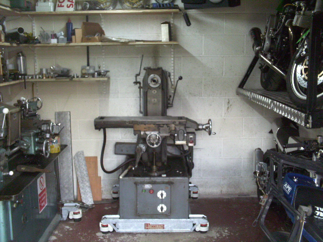

And this is the mill responsible for the desperate measures which has forced a total re-jig of the shed and several months lack of progress on the project bikes.
To figure out the layout i had to move the lathe and mill around a fair bit to find the best position so i ended up making these machine skates from I beam offcuts and some cheap £50 a set Ebay levelling castors.
They work very well and the machines which weigh around 650 kg each take only as much effort to move as pushing around a full supermarket trolley.
