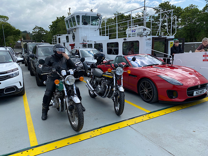

Pic here on ferry across Wyndamere, after seeing bikes ferryman let us cross free!

Looks like you have those hard plastic NGK plug caps ? so likey those are the cause.
I use dyna leads with the tight fitting rubber caps and never had a problem.
